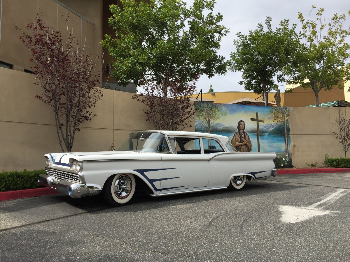

    beautiful!!!!
    59FORD and loudbang like this.
