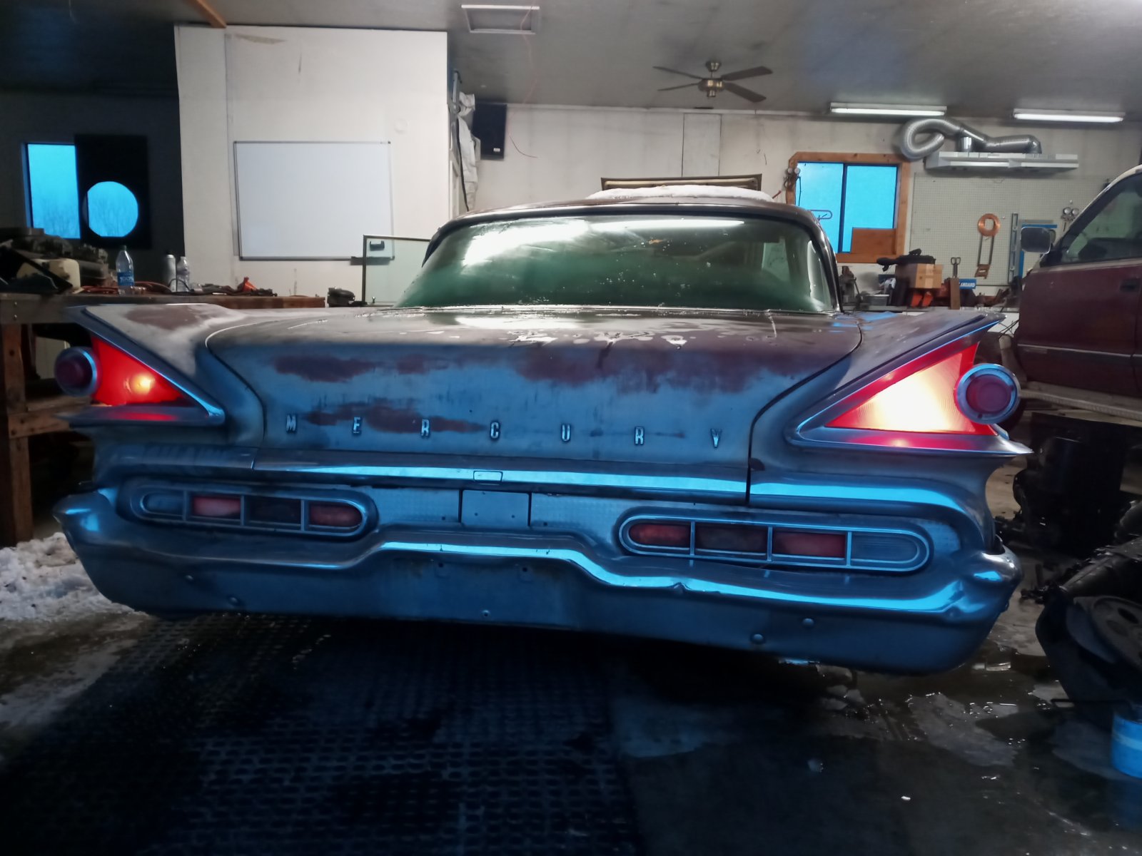

    A good friend of mine does a lot of reselling cool old stuff, and he had picked up this 59 Merc a couple years ago. The car is all original down to the heat riser on the air cleaner, so he was waiting for someone who appreciates that stuff to sell it to. Well after a couple years of the car being buried in his yard and me throwing him stupid lowball offers he gave me a good deal on it. It seems like a couple guys on here like the 59s so I thought I'd share some pics. It's staying all stock the way it is, except for the wheels. Can't get 14" tires that are tall enough so I'm going to throw some 15s on it and cruise it.
    430 MEL, 3 speed Merc-O-Matic, power steering, power brakes, power windows, power locks, power seat. The odometer stopped at exactly 75000 miles but it runs and drives fantastic.
    The story I got is that the second owner daily drove it until they slid off the road into a fence post with it. They got scared of it after that and it stayed parked ever since. It's got some rust and it's a little banged up, but it's unrestored and still roadworthy. That makes it the perfect year-round cruiser in my book.

  8. The rear tailight treatment and how they are canted really are a distinctive styling feature.
