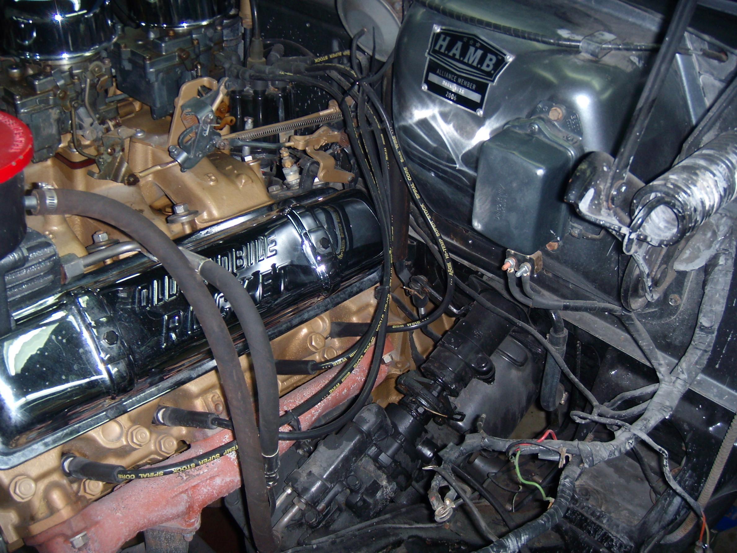

    I will post some more detailed pics as soon as I start ripping into the project. The car is in my driveway and I have no room in the garage because like most of us I have more projects that I really need. The weather just started to get better so I will be going at it pretty soon. I may end up getting all the parts and starting the swap this weekend.
    I am doing a build thread over on http://classicoldsmobile.com/forums/vintage-oldsmobiles/
    and I will have full detailed pics of the brake swap.
    Here are the only pics of the master cylinder area I have so far. I am just now getting to know and really work on this car after having it less than a year.
    Mine has the factory power brakes but I am going to go with manual because I like the feel of the pedal and for the room savings.
    I was going to mount the new master cylinder on the firewall after I make a 16ga block off plate for the cold air box.
    I will get some more pics this weekend.

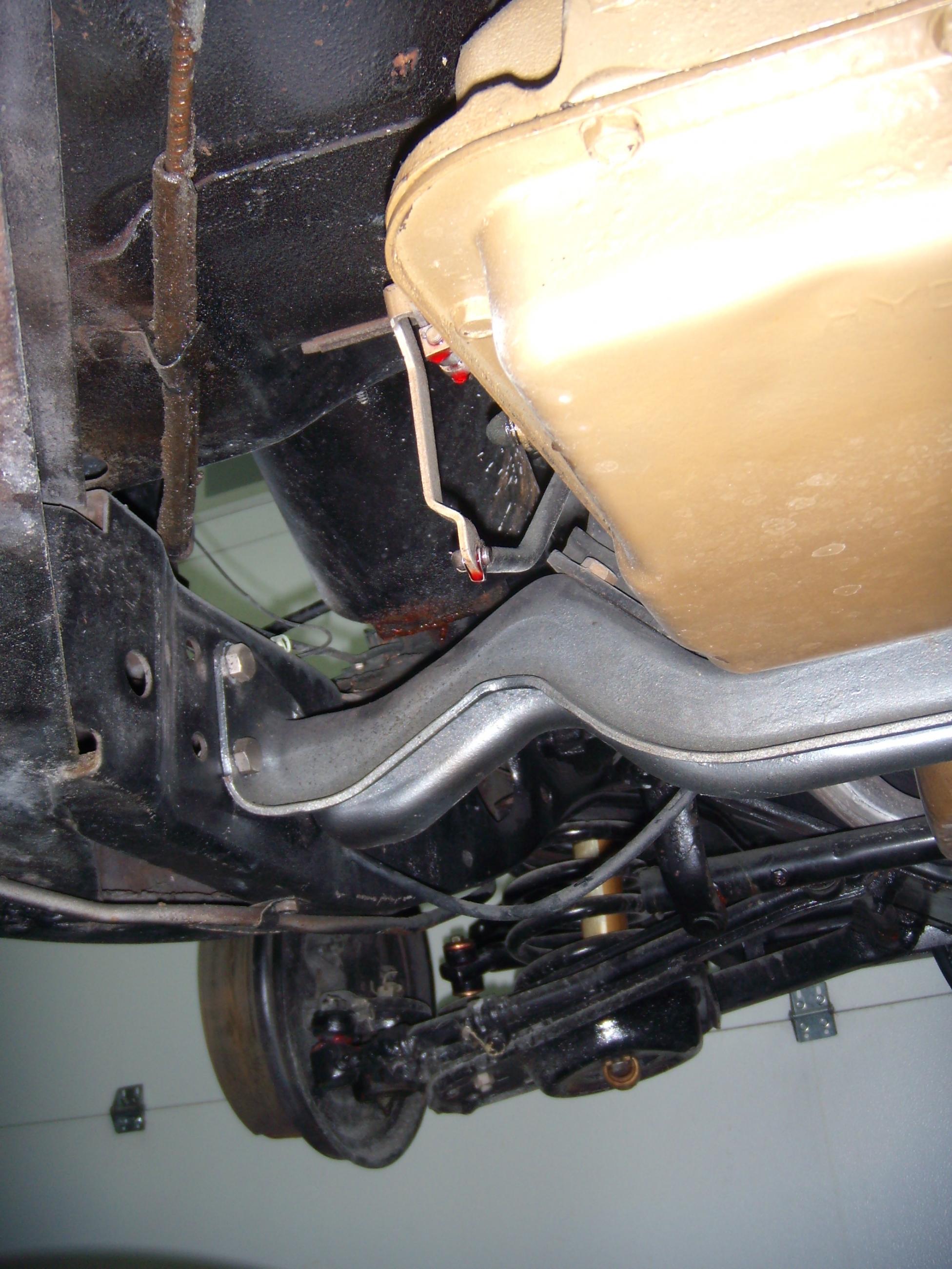

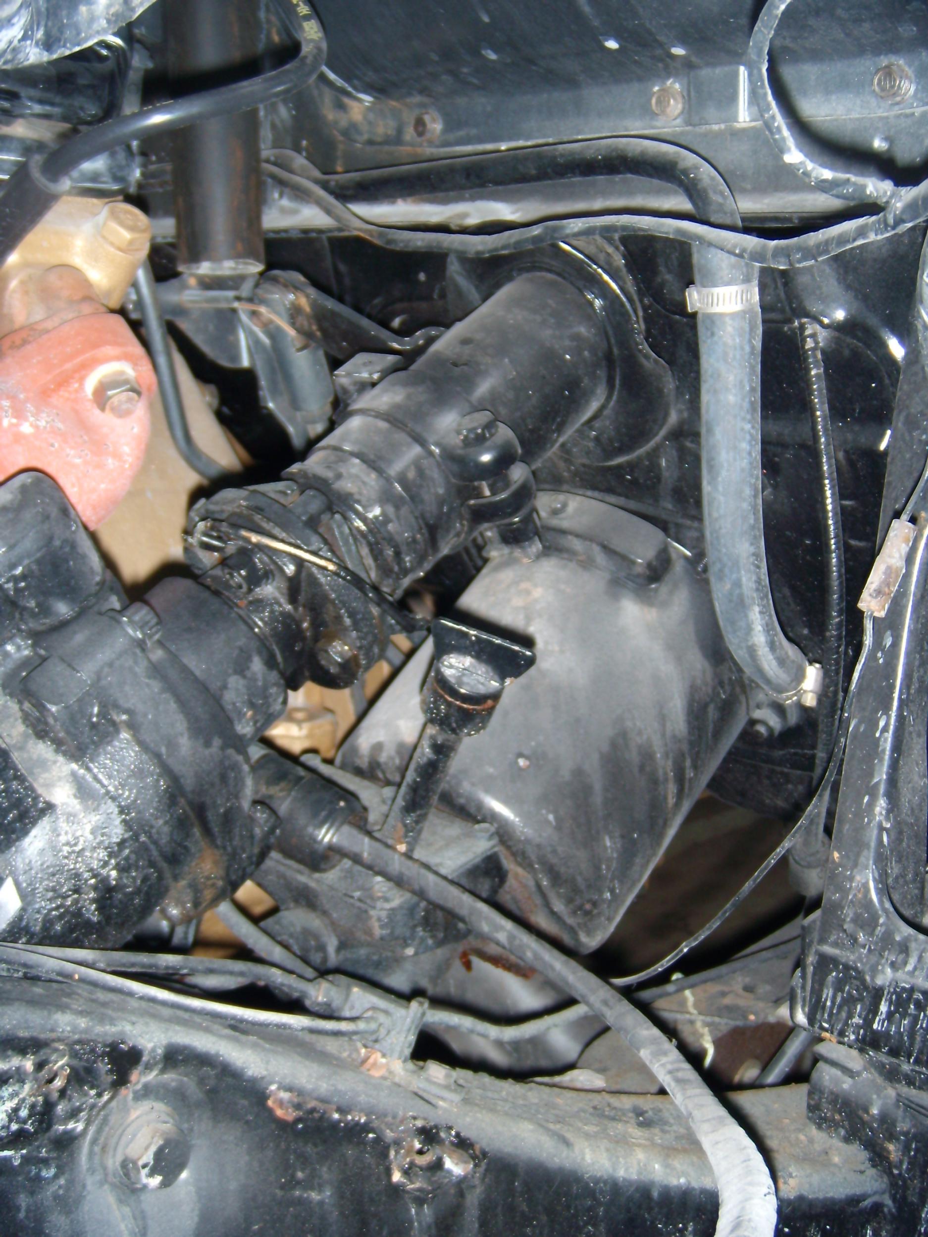

    Its the same down to 57 i know for sure- i will be doing the disc kit too, but i'm trying to first work an upgrade master under the floor with a remote fill. I just like the firewalls look with two bumps even if ones a dummy.
    I just tore mine down to start so here's a couple more pics for tinkers to think on with more room.
    I'm thinking it will take a pedal assembly and then a rod through the diagonal crossmember to the booster/mc with a remote fill to get around(or through) the "X" member - i have my own goofy exhaust preference that leaves some room on the drivers side. If you ran duals u would need to modify the frame and add another hole for an under floor to maybe work. Its not going to be easy no matter what. My pops put a hydra boost unit on his which mounts in the same place as the treadle vac and runs off the power steering pump- but it is it's got some issues still.
