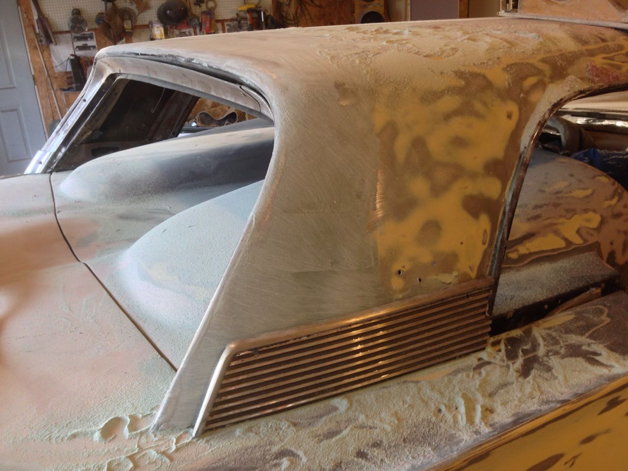

    I hope you dont mind me playin around, but I was curious what some more swoopy, exagerated sail panels would look like, maybe like on a 61 or.....?
    Forgive my poor skills:D.............the skirts look good by the way.

    Thanks for the effort (and I couldn't what you did with the photo!), but I've cut the top apart enough as it is, shortened the sail panels 8", leaned the backlight forward a couple of degrees, made the body fit the new backlight placement, I'm done cutting up that part of the car!

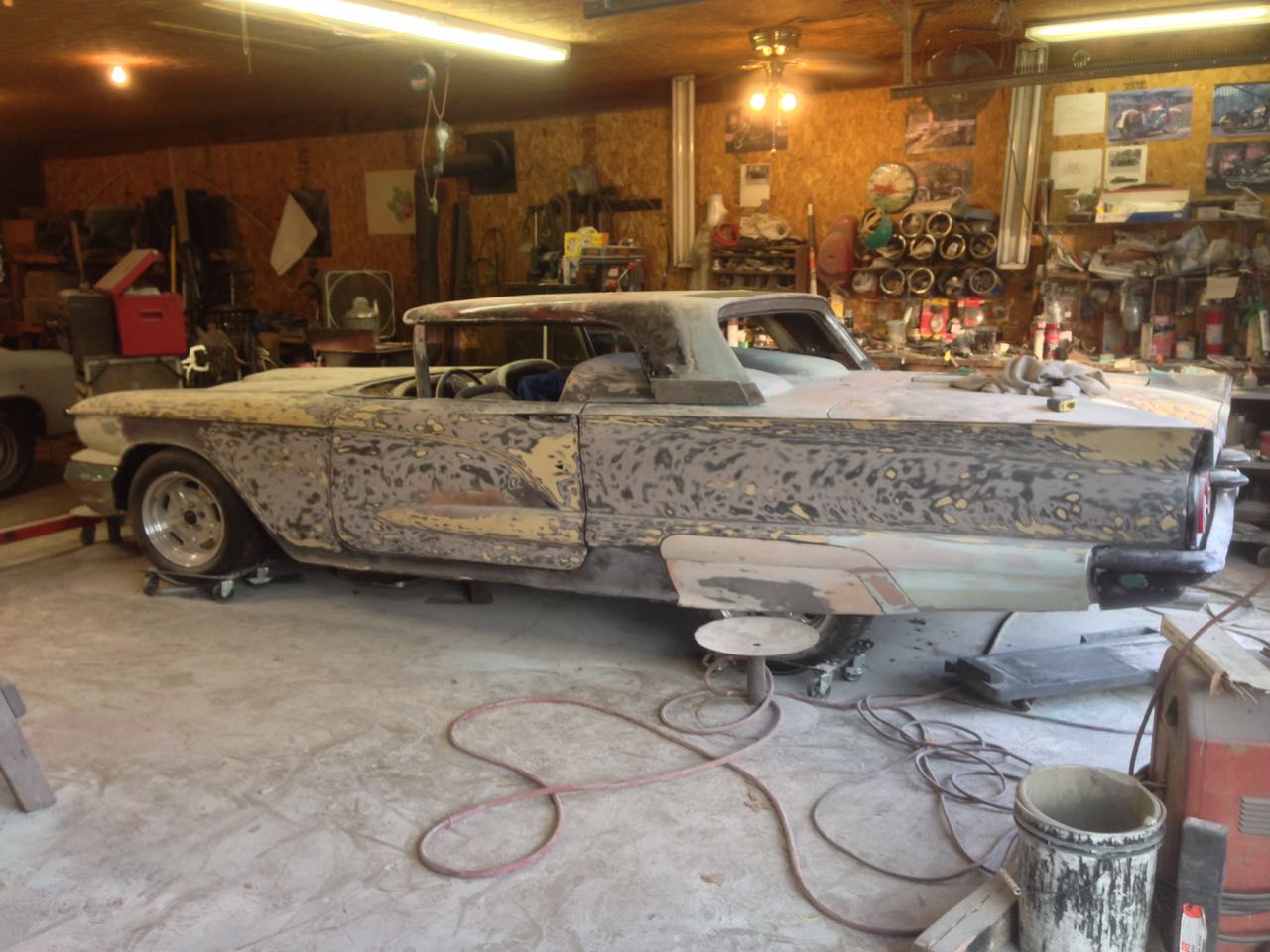

    Actually, the secondary skirt does carry the rocker panel flair about a third of the way back, then it fades away and the bottom of the skirt tucks under and flows into the body line back of the wheel cut out. The quarters are cut to carry the "torpedo" line from the door all the way back to the bumper, which was also sectioned to keep that same line into the bumperette (which may indeed get chromed ;-) IMG_0701.jpg IMG_0702.jpg

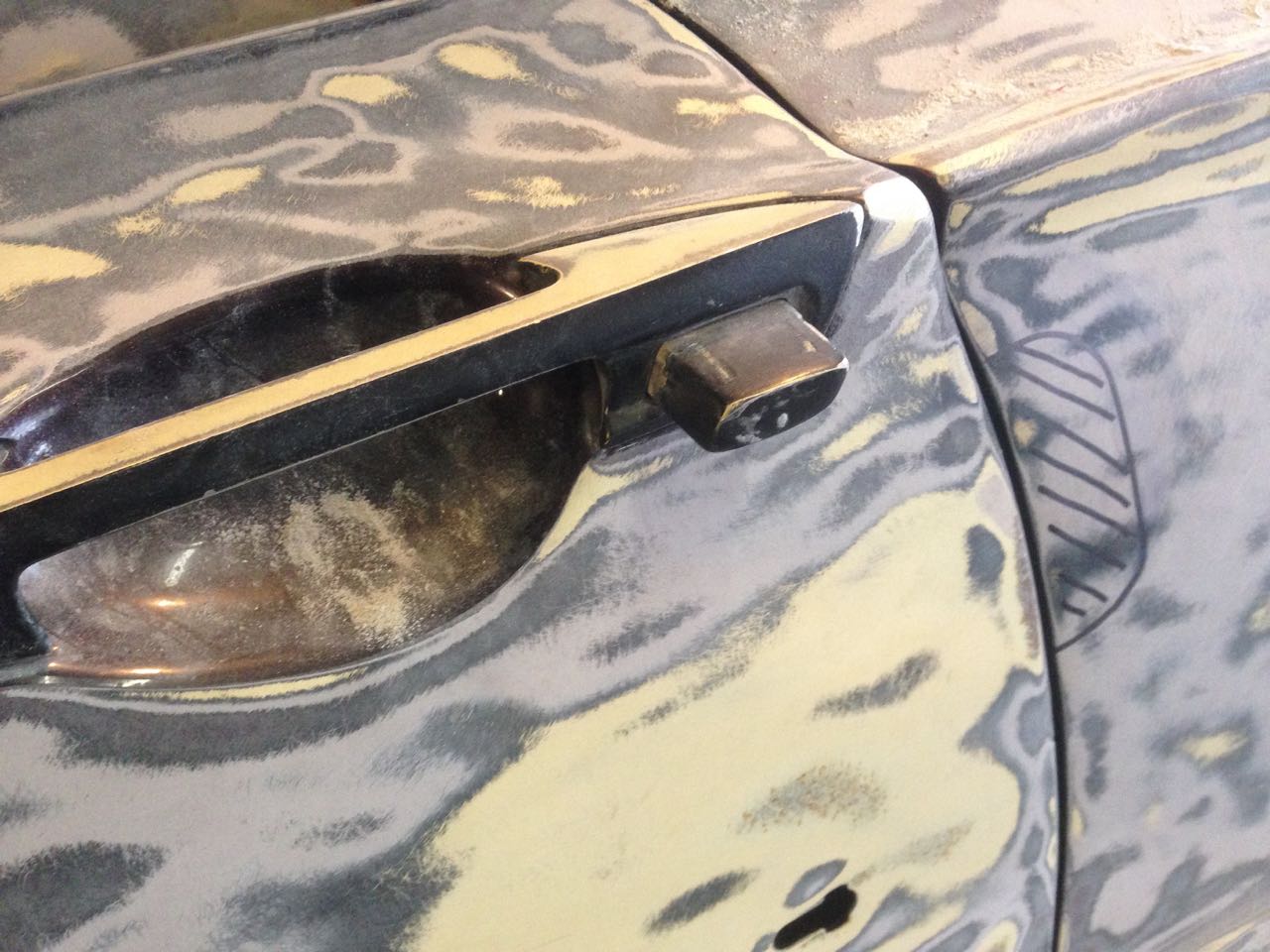

    Shaved the door handle from the p***enger door today. The door latch has a second "finger" 3 inches above the lock which will be perfect for the Lincoln ****ons. I drilled a little and am using an awl until they come.

    The Lincoln door ****ons came and work perfectly! Fitting them was super easy, just a hole in the the door skin and they fit and worked perfect with no fussing or fabricating. The doors pop open on release to the safety catch, then ther's plenty of room to get a finger behind the door and pull it open . I couldn't be more happy with them!
