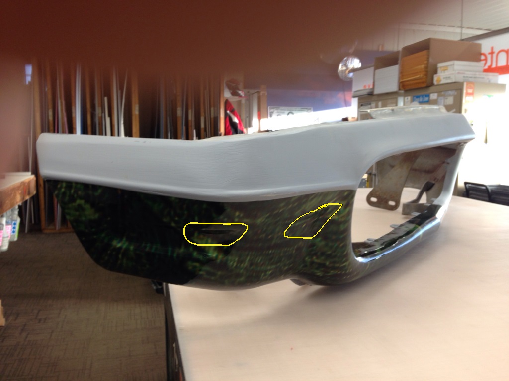

    My initial enthusiasm is fading now as the trial wrap is lifting and blistered in the concave areas. Sigh... ImageUploadedByH.A.M.B.1444834344.456868.jpg

    Maybe a coat of topcoat paint that is really smooth will help adhesion?
  26. Brian, is it lifting in the circled areas (and possibly right below the left one)? I'm guessing this picture was shot at the Vinyl shop, and it looks like it might not have ever been adhered properly in these areas. I kinda agree with Alchemy, if there were sanding scratches on the lower part like there were on the upper part, the introduced air could have caused the lifting as well. Did they (or can they) use a heat gun to get a little extra stretch in those sharp inside corners and curves? Brian bumper.jpg

    So, what's been happening? Big fat NOTHING. Had a right hip replacement last week, am doing great but I can't get around without a cane, which makes it impossible to get out in the garage and actually DO anything. I peeled the vinyl wrap off, and am probably going to have them sprayed, as the car really won't be out in the weather much. My buddy Jake Moomey's '54 Chev has the faux chrome on bumpers and trim, after 10 years, it's showing it's age, but after 10 years with my '51 wagon, the rechromed grill and bumpers have issues as well. Hopefully in a couple weeks I can get back to work on this, the '63 Rivi, the '47 Spartan, and the '34 roadster.

    Yes, exactly. All the above. It would probably adhere fine completely prepped, but there'd still have to be seams, the wrap just won't stretch around all those tight curves.
