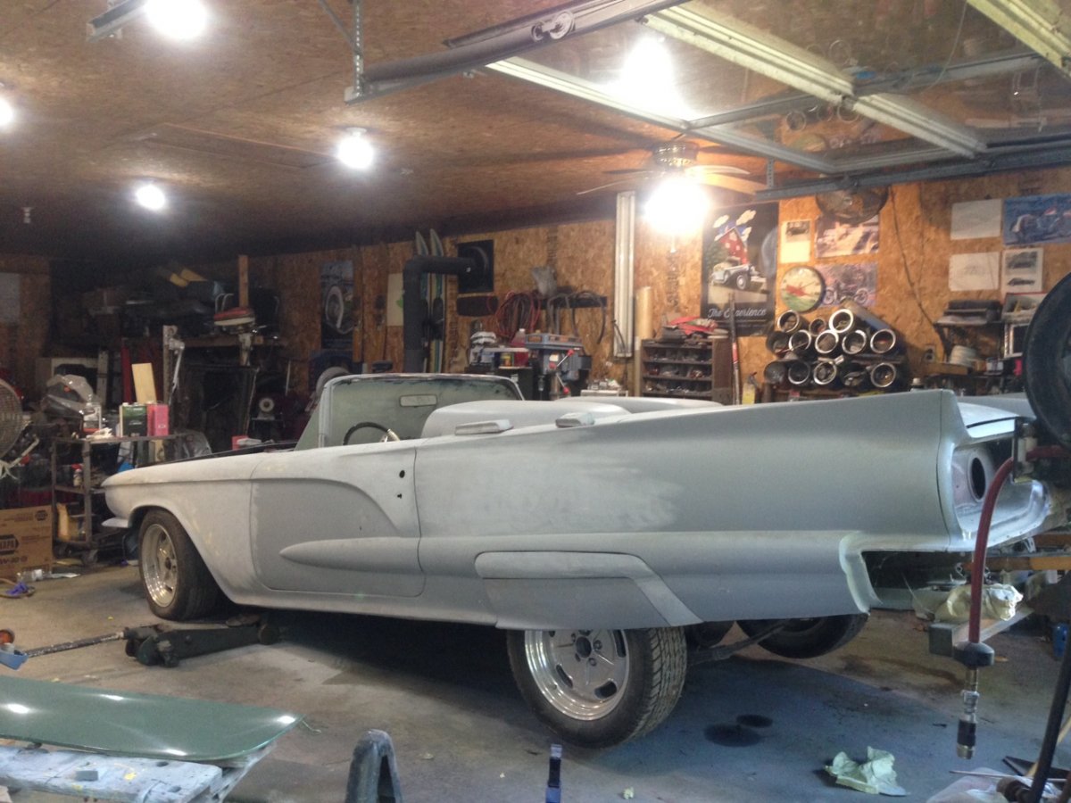

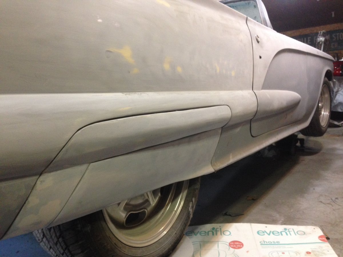

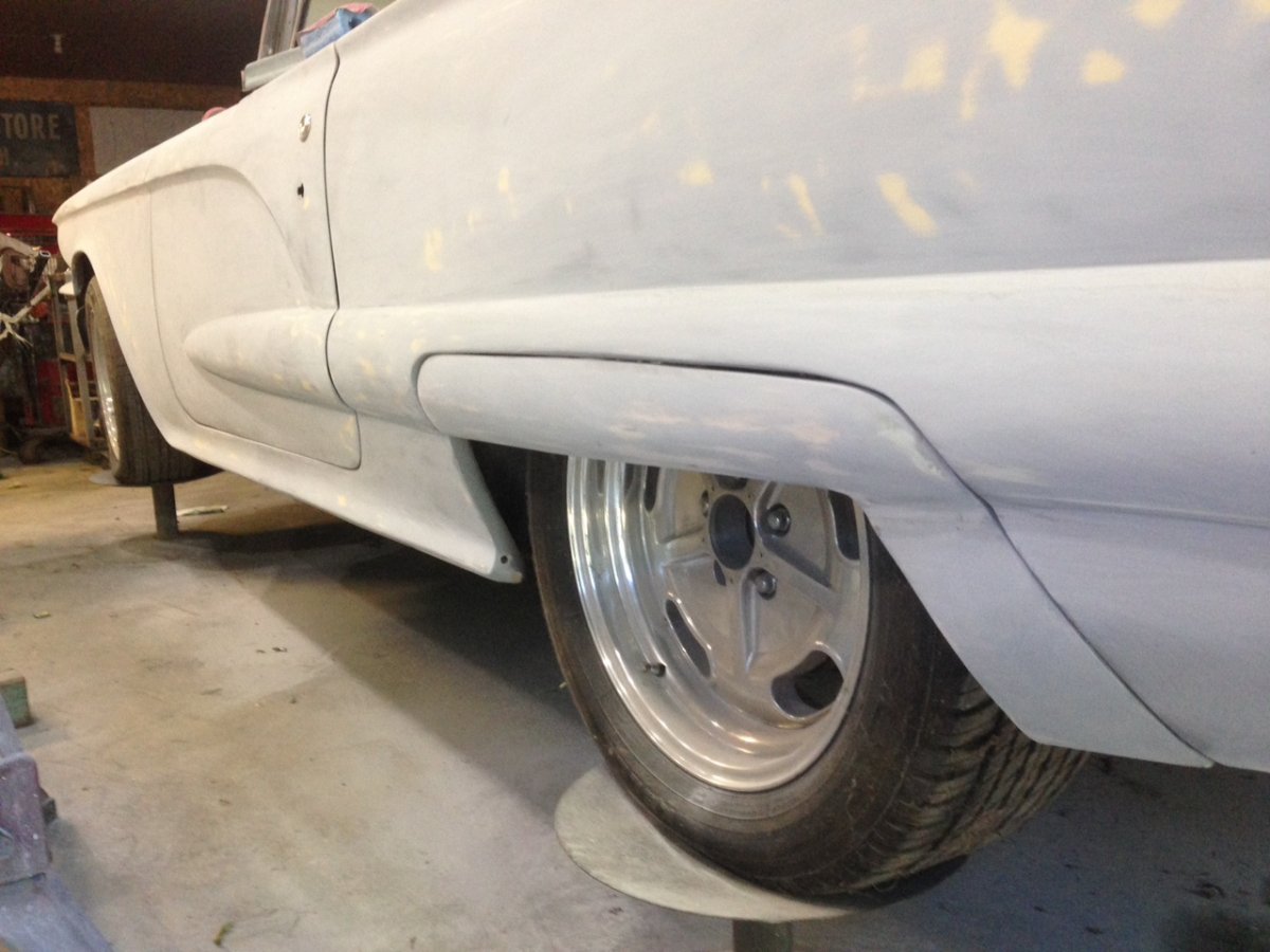

    Full skirt for those times when modesty is in order, mini skirt for going out in go-go boots and a rabbit fur jacket.
    I spent all day finishing up the first go-round of blocking, and finding several spots that needed more work. I guess after 12 years there's no point in leaving things not perfect. [emoji6]

    Thanks! I'm sure you appreciate the time spent getting them this tight. The bumpers now fit the same way, no small feat on a Squarebird...

    Looking good. I wondered about the parting lines on the skirts? Thanks for splaining the difference between the two.

    I kinda think I'd been better off welding the primary skit to the quarter panel, visually. It would make tire change a big challenge though, and it does have to function as a car.

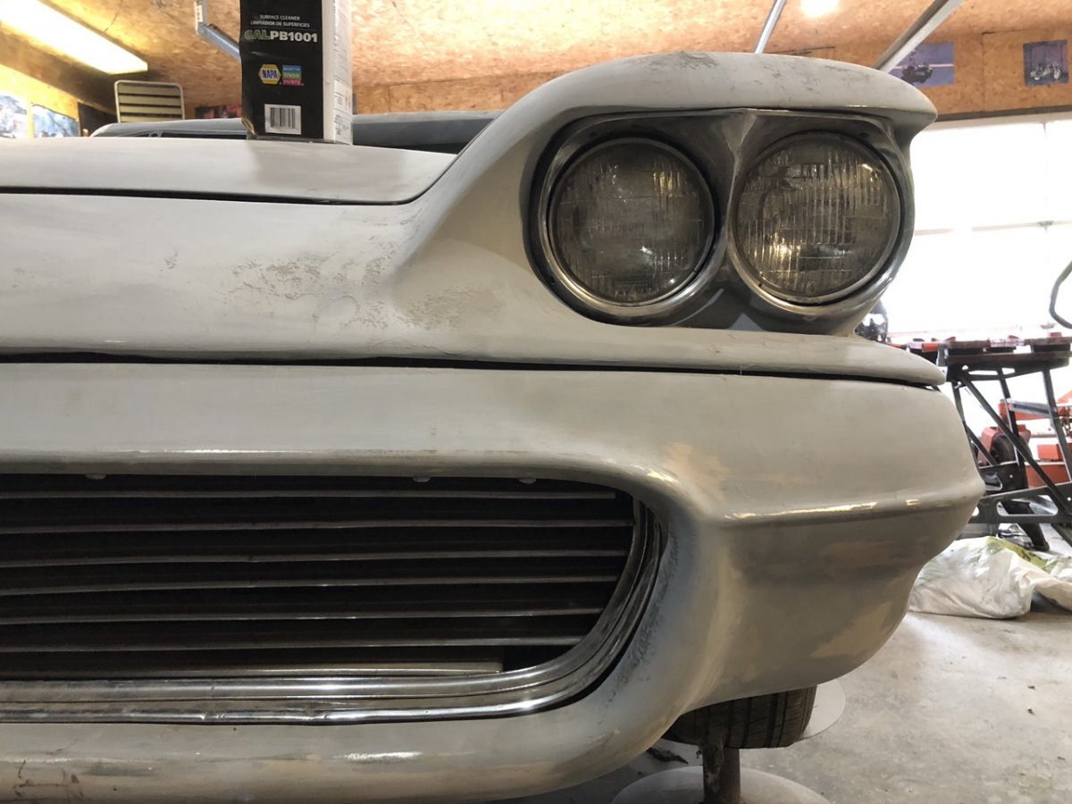

  24. flynbrian48
    Joined: Mar 10, 2008
    Posts: 8,730
    flynbrian48
  25. flynbrian48
    Posts: 8,730
    flynbrian48
  26. flynbrian48
    Posts: 8,730
    flynbrian48
    Getting a little time in on the ‘bird. One more round of blocking, then wet sand and some color. At least the dash and door jambs before cold.

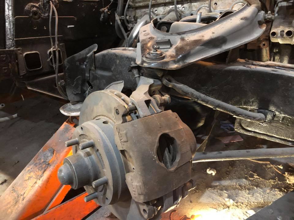

    So, true to form for me, I've quit working on the 'bird because it's now to cold for me to (safely) paint in my shop with a wood stove for heat, so I put disk brakes on the '63 Riviera project. Sigh. Leaving the hood shut will hide the, ahem, non-traditional engine, and with the bags aired out and rocker panels setting on the ground, it's too low to see underneath. Winning. I want to get the T'birds dash painted at the very least so I can put that in and get the wiring finished up during the winter. 43629502_10218308707611711_3582211649253146624_n.jpg View attachment 4074955
