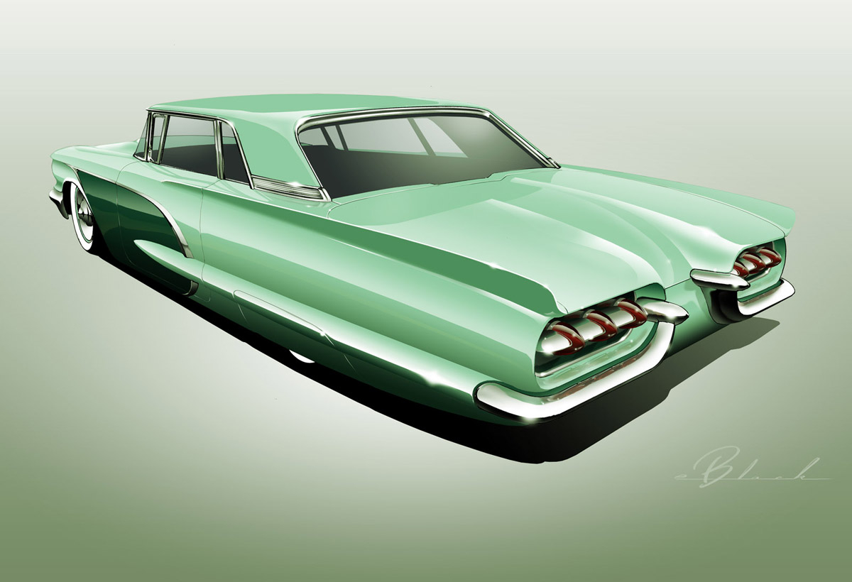

    So if you carry that spear/projectile all the way back to the bumper and tuck the lower part of the quarter as shown in Mr. Black's rendering would you modify the rear bumper accordingly? Would you also get rid of the flare on the rocker panel as in the rendering? Does seem like it might need an appropriately modified version of the stock skirt at the very least. Full skirts are definitely going to look goofy with the current stance and wheel choice.
    Personally I really like the close-coupled-chopped-Sports Roadster-with-lift-off-top you've got going now. Really refines and brings out a racy, rakish aspect of the Squarebird that's likely to get lost swinging toward the ground-hugging custom cruiser look of the "Hirohata Bird."

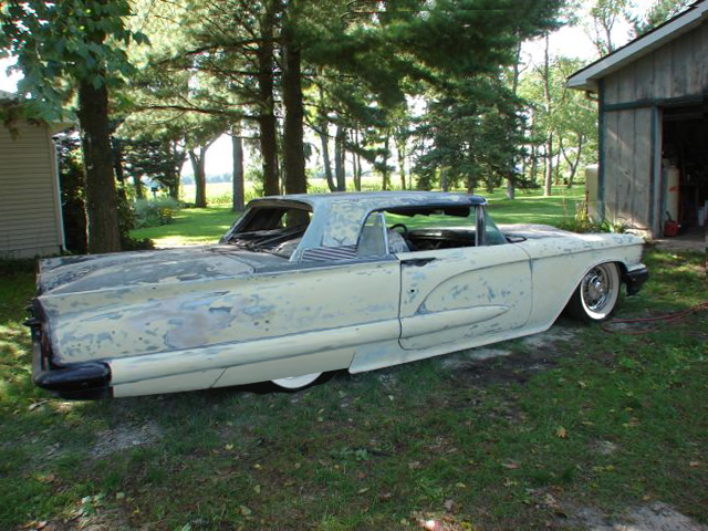

    I say go for it.
    Car is looking GREAT! But to be honest I'm not too keen on your current wheel choice. Not that it matters a bit.

    We should ask Eric if there was a rear view rendering done. Looking at the drawing he has the bottom of the spear carrying into the bumper but has the rear quarter and bottom of the bumper welded together and painted. If you smooth out the bumper bolts on the rear bumper and paint the lower middle section (bumper is 3 pieces) it looks like a roll pan. In writing it sounds odd, but actually looks good (pic attached). Ive been considering this on mine (painting the lower bumper) but leaving the rear quarters as is.

    The rear bumper, regardless of whether I pull the spear all the way back is getting cut up and tucked closer to the body. An inch needs to come out of each bumperette, and a like amount from the lower pan. If I cut the quarters, the lower part, where the outer skin meets the inner panel, will stay where it is, with the outer skin being "rolled" in tighter. The spear then would get a little extension to make it (more or less) match the front part, ahead of the wheel. The bumpers lower pan would get a little extra trimmed out, and the edge rolled a little more to match the new profile of the lower quarter. The little "lip" at the bottom of the rockers I'm keeping. Eric's drawing gives the body more of a "coke-bottle" look than they have in person, I don't know if I like that with the way I'm going with the car. Plus, it would mean a complete re-do of the rockers on my car, and they're perfect now. I sort of like the lip anyway.
    I agree that skirts don't fit the current "sports coupe" theme, I was going more of a Bonneville look. Hence the Salt Flats. I thought if I do this (extend the spears), that I'd pull the top of the wheel opening down to the bottom of the spear, and form a skirt to fit below that, that I could remove depending on my mood. A simple wheel/tire change then would take the car from the luxo-cruiser look of the Hirohata 'Bird, to the performance sports look. You're point about the stance, now nose down and rear lowered 2" from stock, would also have to change to more of a taildragger, and I'm not anxious to bag the car to accomplish that, or change the stainless steel exhaust system now under it.

    Here's the rear 3/4 artwork. As you note, he illustrates it with MUCH work done to the bottoms of the quarters, it looks like they're pulled up towards the rear, and the rear pan would be thinned to match this new line. The car Hollywood Hot Rods is building (shown in Street Rodder last issue) is done this way, but with the rear pan completely eliminated and the lower line of the quarter pulled up to the bottom of the bumperettes. Not sure if I like it, even on somebody else's car, but there isn't a very good photo of it in the feature.

    I did it. Cut the quarter panel behind the wheel. Tomorrow, I'll make new lower quarters with the spear shape in 'em. Sorry guys, I like the wheels, they're staying. A set of polished 5 spokes, or some wires and WW's might make a good alternate wheel/tire combo.

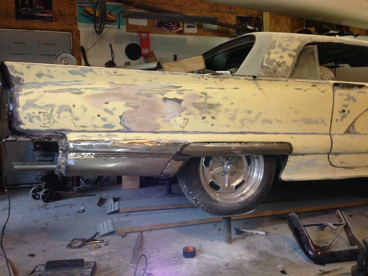

    Well, I did it. Yesterday I made a single cut through the quarter skin behind wheel, figuring if I chickened out, I'd just weld it back together. Today, I cut it completely off, inner fender and all, and made the new "spear" with my buddies 8' brake. The brake leaves a small crease it's true, and it's SOOO easy to go a little to far, each little bend adding up to to tight a roll, but I got it.
    A little t******* and fitting got that on, and I decided to make a complete new skin and inner panel for that part of the quarter, as I'd made patch panels before, and there was quite a lot of filler. I'm a little better builder now, so those had to go.
    The s**** of the roll section makes a perfect skirt, which I trimmed and mocked up as well. I like the short skirt, as opposed to a full skirt, particularly with the wheels, which are staying. Unless somebody wants to donate some polished 5 spoke Supremes, or a set of T'Bird wires.
    So, one side (almost) done. Inner panel tomorrow, and finish up the skirt and make mount pins for that.
    Edit: I'm looking at the picture with the skirt on, and wonder if it needs a little filler panel at the back, to tighten the opening up around the tire?

  15. flynbrian48
    Joined: Mar 10, 2008
    Posts: 8,791
    flynbrian48
    Here is the skirt, with it's own "skirt" added to the rear. It looks much better this way. Now, to finish the inner fender, and make some kind of mount tabs for the skirts. Spring loaded pins? Simple barrel bolts and a center pin? Tabs and bolts? I think the wheel will come off even with the skirt on, so bolts would be easy.

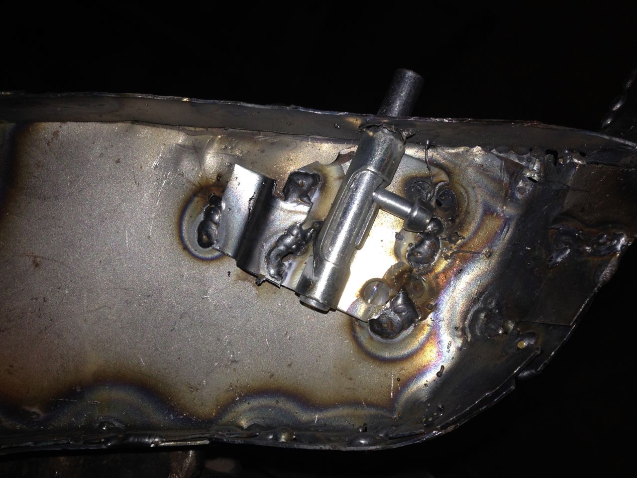

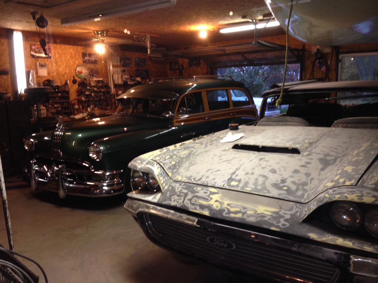

    flynbrian48

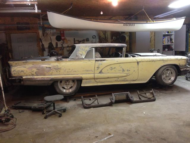

    Right side, with the exception of a lip on the bottom of the skirt, and a skim of filler, is done. In a moment of inspiration, I decided to use a pair of barrel bolts from the hardware store as latches for the skirts, they worked perfectly. A 5/16 bolt with a point ground on the end is a locater in on the top, the barrel bolts hold the sides on. Done.
    Couldn't resist a shot of the interior of Cool McCool's Garage, with the wagon parked next to the evolving T'Bird. Garage full of cool!

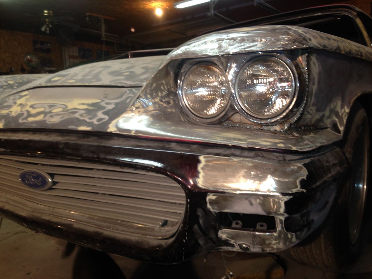

    flynbrian48
    I got the left side headlight done, using the Caddy bucket and die cast bezel. I THOUGHT I was done, but looking at the photos just now from my blog, I don't really like the way the fender doesn't follow the curve of the bezel exactly. The center does, and I tucked the lower part of the fender around a little, to match the overhang at the top, but it's not right. So, tomorrow, we slice and dice, and make it fit better...

    flynbrian48
    Doing the headlights yesterday was so much fun, today I did them all over! Looking at the photos I took, I didn't like the poor fit of the bezel to the fender, so I cut everything apart and did it all over, with more roll top and bottom to fit the relatively flat T'bird fender to the round Caddy headlight bezel. Much better. I may not be a very good welder, but I AM a good grinder!
  21. clean cut creations
    Joined: Feb 8, 2005
    Posts: 1,352
    clean cut creations
    The fender flows better with the roll in it at the trim ring. Good eye!

    flynbrian48
    Thanks guys. The right side would have easier if the fender hadn't been repaired at some point by brazing the front section of another fender on it, over the original, mangled eyebrow, and seriously tweaked. I didn't fix that the first time around, but I did this time.
    I'm kinda proud of the barrel bolt latches too!
