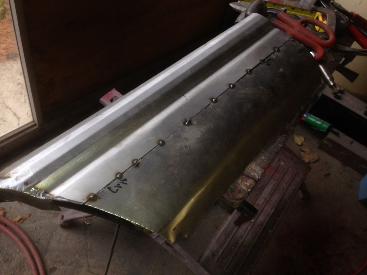

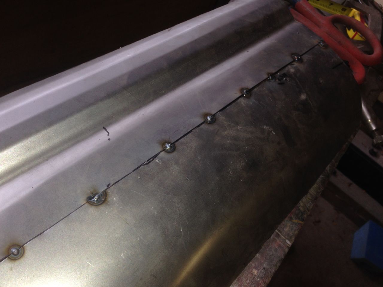

    Got the left quarter panel roughed in, so both sides are now the same. I have got finish the skirt and make the new inner fender panel, but it's looking good. Next project is to tuck the rear bumper in to better fit the body, and new body lines, so that'll be fun. I've soaked the bolts that hold it all together with WD-40, and Thursday, my next day off, I'll take the rear bumper apart and fit it to the body.
    Stay tuned. For more detailed pictures and commentary, just click on the link below and go to "Cool McCool's Garage".

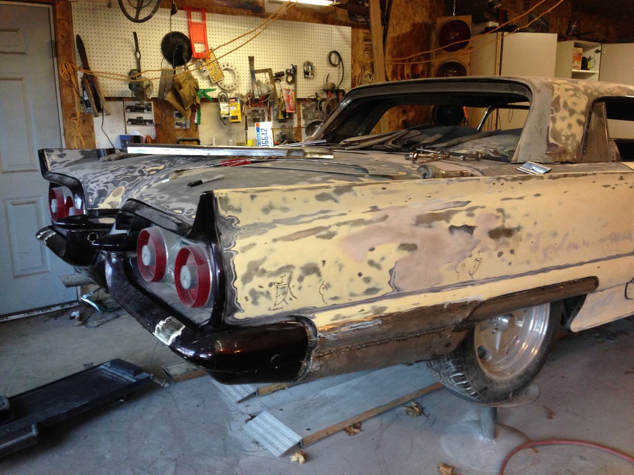

    Started the "nip-tuck" of the rear bumper today. I like the results, it'll be worth cutting the bumper up into pieces to make it actually fit the body. I took almost 3" out of the lower pan, and 5/8" off each bumperette to pull them in tighter to the body.
    Here's the result.
    Now, do I chrome the bumpettes, or just the dagmars? Lot's of early customs utilize rolled pans front and rear, my feeling is the front bumper, and rear bumper pan are integral parts of the styling of the body. Painting them will continue this integration.
    Just doing the dagmars at the rear would give a little "bling", and still keep the bumpers part of the body, not an add on. We'll see...

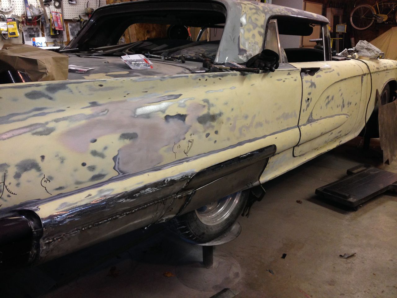

    Still fitting the rear bumper. Evidently, when you cut a bumper into 7 pieces, it may be difficult to get it all lined up exactly correctly and welded back together. Who'd think?
    Nevertheless, I'm happy with how it's going, even though it's taking much longer than I thought it would. I've got to tuck the right hand lower pan in a half inch more where it meets the new character line on the fender, but that should be easy compared tdo the rest of the job.
    The last few photos look pretty much the same, not really showing the hours of work involved in this project, and the hours yet to come to finish. Hopefully, once this bumper fit is over, the metal finishing and body filler part of the job will show a bit more dramatic changes.

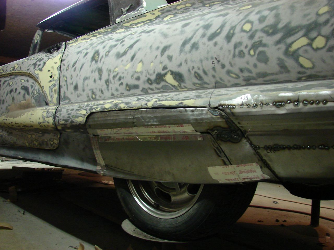

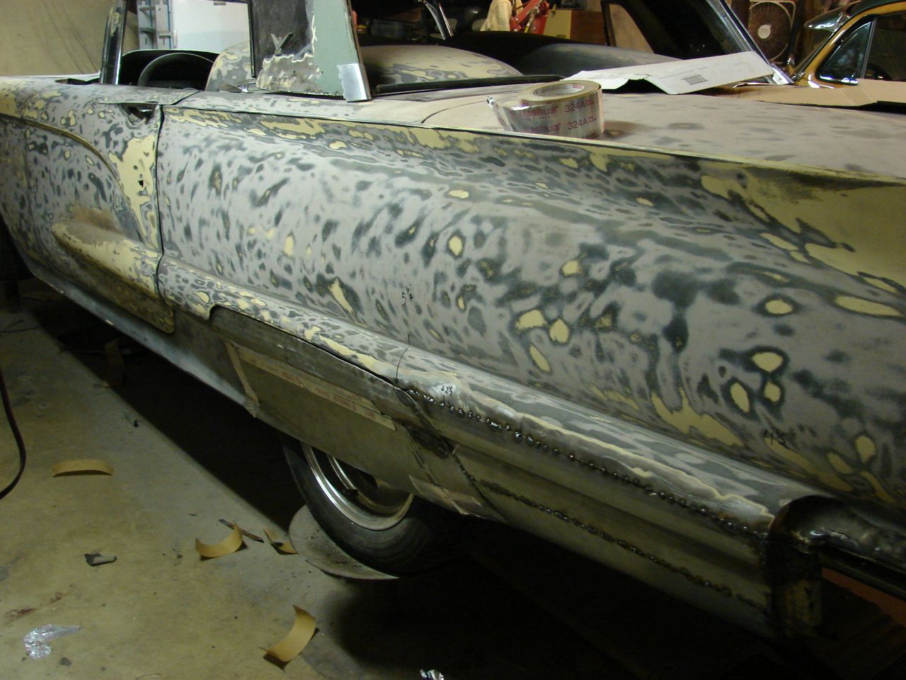

    The image with the full skirts has been burning a hole in my brain, so today I got busy and made a secondary skirt for the right side (the side not jammed up against the bench!). I have to admit, it looks awesome, so I'll finish up the metalwork tomorrow and make the latches for it. It'll mount to the tail of the primary skirt with a barrel bolt, a pin in the center, and another pin in front into the wheel lip of the body.
    I decided to match the flare on the rocker on the skirt, which would have been easier if my metal working tools included more than a bench vice, a stump under the bench, an anvil made of a piece of railroad track, and a few body hammers and dollies. In spite of the lack of equipment, I think it turned out pretty nice.
    Now, I'll be on the hunt for another set of wheels and tires. Chromed Supremes? Wires? Steel wheels and full disks hubcaps?
    Edit: If it looks like it doesn't fit the primary skirt well at the top/rear, it's because I just clamped in up with Vice-Grips to take a photo in the dark. It fits fine, and will once the latches are fitted. And a little more metal work.
    Weedburner 40 likes this.

    Here are some better pictures, after fitting the secondary skirt, making latches and hanging it all together. In the daylight, it looks lots better!

    As for wheels, the ones I put in the photoshop are Chrysler wire wheels which share a bolt pattern with Ford cars. hint hint
    I'm really enjoying the progress on this one.

    Thanks a lot Gotgas, that's only gonna cost another 2 grand! I'm sort of proud of the character line I did on the skirt,the real challenge will be making the left one match. Or, match close enough to be on the other side of the car…
    Brian

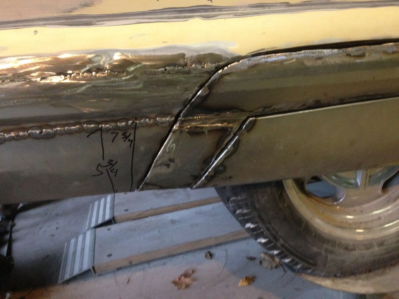

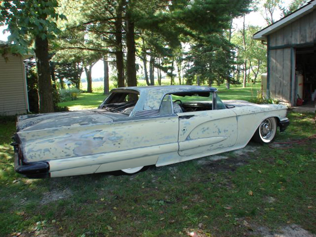

    So, after a little hiatus from the 'Bird to split up the wood needed to heat the shop this winter, next winter, and the winter after that, I got a little done on the fender skirt project today.
    I wasn't happy at all with the way the bottom of the right side skirt fit the body, the roll was wrong, and it didn't match the quarter. Out with cutoff tool, and a little work with hammer and dolly, it's all better. I also hammered a little lip on the flange of the primary skirt for the secondary one to rest against. A little rubber on the skirt face will keep that from rattling, and it looks more finished as well.
    Now that side is done, and I can make the one for the left side, then it's time to finish all the welds down and start some body work!
    Here's what it looks like now.

    I'm curious- why didn't you simply weld up the "bullet" (spear...???) body line and move the skirt to the bottom of that body line instead of going to all the trouble of making the skirt fit halfway into the bullet (spear) body line...??? Wouldn't that have been a lot cleaner...and a lot less work...???

    I did think of doing that, but I was concerned about getting a tire up and under the fender with the wheel opening dropped that far. Maybe stockers would have, but the Salt Flats and big 17" tires on it now would have been a little sketchy along side of the road in the dark if we have tire trouble. That's the way the stockers fit, and honestly, I sort of like keeping that part looking "stock", in the much reworked quarters. In addition, I already had the skirts made in the fashion of the originals. Add to that the extra work of cutting the lip off the wheel opening, making a new section of quarter panel to fill the void, all the work on the inner fenders, and I think it's about a wash. I admit that the extra line between the at the tail end is sort of "odd" looking, but I think once it's all painted, it'll go un- noticed. I got the left one almost done today, and ended up having to cut the primary skirt apart to fit it better to the body. With the latches in, it was twisted a bit, and didn't fit the fender opening just right. So that took awhile, but making the secondary skirt went fast. Just need a couple more barrel bolts for latches for it and we'll call that part "done".

    Here's the left side skirt. Excuse the aluminum tape (temporarily) holding the secondary skirt on, I need to get another pair of barrel bolts for latches.
