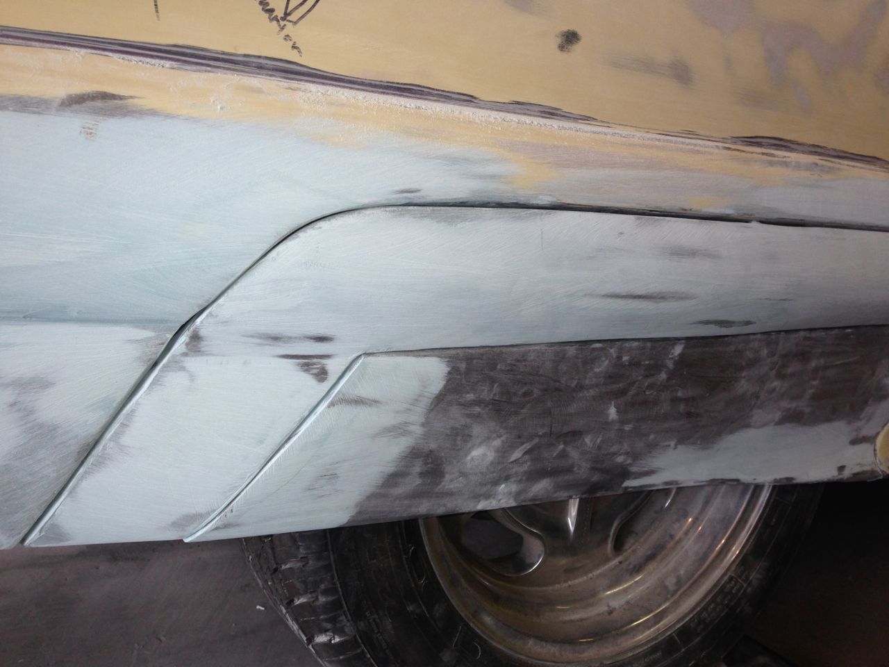

    flynbrian48
    Forgive the "tutti-fruity" look of the mulit-colors of primer, long-strand filler, and top-coat filler. This side needs just a little finesse around the rear bumper notch and the secondary skirt. Then, on the left side and bumpers.
  3. ya know those wheels aren't quite so bad, I kinda dig em' and you wanna have a later style wheels on a thunderbird, cause they were ahead of their time. don't give up and let the mud fly!

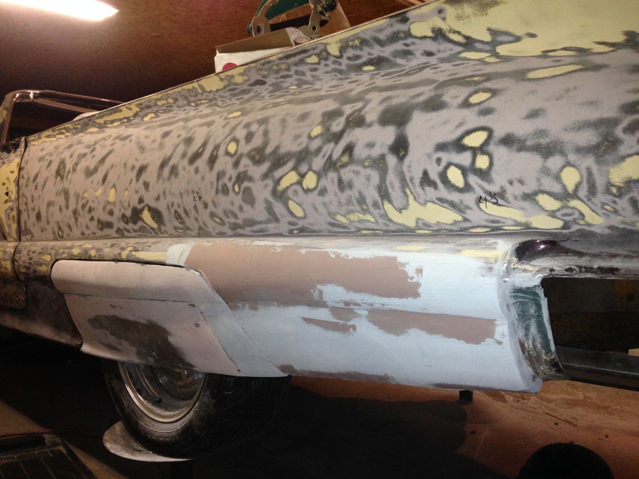

    flynbrian48
    Worked on the 'Bird all afternoon, once the shop got warm enough! It's at the "hard to see progress stage, getting the fit of the skirts perfect (or, as perfect as I can get them), and blocking filler.
    The wood stove is stoked up now, I've had a couple cups of coffee, and the sun is out, so the shop will be warm enough to work in a few minutes. Until then, here's a look at yesterdays "finished" right side fender and skirt. Well, almost finished… The gaps are good now, and just a couple little spots to work out.

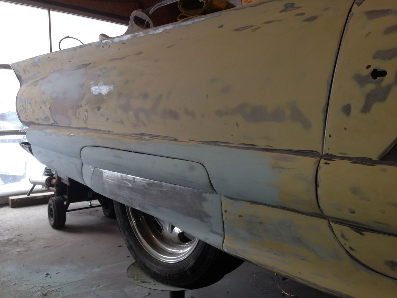

    Finally, after todays work I can see some progress. If I had no self respect or ambition, I could, with about half an hour of blocking, have the car "ready" for a coat of high build, follow up with some flat black and call it done. ;) with a couple days of work, have it ready for a couple coats of high build, block it out, prime it again and squirt it silver, like the plan.
    Here's where I am now…

    That last picture really illustrates the changes you made Brian. It really looks good!

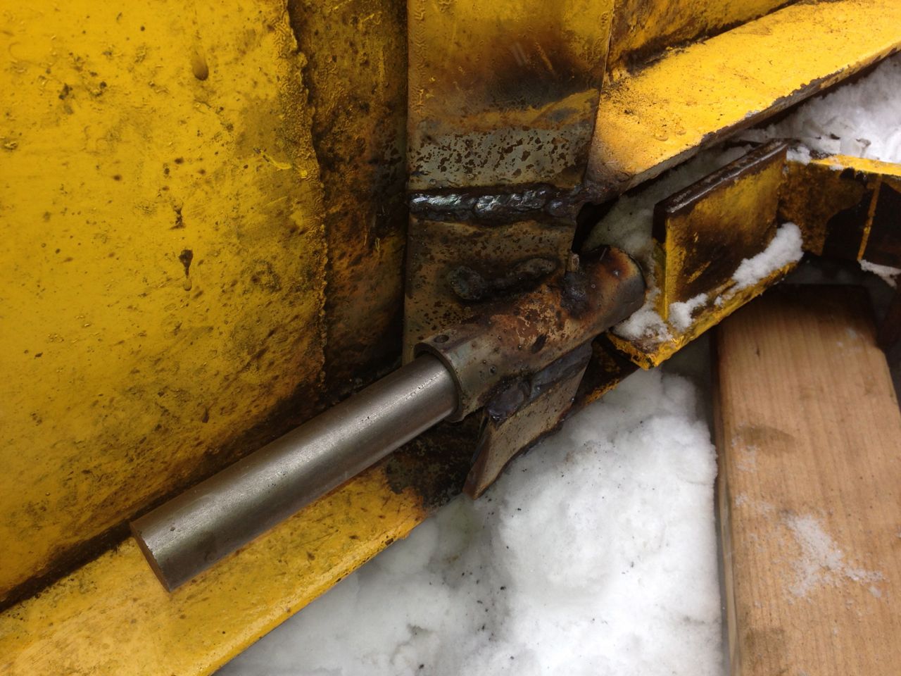

    I'm going to try to work on it today. I got some steel to use to reshape the upper lip the other day, some new cut off wheels, so I can get busy. In between plowing my drive, my folks, my neighbors, my in-laws, and figuring out why the bird bath froze over.
    Like lots of guys before me with snowplows, I'm learning it's not a low maintenance possession! Rust NEVER sleeps. :eek:
