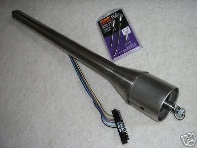

    Sorry to have missed ya! You, and the sea of public opinion against the thick Mustang column has convinced me, today I decided to go with a new, shorty column. I researched the Mustang harness wiring diagrams, ignition pin outs, intstrument panel pin outs, and I think it'll be pretty easy. After all, I made my own harness for the LS in the Diamond T, how hard could it be to wire in a different ignition switch and turn signals, right?
    So, chrome, brushed stainless, or painted?

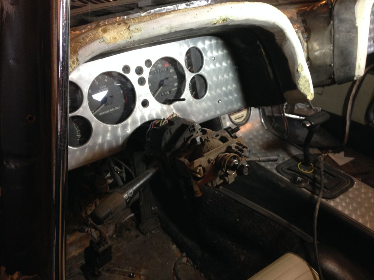

    FlynBrian suc***bs to peer pressure. Goodbye, 80's Mustang steering wheel! Goodbye ugly steering column with unused swathes, clunky jacket and wrong vibe! Hello big expense for stuff I already had, and worked fine, :rolleyes:but prettier…

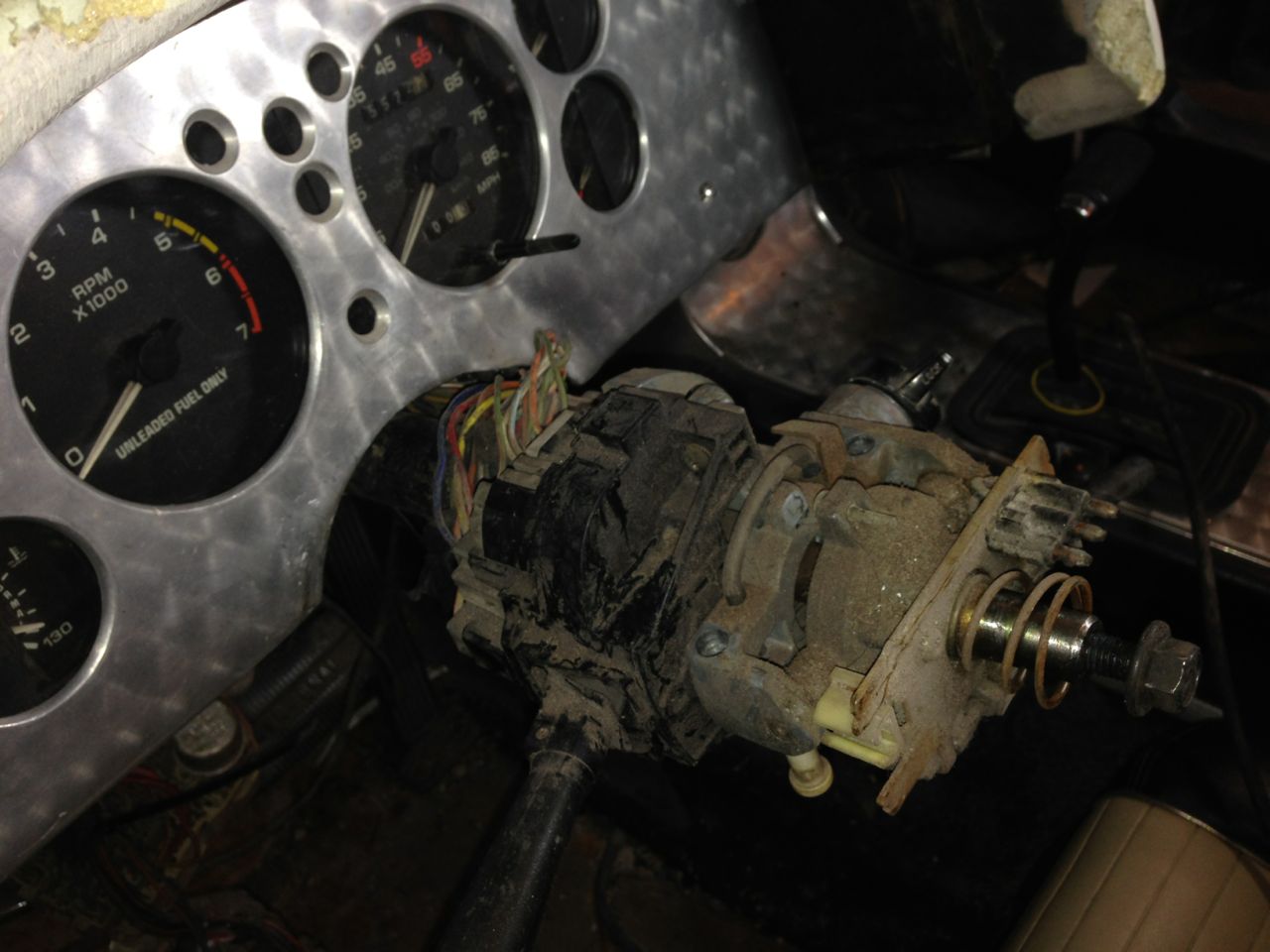

    I'm leaving the column if for now until the new stuff comes, because I'll need to sort out the wiring for the dimmer, turn signals, and cruise. Looks like I can keep the cruise, I'll add wire, and put the switches in the console.

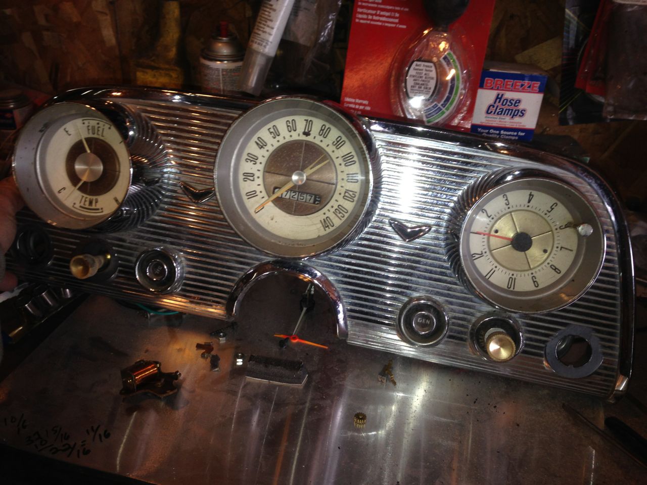

    The 80's called, and wanted their dashboard back. The original '59 gauge panel and glove box door are back in, along with a new white face tack where the clock was, and a 3 gauge trio.
    Now, you'll have to wait to see the new wheel, but it's being made right now, and will ship next week, so we'll soon get to see the whole "new" package.
    I fired the car up to make sure the new ignition switch worked, and everything was fine. I need to figure out the GM style plug on the column, and how to wire that into the Ford harness, but I've got the schematic for the under dash harness in the car, the switch pin-outs, and a voltmeter, so it should all work!

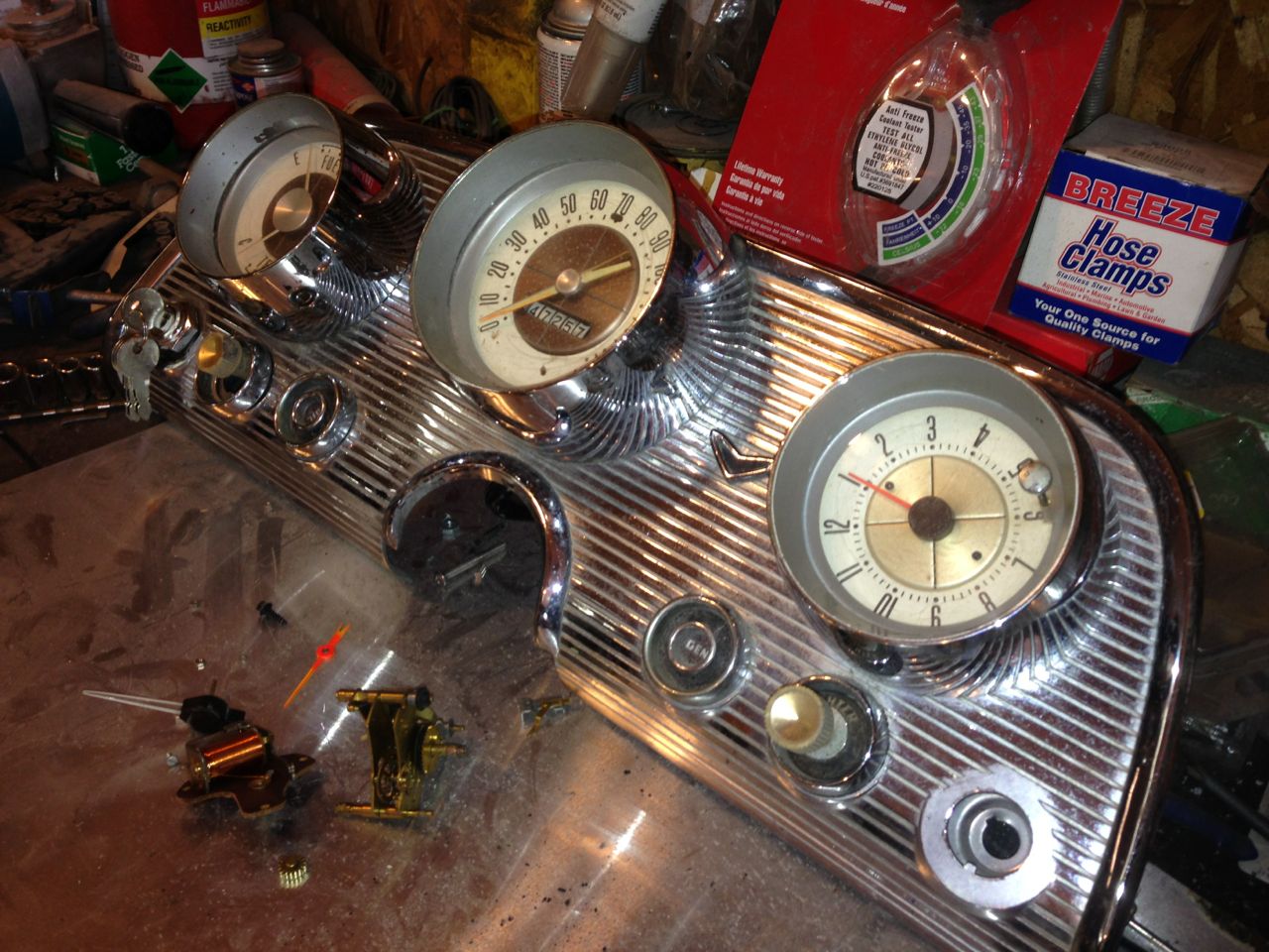

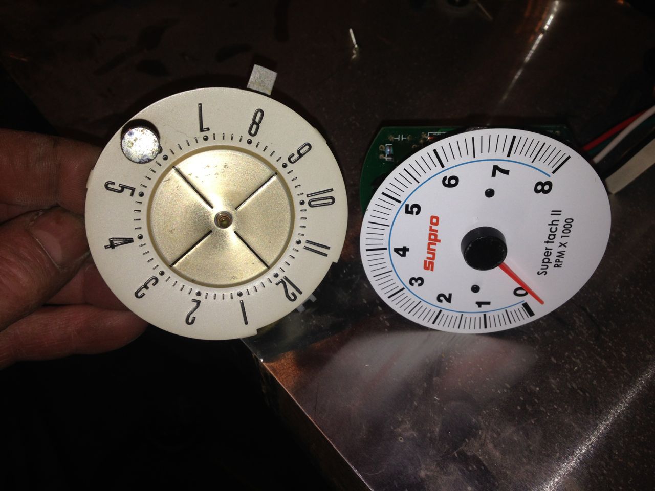

    Looking at the gauges today, the original clock and the new Sun elec. tach are the same diameter, and the spacing of the numerals is close enough that, for the cosmetic purpose of the tach, I simply mounted the tach guts on the clock face. A little work with a cut-off wheel gutted the rear face of the clock, which kept the gauge spaced perfectly from the lens. My wife pointed out that I needed to "clock" the gauge in the panel, as I couldn't let of go tach needles orientation at what would be 8 o'clock. I had rotated the face so that the 12 (the new 0 for the tach) was at the 8 spot on the dial. Which of course looked goofy. So, I fixed that, rotating the gauge in the dash so the 12 was back at 12 o'clock, and then I pulled the needle, and "clocked" it so it pointed at 12, which is now "0" for tach purposes. Anyway, it looks pretty cool, and the total investment was $30 for the Sun tach. Cool, huh?

    It looks, to me, like the needle is pointing at 1 instead of 12. Am I missing something?
    Excellent idea, by the way. I wasn't feeling the tach's original face. :cool:
  23. I'm thinking he means 1200 rpm.
  24. Odds are the tech isn't powered in that photo, and doesn't zero until it is.
  25. Peanut 1959
    Joined: Oct 11, 2008
    Posts: 2,188
    Peanut 1959
    Ahh, that makes sense. Thanks!
  26. flynbrian48
    Joined: Mar 10, 2008
    Posts: 8,693
    flynbrian48
    You're right, I ended up with the needle resting at 12:00, after realizing I'd initially put it on 1:00, forgetting that It needed to rest on zero, and there isn't a zero on a clock face! I just pulled the needle, dropped it back to the 12. That's where, on the original tach face, zero would have been, the sweep of the dials are the same (or close enough). We'll see when I fire it up with the panel installed if I need to index it a little one way or the other, but it should be close. When I loaded the photos, the thumbnails are so small it's hard to see much detail, and I missed that I didn't have the correct photo.

  27. I might be alone in this thinking, but I kinda like the clock rotated the way you had it first. Not everyone would pick up on what it is, kind of an inside joke for those in the know. The tire kickers would just think your clock is messed up.
  28. flynbrian48
    Posts: 8,693
    flynbrian48
    If it hadn't been for the numerals then being upside down, I would have. And, they're stamped into the face, not just a silk screen, so re-finishing it wouldn't have helped. I like it fine at 1200=zero, most people will not even notice there's anything awry, just a clock that's right twice a day!
    Brian
  29. ynottayblock
    Joined: Dec 23, 2005
    Posts: 1,954
    ynottayblock
    Brian, you could make a new face (white outer part) that will slide over the existing one, so you could have the correct numbers and orientation of the gauge. Wouldn't take much to whip up the artwork on a computer
