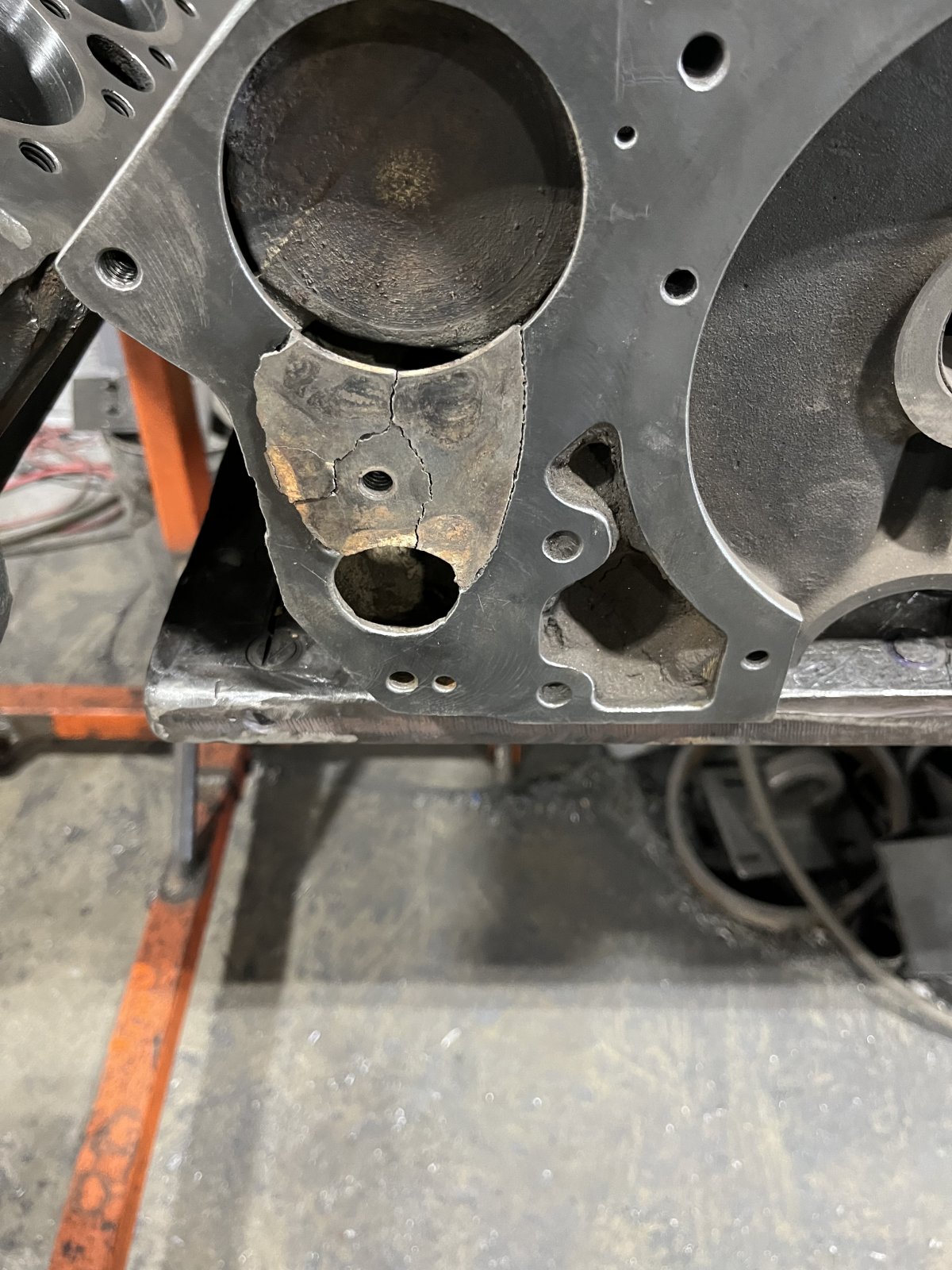

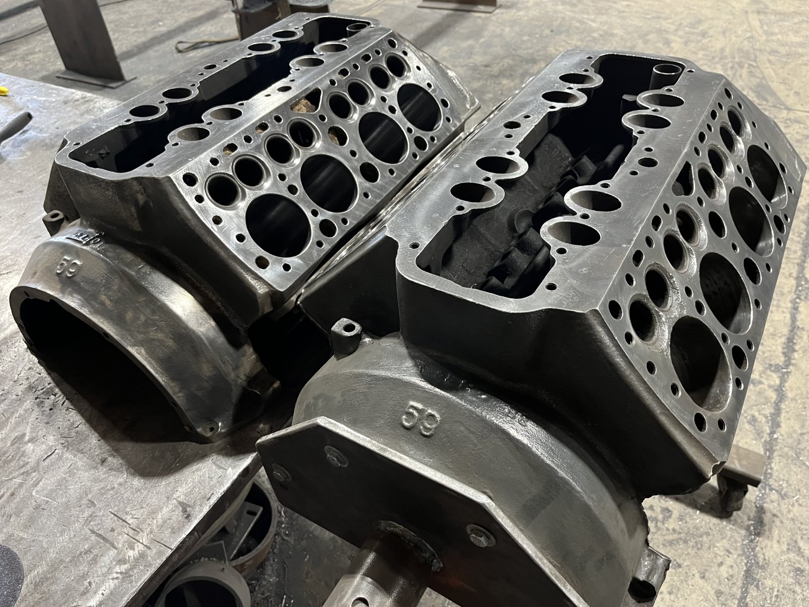

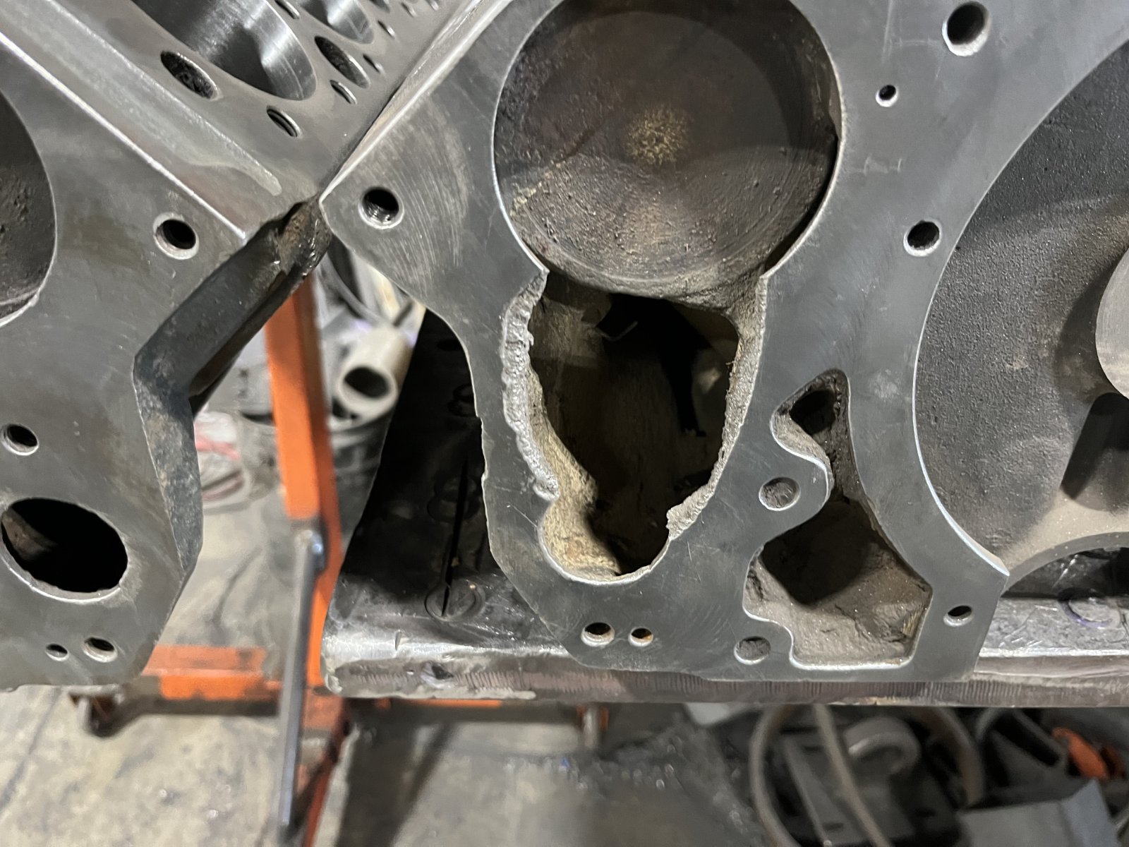

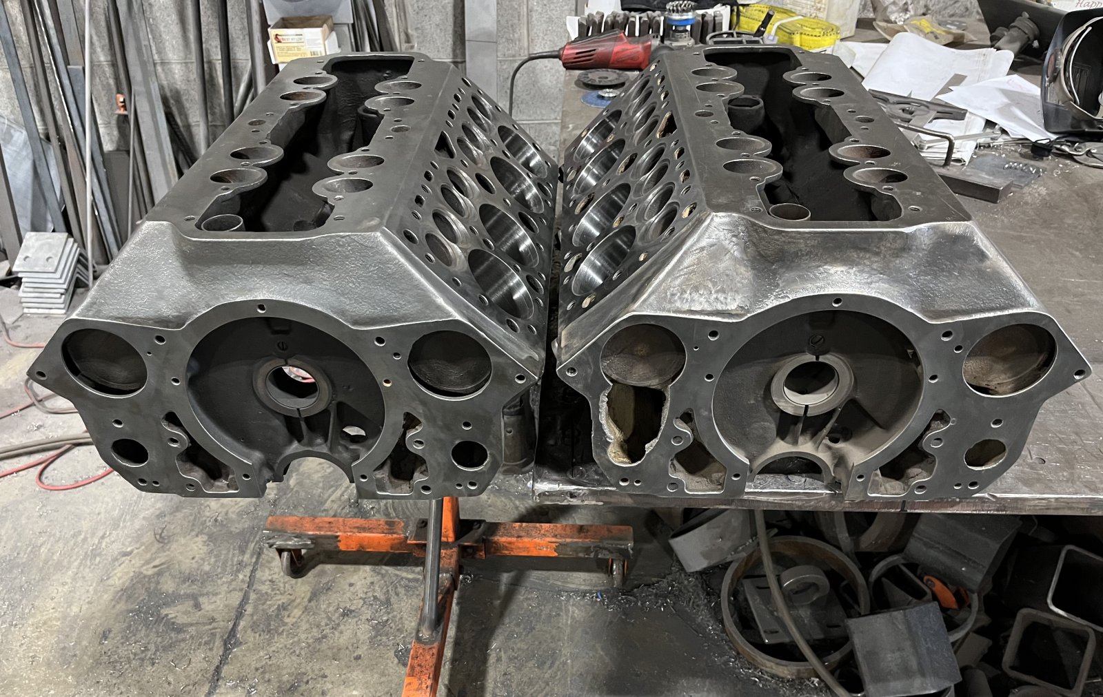

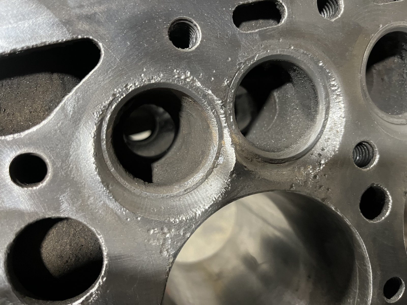

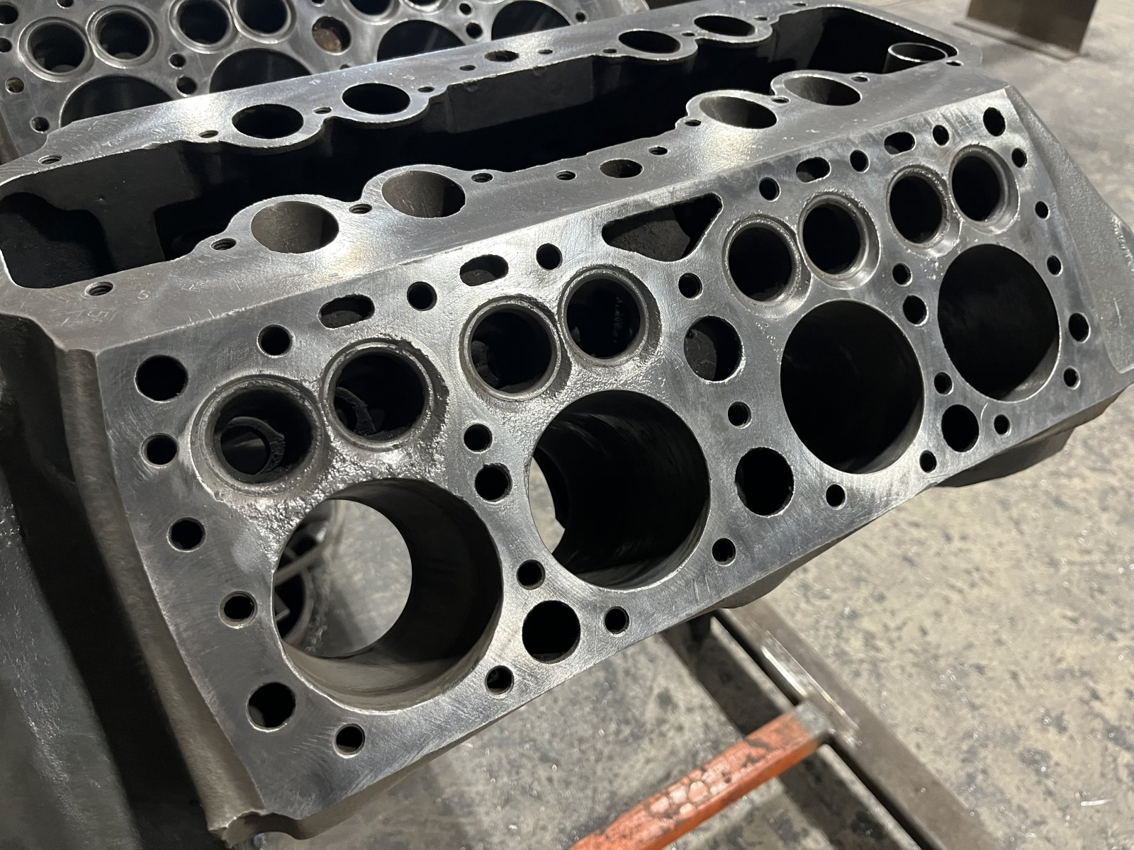

    The block on the right is perfect except it fell 4 feet to the ground and broke the water pump. When I took it apart, the block is busted between the two water p***ages.

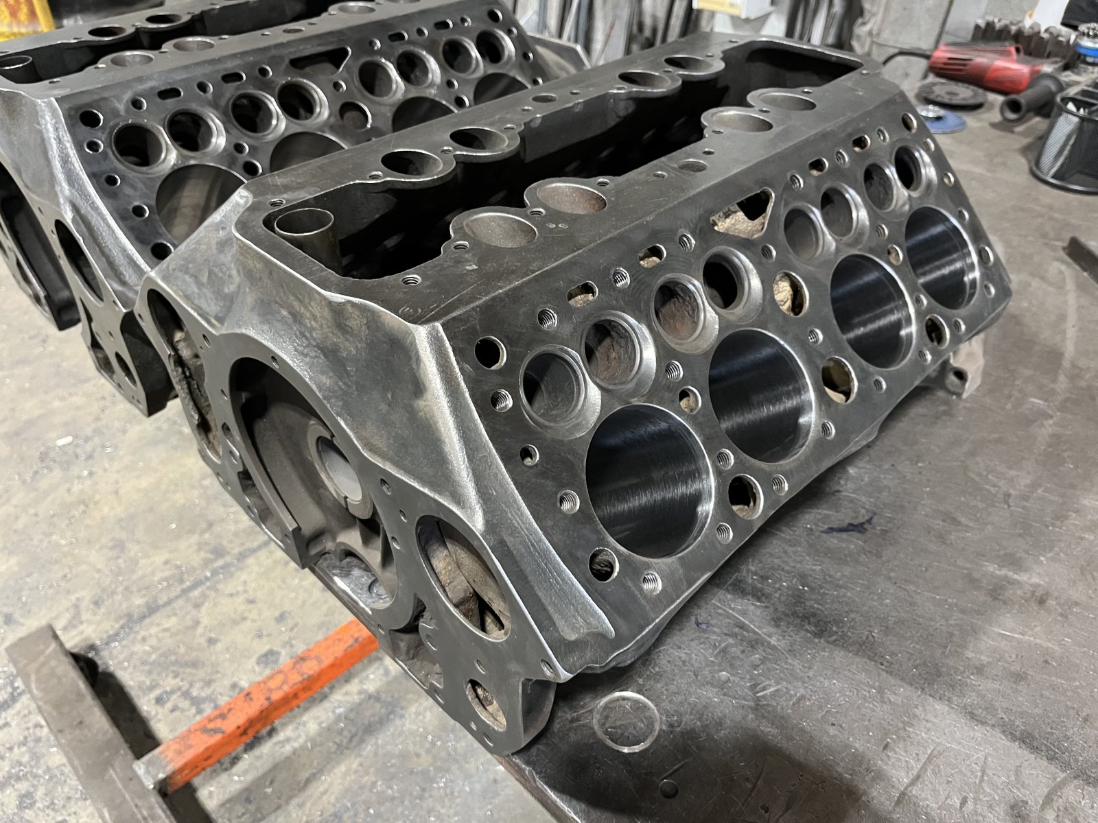

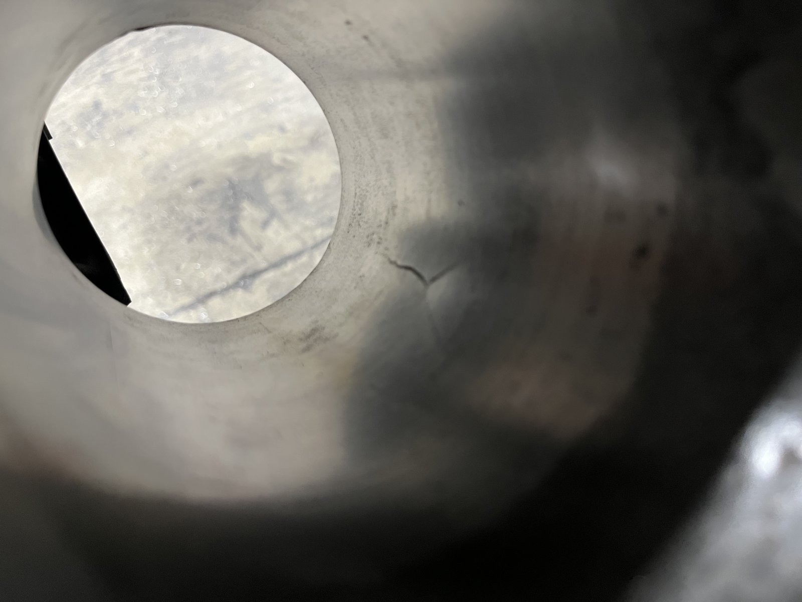

    the block on the left has a crack in cylinder #7 and major pitting on the deck and bore at cylinders #4 & #7. It also has two cracks between a head stud and water p***age.
    is the block with the water pump damage fixable? Or keep looking for another block?

  2. Well it couldn't hurt to try and fix the water pump surface at this point, but it is also a load bearing mounting point and could let go again. I would bring in someone who is proficient at sticking cast iron back together if it is beyond your ability. That ****s.
    But, you could also have the one with cracked cylinders sleeved. I would not mind the corrosion or the small cracks between the stud and water jacket (normal) as long as the head gaskets and valves sealed up. With the poor breathing of the flathead the bumpy transition to the cylinder from the valve pocket would probably not be noticeable anyway if you're not trying to extract every last drop of performance out of it.
    gimpyshotrods likes this.
  3. Getting the block with the broken water pump area repaired is going to be expensive - as it really needs to be done by a professional shop that has a furnace and the cast-iron repair experience to do it. It will cost you a lot more than the block is worth (sad but true). Also, once you put a block like this in the furnace - it may need all the surfaces machined as things tend to "move around".
    On the block with the rust pitting - looks like a perfect candidate to "relieve" the transfer area (that is what I'd do). The seats can be evaluated and if they need to be replaced, not a huge deal. The most important thing is that you use a machine shop that is very familiar with flatheads, has the correct valve mandrels/equipment, etc..
  4. Another thing to ponder for a bit is the block with the broken-out area behind the water pump . . . why fix it at all? My guess is that with a good gasket there is really no place for the pump to leak and it will probably pump just fine. You've only lost one mounting hole out of the four, so as long as the threads are good in the other three - I'd not worry about strength. Anyway, just an idea to ponder.

    Those make me want to cry. :( I would not try to fix the one with the water pump damage. There is more at issue than obvious here. The other one can be fixed with a sleeve and relieve. If you notice the area that the gasket fire ring seals is right up to the cylinder bore and very close to the valve area. If you relieve this area it will still have pits that won't seal and need to be filled and machined flat. Same with any near the edge of the bores. The crack in the cylinder wall looks like it's been hit with a broken rod. Not really a problem with a sleeve installed. I would also use a big bore gasket to keep the fire ring farther away from the edge of the bore where there are less pits. Gaskets are available for bores up to .100" over size. Any welding should be done with pre-heating and very slow cooling. I have found a cast rod that could be used on the pits without a high temp pre-heat. I believe it's "Nomacast" rod. I've used it a time or two and it works good. I would then have both decks milled for flatness. Sadly, I would not even try to fix the other one. It might make a nice coffee table?

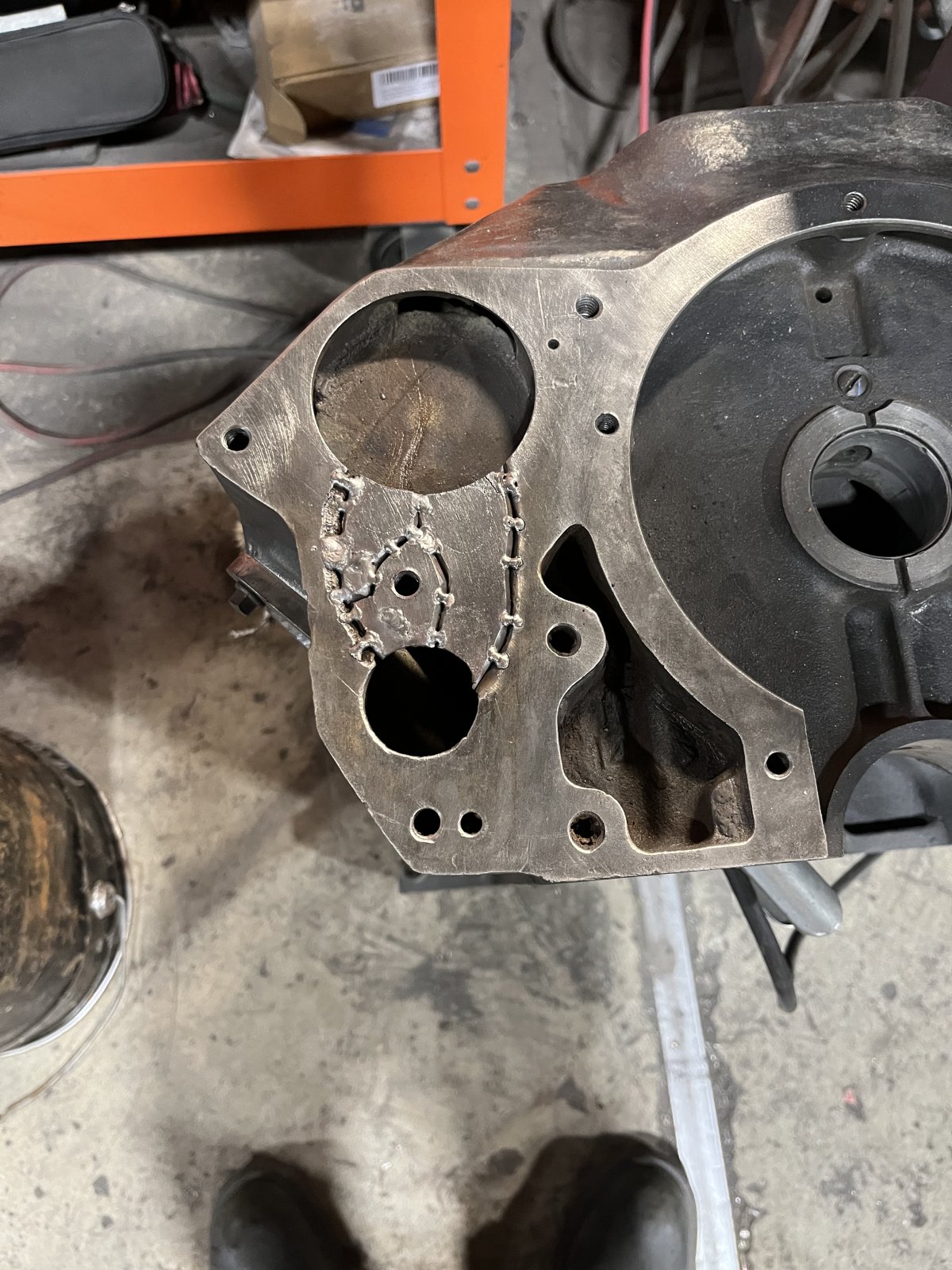

    F99281C4-96D3-42EC-B891-58EAAAC446B0.jpeg I’ve got nothing to lose except try to weld it back together. I don’t like to show welding on the internet because I will get **** for doing it my way.
  16. 65standard
    Joined: Jun 14, 2011
    Posts: 1,096
    65standard
    I tack welded the pieces back in. Then I will fully weld it and see what happens. Nothing to lose for trying

    Haha! Looking good! Just make sure the middle threaded socket lines up with the hole in the pump.

    You will also need to weld the middle hole up and re-machine it, along with decking that front face.
    You should be able to find a blueprint in the Ford Benson Research Center online digital archives to help you re-locate that bolt hole position.

    I wouldn't go crazy welding that solid. I will fill in those recesses with a high quality epoxy.
    65standard and 34 5W Paul like this.
  20. If you start throwing more weld on it, you'll probably get some cracks - any maybe in the good material. If you do weld some more, preheat the whole block if you can -- like on a BBQ and then after more welding try to let it cool as slowly as possible (welding blankets, vermiculite, etc..). As Banjo noted, if you're sure all the pieces are good and solid, I'd switch over to some high strength epoxy - rather than trying to fill all the voids in. There really isn't a need for strength in this area - so why risk ruining the block.
    Alternately, you might be better off with cast-iron brazing from this point forward. ;)
    Robert J. Palmer and 65standard like this.

    The one with the cylinder damage is a better build candidate honestly. Sleeve it and relieve it.
    Good luck on fixing the water pump housing, I would heat the absolute hell out of it before welding anything to it, and let it cool naturally, fill in the left over voids and thin areas with JB weld and let her sit up real well. It will probably be all right honestly. They are tough motors.

    Braze the rest of it with a rod containing a lot of silver. This givers a low melting point and very good bond on cast iron. I do this on a lot of motorcycle barrels without any problems.

  27. Brazing can fix that right up,,,,,almost like it never happened .
    Use a good filler rod and a good torch tip .
    It mounts the water pump,,,,not a ton of stress in that area anyway .
    The bottom bolt holds most of the load ,,,,,for the engine mount .
    You should be able to get that fairly strong again,,,,,brazing is stronger than most people give it credit .

    I think I’ll finish it with brazing. I’m picking up another block Sunday just to see if there is a better one to start with.
