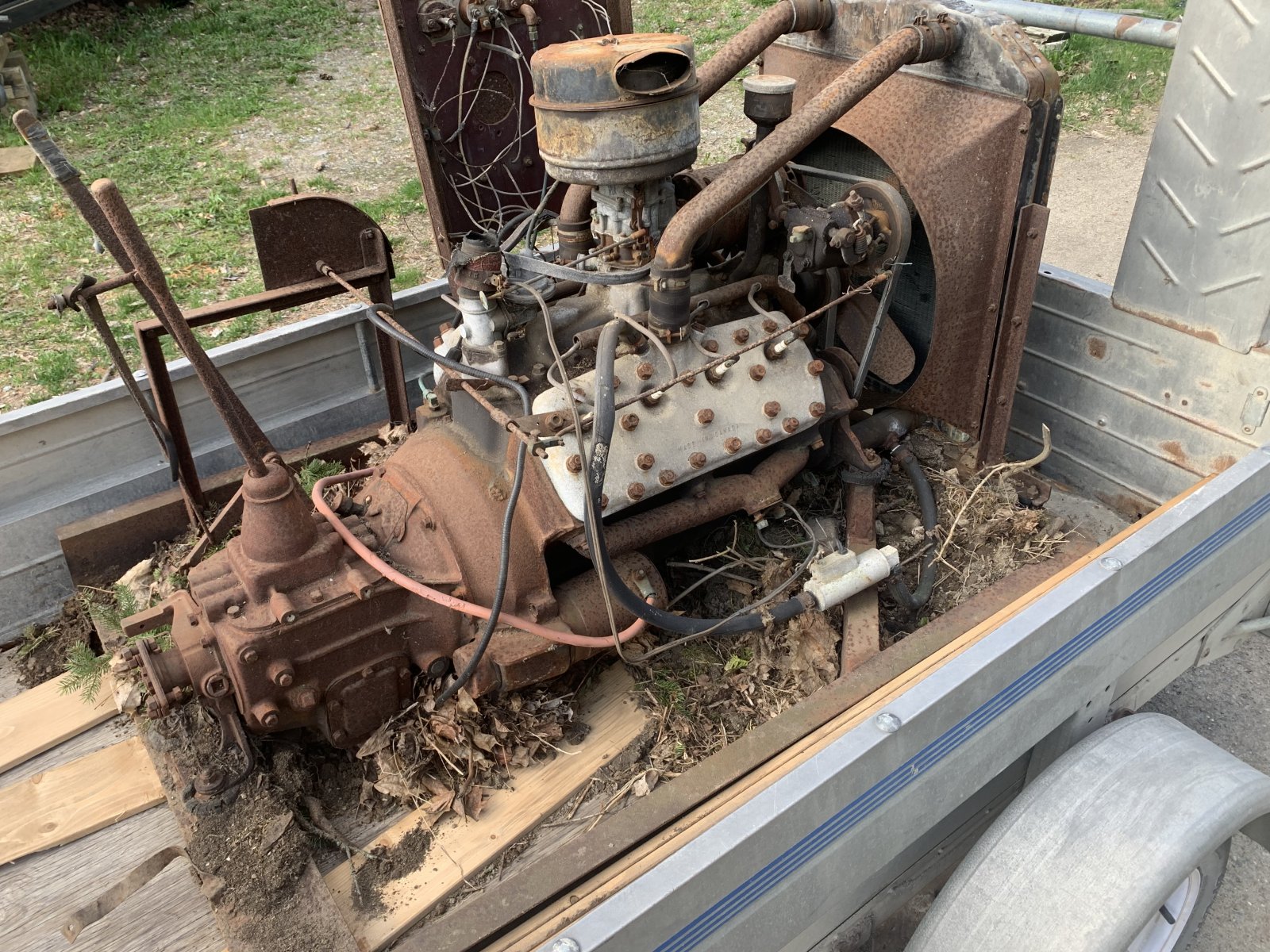

  18. 65standard
    Joined: Jun 14, 2011
    Posts: 1,096
    65standard

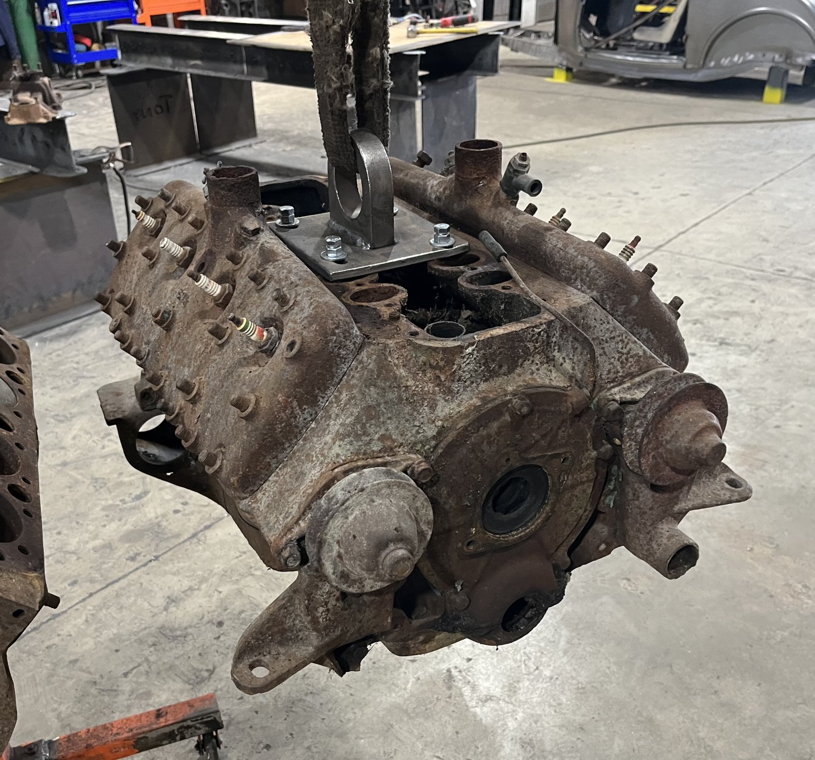

    A1FC8BFD-4826-4F5C-A9A8-540C625B9907.jpeg 5C694D36-0F56-4F82-BE2D-475BB6AC4F3D.jpeg 1F01A011-406E-4003-8F5A-B34BD9F4F609.jpeg I picked up two 59a flatheads this weekend. One on Sunday was $80

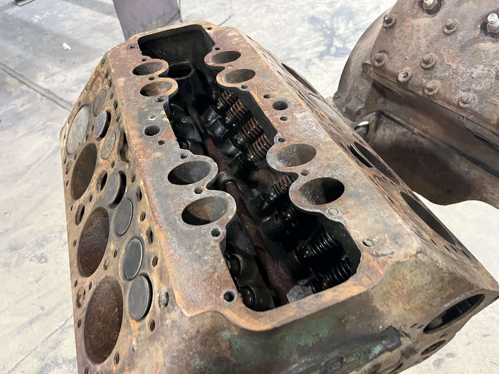

  19. 65standard
    Posts: 1,096
    65standard
    4B128BDF-F753-47B6-BA17-8DC34199F47A.jpeg BFABD355-9971-4887-B042-B789C1097749.jpeg 69DBA58B-6700-4A67-A742-AE1F90E8F8F9.jpeg 0EC2160B-2EAD-446B-92F6-AF44402399AA.jpeg F7F27258-0212-4F75-A6D4-52ADA9D56FC3.jpeg And this one Monday for $50

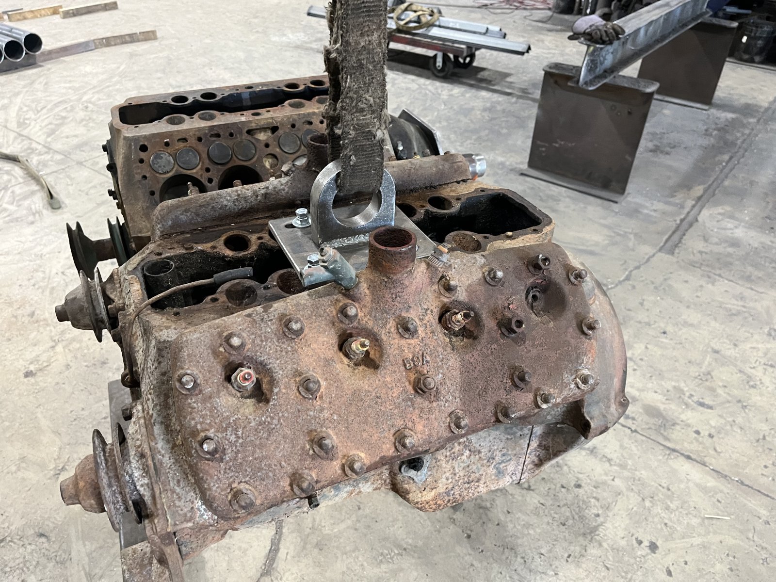

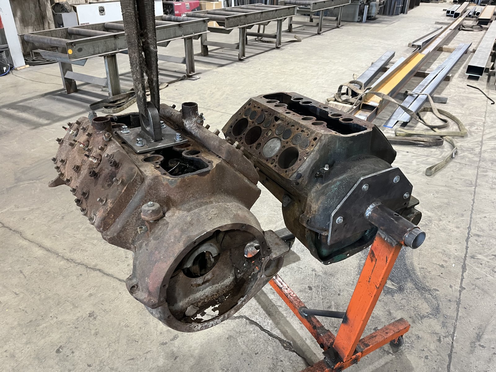

    Not to be one of those I told you so dudes, but don't get in the habit of mounting them by the bell housing. Side mounted using the exhaust threads or supported front and rear.
    There are many horror stories of motors being stored this way only to break off the upper bell housing.

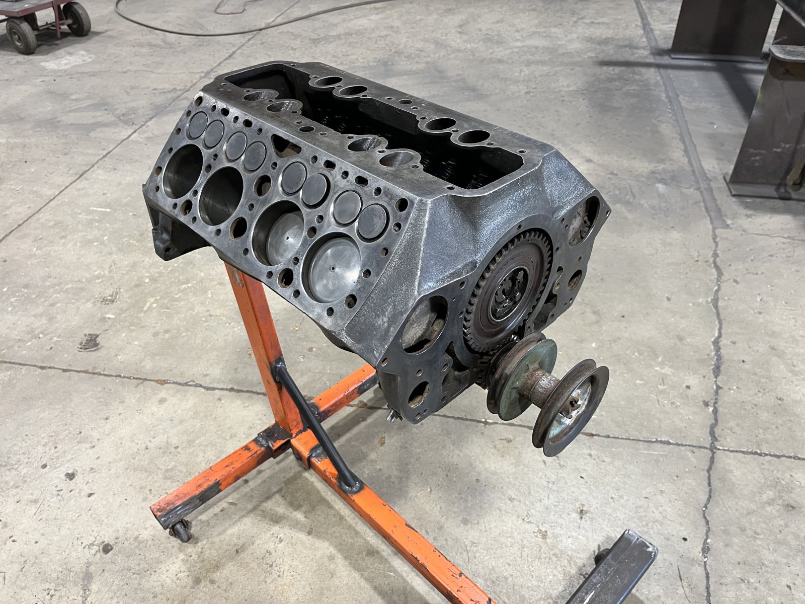

  21. 65standard
    Posts: 1,096
    65standard

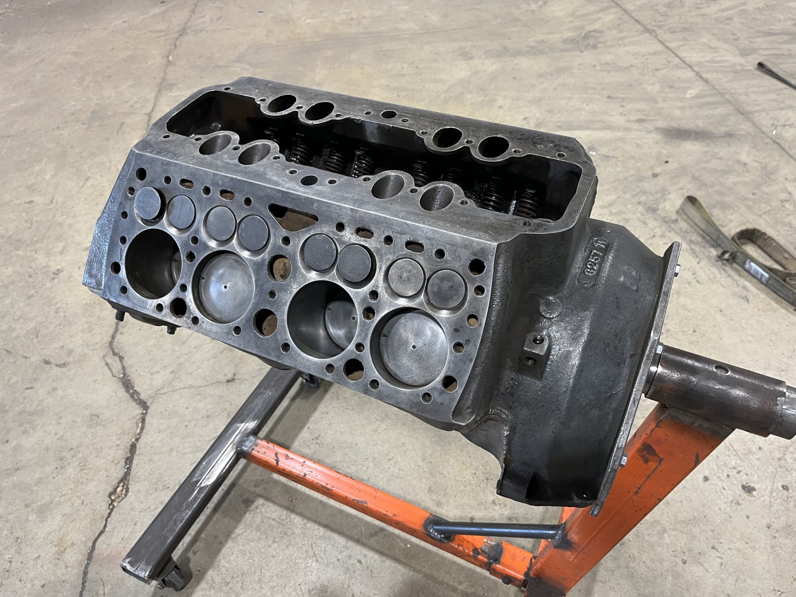

    00DE903F-D74C-476C-A979-0DEA99A1F027.jpeg 05F5AFAA-06F6-4E6D-8CFB-41C77895D740.jpeg 34DC14BF-B2C6-49A7-B312-D0E590DE0EA3.jpeg 7E3A0855-D387-4DA0-AFFF-1F3EF70D2E87.jpeg EF11C366-65CF-4D2C-9DAA-A51CEEDCEFFD.jpeg This $50 motor was remanufactured. So far the block looks perfect. It’s bored 0.100 over. Replacement valves and springs. Looks balanced with the extra drilling on the crank. I’ll see more once I fully tear it down.

  24. That one looks like it might be a good one! It is already .100 over . . . I'd bore it to .125 and go for a 3 5/16 bore. It sort of looks like the pistons might have been lightly "kissing" the heads - notice the shiny ring around the outer portions? Could just be the pictures or maybe they ran it with heads that have been milled too much.

    The one that is .100" over, that was one of the two you just picked up? If so, what did you use or do to get them that clean so quickly?

    I'm in the opposite camp at first. I'd put an intake and flywheel on it and see if you can get it running. You may be surprised how well it runs before doing a rebuild. Worst case, it doesn't run well and will need to be rebuilt.
    I believe this is the second rebuilt motor that someone has posted about here that has had the same REX- #'s stamped on the top deck. Really curious what outfit that was how rebuilt them.

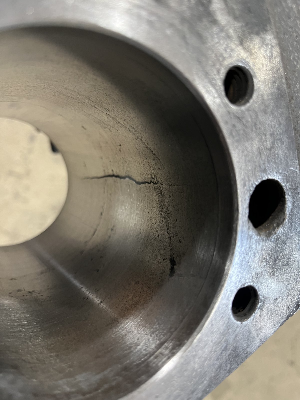

  27. 65standard
    Posts: 1,096
    65standard
    Pulled the pistons out and started to clean up the bored so I could examine them. She was looking good until i got to the last cylinder to clean. Then I saw this 5” long crack. Ugh. 4DAC713A-281D-410A-B6B0-8699169B4D41.jpeg AB5345EE-3DA1-4F6D-904D-56AEE10CB5B3.jpeg

  29. FrozenMerc
    Joined: Sep 4, 2009
    Posts: 3,567
    FrozenMerc
    Stick a sleeve in it and move on.
    Desoto291Hemi and Okie Pete like this.
  30. Isn't that the way it always goes . . . on the LAST one of the operations . . .
    Have the block magged first - including the pan rails - to make sure something else didn't happen to it (due to freezing) or some other issue.
    Then, have it sonic tested for cylinder wall thickness and potential core shift - before you invest in sleeves.
    You have to ask yourself --> "How the heck did this crack happen?". That is a big crack - and something was going on to cause it.
