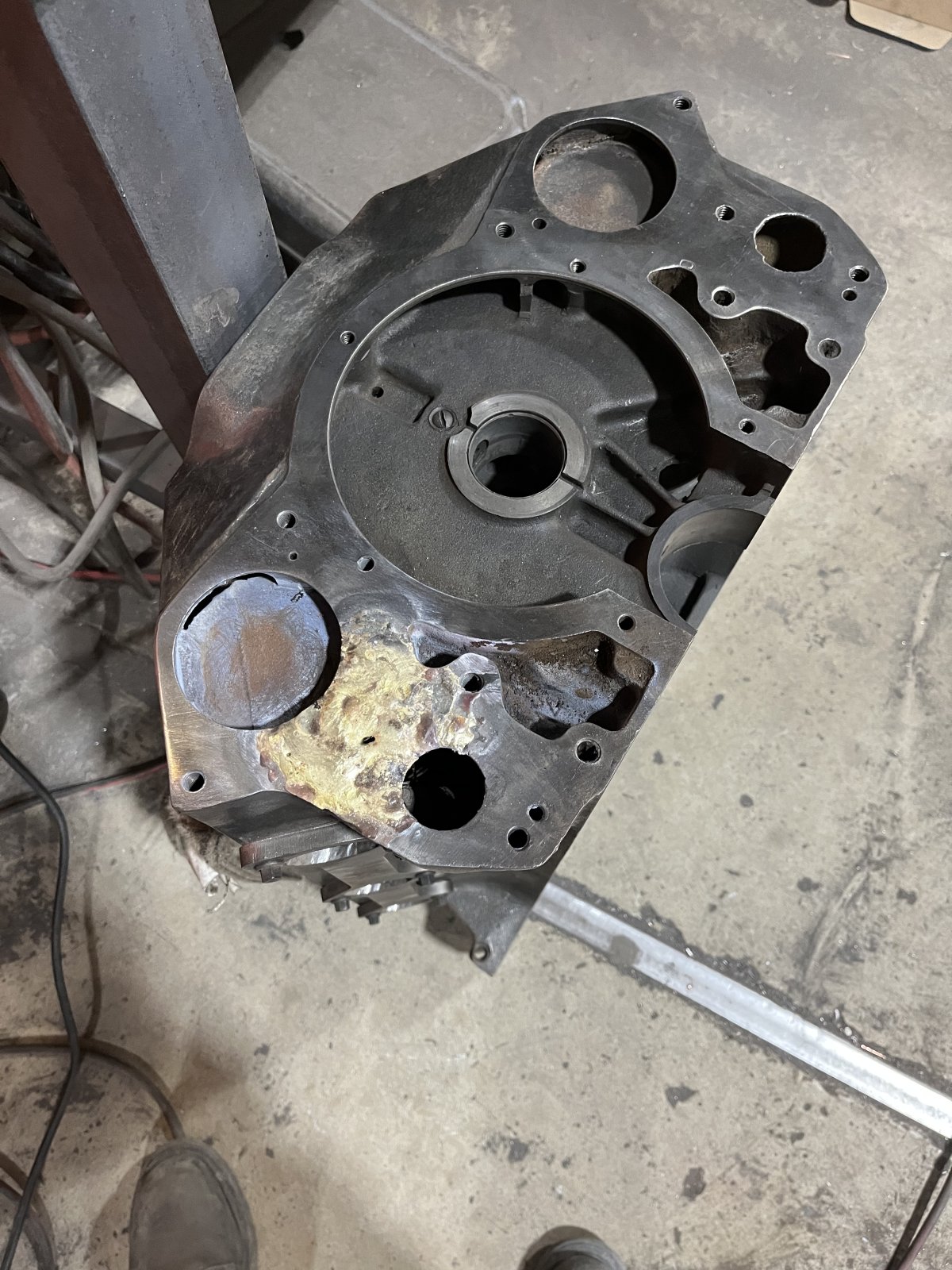

  2. 65standard
    Joined: Jun 14, 2011
    Posts: 1,096
    65standard

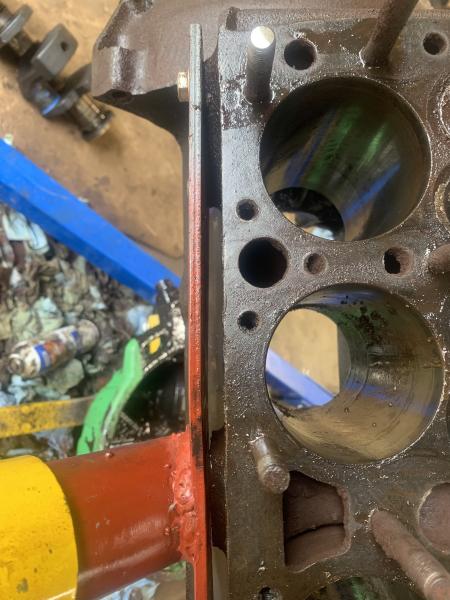

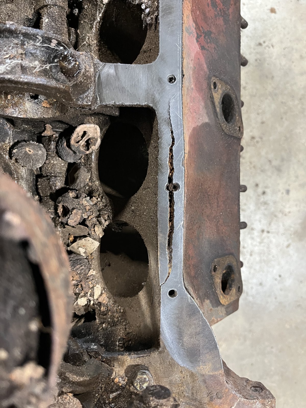

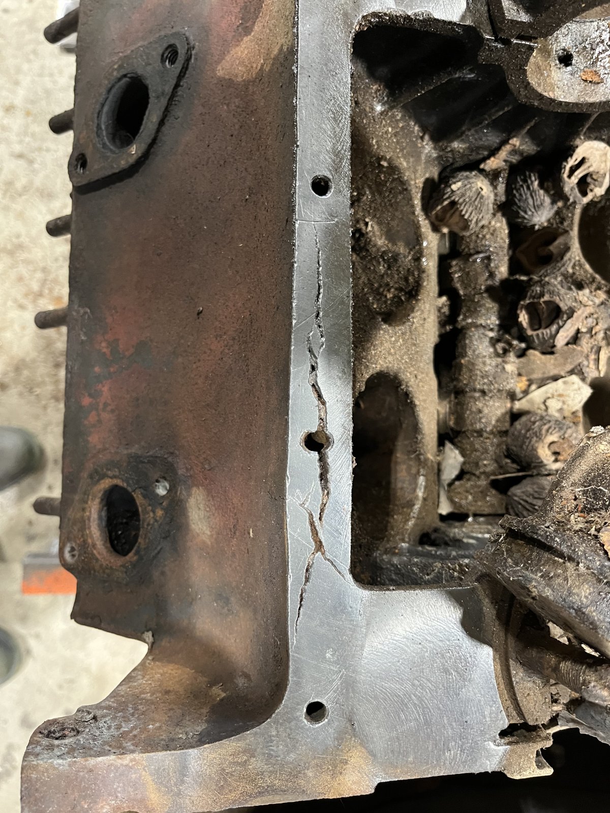

    39D3823F-F38F-45AF-BA51-435050458EE2.jpeg No idea how it would get a crack like that. The piston and rod are still perfect. The valves in that cylinder are perfect.
    Maybe it over heated, or was over boosted, or it’s just too thin?
    I’ll start to look at the 4th engine I have
    or use the good 392 fuel Hemi I have? 82D4F8C9-1004-41D5-8CFE-06DFFB56533B.jpeg 39D3823F-F38F-45AF-BA51-435050458EE2.jpeg

    Damn! That block looked so good.
  4. chicken
    Joined: Aug 15, 2004
    Posts: 727
    chicken
    from Kansas
    Usually cracks like that are from freezing with plain water instead of antifreeze. If no other cracks show up when magged, a sleeve will fix it properly.

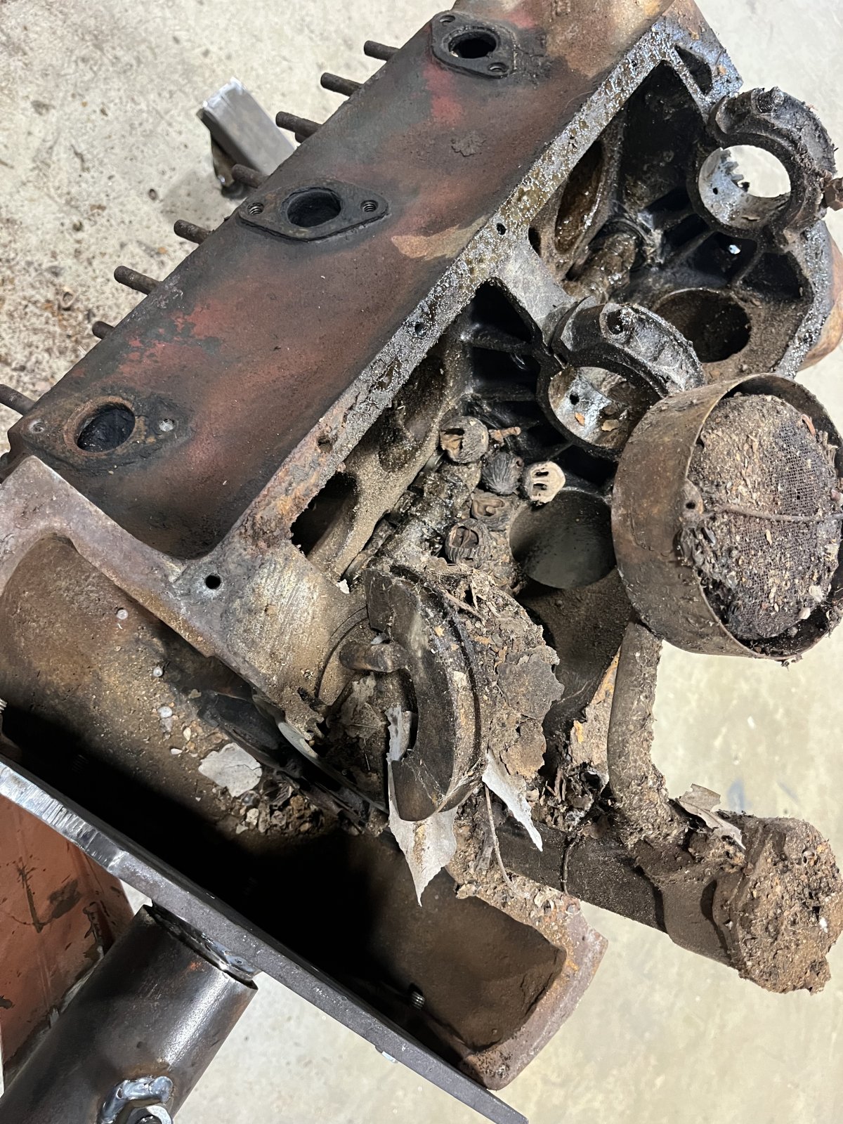

  5. 65standard
    Posts: 1,096
    65standard

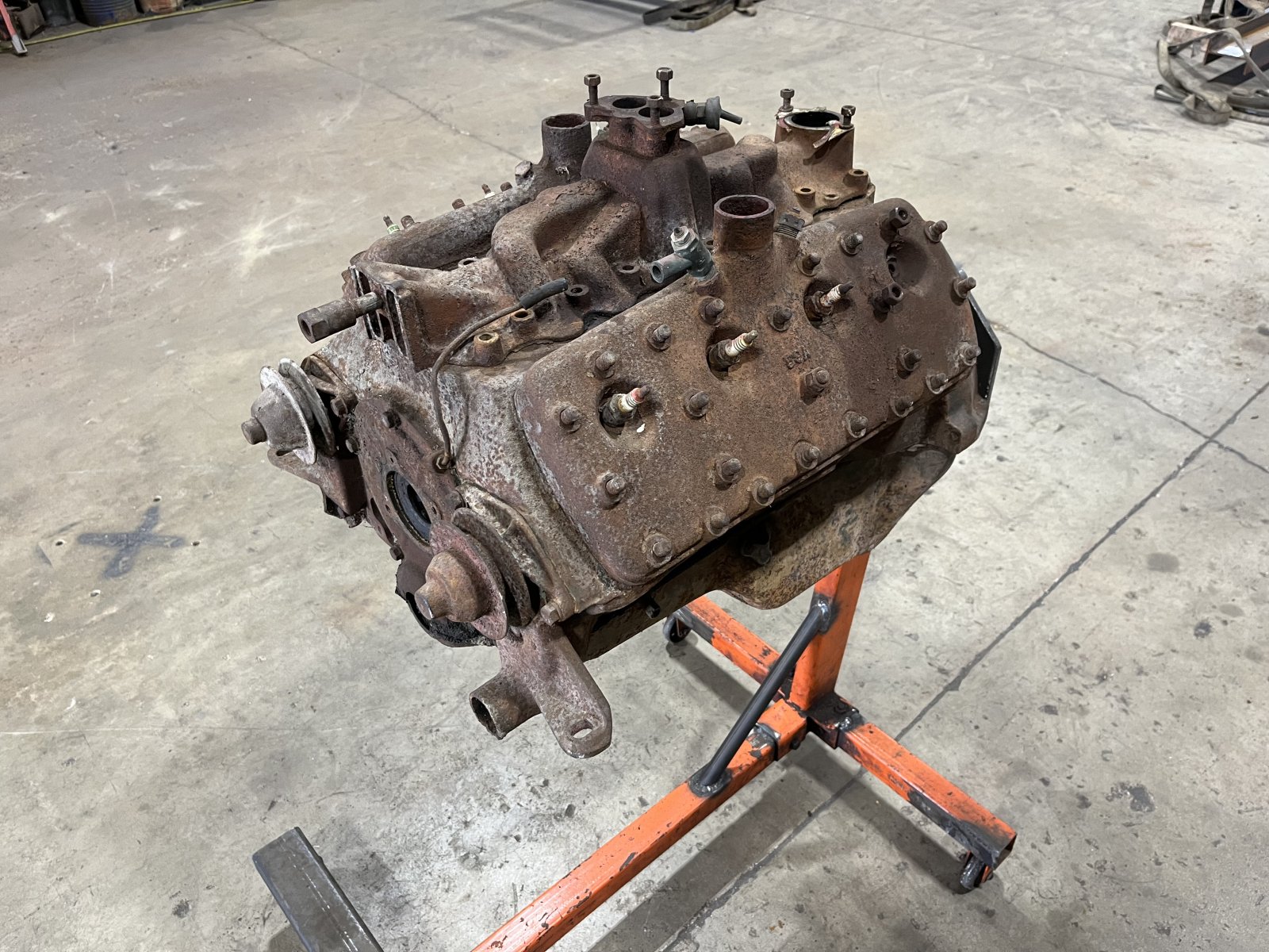

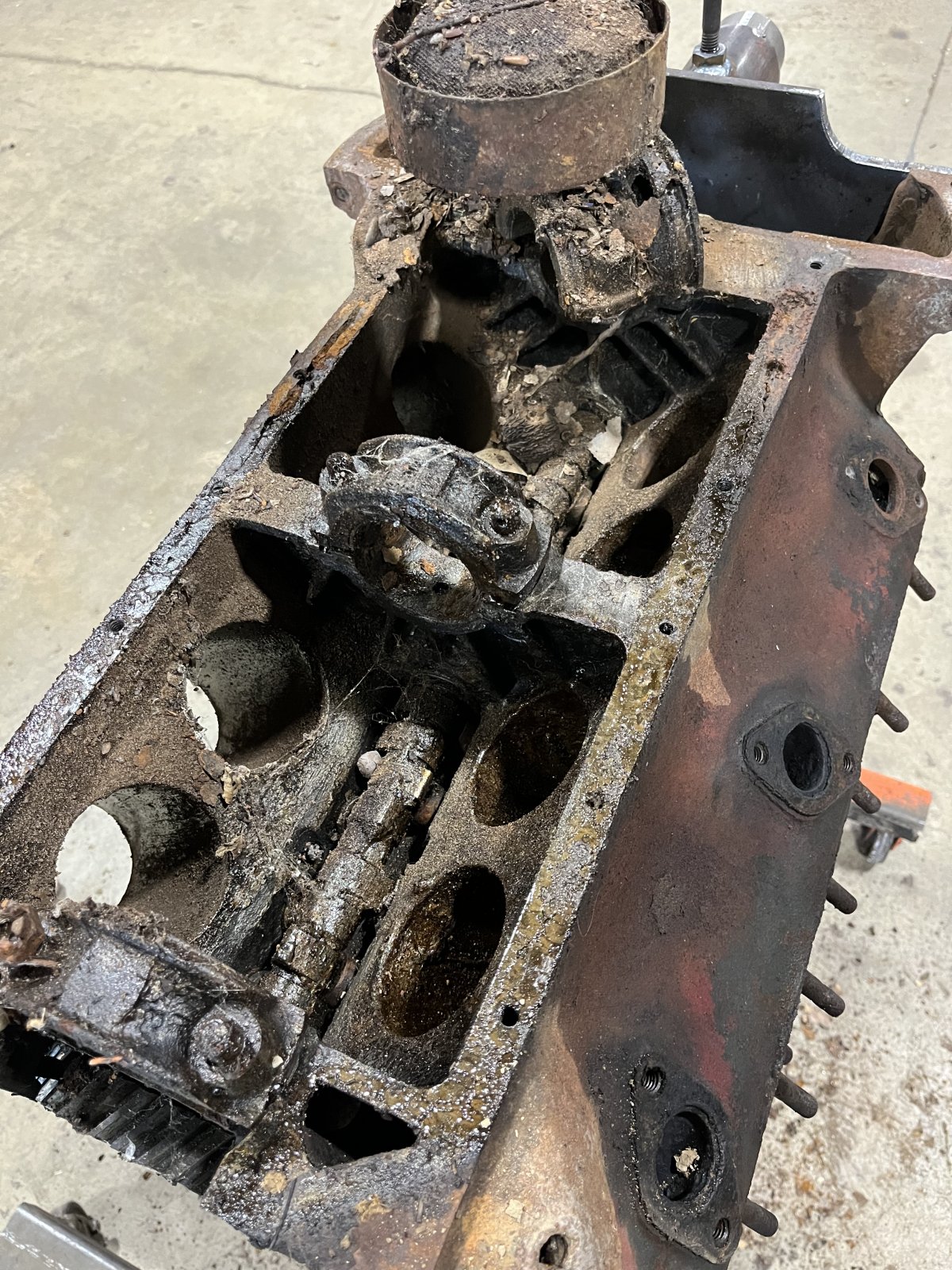

    72649933-51A4-46CC-AE14-D689C986CA82.jpeg BFEE3C75-68EF-47F1-A82B-236FB9ECD674.jpeg F3E0A1E6-FA79-42C9-8457-7746943AC2C3.jpeg 7E6CCFF6-F648-40A5-9CC5-1FE44D564C21.jpeg The worst looking engine ended up being the worst. Didn’t take long to see these cracks.

    Jimminy crackers, dude. The flathead gods are not on your side.

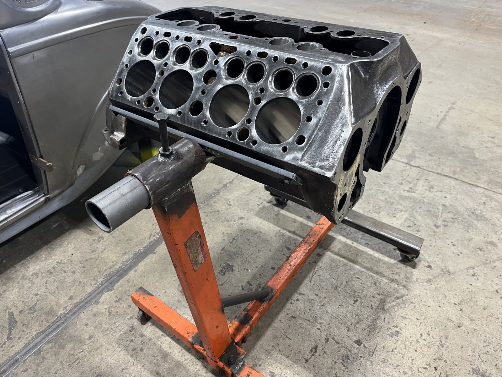

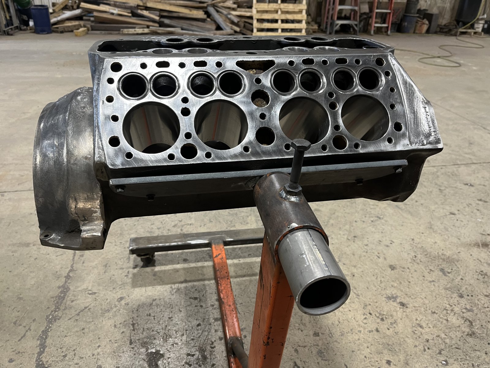

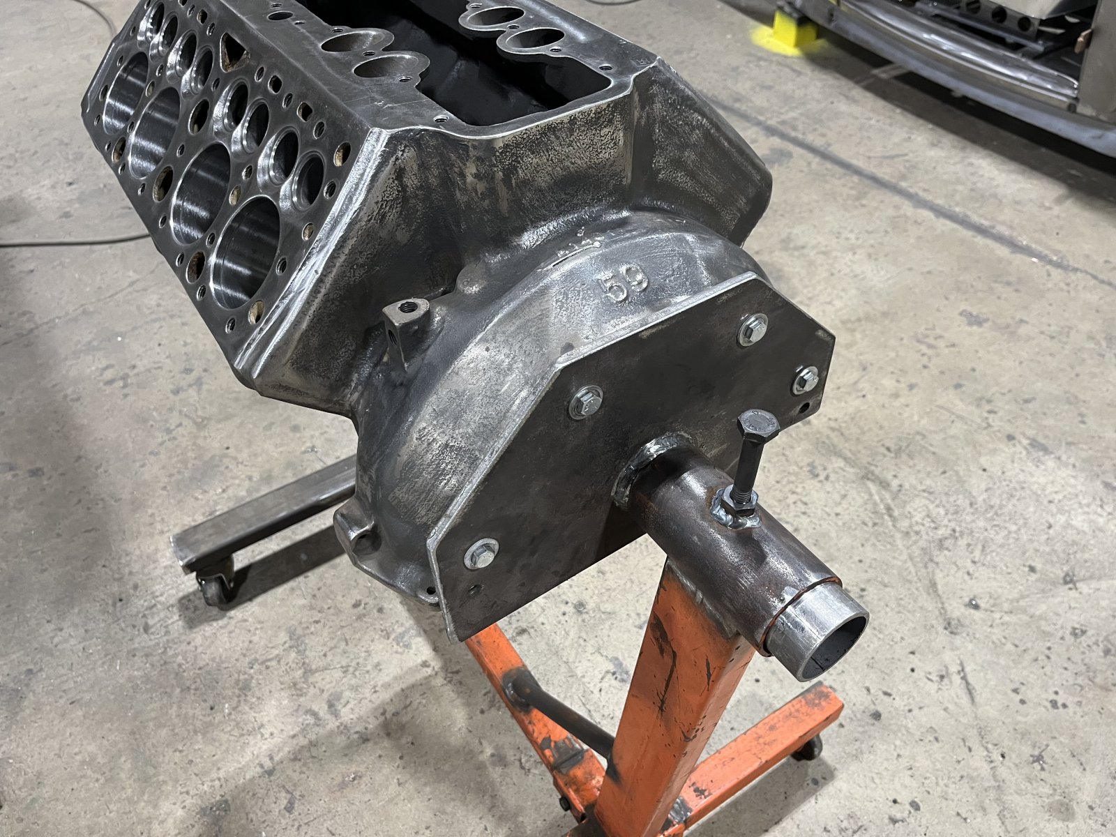

  8. 65standard
    Posts: 1,096
    65standard

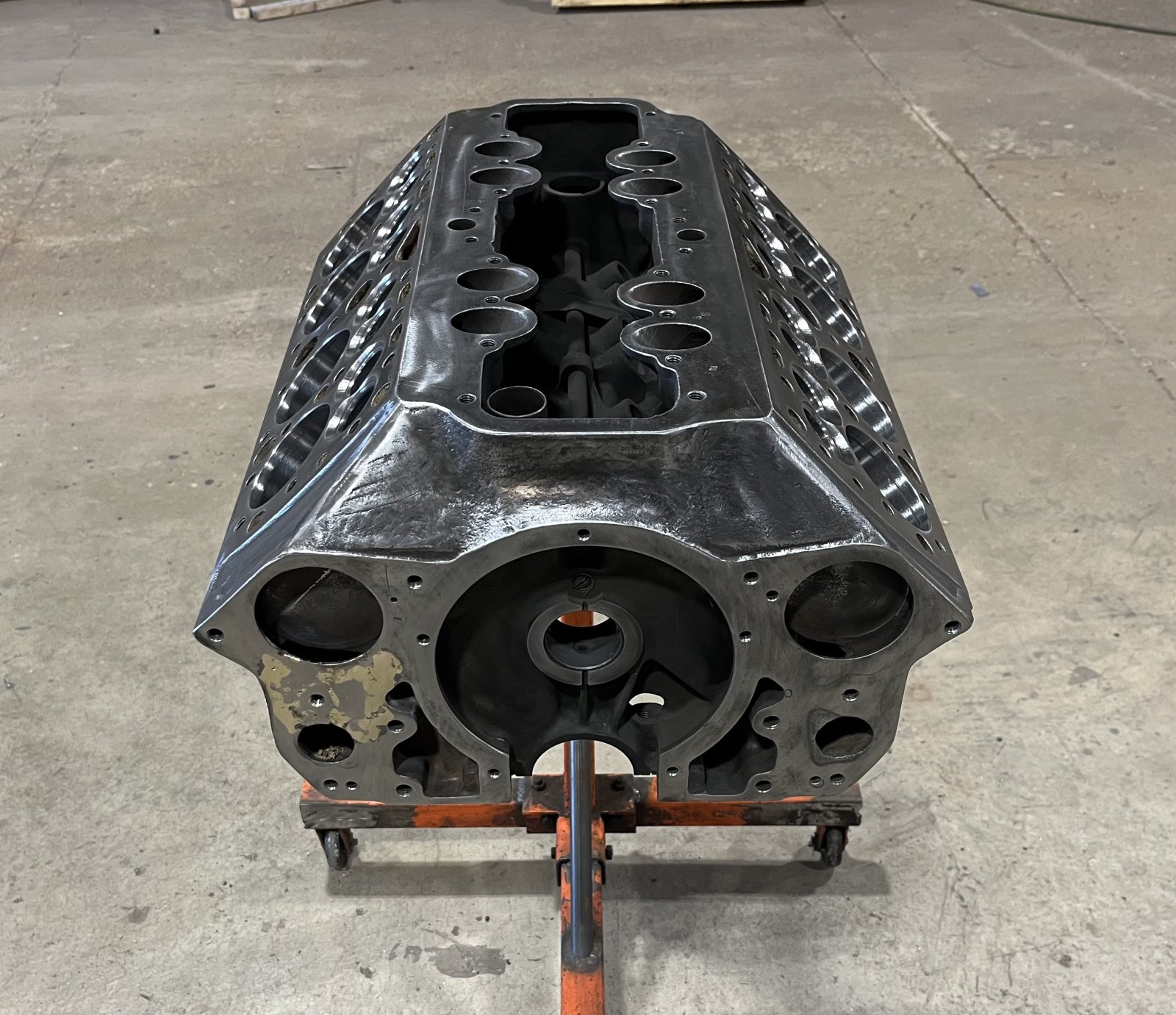

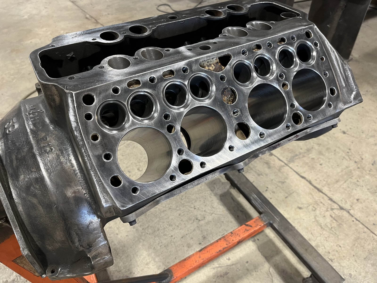

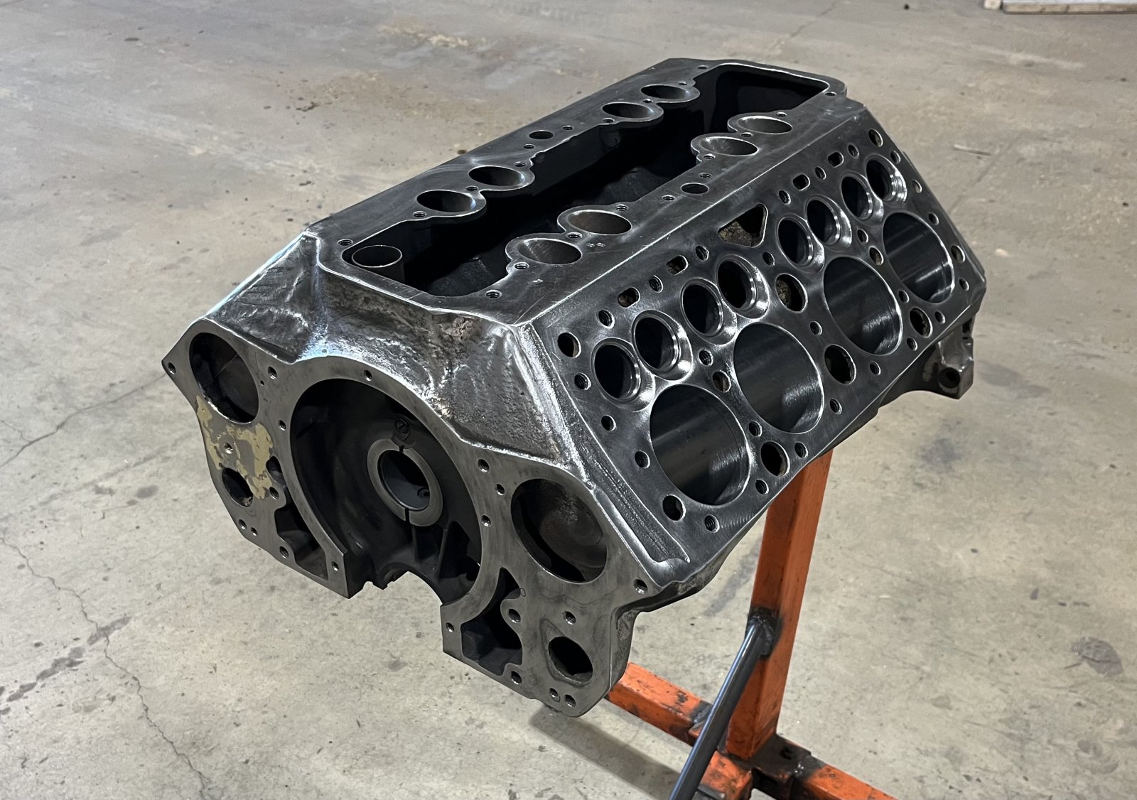

    43D61DC8-96B7-440F-9073-3C5CE7881992.jpeg 3022F3FD-52CF-43B4-B103-C2E060F6B8BD.jpeg 591084A3-5BE7-4BA3-867F-78B47B469D0F.jpeg A61439A1-8A8A-4235-84F3-FB804BDC6AFC.jpeg 4D3EF4BA-22DE-4902-BC9F-52C1D5D1FD47.jpeg Okay. I’m going back to my original block. It’s by far the best choice a**** the 4 blocks I have.
  9. Yep - and I believe the "fix" you put in place will be just fine. I would have it magged around that area, and the whole rest of the block - just to make sure you don't have other cracks you can't see. You can always use some "Lock-N-S***ch" techniques to repair any you might find.
    Then, have the block baked and blasted to get any rust/scale out of the guts of it - then pressure tested. I've seen blocks with cracks in the exhaust ports - that were only found with pressure testing.
    If it p***es all that, then sonic tested for cylinder wall thickness. This way, you'll truly know what you're starting with - before investing in expensive machining operations and ***ociated parts.
  10. Also, PLEASE get a side-mount block adapter for your engine stand. ;)

    As time marches on, I'm starting to believe a vast majority of the complete flatheads engine were taken out due to catastrophic failure reasons while in a car/truck.
    When factoring in your time, you may want to start looking for a known good bare block so you don't keep having this heartbreak. Plus, you don't have to keep dealing with heavy, cast iron s**** that some s**** yards won't take unless you hit a specific tonnage.

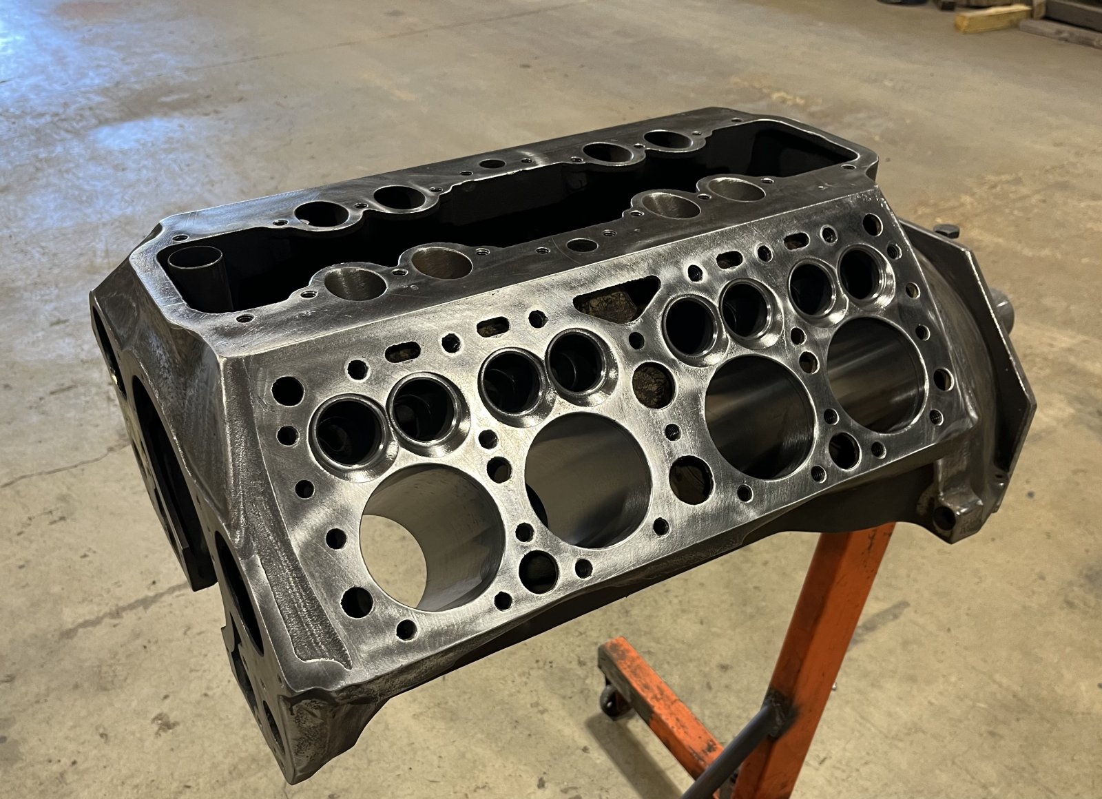

    Also, can you tell us how you are getting these block so clean so quickly? I'd really like to know and give is whirl with some of my blocks. Thanks,
  13. 65standard
    Posts: 1,096
    65standard
    How is a full contact mount not good enough?

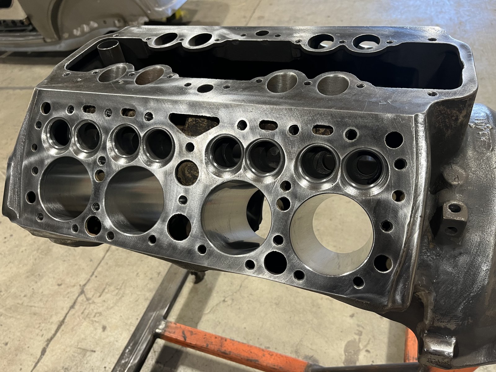

    Block cleaned with a wire cup on the outside. Bores cleaned with a deglasing ball hone and machine surfaces clean with 2” Scotch Brite pads.

  15. banjorear
    Joined: Jul 30, 2004
    Posts: 4,966
    banjorear

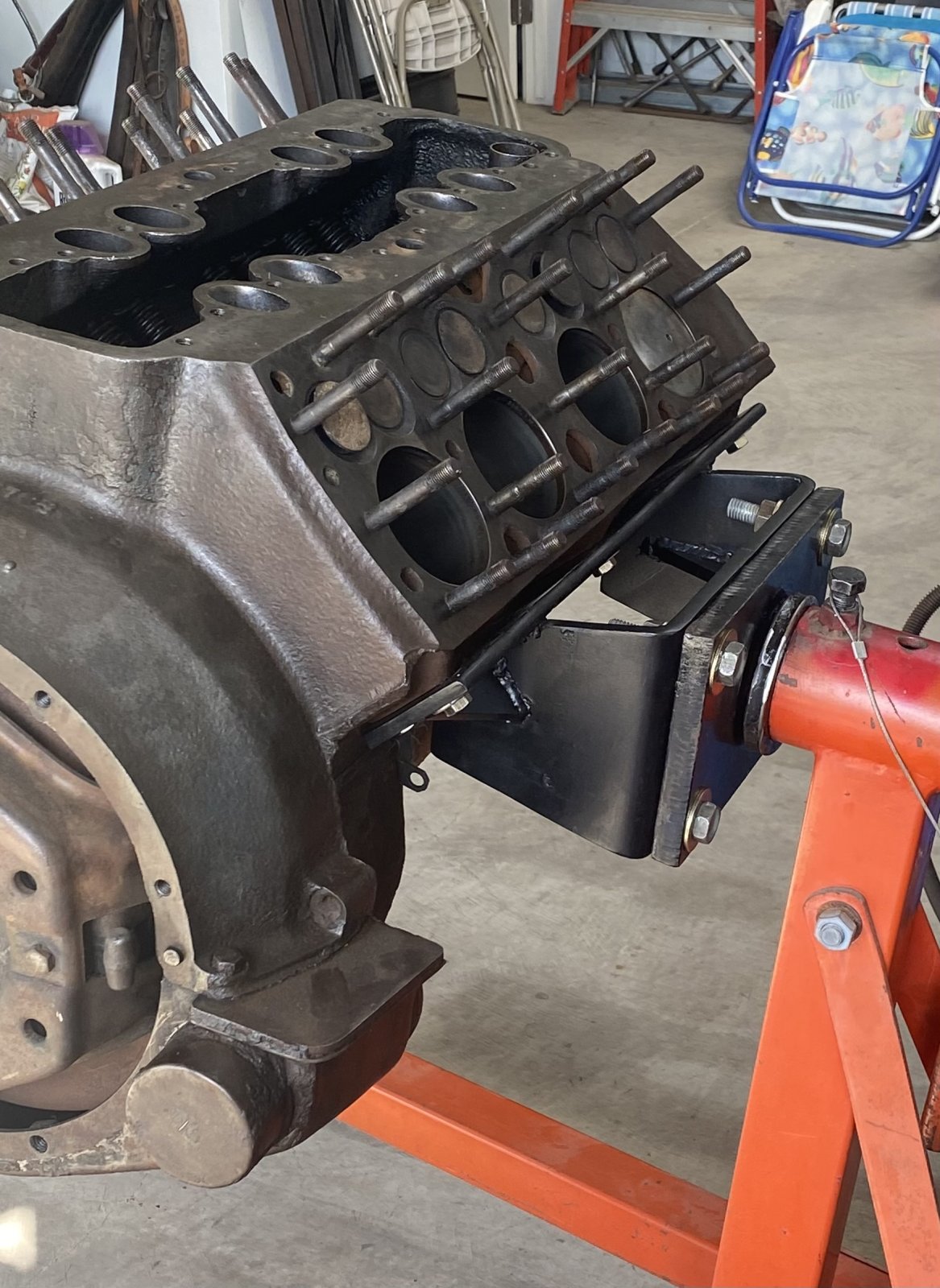

    That cast bell is not strong enough to hold a motor. Can you do it? Sure, many have. You may get lucky since it's only a bare block.
    NEVER support a full 59-series motor by the bell. That's why KR Wilson and other OE Ford tool makers designed their stands to mount the motor using the exhaust manifold bolts.

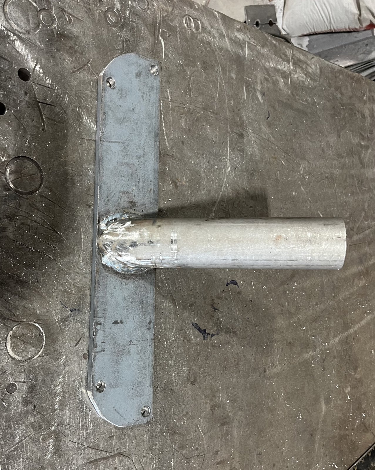

  21. 65standard
    Posts: 1,096
    65standard
    1368BAA8-E25B-4D2B-8652-CED9814D5C9B.jpeg I could have used any thickness I wanted, but went with 3/8. Took about 20 minutes to fabricate.
    KiWinUS and Ziggster like this.

  23. shorrock
    Joined: Oct 23, 2020
    Posts: 273
    shorrock
    from Germany
    I made the same engine adapter but drilled and use all 6 holes for maximum safety. I still don´t feel realy safe when a fully built engine hangs on those 6 exhaust bolts...
  24. tubman
    Joined: May 16, 2007
    Posts: 8,678
    tubman
    I agree; I would feel a little insecure with only 4 bolts.
  25. My adapter only has 4 bolts and as long as the threads in the block are good AND you use 7/16 NC bolts for the front two (many newbies don't notice this - and put 3/8" NC - which can get your feet smashed!) - then you'll be good.
    Ziggster likes this.
  26. Ziggster
    Joined: Aug 27, 2018
    Posts: 4,572
    Ziggster
    Agree. My first flathead sat on my engine stand with my DIY engine adapter plate mounted with four bolts probably close to a year. The load/stress on the four bolts I’m sure is well below their yield strength. Just use quality hardware and have sufficient thread engagement and all will be good. I did notice while getting the HellsGate exhaust manifold plate mounted, the thread depth of the exh manifold mounting holes were all over the place and I had to cut down a few of the bolts as they were bottoming out before the underside of the bolt head had contact with the manifold plate.
    GlassThamesDoug likes this.

    I built my adapter out of 3/8” plate to use six bolts and drilled and slotted to fit each of my three engine stands - all with different diameter yokes. IMG_2506.jpeg
  28. GlassThamesDoug
    Joined: May 25, 2008
    Posts: 2,143
    GlassThamesDoug
    Car buddy in Illinois, could weld cast iron like ****er. Amazing how good he was.
  29. There used to be a few guys that did furnace welding and fixing of blocks - most of them are long gone these days. That is part of the issue - the skills, tools and techniques that were used on a lot of our vintage engines are slowly disappearing.
    Desoto291Hemi likes this.
