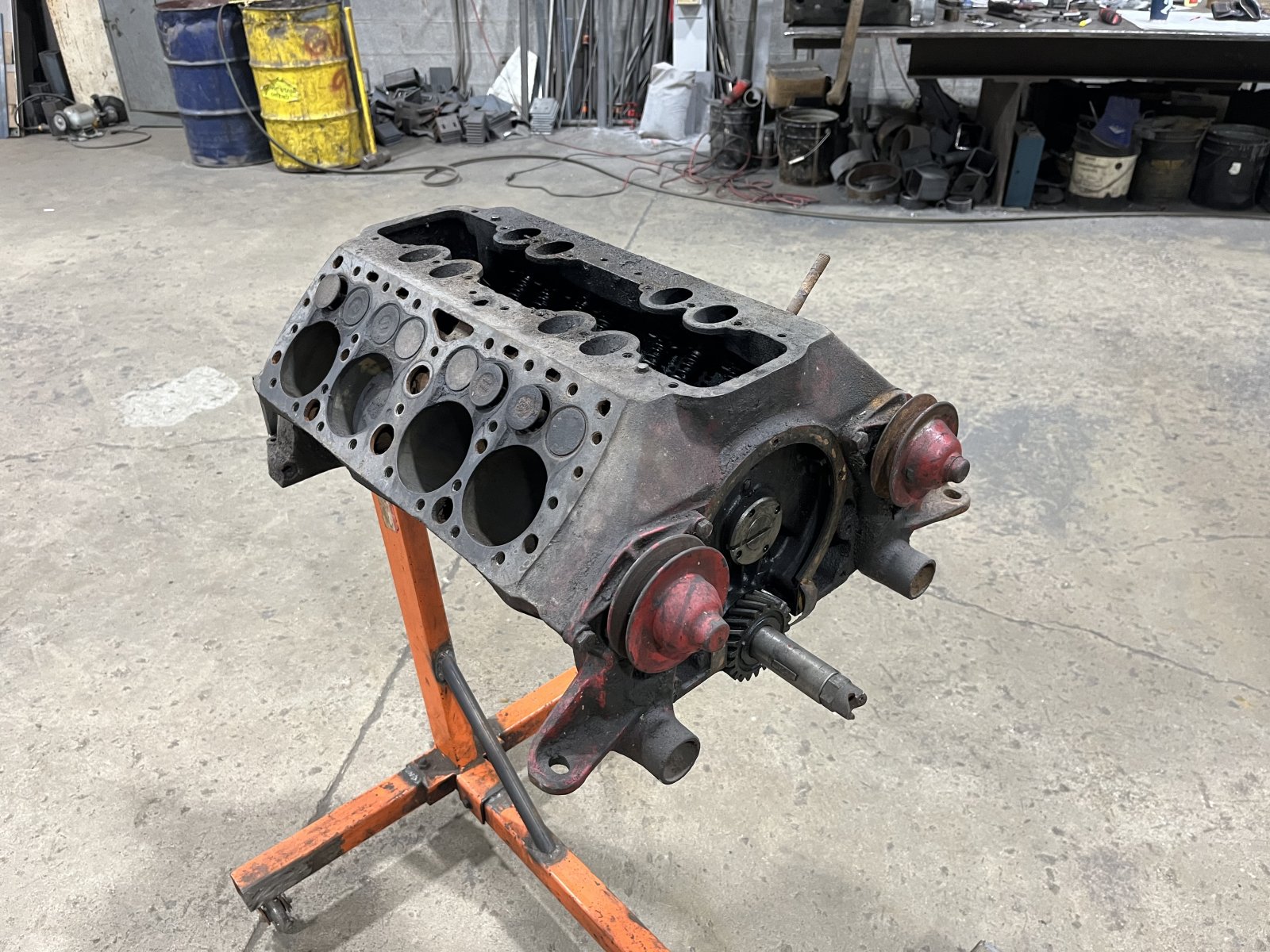

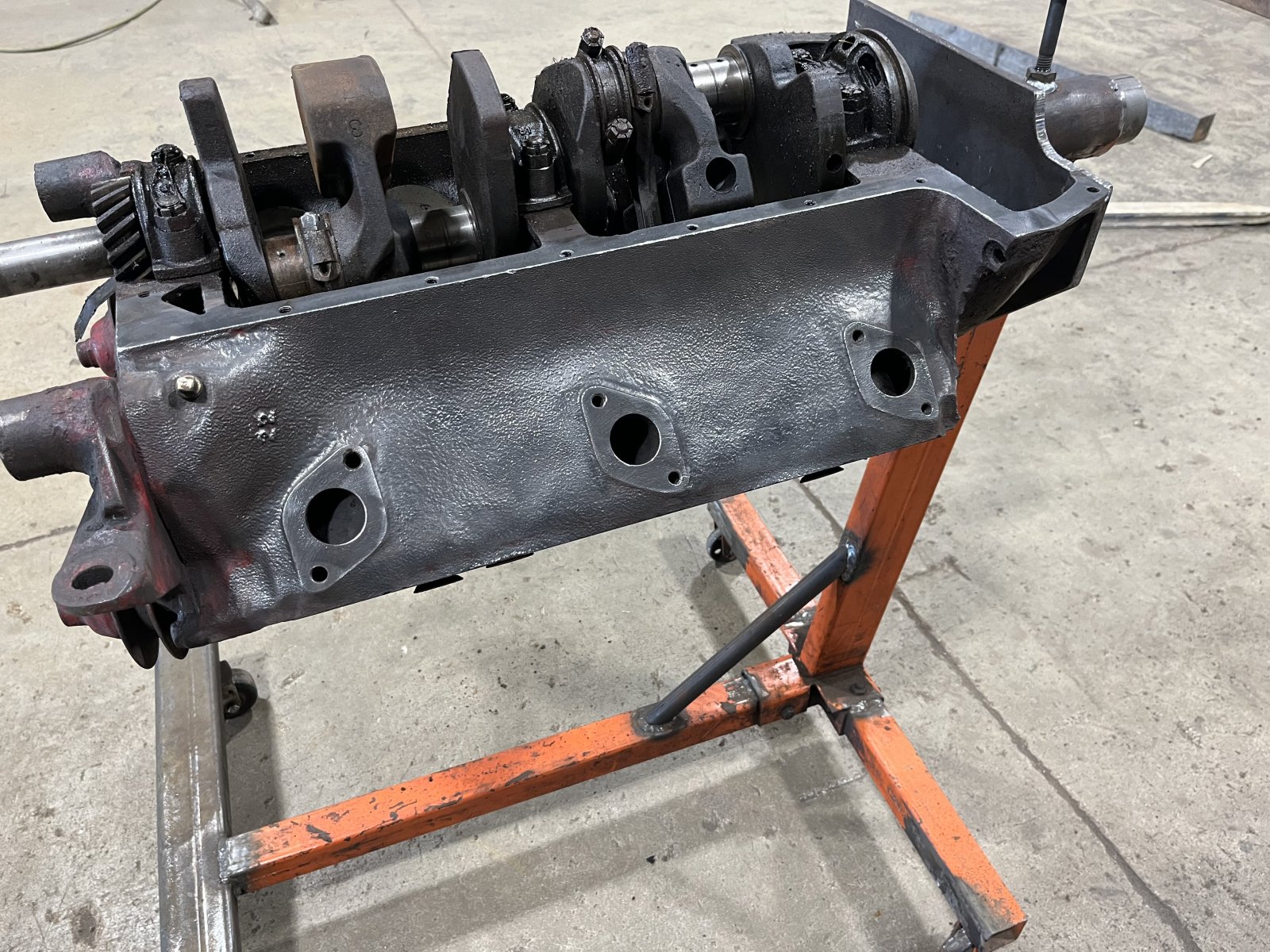

    3BE8B6F3-8D0B-42DE-A6B3-85D26909CEE5.jpeg 50A9759F-B977-410A-A6CE-33747260524C.jpeg Another 59a flathead number 5. This one is a mystery. Mountain motor flathead. I’ll tear it down and check for cracks. Big bore big stroke motor

  3. I sure wish you'd get or make a side/mount adapter for these engines . . . why take a chance with breaking the bellhousing off and having it land on your feet! ;)

    I have one. I like the bell housing mount for tear down and inspection. I’ll use the side mount on final ***embly.

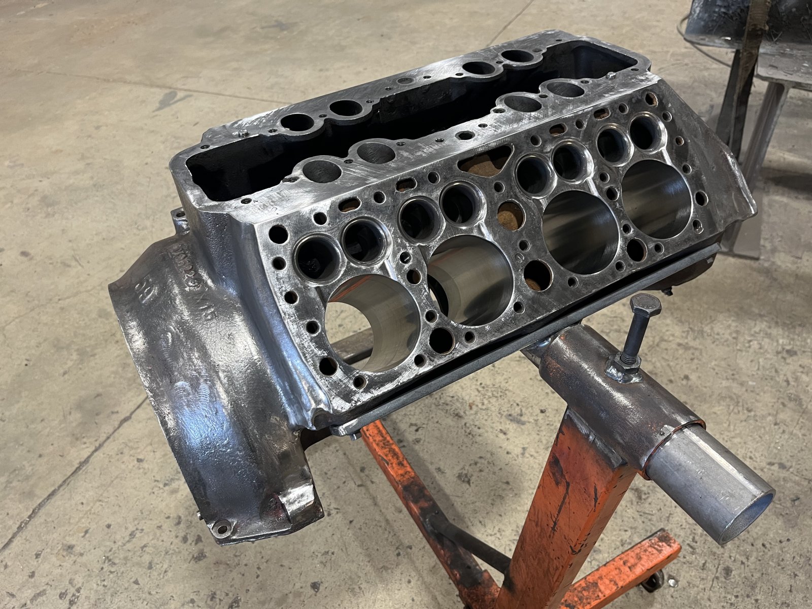

  6. 65standard
    Joined: Jun 14, 2011
    Posts: 1,096
    65standard
    It also has a 4.110 stroke and 3.360 bore.
    I’ll clean the block side and the header threads first, then switch over to the side mount.
  7. 65standard
    Posts: 1,096
    65standard

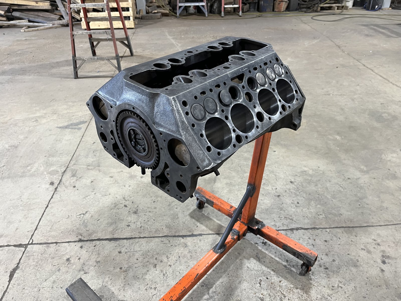

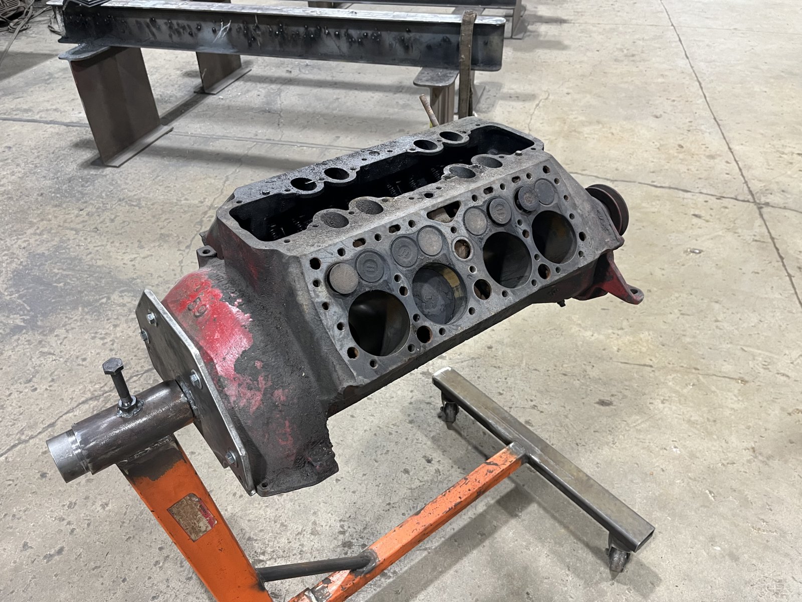

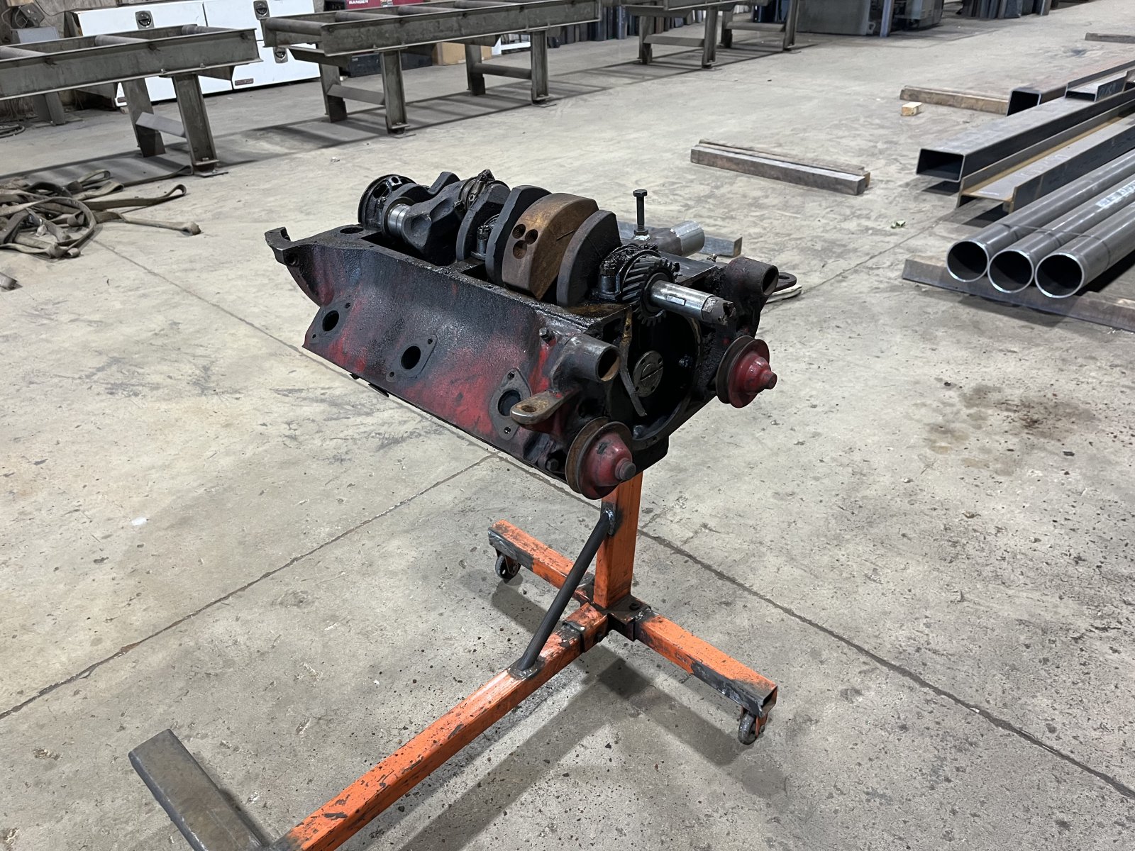

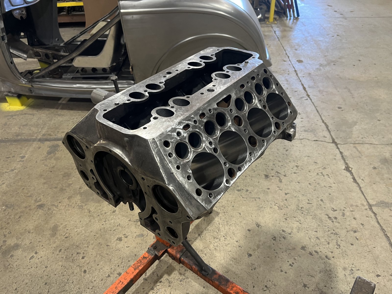

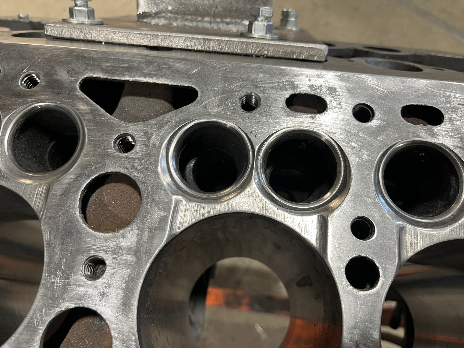

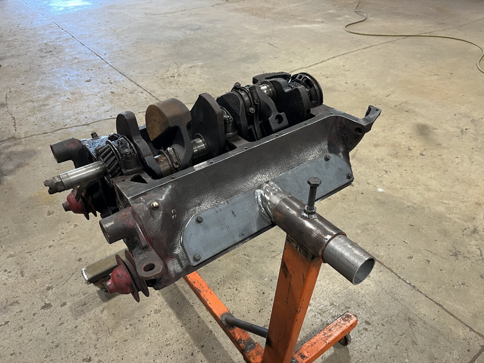

    373B7737-C470-4975-9414-BF26E4B41603.jpeg D08107F1-EB46-4A11-8537-FCAF7FB0E8A3.jpeg 447464C6-DC72-4C13-AF80-1322FC4A84BA.jpeg Okay, put it on the side mount.
    Ziggster likes this.
  8. If this new "Big Dog" flathead is in good shape (no cracks), it would be a nice big-cube motor. It will probably need bored and it is close to the max bore size. If it checks out on the mag test, I would sonic test all the bores before going further. I take 12 readings per cylinder to get an idea if you have material to work with. Some of these older big-cube builds have had a lot of rust issues - leaving no material for an overbore. I just s****ped one recently - due to the amount of block deterioration from rust in the water jackets and around the cylinders.

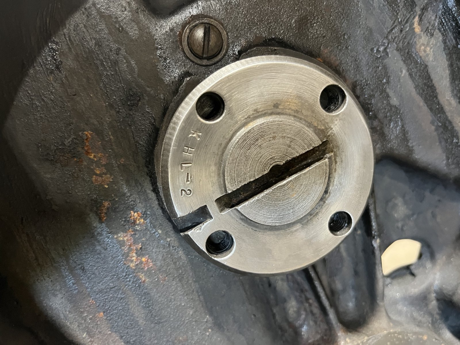

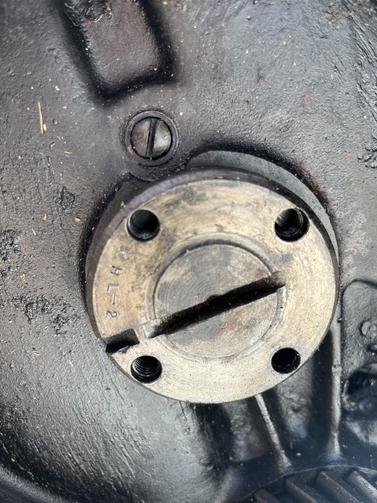

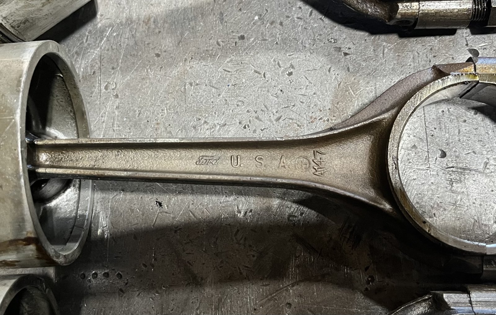

  9. Are the rods 21A or 91A versions? What cam is in it?
  10. LSJUNIPER
    Joined: Aug 17, 2010
    Posts: 254
    LSJUNIPER
    from ct
    YIKES!
  11. 65standard
    Posts: 1,096
    65standard
    Some rods are out and are 91A or 91 and a A147 rod. Cam is a regrind of what? I don’t know. 5A25BF15-DC86-49C5-88AA-49A01F1E7C6F.jpeg 1C98A445-9667-41EE-91F1-309C97AF8191.jpeg 00150DD1-50AA-4D51-A639-B0975E589C4C.jpeg

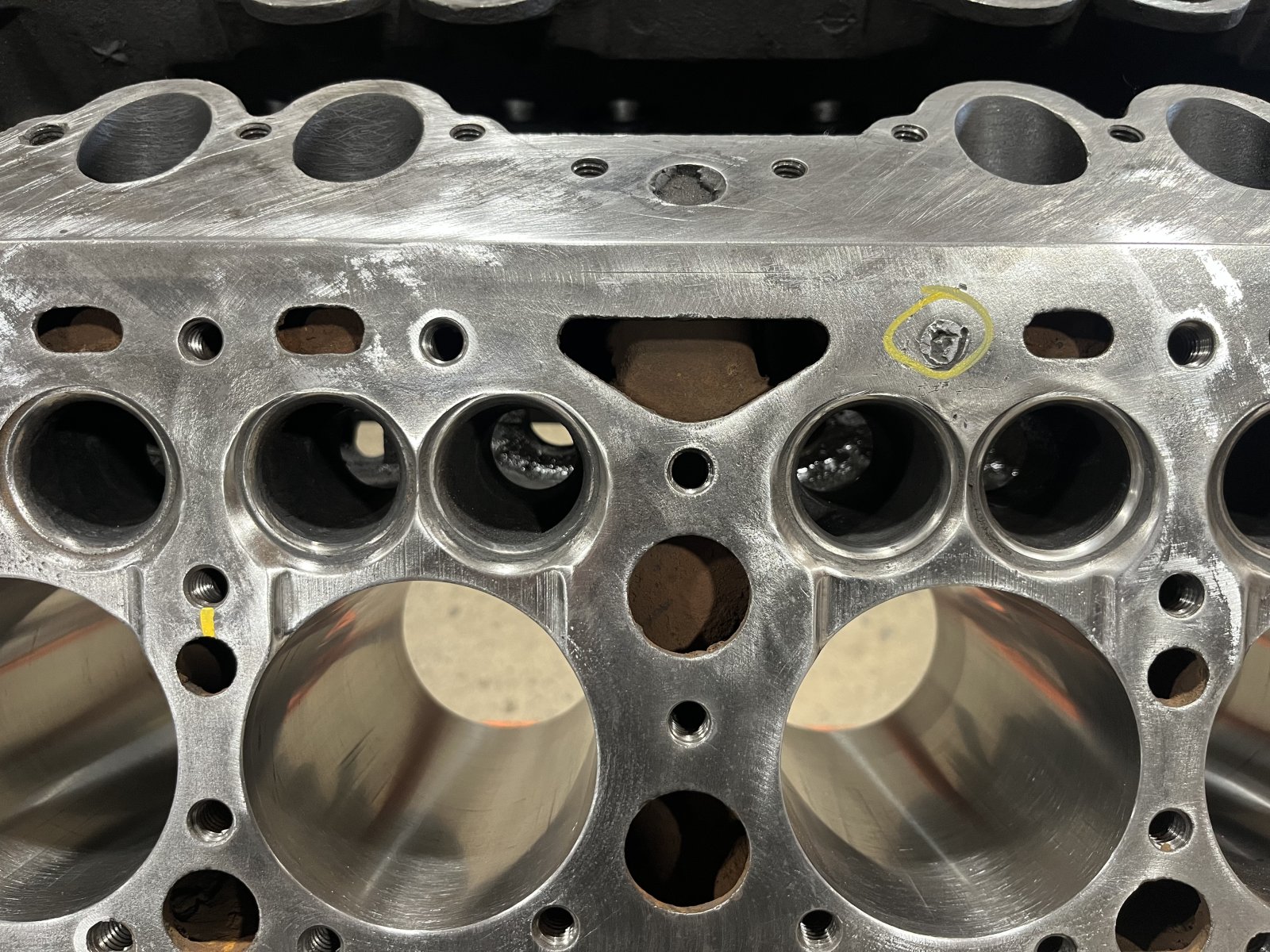

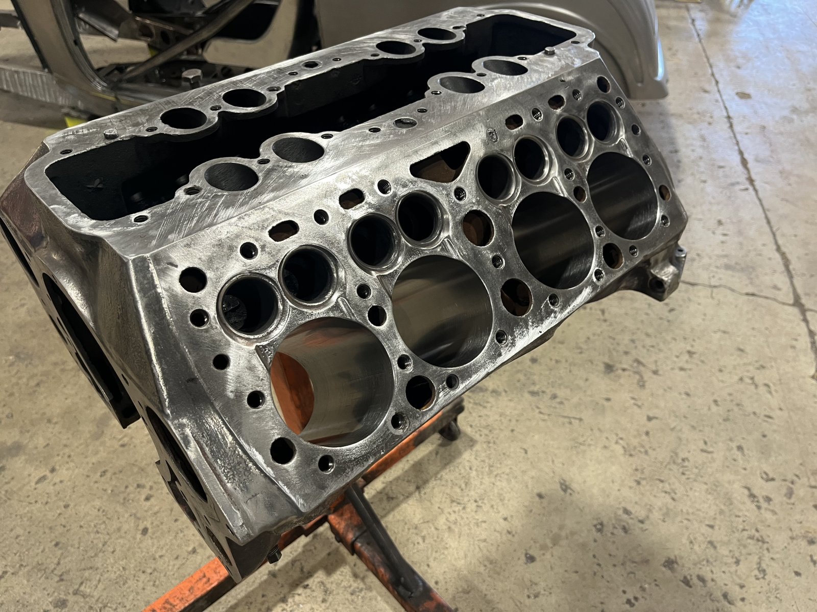

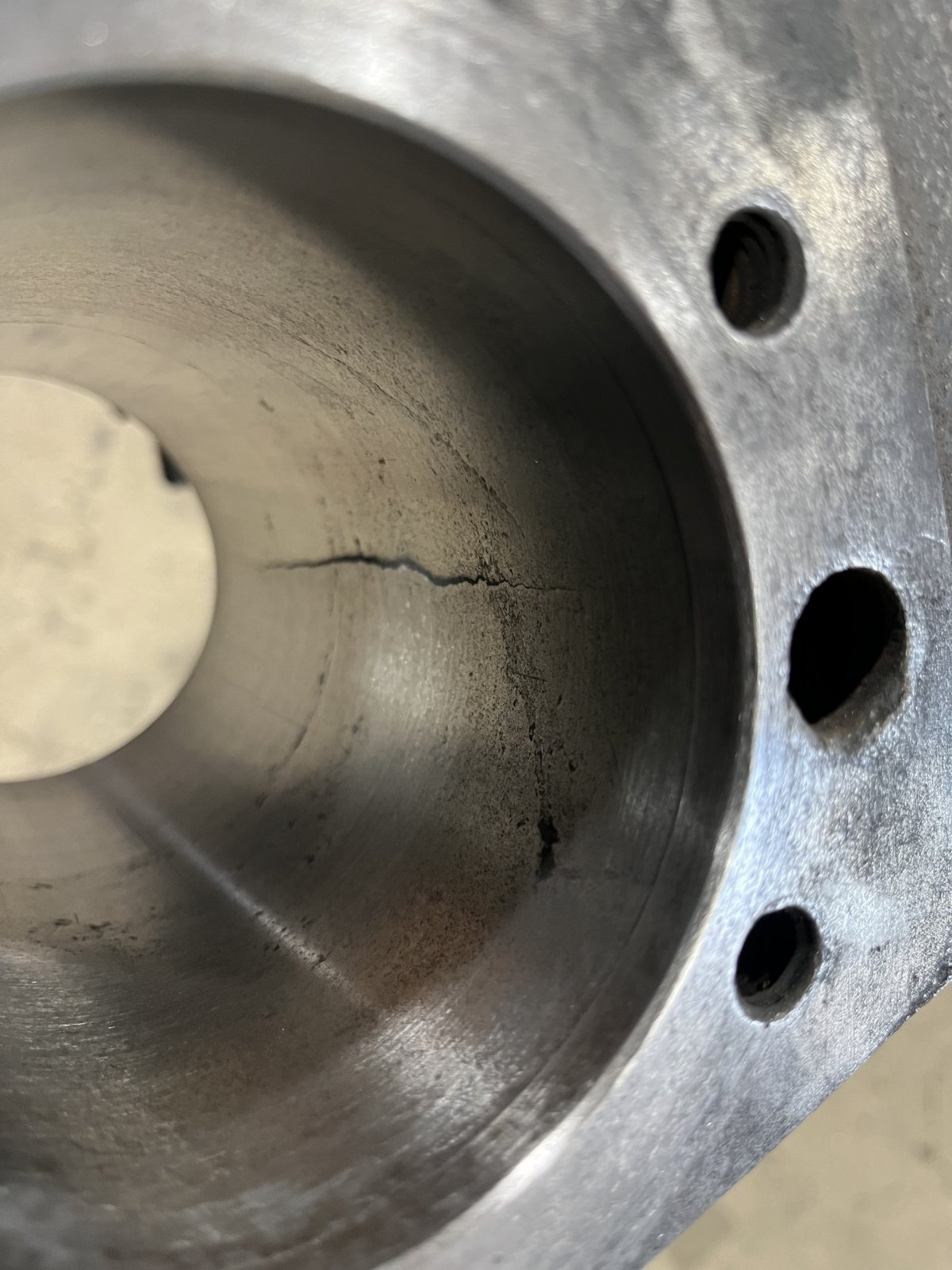

    B200616E-F2EC-4029-B3C1-095E8EDF3414.jpeg D38AF0C5-3659-4237-9570-56FB0BC24B9A.jpeg 7745409C-17DD-4954-9A30-45503D9E25B7.jpeg C2599231-027D-4ED5-944A-498E871E684B.jpeg 4EA7F5D5-0F77-450D-8CA0-C2909DDB49E1.jpeg FA933164-A428-4992-A595-3CEB0375B9D4.jpeg EBC584ED-B9E6-435F-9D18-6001320C7DCE.jpeg This mountain motor flathead has a broken head stud and 3 minor cracks between a head bolt and water p***age. Everything else is good. Cylinders are excellent. No idea what cam it has but I measured .358 lift intake & .395 lift exhaust.

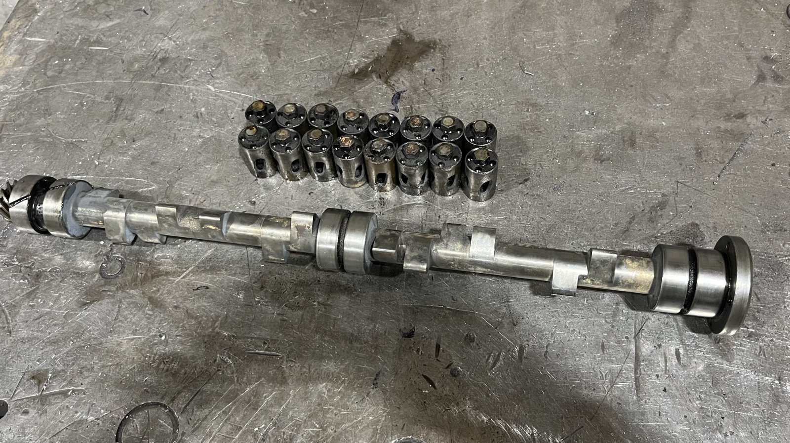

    0CA4BBE2-DB4D-4D2D-8352-B656E6A9BB27.jpeg The cam and lifters.

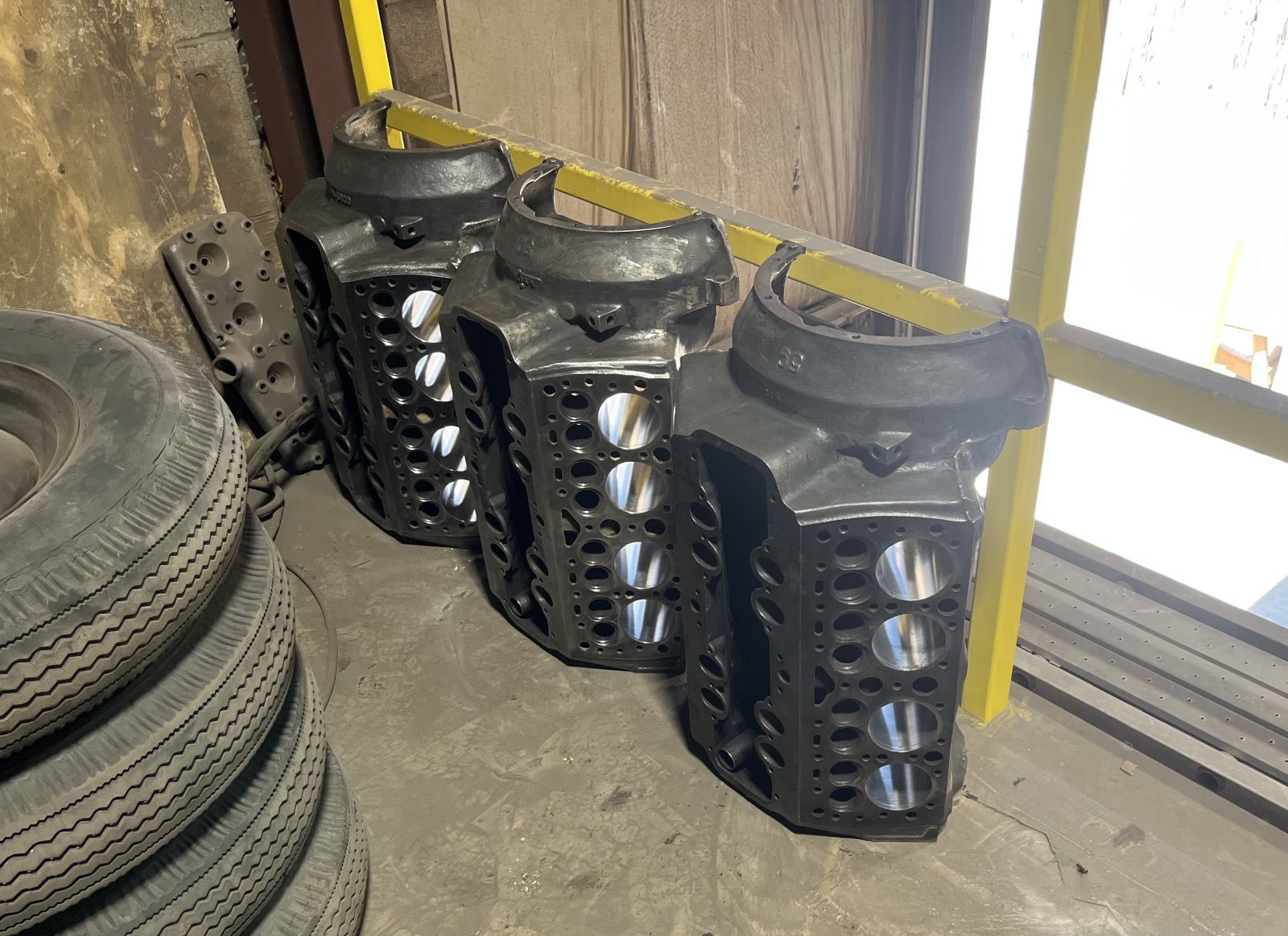

    1509CF55-0773-41DA-81F0-B7356FF38FD2.jpeg And the 3 blocks worth saving.
    One standard bore
    One .040 over bore
    One .100 over bore

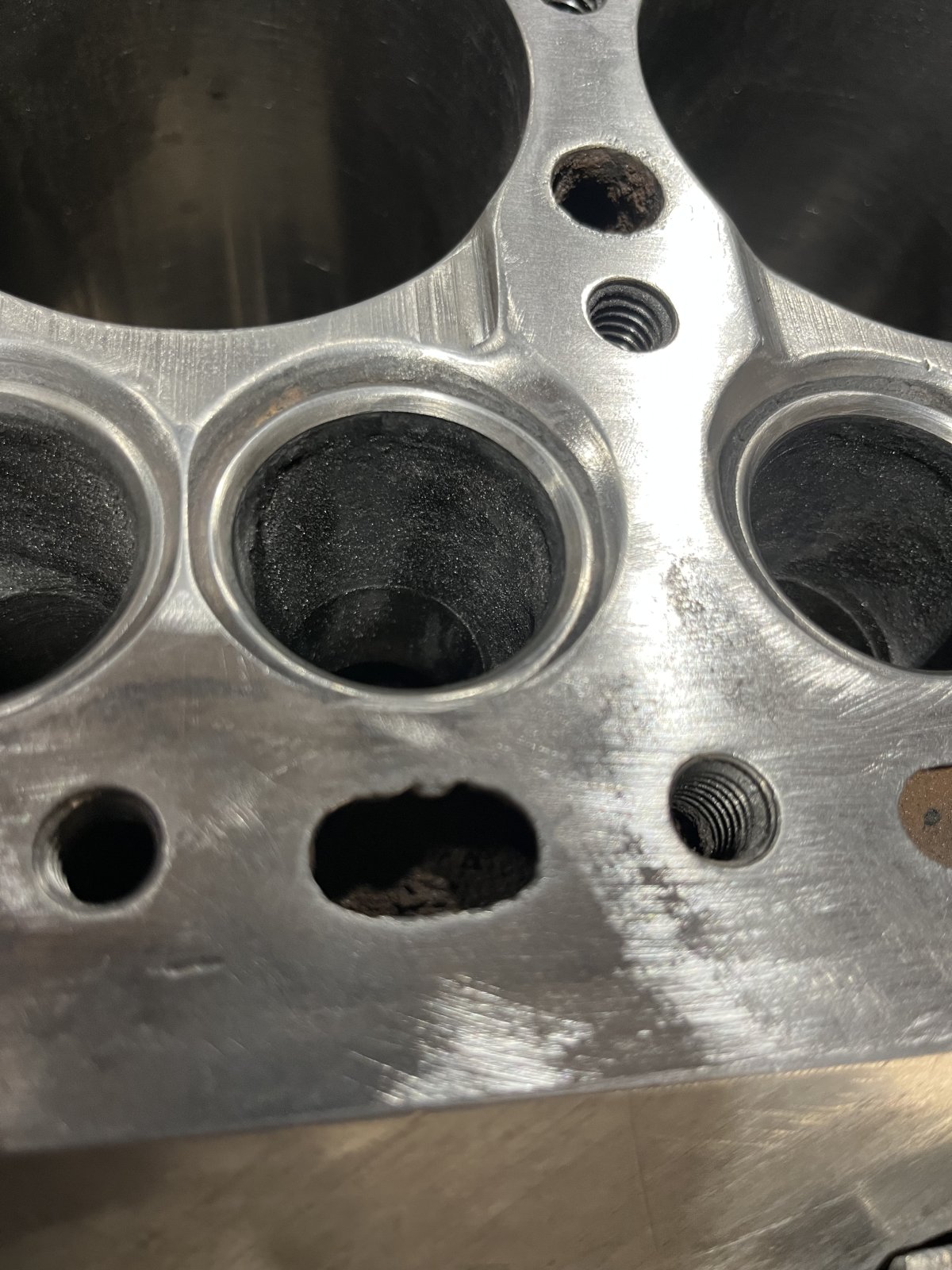

  15. I think you scored with this engine! I don't recognize the front of the cam, but the profile almost looks like a Harman-Collins grind. You might check around the perimeter of the front flange - H&C normally marked their cams in this location. The cracks from the stud to the water jackets are a total non-issue . . . some of us believe Ford even gave them a "part number" - they happen so often. ;)
    Make sure you have the block sonic tested . . . so important to know what you have to work with. If you like the results, then make sure to pressure test it as well. It has some scoring and pitting in the bores, I would consider boring it the least amount possible.
    Ross will make you pistons to fit your bore size. I would look for metric rings before you decide on the bore -- using 1.5, 1.5, 3.0 ring packages (or similar). If your bores are 3.360 (with no taper), consider just having them honed for 85.5 mm rings (3.366 bore). In today's world, always select your ring package first - then use them to determine your piston configuration.
    The modern metric rings are a whole lot better than the good ole' Grant or Hastings stuff we used to all run.
    I'm quite hopeful for this latest engine!
    If you need anything, just send me a private convo request.
    Cheers,
    B&S

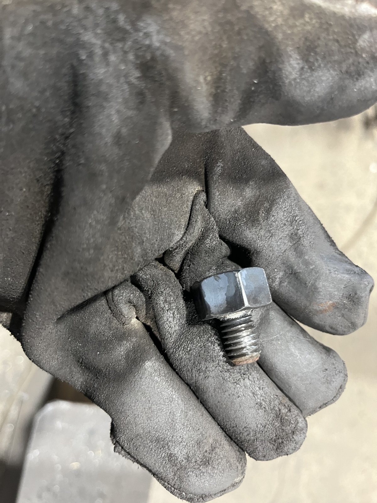

  16. 65standard
    Posts: 1,096
    65standard

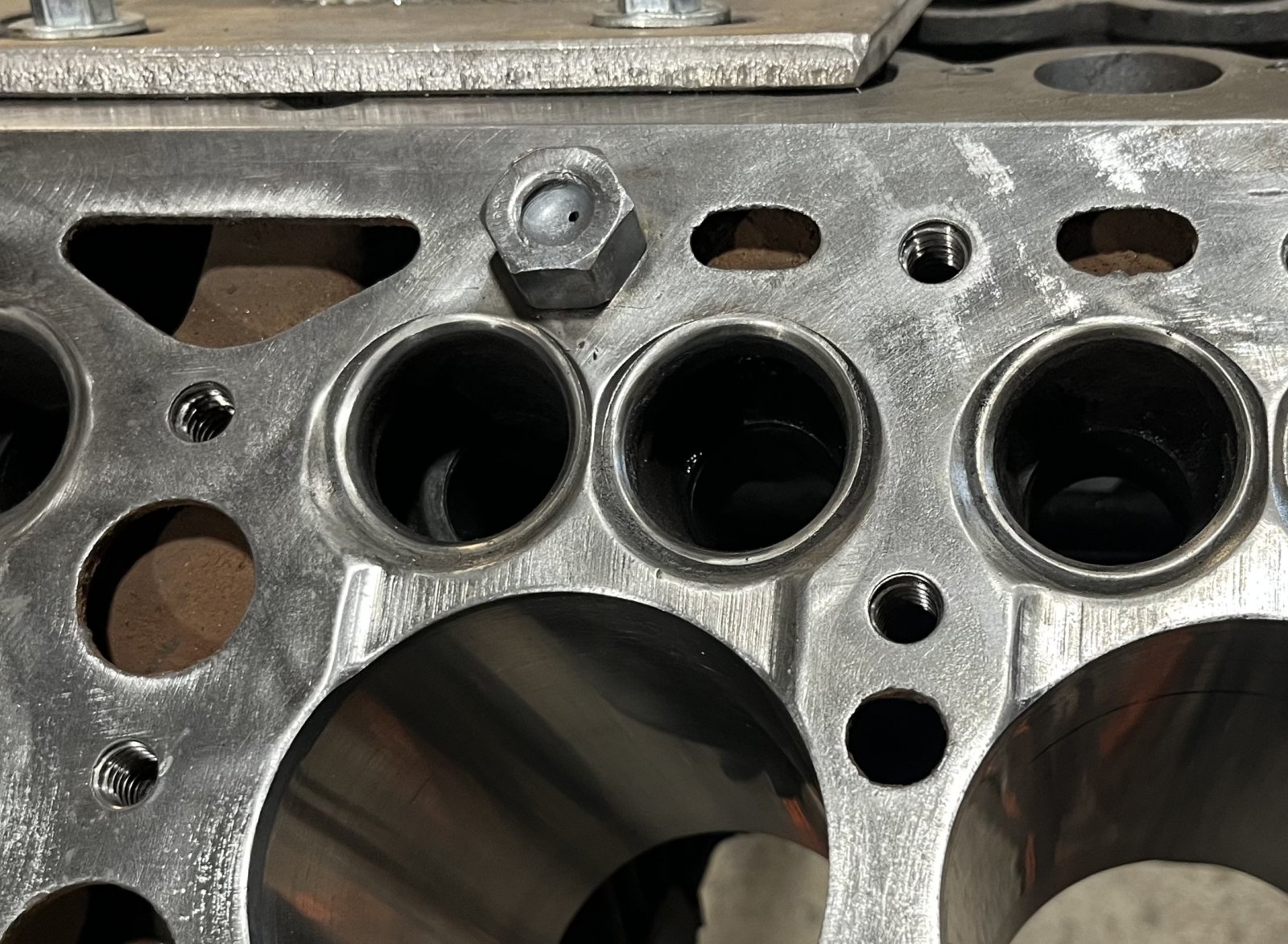

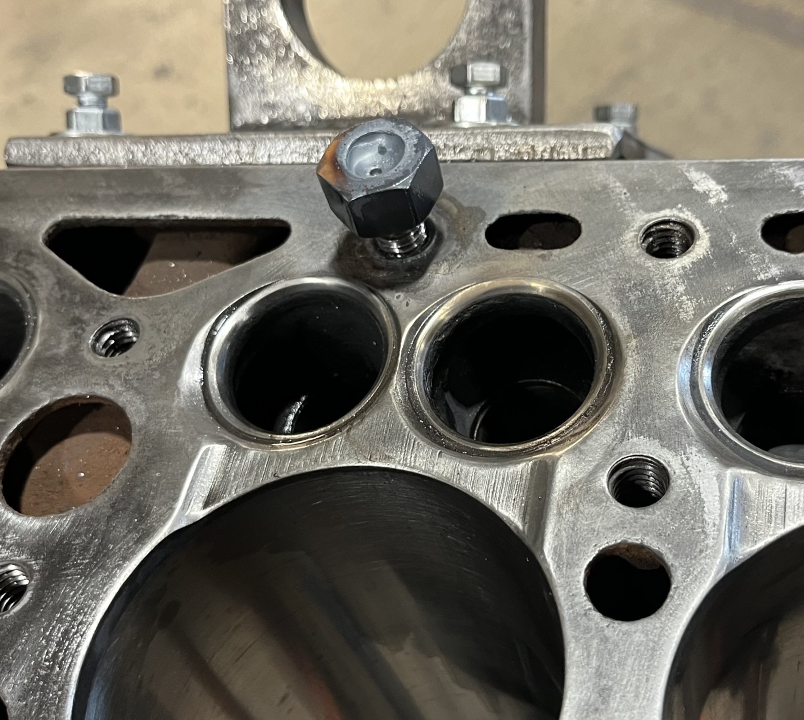

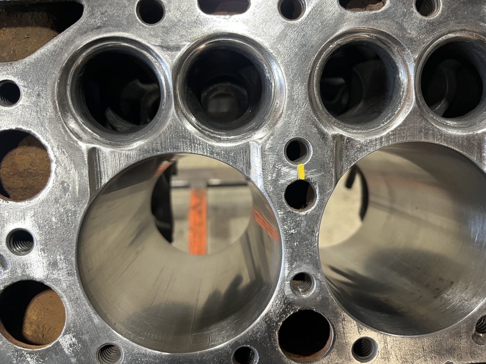

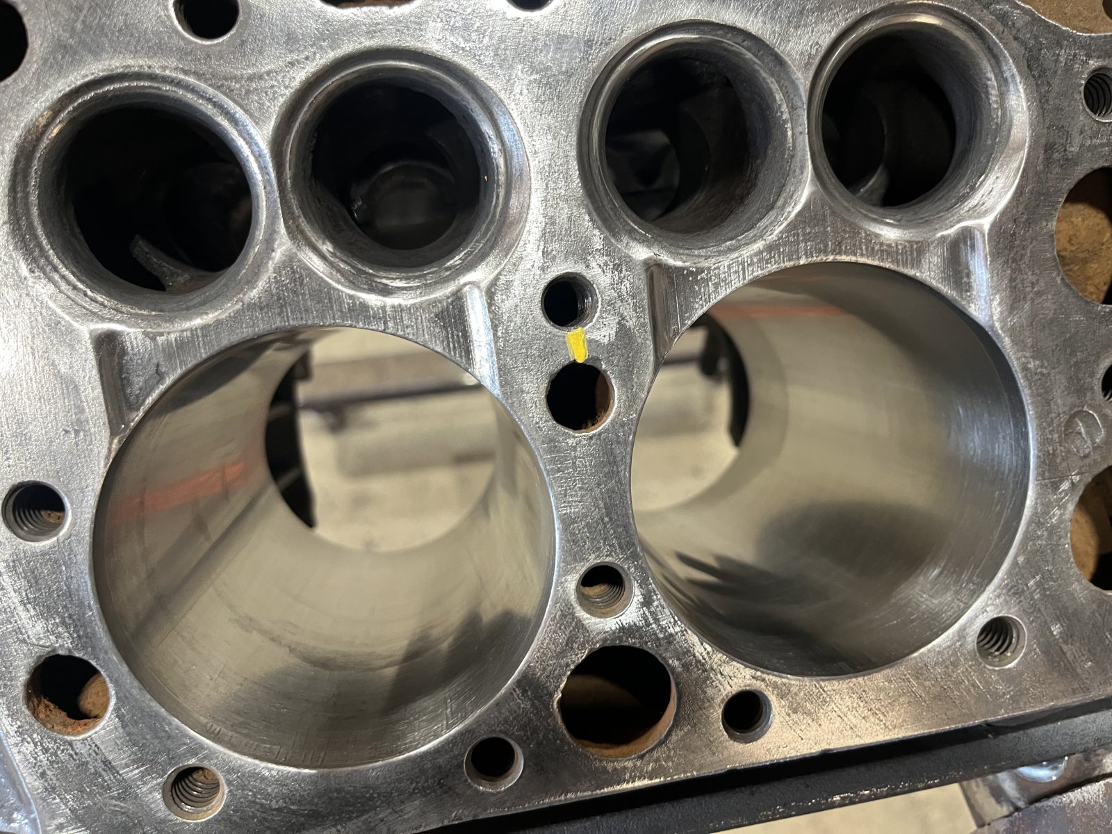

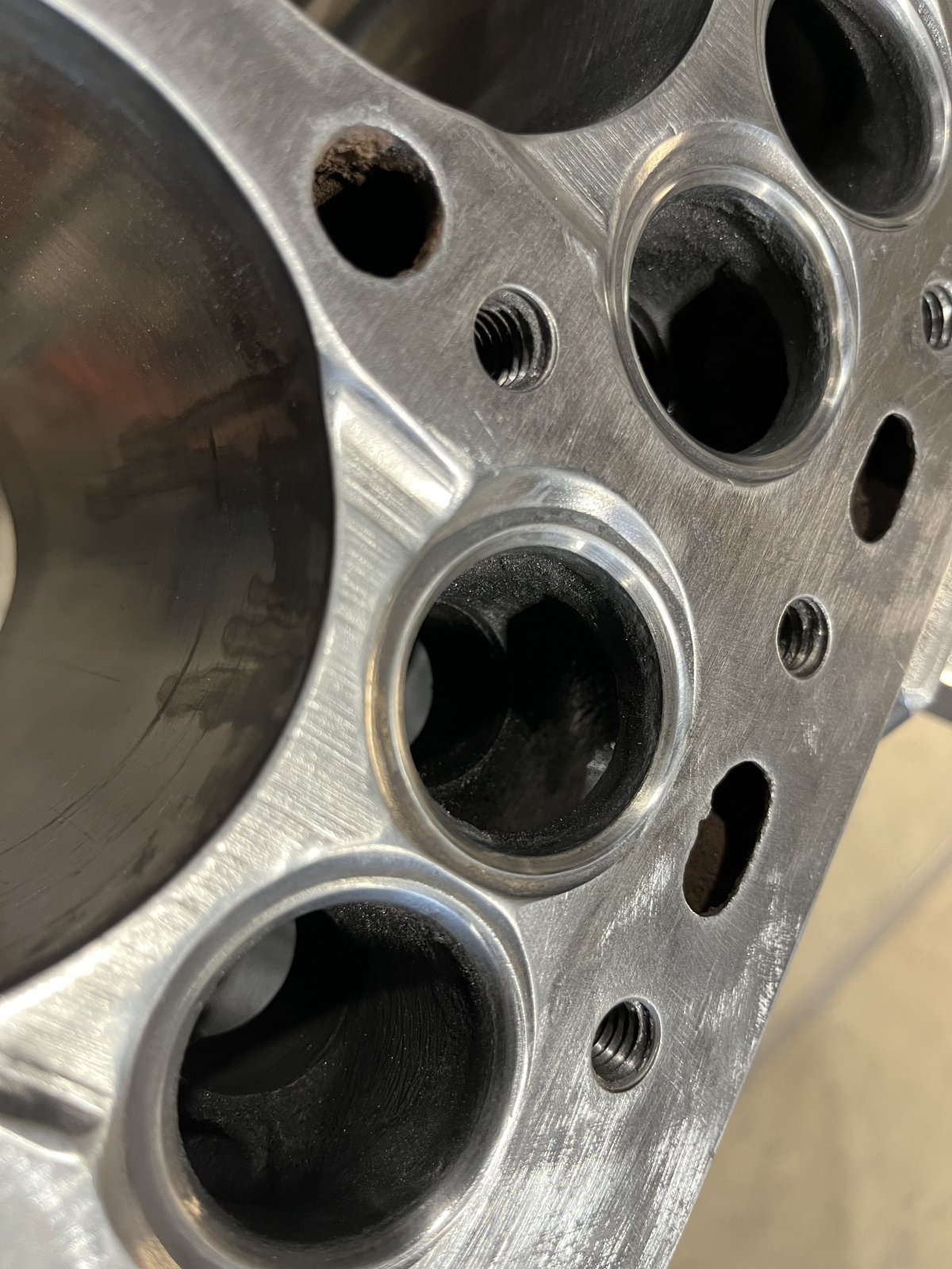

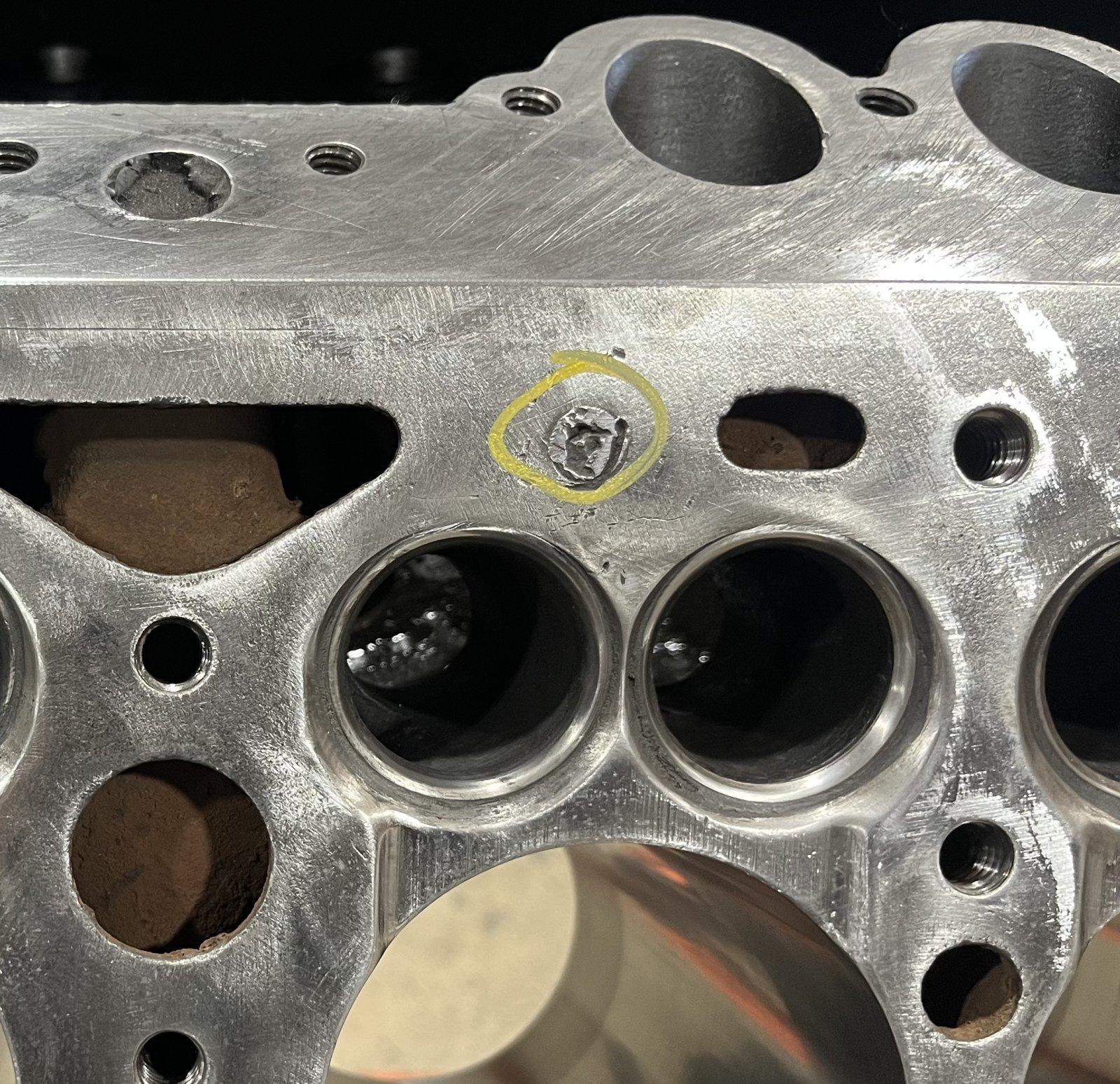

    B98DD733-FCBE-4700-A77B-AAF399BD2FC0.jpeg 513938F6-857A-4C92-BA76-0333F81BD669.jpeg 2ACC992B-B68F-456B-AA1F-0B9FCDE909E3.jpeg A89407E5-E62C-43EB-BE39-928C330F41D6.jpeg DC0DF3FB-9713-40DE-9278-CFD52B9C516E.jpeg I removed the broken head bolt.

  18. Great Job! The block doesn't appear to be ported . . . and it if is, not by much. What do the intake bowls and ports look like?

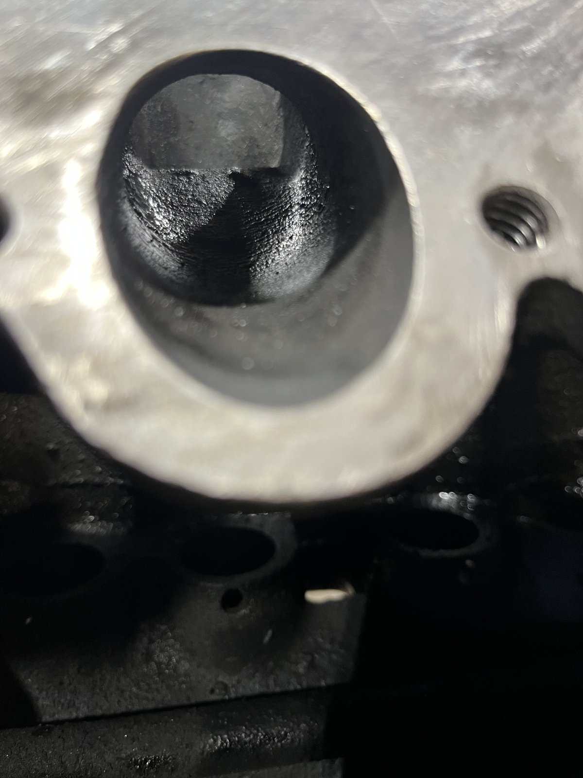

  19. 65standard
    Posts: 1,096
    65standard
    4C238E46-3930-4EFB-8183-1094386A520F.jpeg 4CA7B396-711E-472B-BB02-11B1AA5224BD.jpeg D05CDC84-ADB8-412D-9407-FA42AE37F224.jpeg I don’t think the ports were touched. I will port match the intake side. I took a gamble and paid $250 for this big inch motor. I figured that the crank was worth the price even if the block was no good.
  20. Yeah, no port work done. There isn't a whole lot to be gained by porting - unless you plan to run at higher RPMS.
  21. banjorear
    Joined: Jul 30, 2004
    Posts: 4,966
    banjorear
    For that big of motor and that it's already stripped down, I'd think about opening the exhaust up to 1 3/4" and cleaning up the center exhaust port and removing as much of the "lip" just inside of the the end exhaust ports as well.
  22. It surely won't hurt . . . though the intake side of this block is stock . . . so if it was mine, I'd concentrate on both ends of the system. It also depends on what his goals are for the engine, how he wants to drive the car, etc..

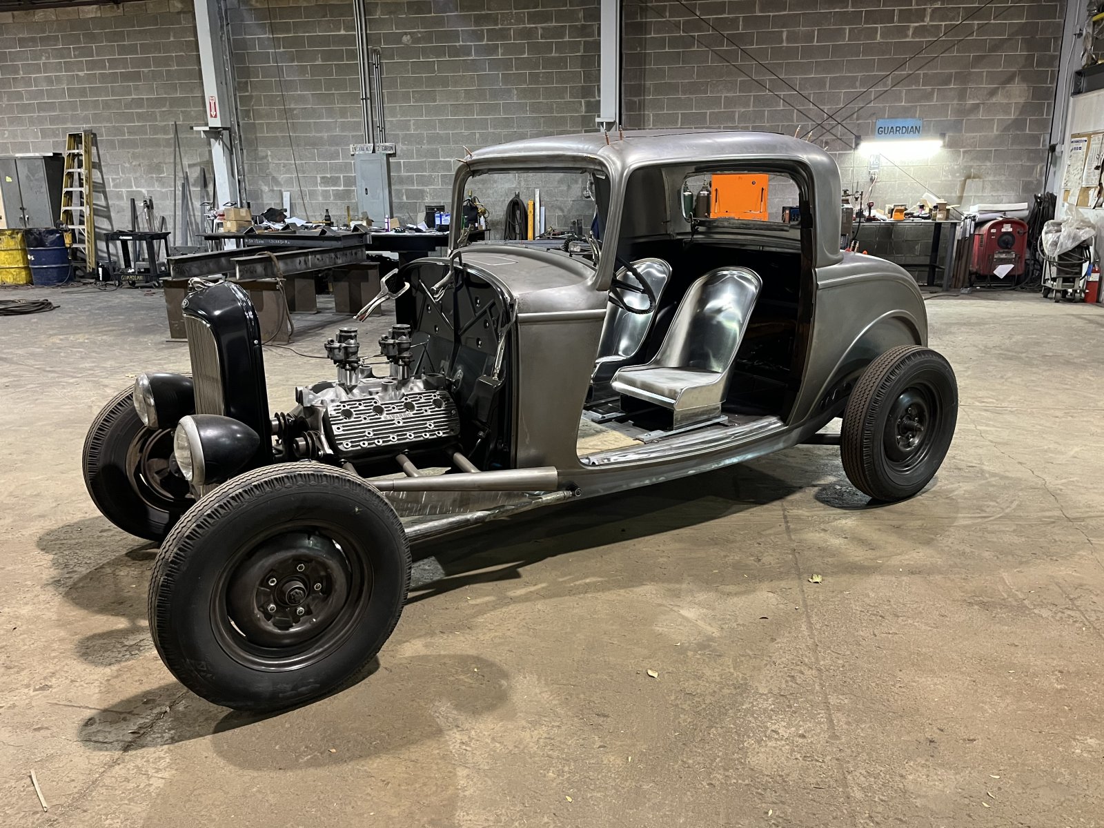

  25. 65standard
    Posts: 1,096
    65standard

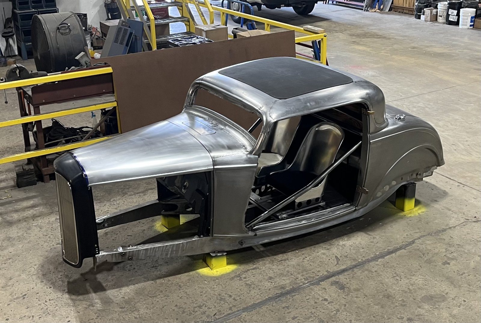

    the flathead is going in my 3w. This car is all about the sound and looks
    3B9F369C-48B9-4E35-BEAB-7B3F34871272.jpeg D058F864-235F-4AE1-9FA8-BC0AA70983C0.jpeg 82B0D121-E956-4CF3-A308-88F5D432EB40.png

  26. Then you're going to need a nasty *** cam! LOL
  27. 65standard
    Posts: 1,096
    65standard
    Yes. A big Isky cam. Probably need a bigger cam because of the extra cubes. Just have to see what is recommended
    61Lancerwagon likes this.
  28. banjorear
    Posts: 4,966
    banjorear
    Dang. Looks great! Agreed. Nasty cam. Potvin 3/8ths or Eliminator if your heads can be flycut or take the lift would be my choices.
