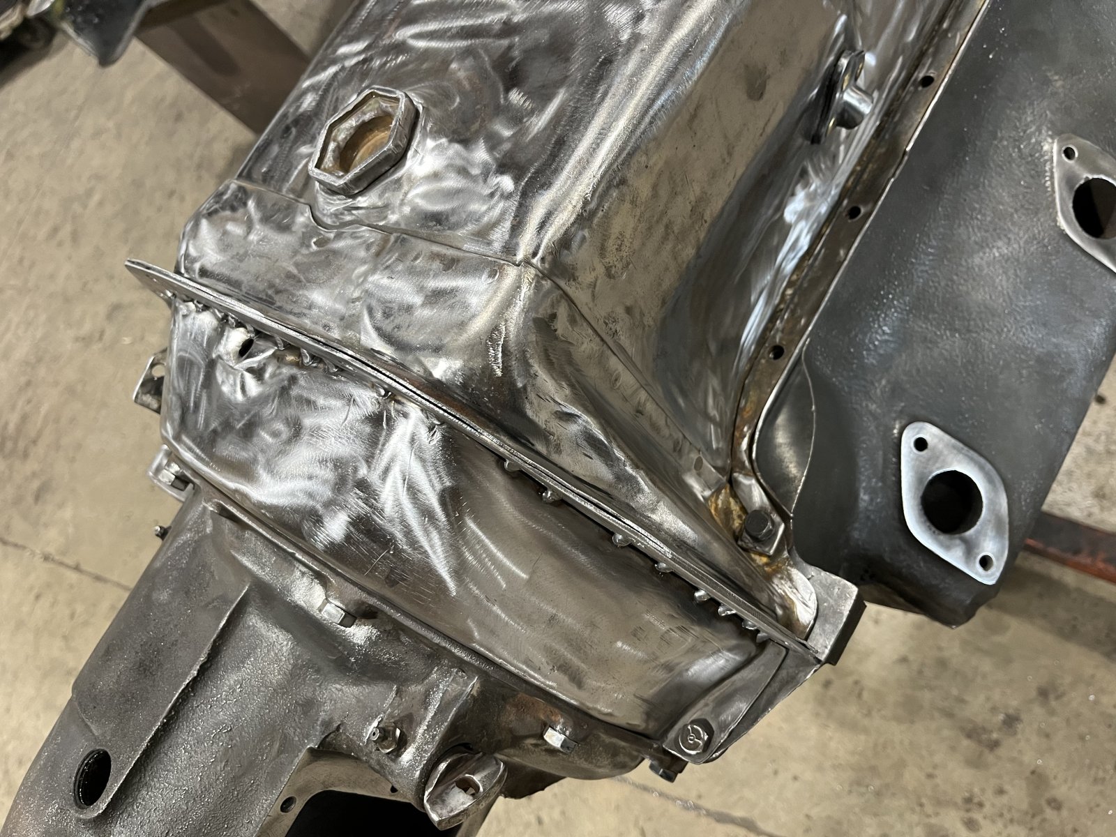

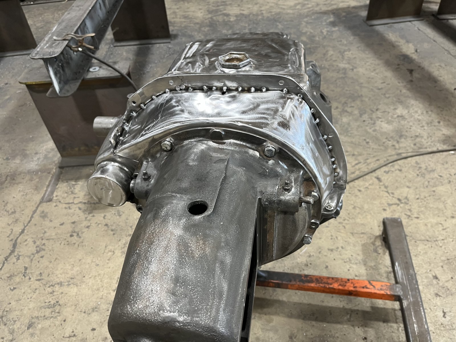

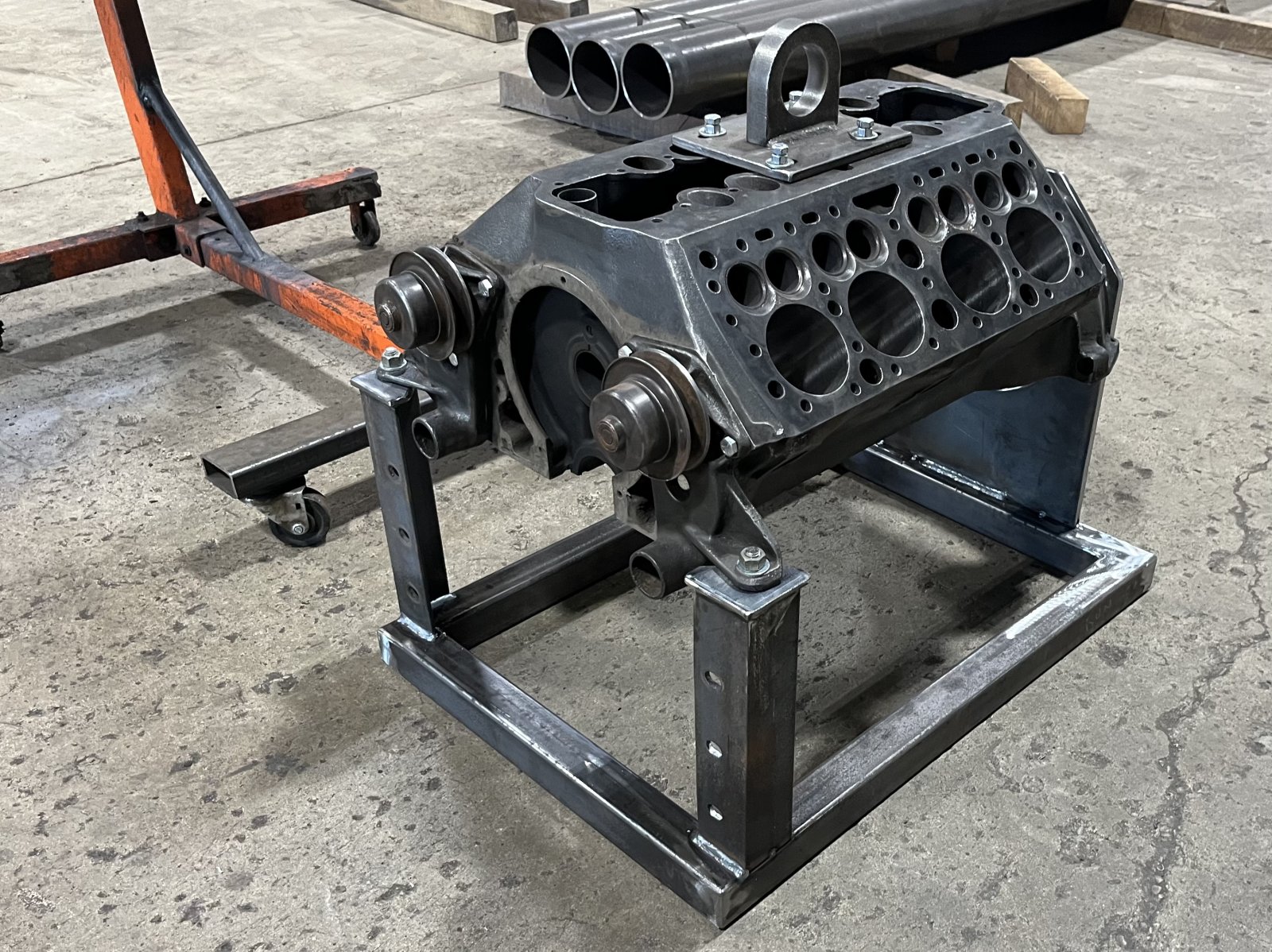

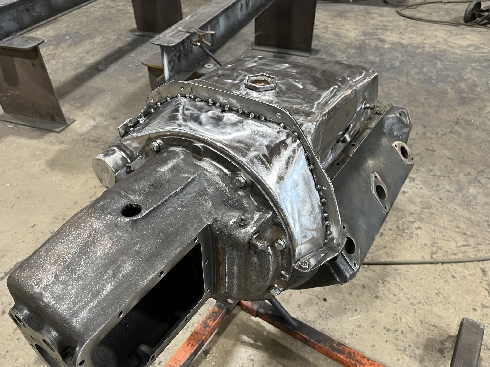

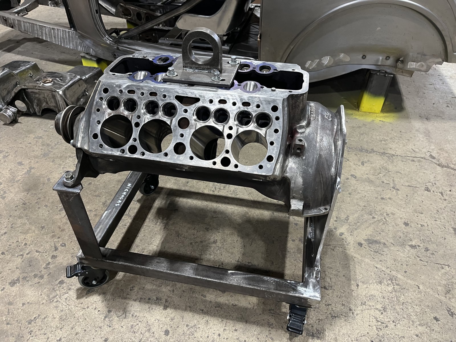

    B68B6EF4-4066-4928-9D23-529B9D55321D.jpeg AD9F347B-07FA-4289-86D8-8BE546F2364A.jpeg Thanks for the cam recommendation. I’m building an engine cradle that I’ll turn into a run stand for the flatheads.

  5. You should have your water pumps rebuilt/updated by "Skip" down in Punta-Gorda. He puts sealed roller bearings in the castings and has an improved impeller that pumps a lot more water. This is all the more important when you're running a big-cube motor as the cylinder walls are thinner and the added horsepower creates more heat.
    You should put the crank in the block with a rod and piston pin in each bank - to determine the exact compression height you'll need for your pistons. Don't do this until the machine shop has checked the deck height and probably 'square decked' the block. You can then determine the center of the pin location from the new deck surface and this number (the compression height) can be specified with Ross - such that you get pistons that are exactly where you need them as compared to the deck and head chambers. You'll want .040 to .045 above the piston - to the head chamber (with a gasket in place).
    Run Stand: Nice work! Only use this to start the engine, make sure you have oil-pressure, bring it up to temp and check for leaks. Do not make the mistake of running it a bunch on the stand (even though folks think it is fun/cool). If you don't put the engine under load, then the rings won't correctly seat in the bores -- so get it off the stand and into a car to complete the break-in cycle.
    Also, what size did your bores measure out to? I'll look for some metric ring sizes - that you'd want to give to Ross as well. You're best off to end up with metric rings and a metric piston size -- don't just go to 3.375 because that is what they did "back in the day". We have much better ring packages today . . . make sure you use them!
    Okay . . . back to work . . . enough babble out of me!
    61Lancerwagon and chlsnk like this.

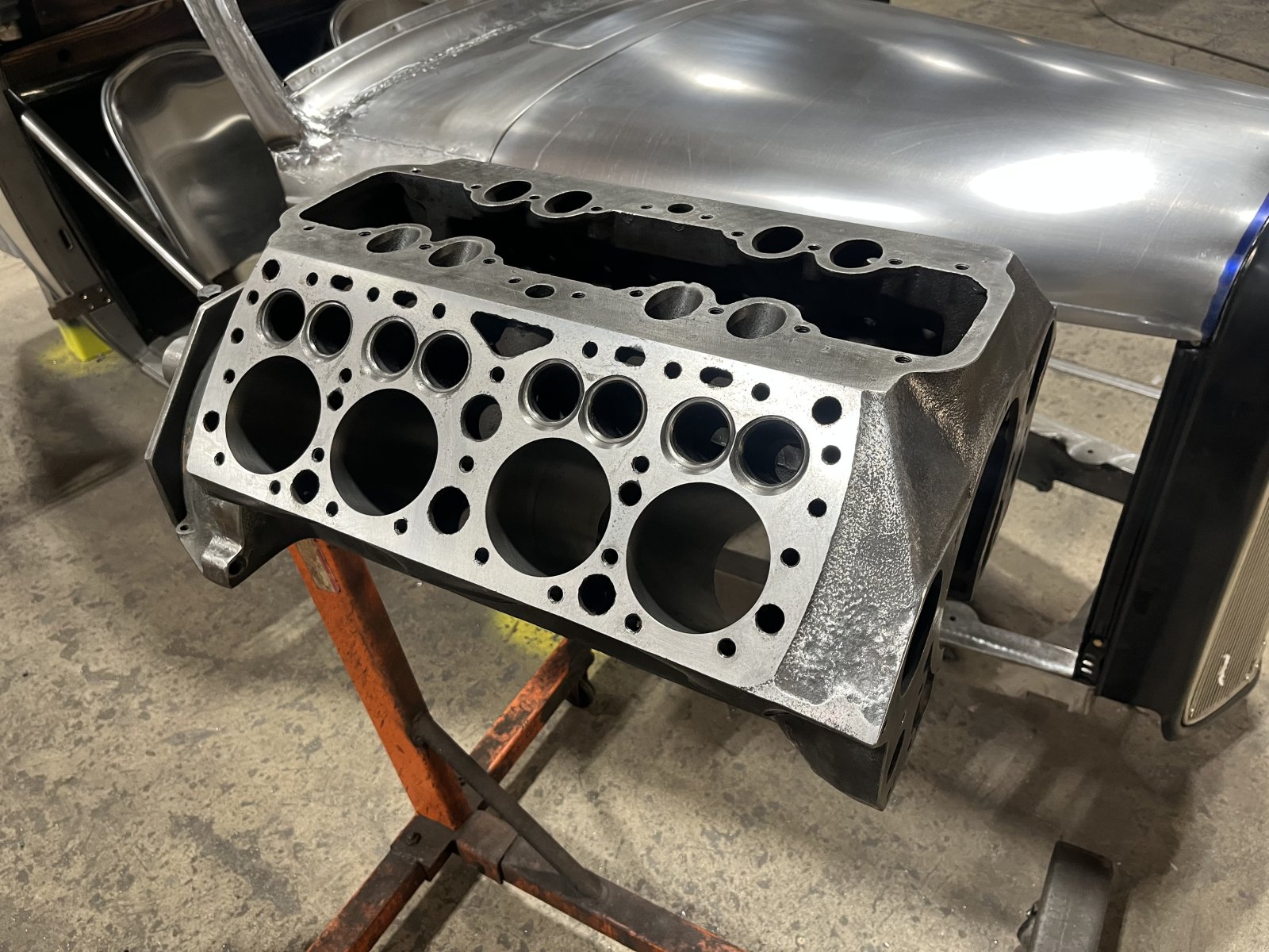

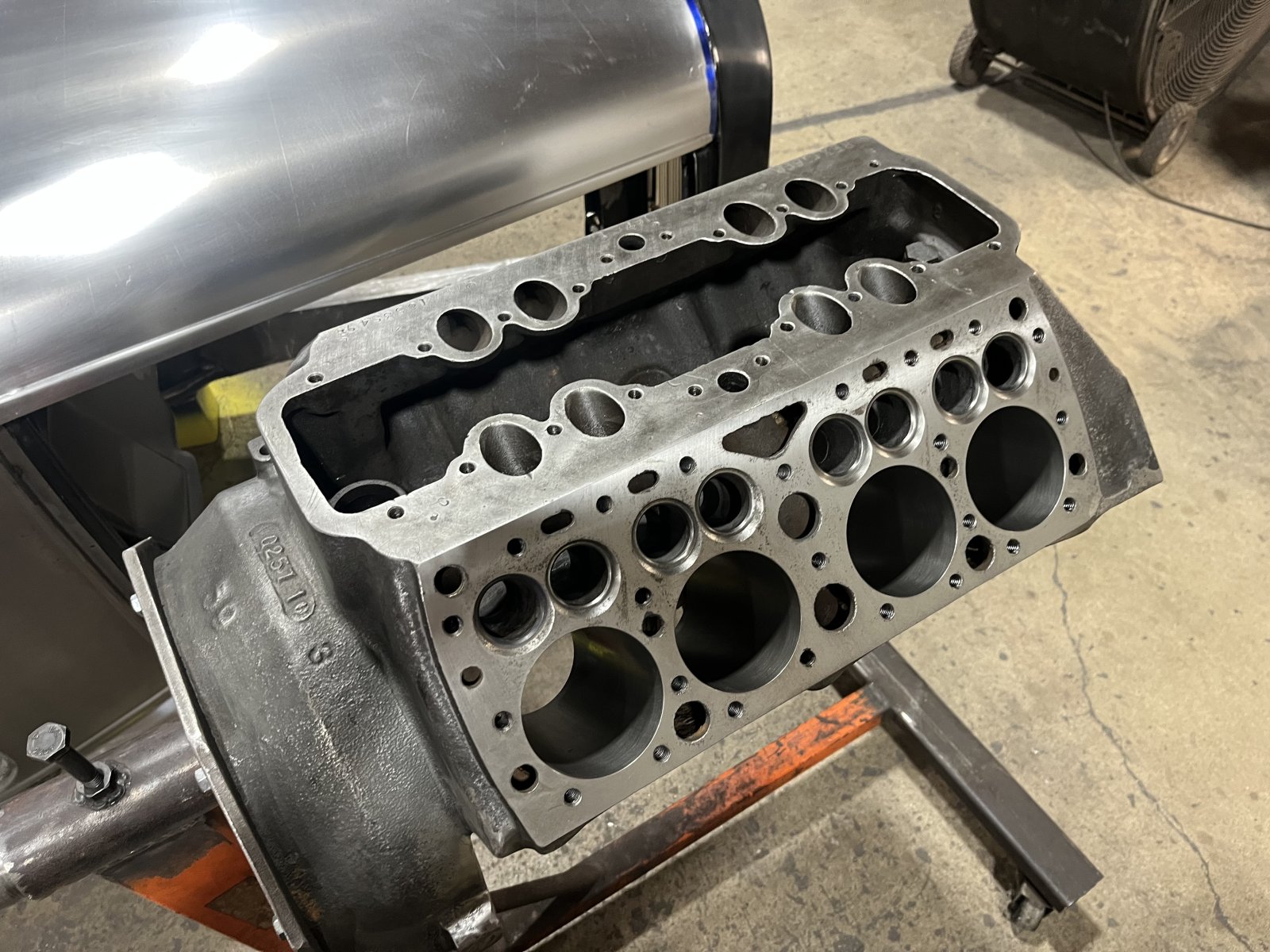

    Block is ready for its final honing. Crank is back from the race shop. New rods, bearings, race pistons, and Moly rings are going in it. Haven’t decided on which oil pan to use. I like the one with the removable section to replace a clutch without pulling the oil pan
    215857CA-CC2A-4CF7-BCE8-CEE6685E8431.jpeg 7C12EAED-E97C-45E3-B075-1AA7F873B775.jpeg 5A758EF4-1319-40BD-A79E-570D5F38707F.jpeg
    Desoto291Hemi likes this.
  10. Hopefully you have the complete reciprocating ***embly balanced. Which CAM are you going to run? I'd be thinking about a Potvin 3/8 . . .
    Did you have the block decks checked? Make sure you measure the compression height so you can get pistons with the pin in the right location. Buying standard "stocking pistons" is usually not the way to go.
    Best of luck!

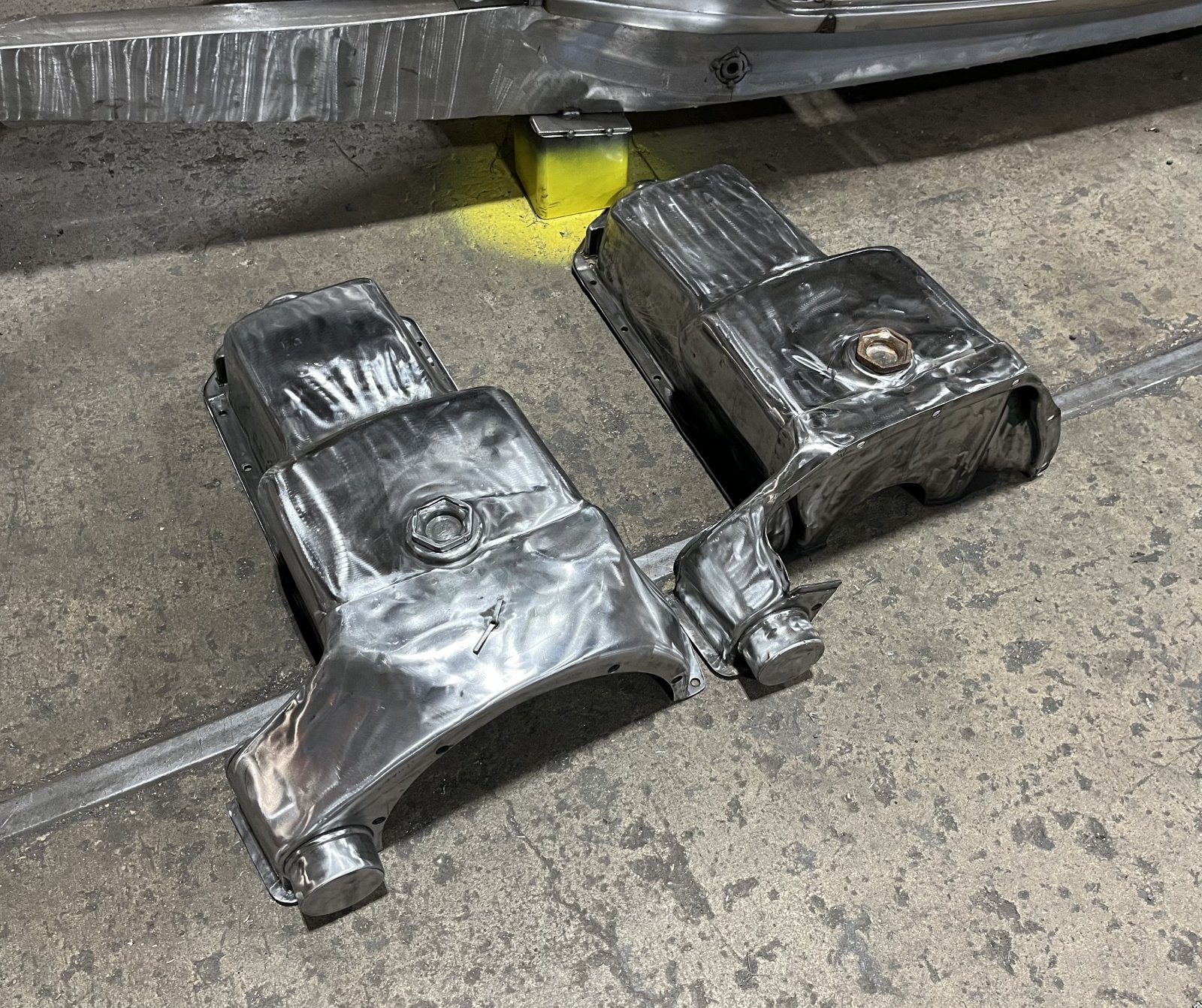

    I'm running a 59A with the two piece oil pan and its the only way to go. It saved me from pulling the engine several times.
  14. The two-piece oil pan will not do you any good unless you have the engine/trans in a ch***is that makes it possible to remove the transmission while the engine is still in place. If you're running a stock 32 K-member, then I always pull BOTH at the same time - is really about the only viable way to get to the clutch.

    I like the two piece oil pan just for the fact I can put the pan on and the flywheel afterwards. It will allow clutch inspection while still in the car.

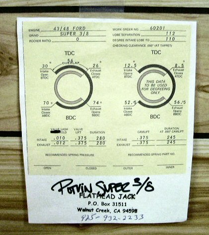

  20. Here is a pic of the cam he ground for me .
    Tommy
    61Lancerwagon likes this.
  21. Metal Jewelry! Love Pete's work . . . and he is one solid dude!

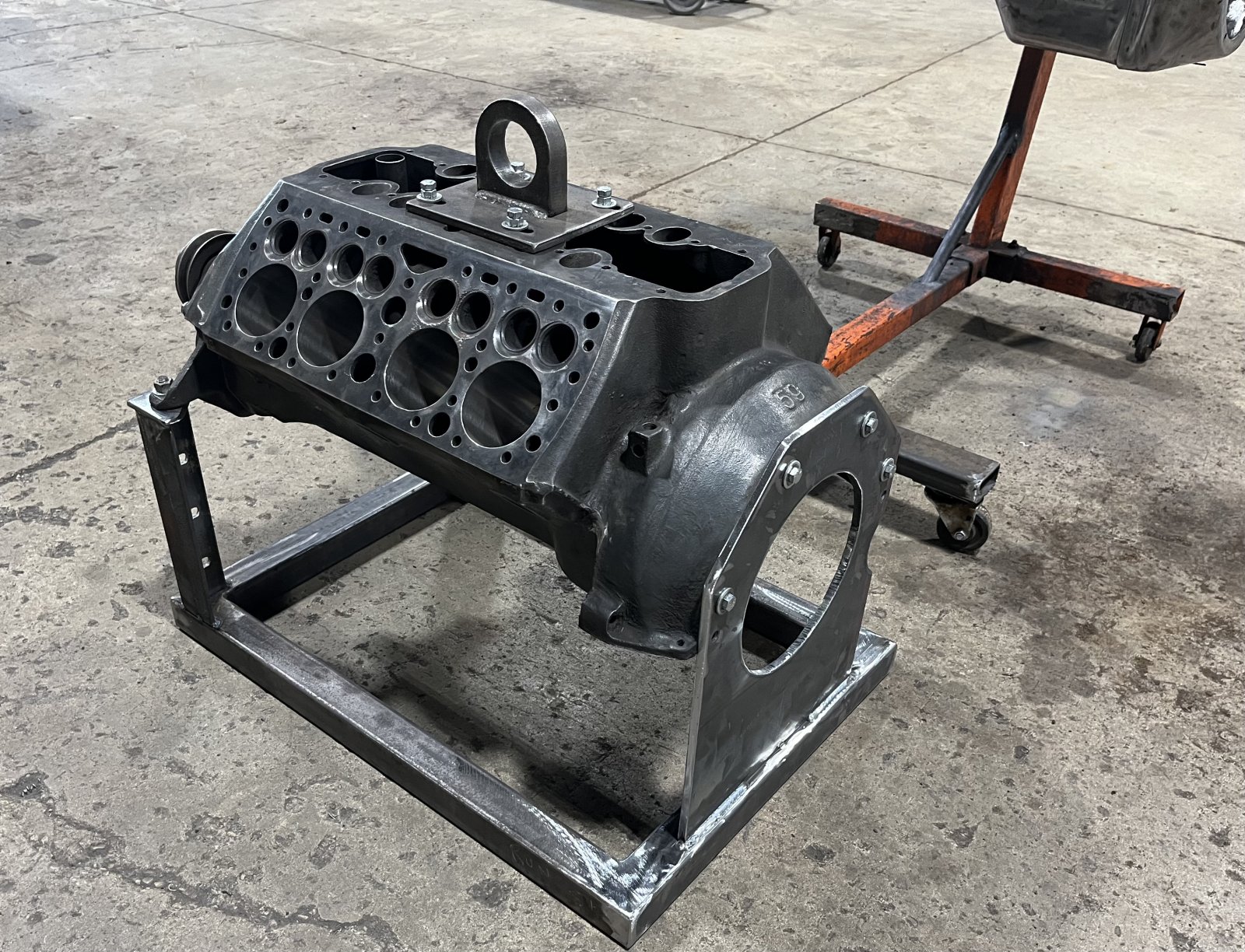

    0FB773CA-2EC9-4BAB-9263-DD11F315DCAB.jpeg C05A49D9-23AD-46D1-B726-A65AA0CE79E5.jpeg C5861903-44AD-4799-878B-A01929DD863D.jpeg I’m fabricating the missing clutch inspection cover for the 2 piece oil pan. Just have to weld it up

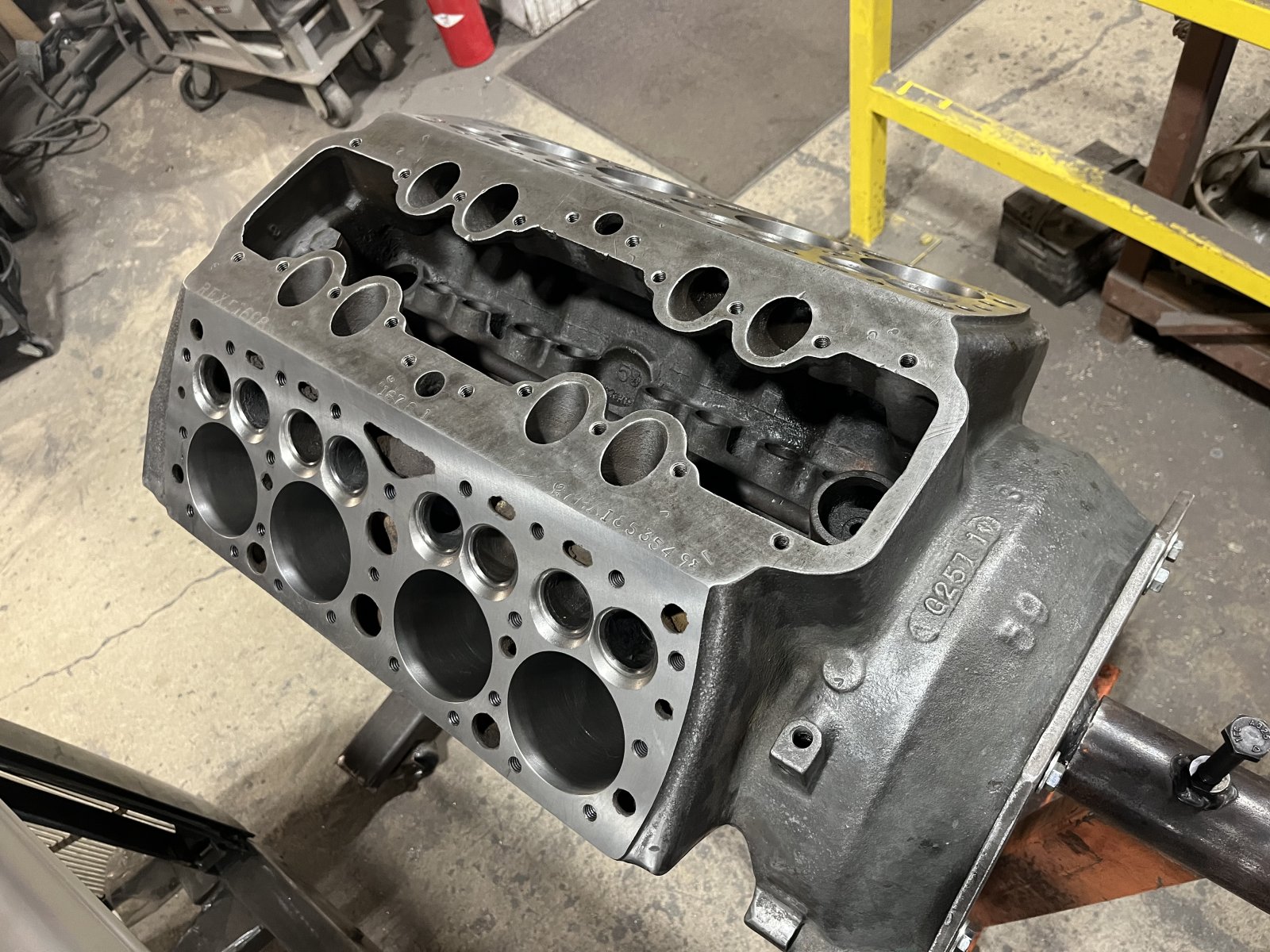

    Things have gone sour again. The big bore block has too much piston to bore clearance (between .005-.008). Max should be .004.
    The first block with the cracked water pump area has the wrong center main cap.
    The other two blocks have a cracked cylinder wall.
    I’m batting zero out of 5 so far.

    As long as there's no taper you could order up a set of Ross pistons like B&S suggested and be the better off, I'd think. If they need bored I guess it's only money.

    This. If everything else checks out with the block, I'd give them a call to see what they say. I had to get custom pistons made for mine. I believe it was a $250 overcharge and it took 6 weeks total time from order to arrival.

    I have block #4 back from the machine shop. This was the block that was .100 over but a cracked #1 cylinder. I had it sleeved and bore to 3.375. Sonic tested, magged, and decked. The 4-1/8” crank was turned and polished. Finally received my H-beam rods from ****. My stock cam and Isky lifters were sent to Pete for the Potvin 3/8 grind.
    I will mock up the crank, rods, and pistons in the block and then get everything balanced.
