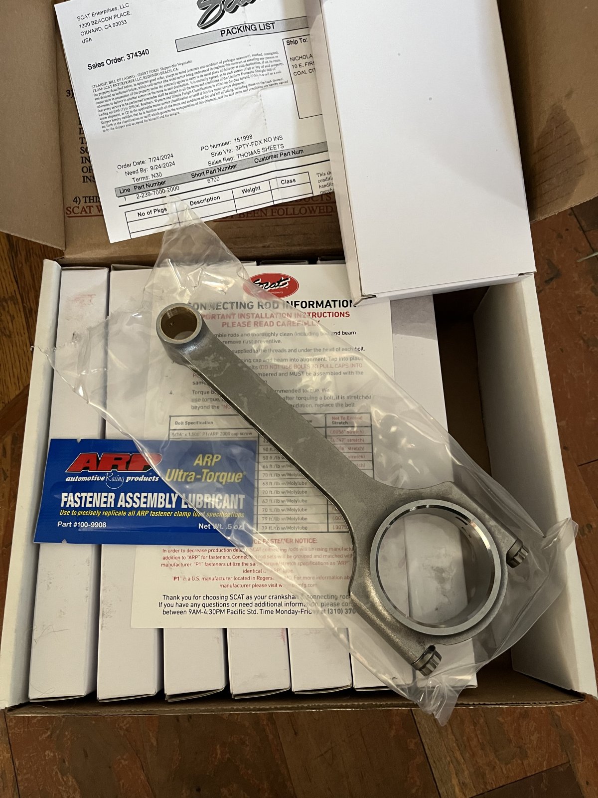

    C1D7B52A-AC12-4A40-A8FF-891E4F5B8365.jpeg B340753A-4C44-4DC2-A1EC-CC94F2D8526F.jpeg And these **** rods will make me feel a little better. Even though I have NOS pre-war rods, I was nervous on using them. They look so fragile. The **** rods look much better.
