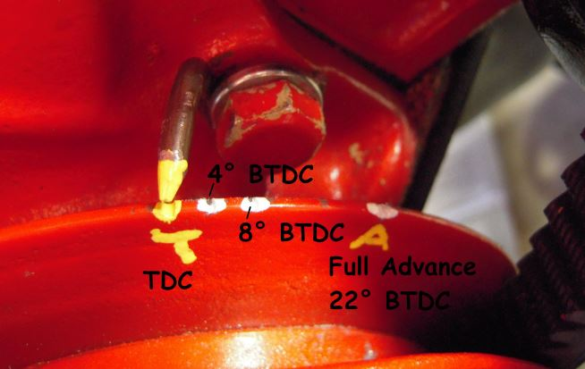

    I used the so called "zip tie method" to find TDC on my ***embled 59A.
    Once I found it I made a wire pointer and filed a groove in my crank pulley. I calculated the arc lengths (see pdf attached) for the degree markings and also put on paint marks at every 90°.
    https://www.jalopyjournal.com/?p=10940
    "Heads ON: Slide a large tie-wrap or any sort of lump on a wire through plug hole and against farthest point where it hits the wall. Have apprentice holditthere. Rotate as above… Bump, bump, divide. Repeat a couple times to be sure it is repeatable and your stop isn’t moving. Have apprentice flogged if inaccurate.
    Once you have TDC nailed…
    Go mug an eighth grader leaving his plane geometry cl***. Steal his protractor and comp***, discard the rest.
    Draw a circle on a piece of cardboard matching OD of your pulley. Draw a larger circle around it from same center.
    Put protractor on center, draw lines at whatever interval you want – 5 degrees is adequate for estimation, can be as many degree points as you want. Mark off about 30 degrees.
    Cut out inner circle, hold your new device over pulley with beginning line at your TDC, mark off rest of degrees. Can be permanent file or chisel marks, or just mark a swath with liquid paper and pencil in the lines.
    You now have accurate TDC and permanent or easily re-doable scale for full range checking with a simple timing light.
    Bruce"
