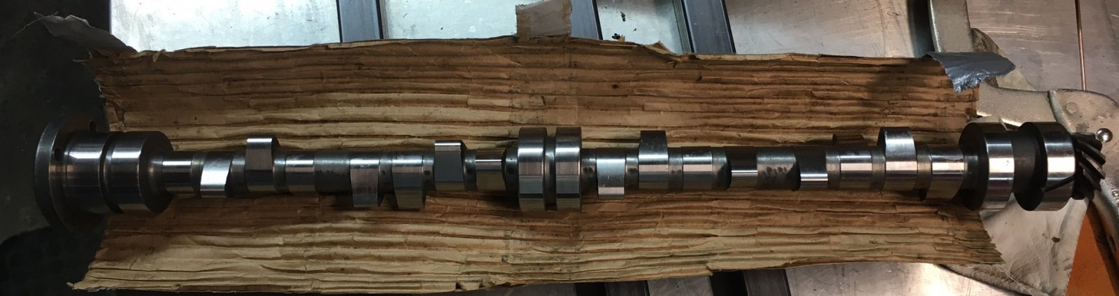

    Have just what u need. Stock appearing cam(approx .028-.030 more lift) factory ford. Intake valve opens sooner that stocker and stay open about same as stocker. Stock lift is .292, this cam lift approx .320 Ford felt it necessary to upgrade their everyday cam and this is it!!! . Could send you a pic but you won’t see any difference from a stone stocker. The micrometer is the decider! John in s.Texas E340D4E9-1382-4548-A3EC-FF1B2F3991B3.jpeg

    I am doing a 59 with the 1007B . MY block was factory relieved , .080 over bored and stroke. The bore should have raised compression slightly but the relief dropped it more and I asked Pete1 for his recommendation. It was the 1007B. I wish I could report the performance, but I won't have the truck running until next summer.
    IMG_1967.JPG I don't have my cam spec card at the moment ( put away for safe keeping) , but duration is slightly more than stock Merc and lift is around .350" . I'd go with Pete's call.
