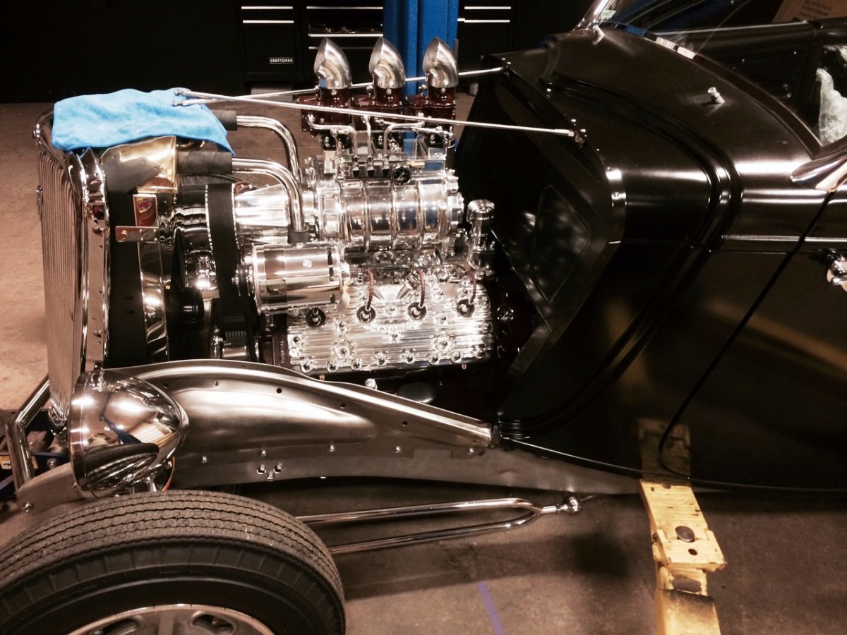

  13. tig master
    Joined: Apr 9, 2009
    Posts: 416
    tig master
    from up north
    16 spark plugs cool
    Tig
