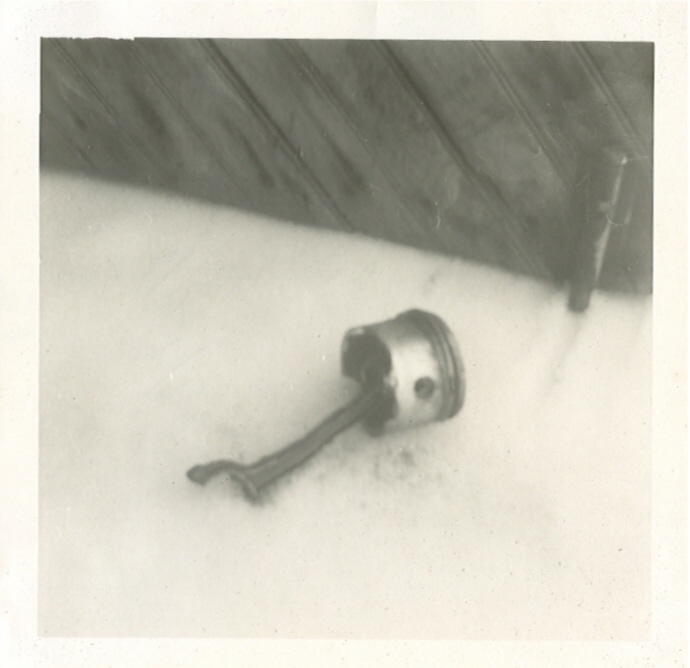

  6. AngleDrive
    Joined: Mar 9, 2006
    Posts: 1,166
    AngleDrive
    from Florida
    My avatar was a 304 cubic inch 59L. This is what happens when you miss a shift.
    Desoto291Hemi likes this.
