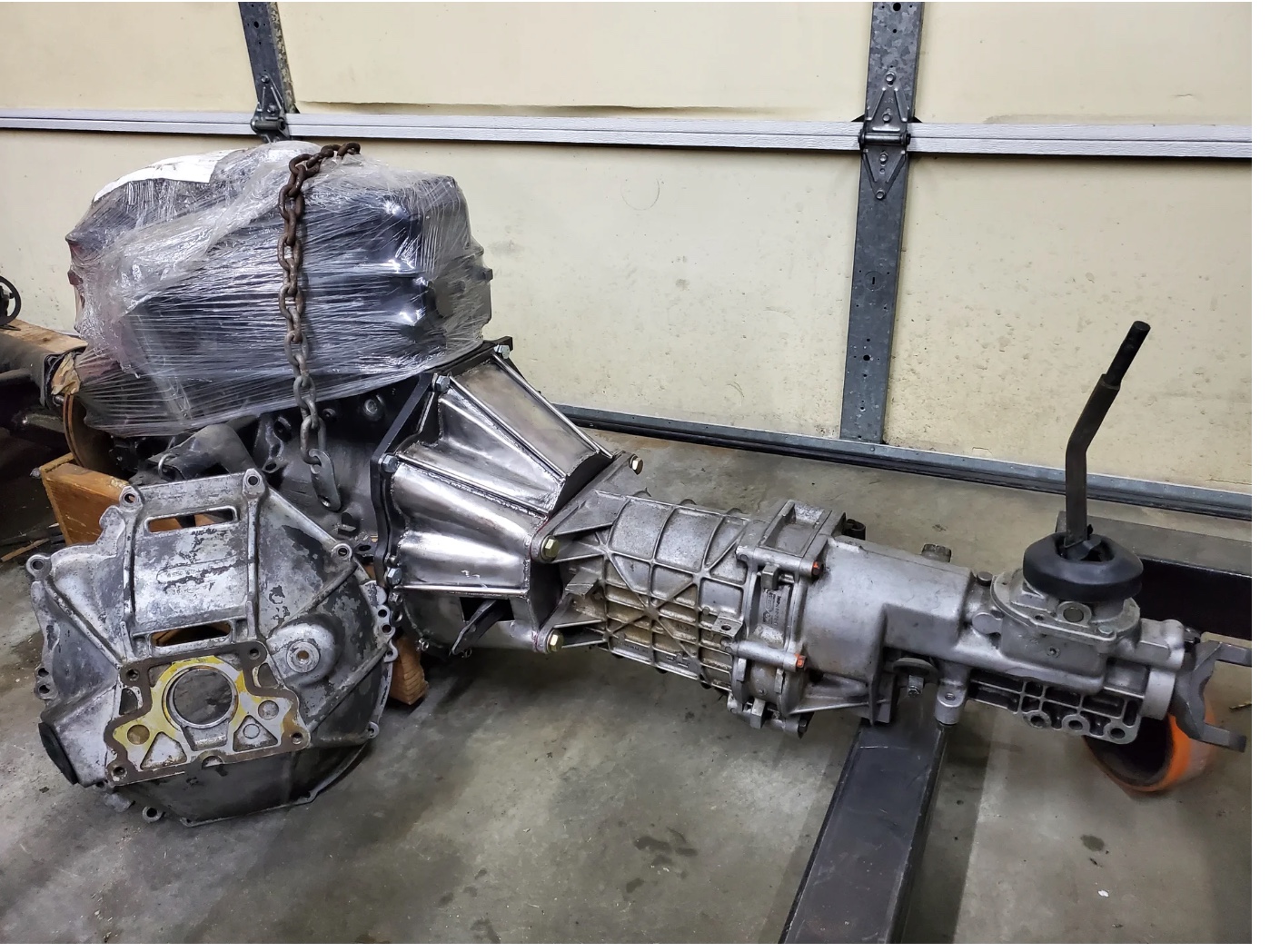

  1. I just picked up a 5spd trans. It's supposed to have come out of a Monza. It doesn't look anything like a T5, but it is a Warner trans. Anyone have any info? I'll post a picture later. Gene.

    Just did a search because I haven't thought of a Monza in decades. Looks like the trans is a
    Borg-Warner T-50 manual transmission. Also looks to be the first American car with a 5 speed.
    I can't remember the last time I saw one of those, the car not the trans.

    A T50 is an orphan.
    I have a broken one.
    The gear shift pattern is a bit funky.
    Reverse is where 1st would be, 1st is 2nd, and so on.
    Last time I checked there are no replacement parts available for it, besides the clutch.
    Bearings are uncaged, took mine apart to find out the crunchy crunchy, busted gears everywhere and rollers beyond count.
    If you have a nice operating one, change fluid dont beat on it at all or sell it to some poor ******* in need of a T50.
    It has good gear ratios, but can only handle 200lbft.
    There is also the Toyota T50, afaik they are not related.
