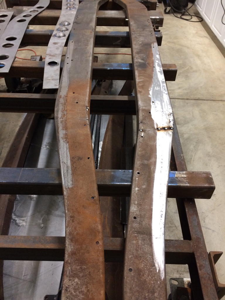

    I started on frame last summer, and found out we had mold in garage from water leaking thru walls. Put on hold again, while we straightened all that out, and have been picking away over the holidays as time allows. I've got a toddler, so it's tough to spend endless hours in garage, as she wonders out and wants to help (but won't wear weld helmet...go figure!)....

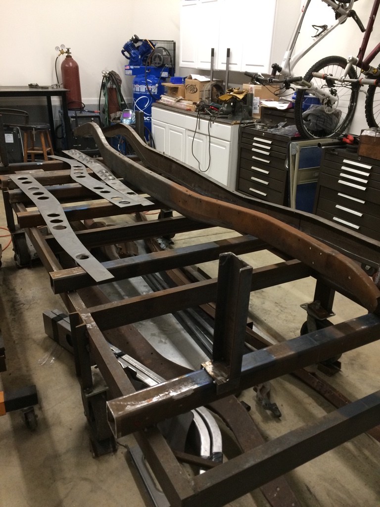

    Tried to make a Cop Shop coupe styled ch***is in late 90's, but it didn't turn out like I wanted... bought a set of American rails around 2005, and commenced to go at pinching frame again, to get a heavy rake and channeled look without dropping body way over frame (I'm 6'0, so don't fit well)... finally decided to put pieces back in frame, so that's where I started...[​IMG]

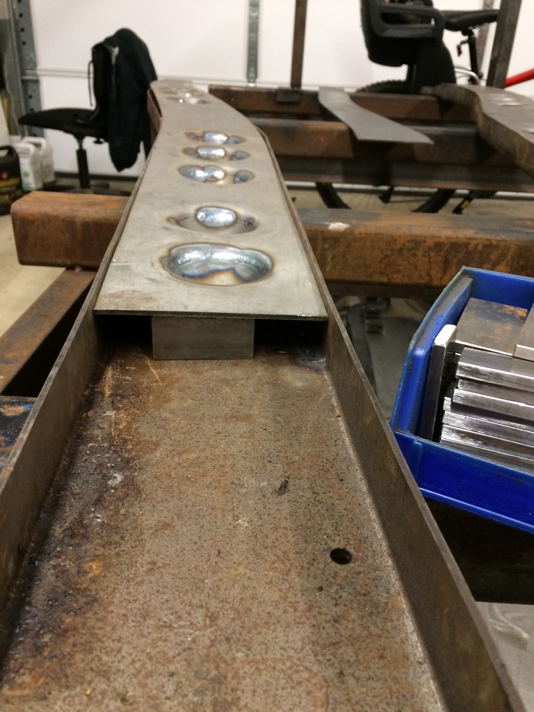

    I bought a set of Ionia HRS boxing plates a few years back, and am trying to get them fit to these rails... and as if the project wasn't enough, I decided to fill in the holes on boxing plates in my free time... have always liked the thought of having cups in the frame

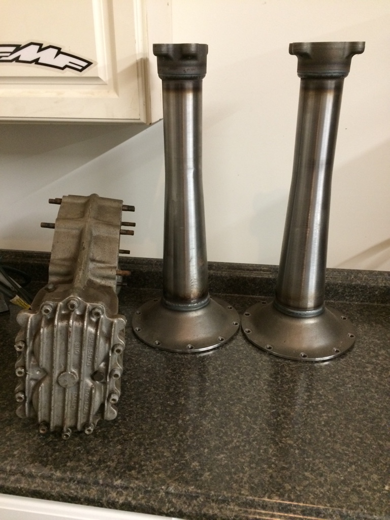

    Thanks KiwiJeff... got an old Torrance301 champ, that I'm going to use Winters parts to finish, and get hung in the back[​IMG]

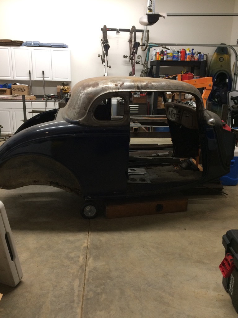

    Timwhit, It wouldn't be a radical rechop, but when my Dad and his buds did it way back when, I wanted to lay posts back a little, and put a small rake on top, and they wanted to stick w a straight drop street chop... seeing one of Rudy's chops, or others like Flatnasty's build, really gets me going... I dig the at***ude those cars have

    Rocky, my dad and I built a form die, and formed the cups in a Harbor Freight 20 ton bottle jack press... we cut blanks on saw, and them switched to hole saw, and cleaned up on lathe... it's a bunch of work, but I really enjoyed getting dad involved, and that's the ultimate reason I bought the car in first place...:)

    I cut a bunch of plates, and am contemplating welding them to backs of boxing plates, to keep consistent distance of depth during welding. [​IMG]
