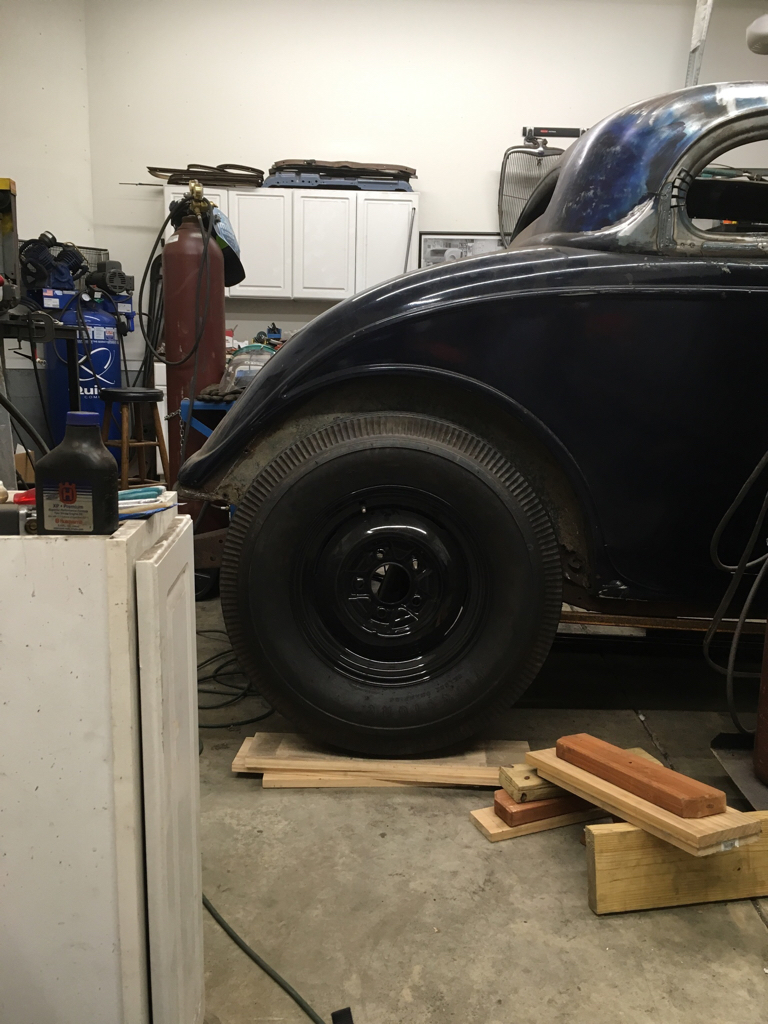

  12. ls1yj
    Joined: Sep 14, 2011
    Posts: 465
    ls1yj
    from Kentucky
    Working on a good location for rear wheels... I’ve been told that wheels should move rearward 3/4-1” from stock, but looks like stock location is pretty close to matching body reveal around wheelwell... oh, these are setup wheels, and are a little short, only 30” tall... will be getting 31’s later to fill up well...

  14. ls1yj
    Posts: 465
    ls1yj
    from Kentucky
    Dave
    I’ve been told the axle placement is to match the openings in rear fenders, so losing the fenders changes position slightly
  15. deathrowdave
    Joined: May 27, 2014
    Posts: 5,059
    deathrowdave
    from NKy
    I see . I ran my 32 for a bit without fenders and wheel was correct . But the location could have been changed , because of the buggy spring mount I used to mount the 9 in moved it without me knowing it . You are correct in saying that the tire must fit the opening for the look . I’m just a bit stupid when it comes to Ford issues .

  18. brEad
    Joined: Dec 23, 2016
    Posts: 2,039
    brEad
    Looks like that wheel is just right as compared to the reveal to me, too.

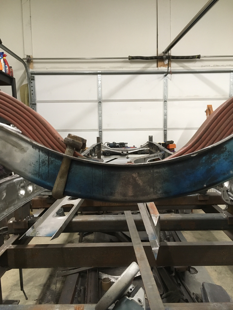

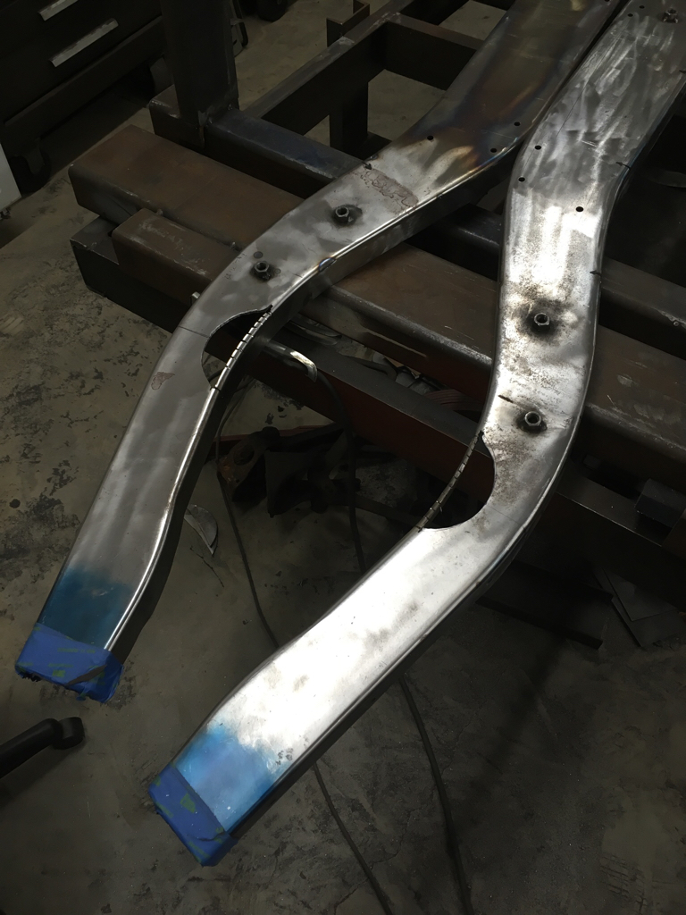

    It is slow going.... heating and beating the arch plates for rear axle clearance today... will post a few pics soon

  23. ls1yj
    Posts: 465
    ls1yj
    from Kentucky
    Got one side roughed in, just a little more welding and grinding to get other side
  24. brEad
    Posts: 2,039
    brEad
    I like your attention to detail on the notch. Very nice!

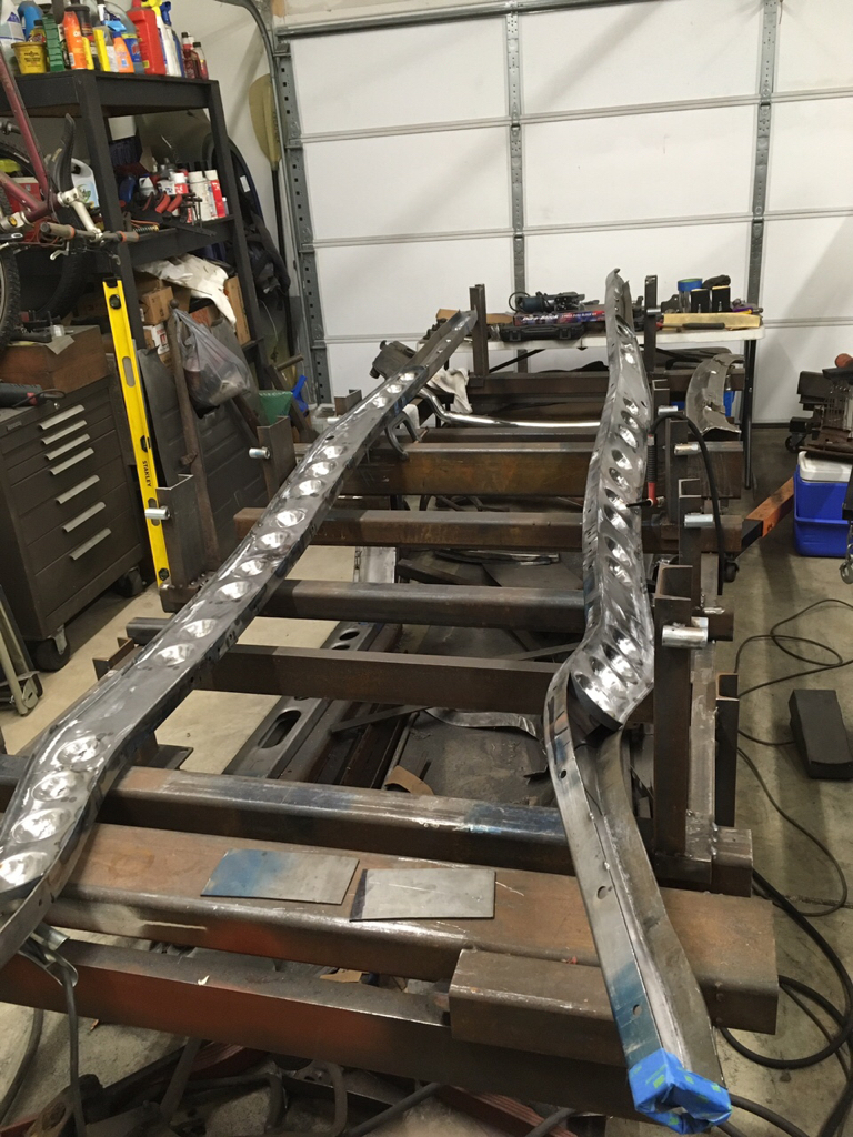

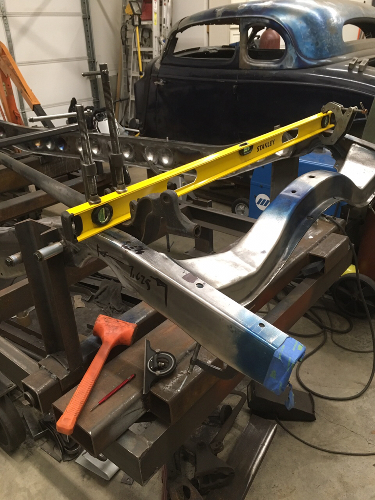

  26. ls1yj
    Posts: 465
    ls1yj
    from Kentucky
    Got both axle cuts cleaned up, and frame back in jig, realigning cross members, and laying out placement of rear bones
