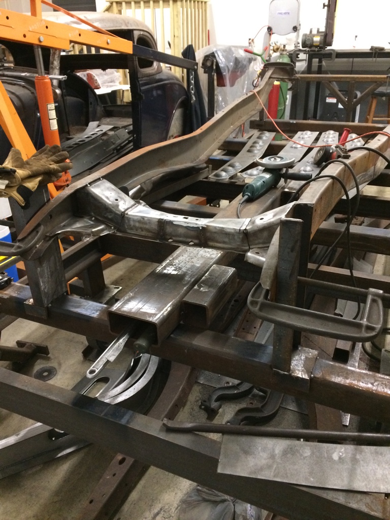

    I got the corner welded, and trimmed out... 1st plate is fitting pretty decent. Also tacked the cups in rear DS plate [​IMG]

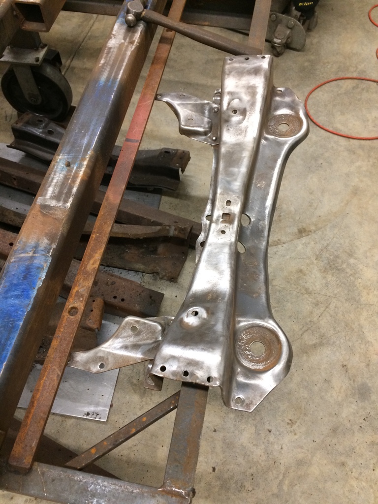

    Gonna pull a 33 front cross member out today, to mock front box plates around. [​IMG]

  20. How far down from the top of the rails is the top of the crossmember middle section(center pin)?

    I checked from top of frame down to top of front member= 3.060"

    Doin a little grinding and welding today...it's slow goin, but at least I'm goin...:)
