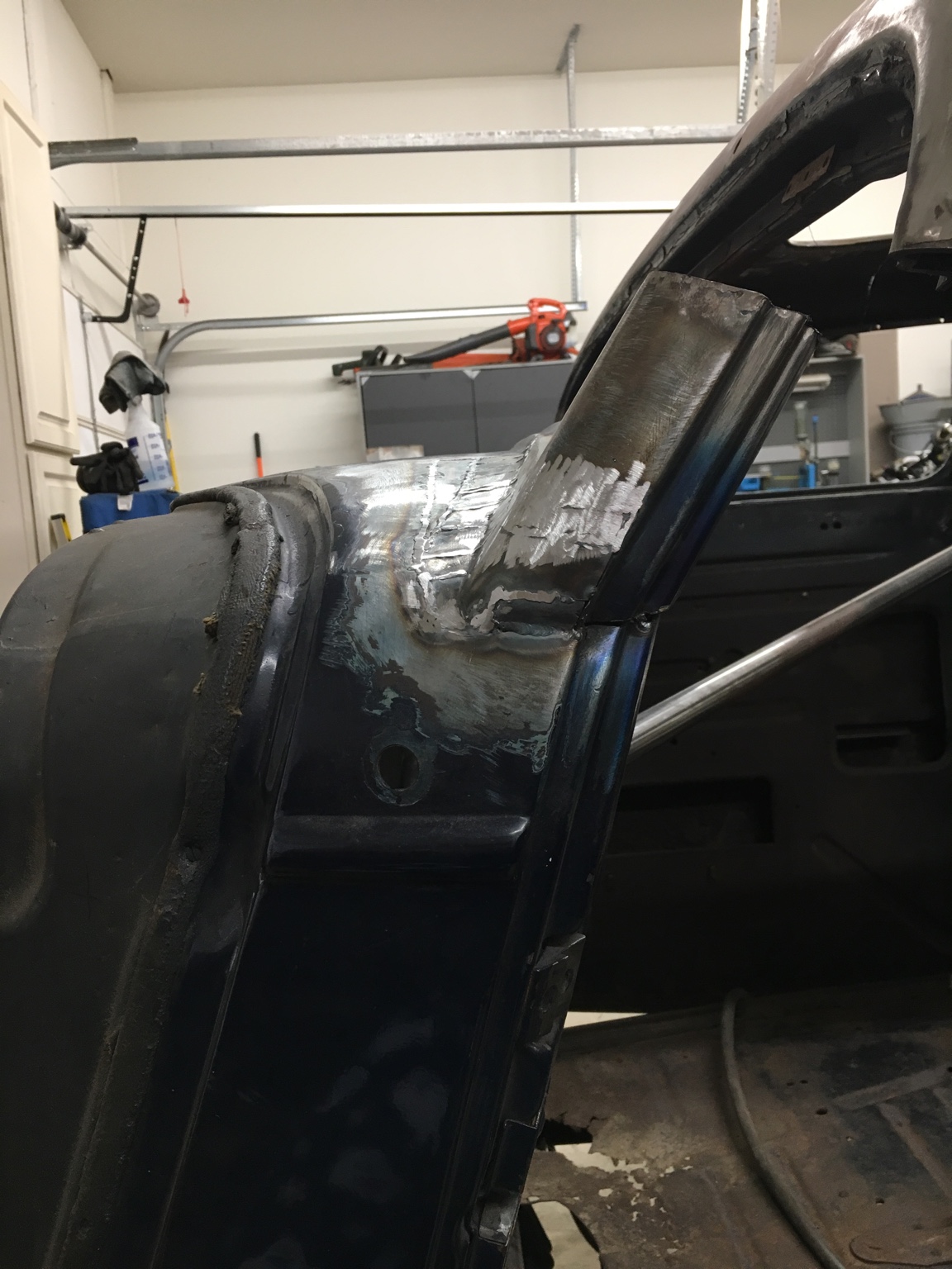

    Here’s a couple of in progress shots of drivers side cowl at A pillar

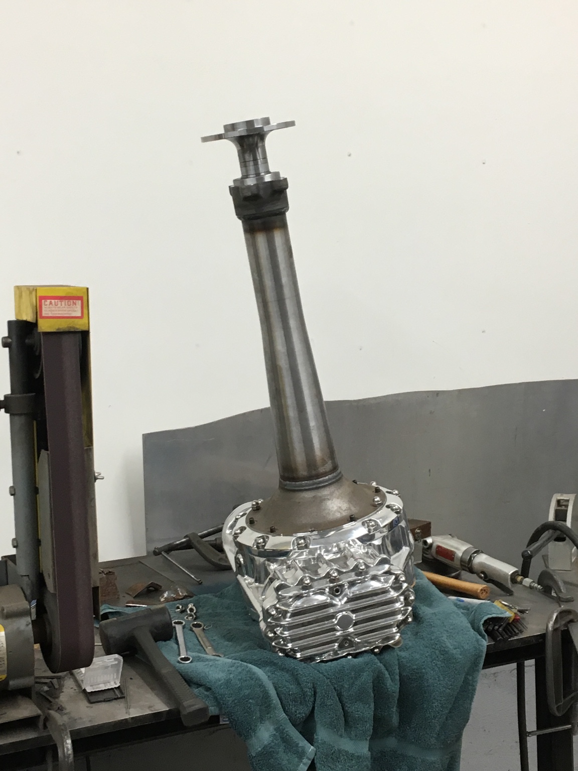

    Got my QC back from Bruce at QuickchangeExchange... looks great! Mocked up side bell, and checked axle fit... axle will need a little trimmed off, but won’t be long to have it ***embled and ready to slide under frame...!!

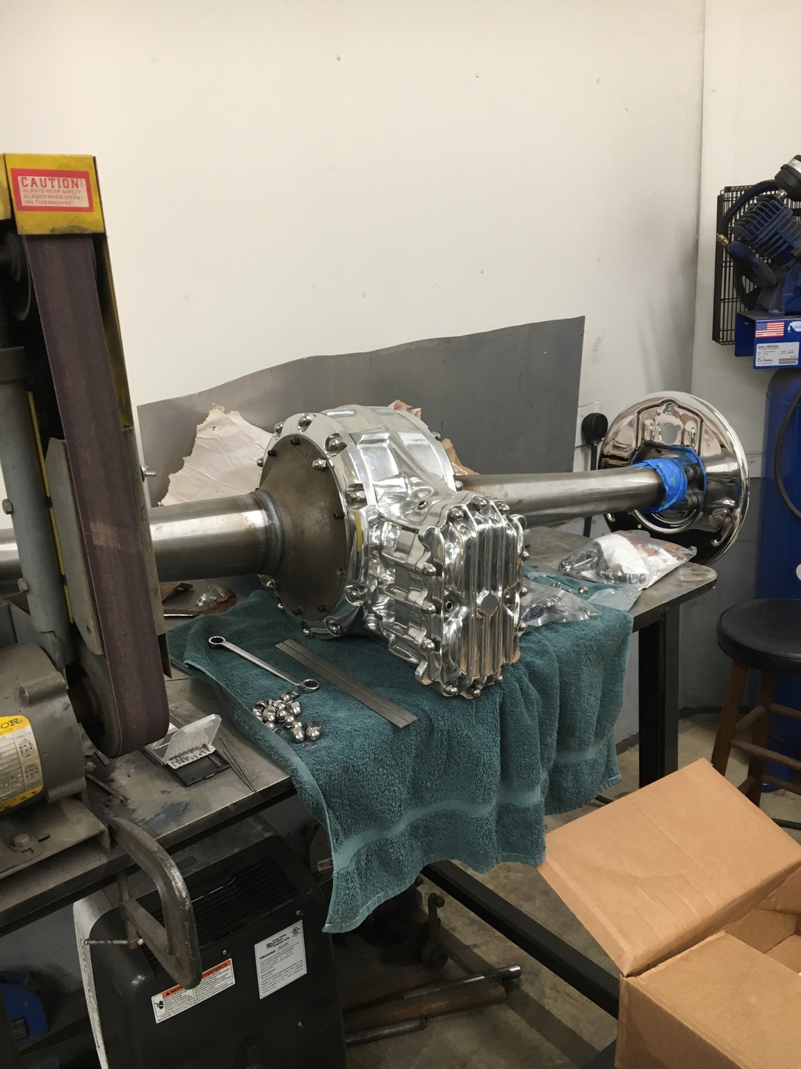

    Checking fitment of backing plates, all looks good.
    Had an issue with axle fit. As you can see from previous pic, the bearing wouldn’t set flush with support. Figured out splines weren’t cut far enough, so I’ll work on getting that problem solved.

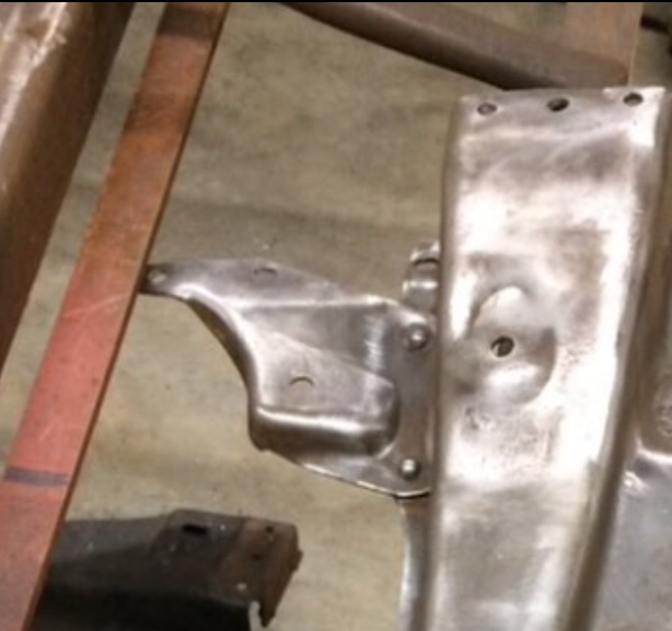

    Meanwhile, worked on F1 steering box and got it cleaned up to see how bad wear was... also, got the boxing plate marked, where steering will go thru. Took it to the shop, and bored a hole in plate while Dad made me a sleeve... going to weld sleeve to inner C, and then weld to box plate, to give a super stout mounting area.

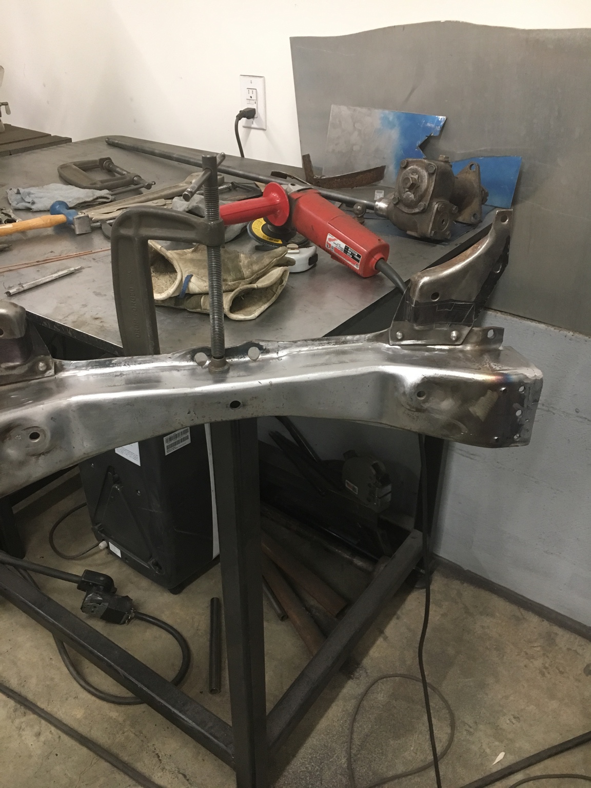

    Had a pretty good day yesterday, and welded 3/8” to each side of front crossmember, to make it fit well between frame rails

  20. dumprat
    Joined: Dec 27, 2006
    Posts: 3,572
    dumprat
    from b.c.
    So is that an A crossmember with the 34 rad brackets added?
    ls1yj likes this.
  21. ls1yj
    Joined: Sep 14, 2011
    Posts: 465
    ls1yj
    from Kentucky
    Dumprat,

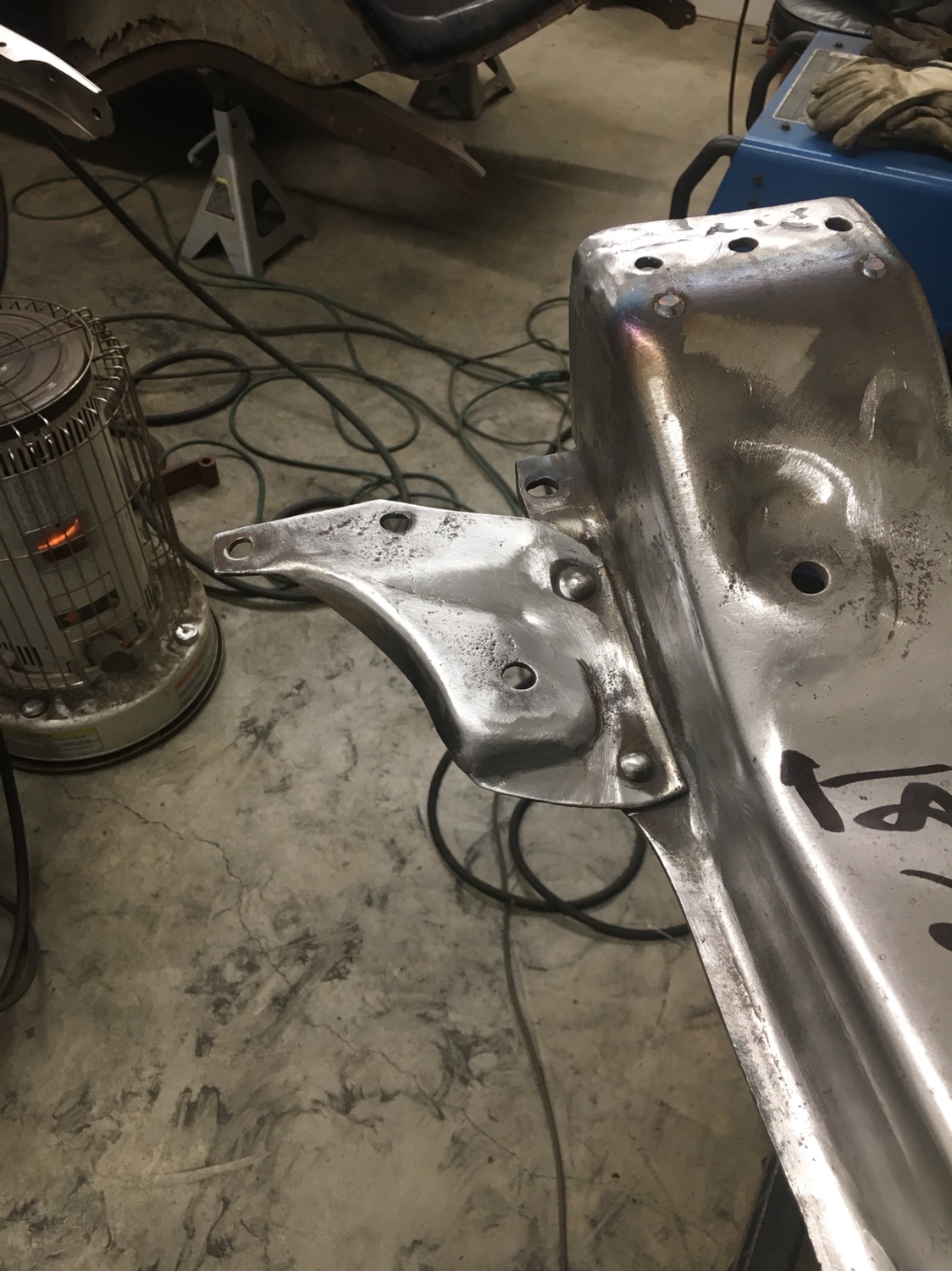

    It’s the original model 40 front, that I sectioned and flattened, and trimmed Flathead motor mounts off. I filled in the places where motor mounts were.
    loudbang and Tim_with_a_T like this.
  22. dumprat
    Posts: 3,572
    dumprat
    from b.c.
    Very cool! I am looking at using a stock A crossmember in mine and wondered how it compared.

  25. Not to hijack the thread-
    Usually with an A crossmember, you scoot it forward a bit extending the wheel base forward helps with proportions when it drops the ride height. then run a chopped radiator mounted on top of the crossmember. The radiator is the same location related to the firewall.
  26. ls1yj
    Posts: 465
    ls1yj
    from Kentucky
    I mimicked how the A looks in a Model 40, but both of my A front members look like ****, and needed a ton of work...
    I’ve got the stock front 40 flattened, and trimmed up similar to A, and currently have it slid forward an inch...
    Since I plan to run full hood and splash aprons, I’m still undecided about the 1” forward move, as it will force me to do a lot of sheetmetal work to make it all look good...
    But, I love the look of extended wheelbase
  27. That's why the radiator gets chopped and sets on top of the crossmember.
    You're talking about fabricating a new hood and splash apron, not just some sheet metal work if you move the grill forward.
    loudbang and ls1yj like this.

  29. ls1yj
    Posts: 465
    ls1yj
    from Kentucky
    @31Vicky with a hemi
    I studied the radiator and front cross member relationship, and decided I could slide the member forward just a little, and still keep the water in front of the member...

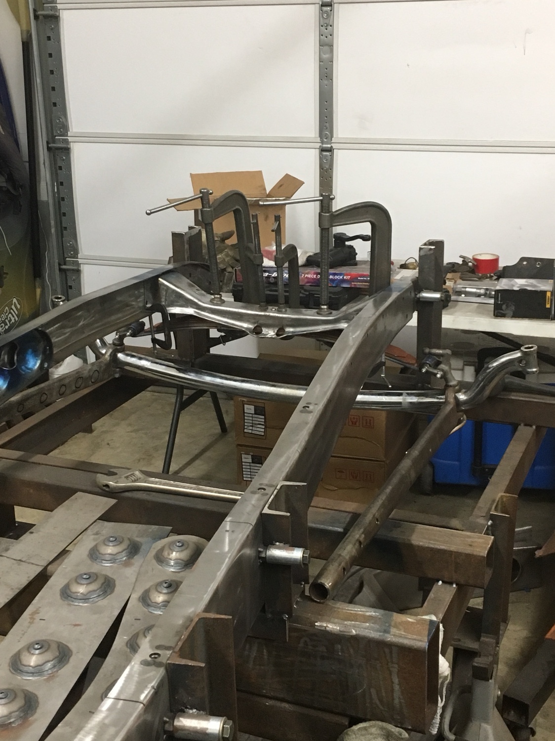

    Got cross member clamped up, and threw the front end on to see how far off it all is... a little nip here and a tuck there
