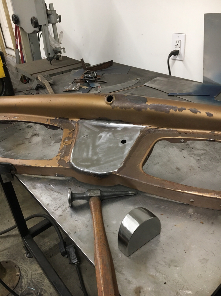

    Spent last Sunday at Cornfield Customs with Mike Wagner and Kyle Yo*** of Yo***srodshop taking a metal shaping cl***... really enjoyed it, and picked up some great pointers... Made a template for cowl corner where it meets windshield corner, and made one while at their cl***... got started today making the driver side here in garage..

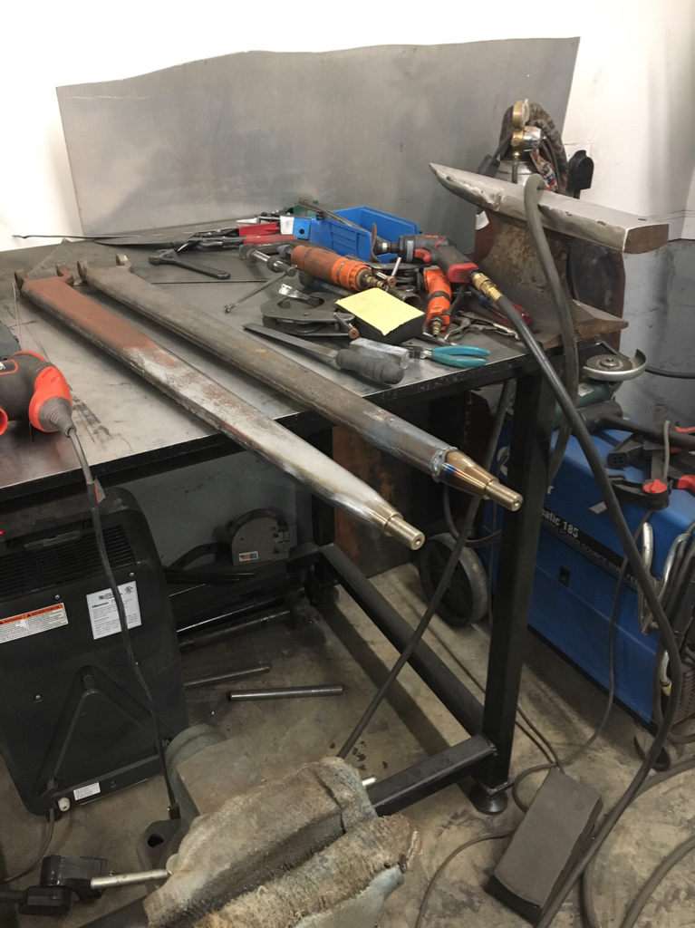

    Also spent some time this weekend building a stand from an old axle housing, to put a family hand-me-down anvil on... spent couple of hours grinding on anvil to get flat on top, and point pointier

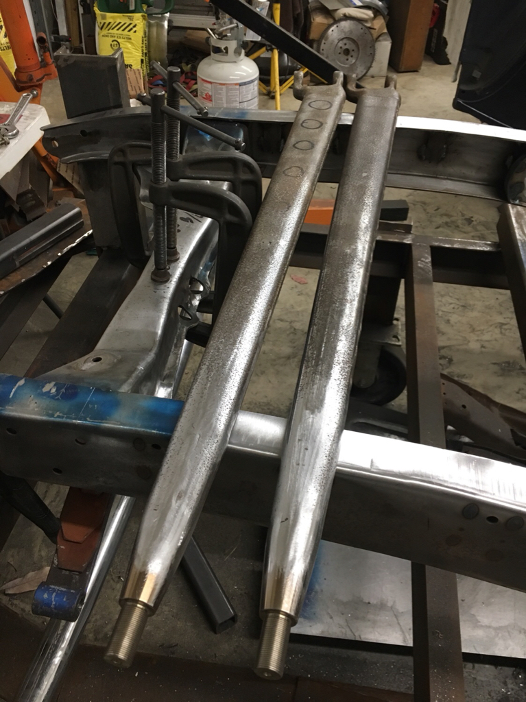

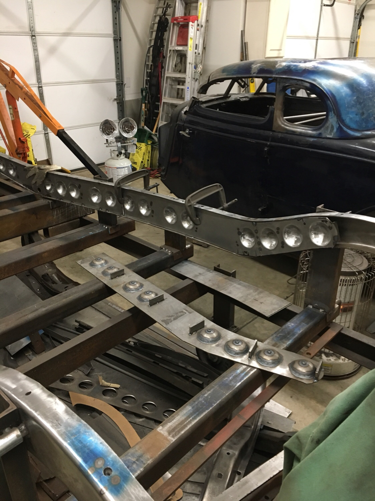

    Tacked in a set of box plates, and layed out the holes for the bungs that split bones will attach to...

  8. Wrench666
    Joined: Oct 26, 2017
    Posts: 212
    Wrench666
    That frame is awesome. Too bad all your hard work is on the inside and not the outside of the frame.
    Looks great. Your work is amazing

    Got bungs welded in, and worked down, looking good.
    Stuck rails back in jig, got front member squared up, and mocked front end up, to get the wishbone lengths cut and fit
