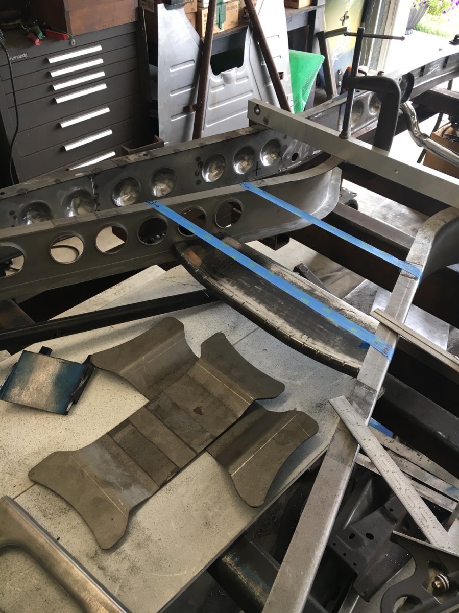

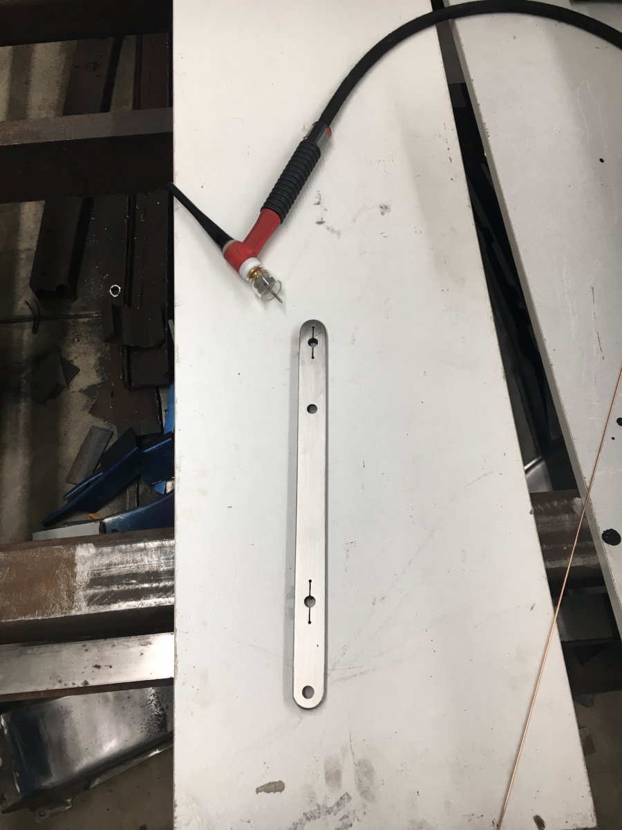

    Had a small misconbobulation on the stainless piece I made yesterday. I transposed last 2!numbers on sketch, and one hole and overall length are off quite a bit... so, some sectioning is in order

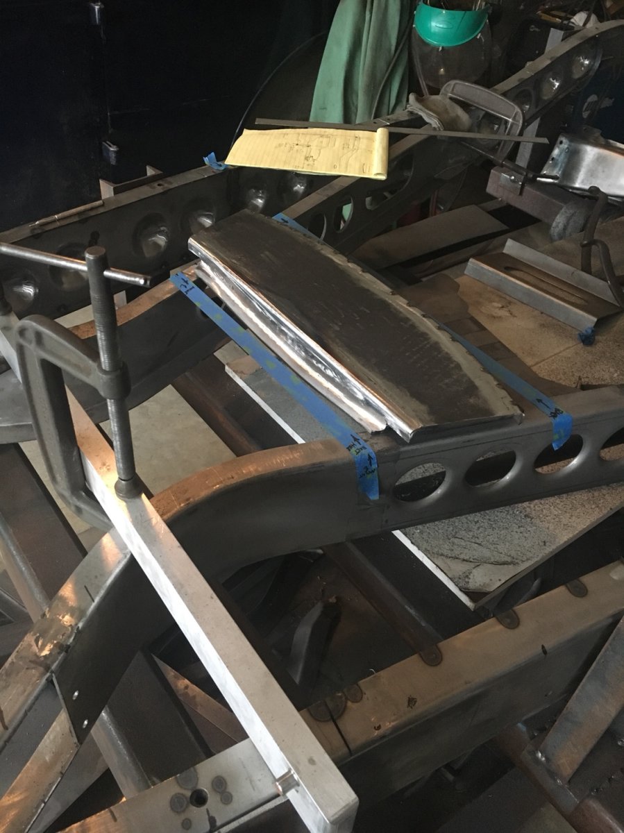

    Got another box plate tacked in... now on to fitting crossmembers

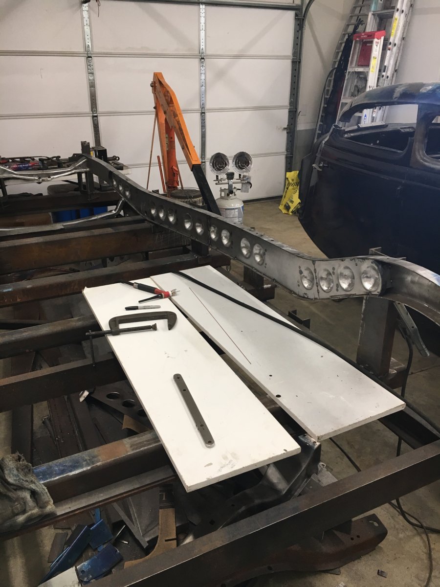

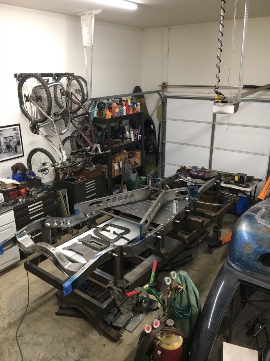

    Lined the x-member pieces up to fit the sheetmetal dimples where stock pieces were, and saw that fronts are a little long, and rears come up just a bit short... gonna need to do some t******* and tacking here and there

    Pulled rails apart to fix some short flanges before I weld cross members in... added some pieces to front horns, to even them up

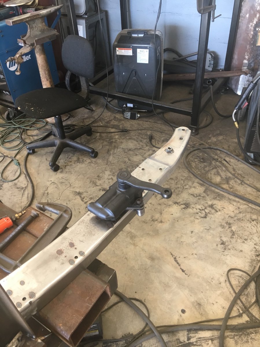

    Got flange for steering box welded on, and smoothed out some

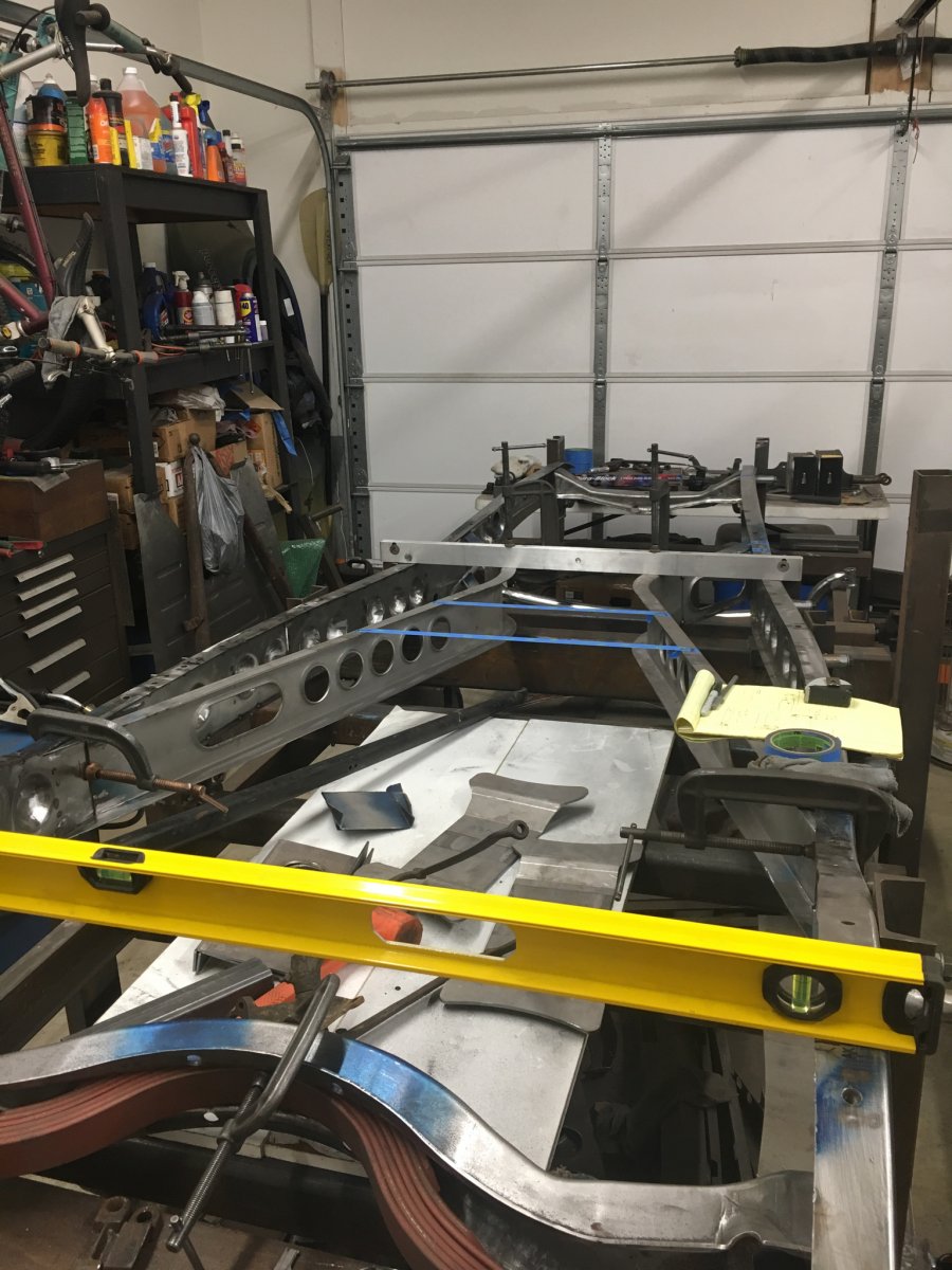

    Doing some cyphering.... trying to figure out where to put the solid brace under trans tail section... I’m estimating where motor position is, based off a spare 365, but I don’t have a fan mounted... so not really sure how close I can estimate without one in hand...

    @Roothawg, I’m contemplating adding a piece inside the rear cross member, to pull the T spring against... there’s several inches between the arch for A, and the smaller radius of the T

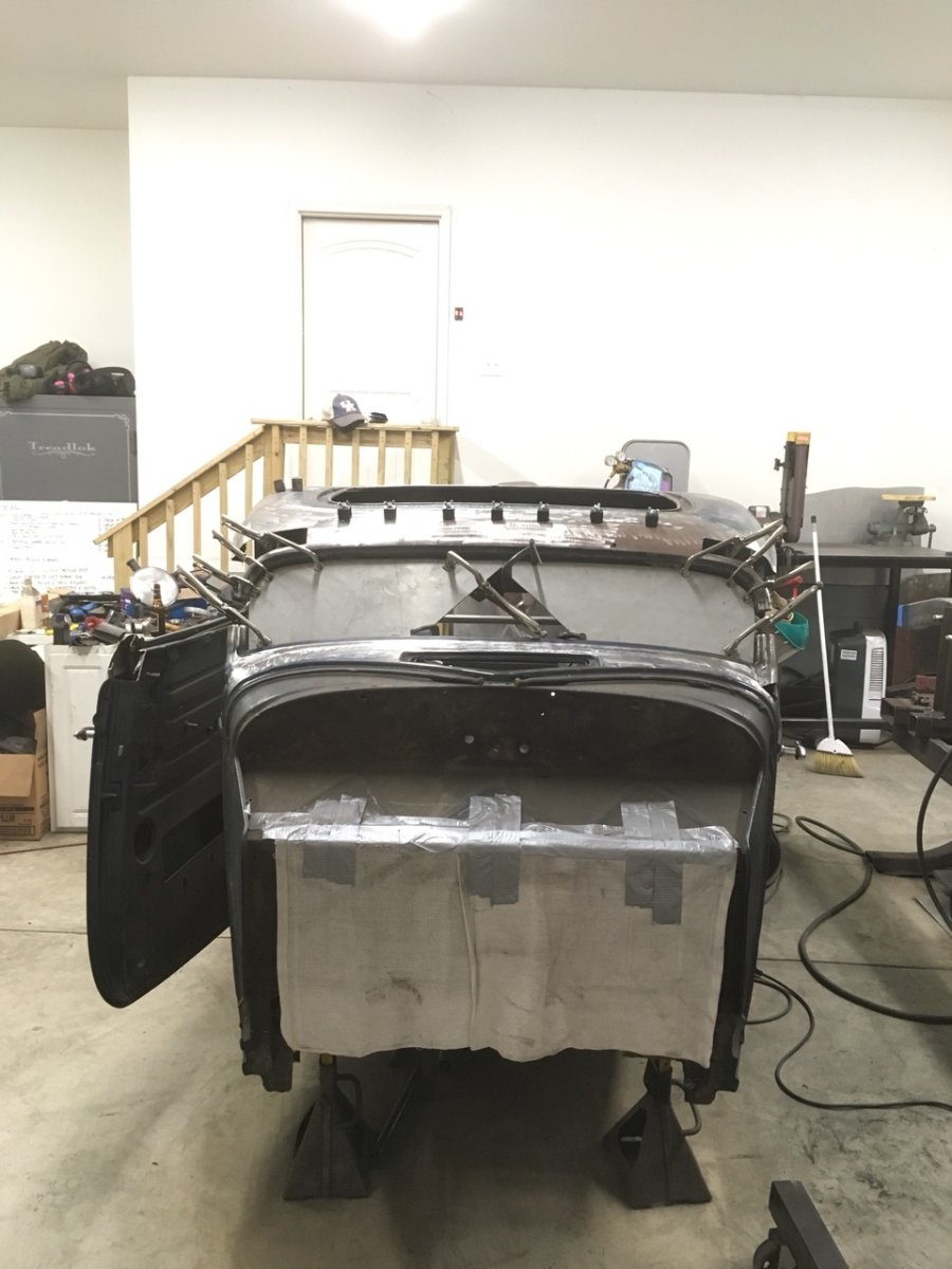

    Made template to clamp in windshield pocket, and starting lining up the A pillar areas
