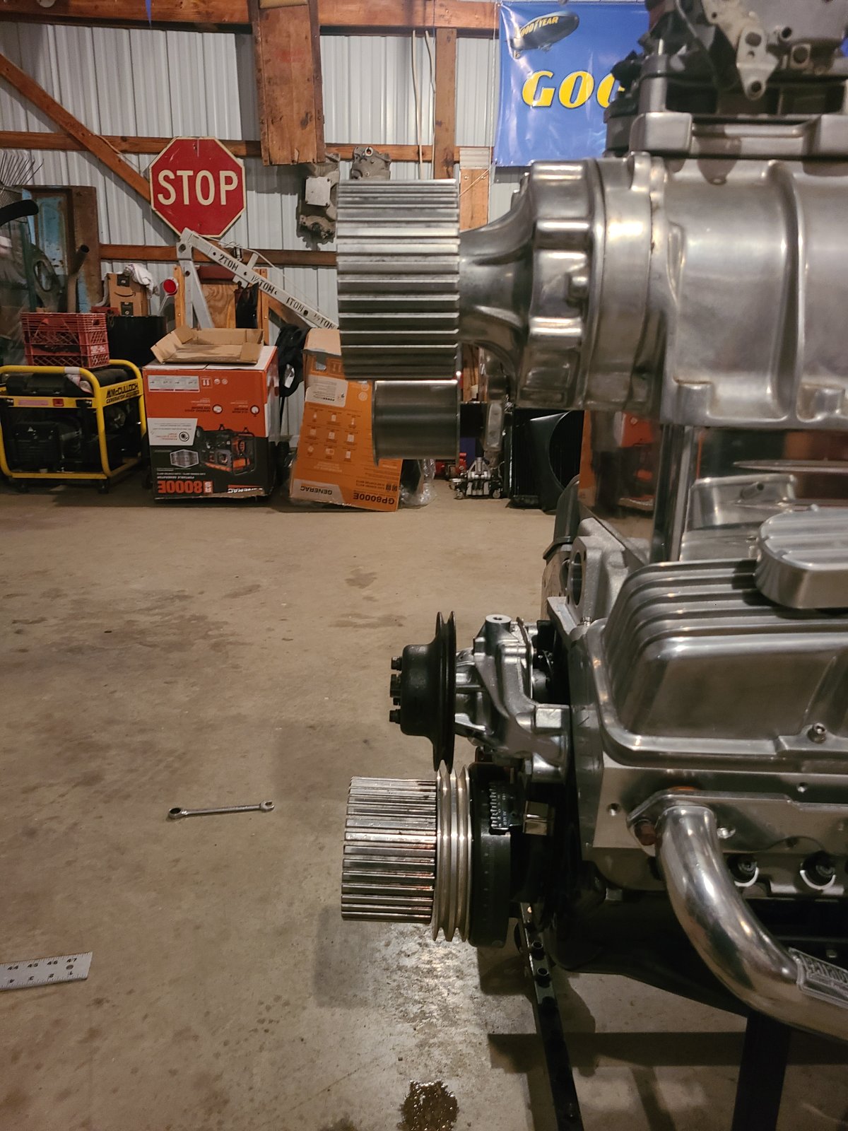

    Hey guys, I have a Weiand 6-71 that was originally on a BBC that I had. I built a new SBC and bought a Weiand blower intake for the SBC but now my drive alignment is way off. Are there different versions of this intake? Are there different snout options for this version? Any help would be appreciated, I'm kind of stuck until I get this figured out. Thanks Screenshot_20230317_185715_Gallery.jpg Screenshot_20230317_185709_Gallery.jpg 20230315_165412.jpg

    Weiand built the snout into the front cover on these older blowers, which complicates things for you. Small block and big block Weiand blowers use different front cover/snout ***emblies. You gotta get the right one...or choose a different blower that has a separate snout, and get the correct length snout, or get a different front cover that will take a separate snout.
    Or get a big block....which is usually the best answer.

  7. That looks like a very long snout for a Chevrolet,,,,,,you did check behind the pulley and make certain it doesn’t have a spacer in there ?
    It looks like it needs to come back about 2 inches,,,or whatever those standoffs are on the idler bracket.
    I’m not certain,,,,but always check .

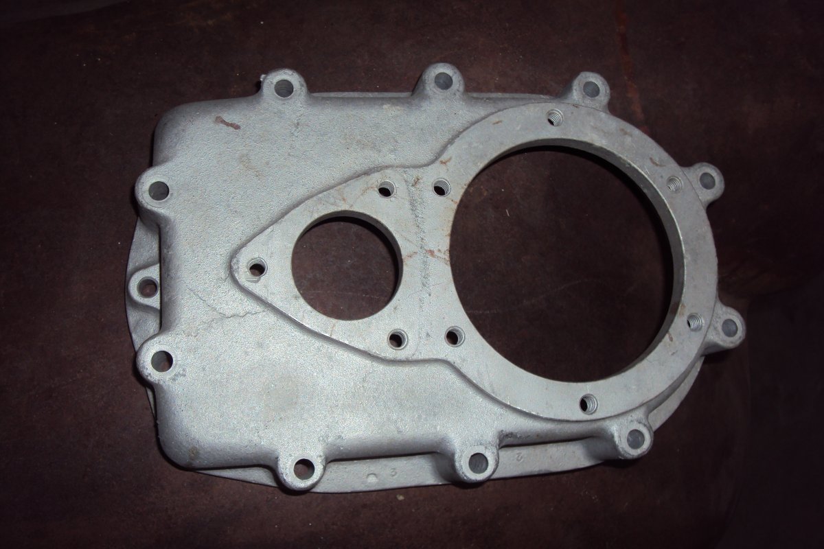

    Just switch to a regular GMC front cover & use one of the common drive snouts.
    The snouts come in different lengths.

    UPDATE: Upon further investigation, apparently they used the same snout on SBC and BBC versions. The BBC version just has a 2" aluminum spacer. Pulled that off and now just need some shorter bolts for upper pulley. Will need to make some small spacers for the idler ***embly, but that's definitely doable. Much closer than I was this morning. Thanks to everyone for their info. 20230318_221843.jpg 20230318_220202.jpg 20230318_221646.jpg 20230318_222441.jpg
