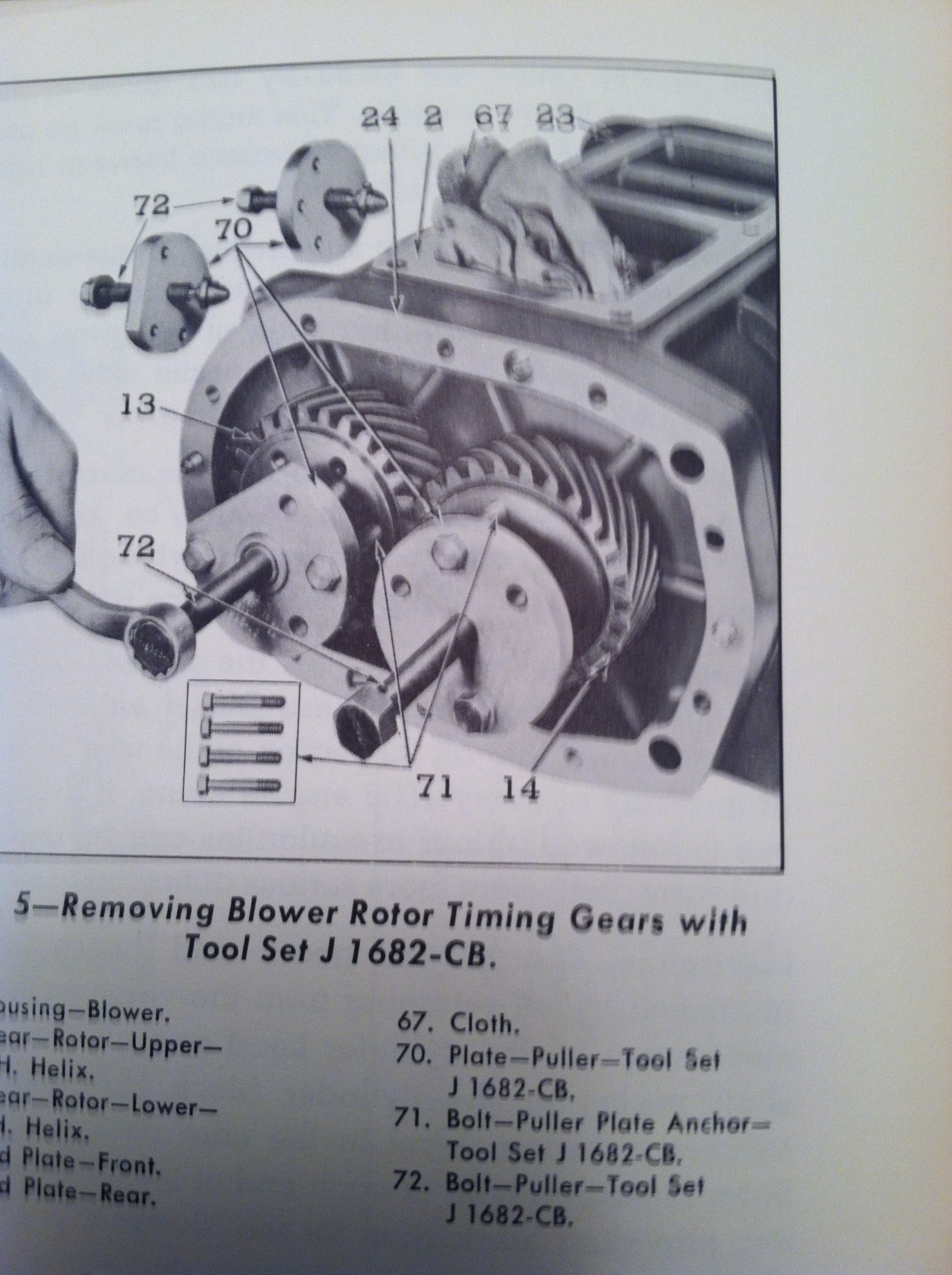

    Couple pics of gear puller tools from GM manual. Took one apart once using a couple of small pullers I had at work.

    Yes, when pulling the helix cut gears off the rotors they should both be pulled together. It's not a big deal to do it correctly. Doesn't take much to fab up a set of pullers like the OEM Kent Moore tool. You will be pulling them several times during re***embly while shimming the gears to set the rotor clearances. Also get some long 10" or 12" feeler gauges to set the rotor clearances when re***embling. Many years ago my first job after tech school was working at a Detroit Diesel dealership.

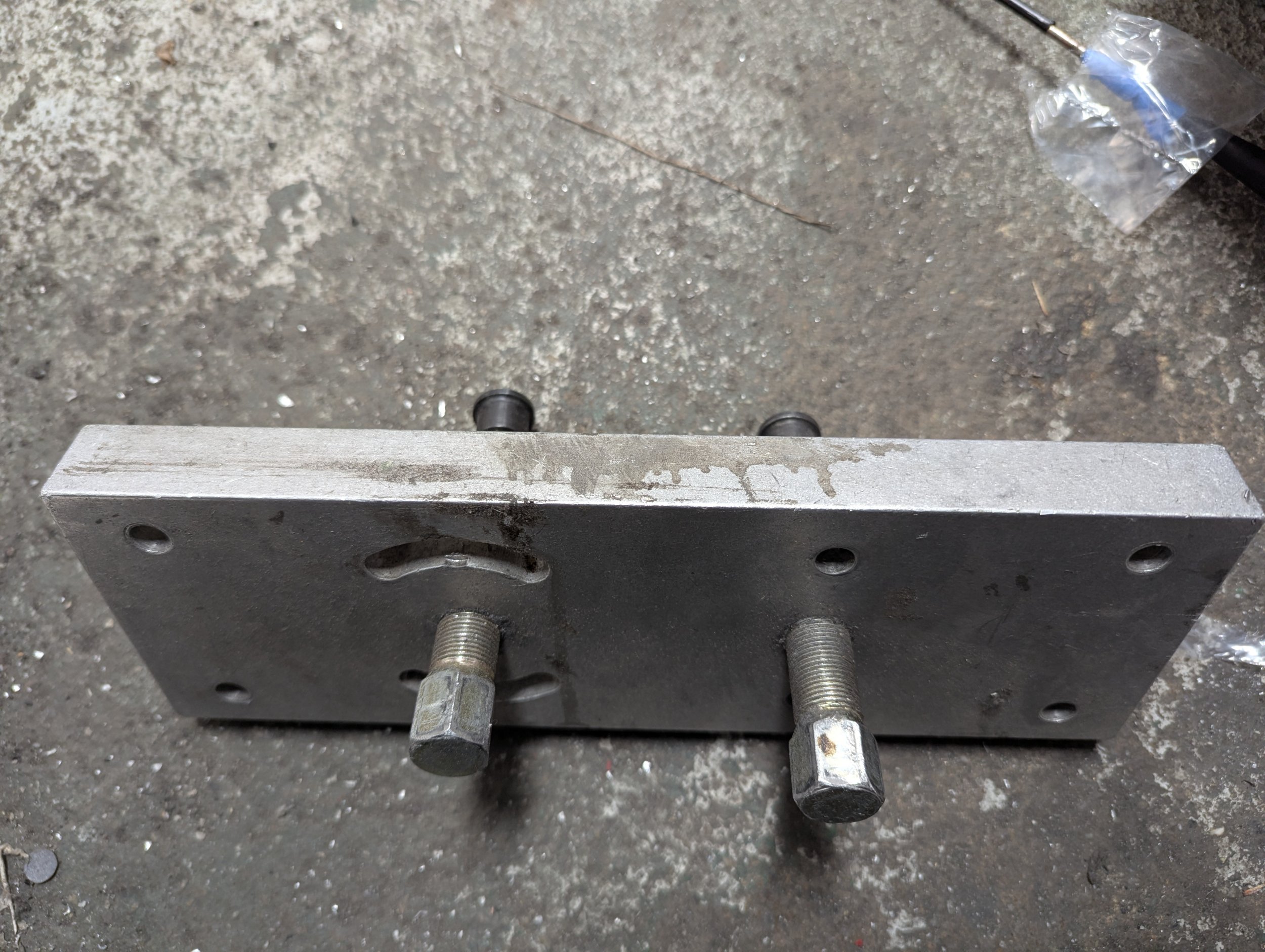

    I bought this, but it can be made.
    winduptoy likes this.

    That's what I'm talking about. I'll take a chunk of aluminum and maybe chop up a couple of cheap China Freight pullers and make one. Thanks.

    Not much to it.
