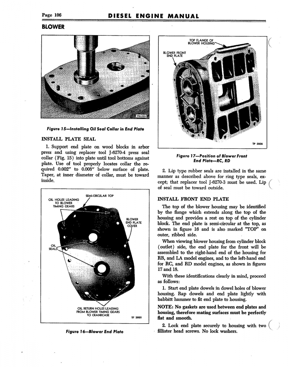

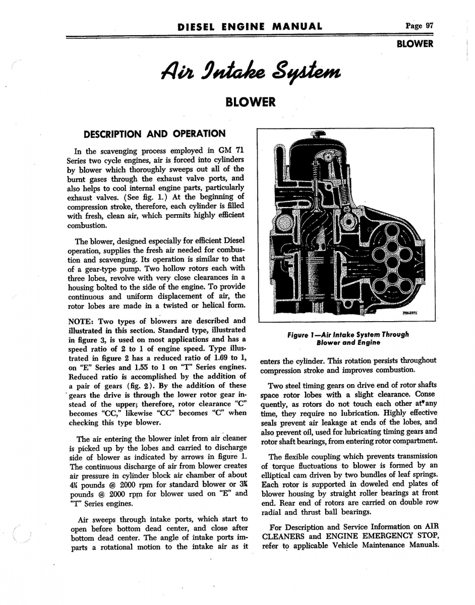

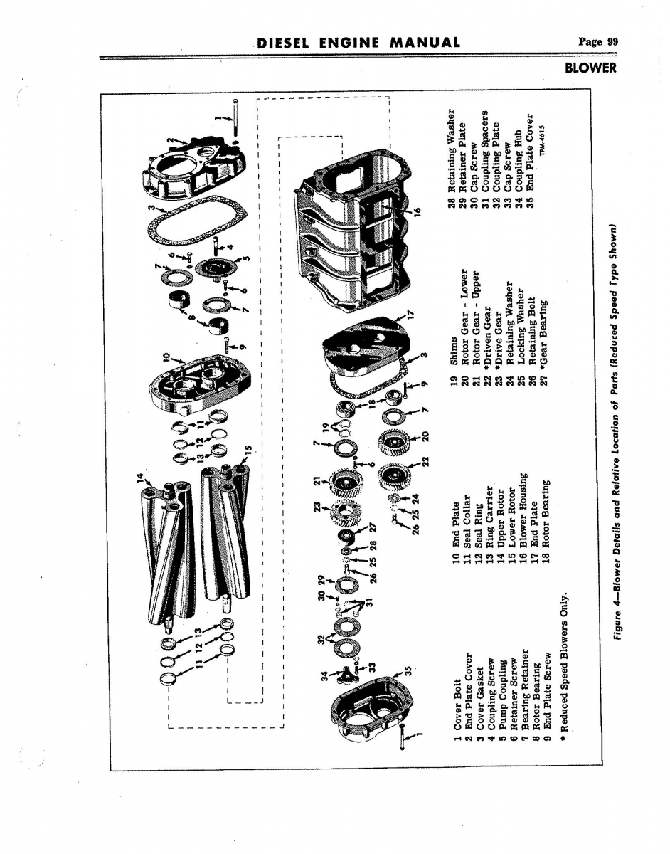

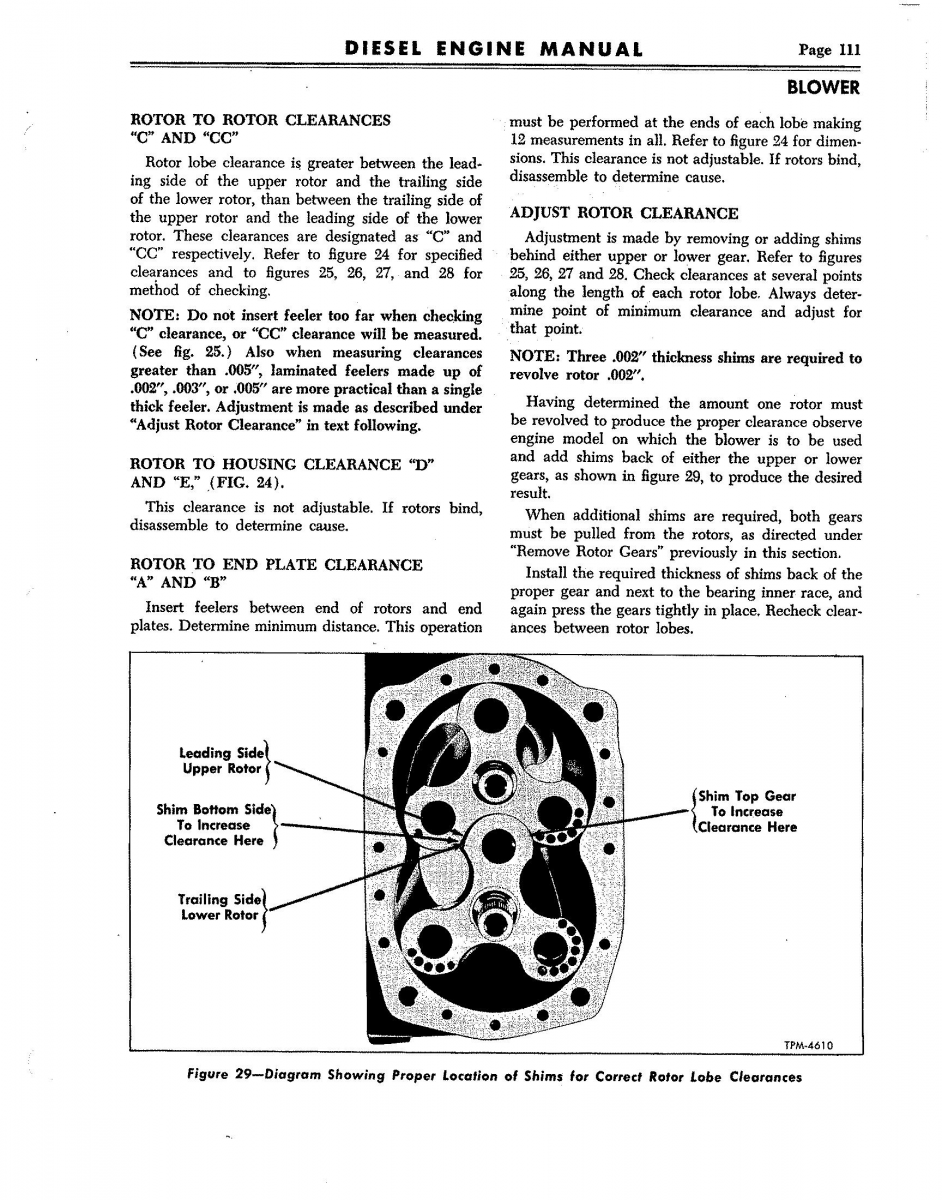

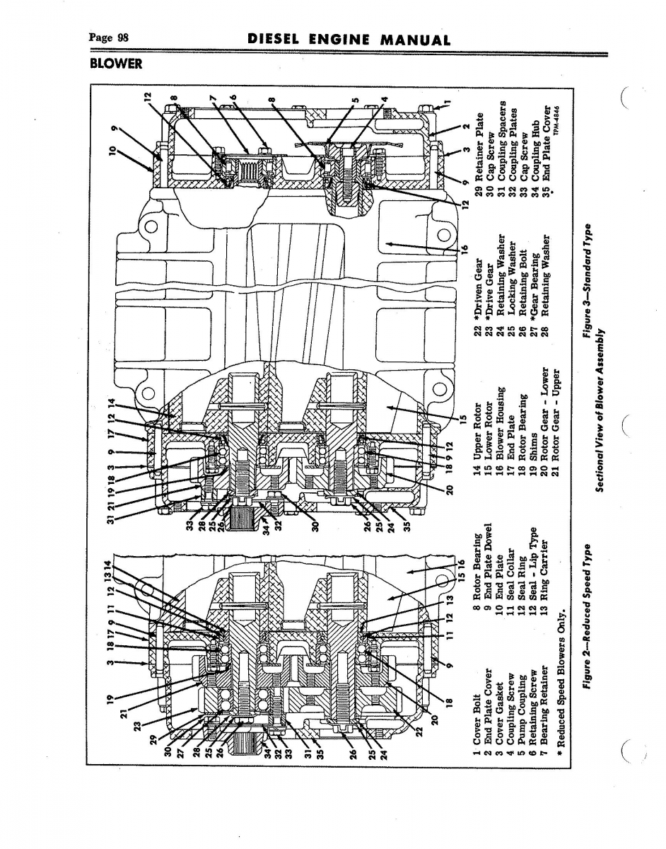

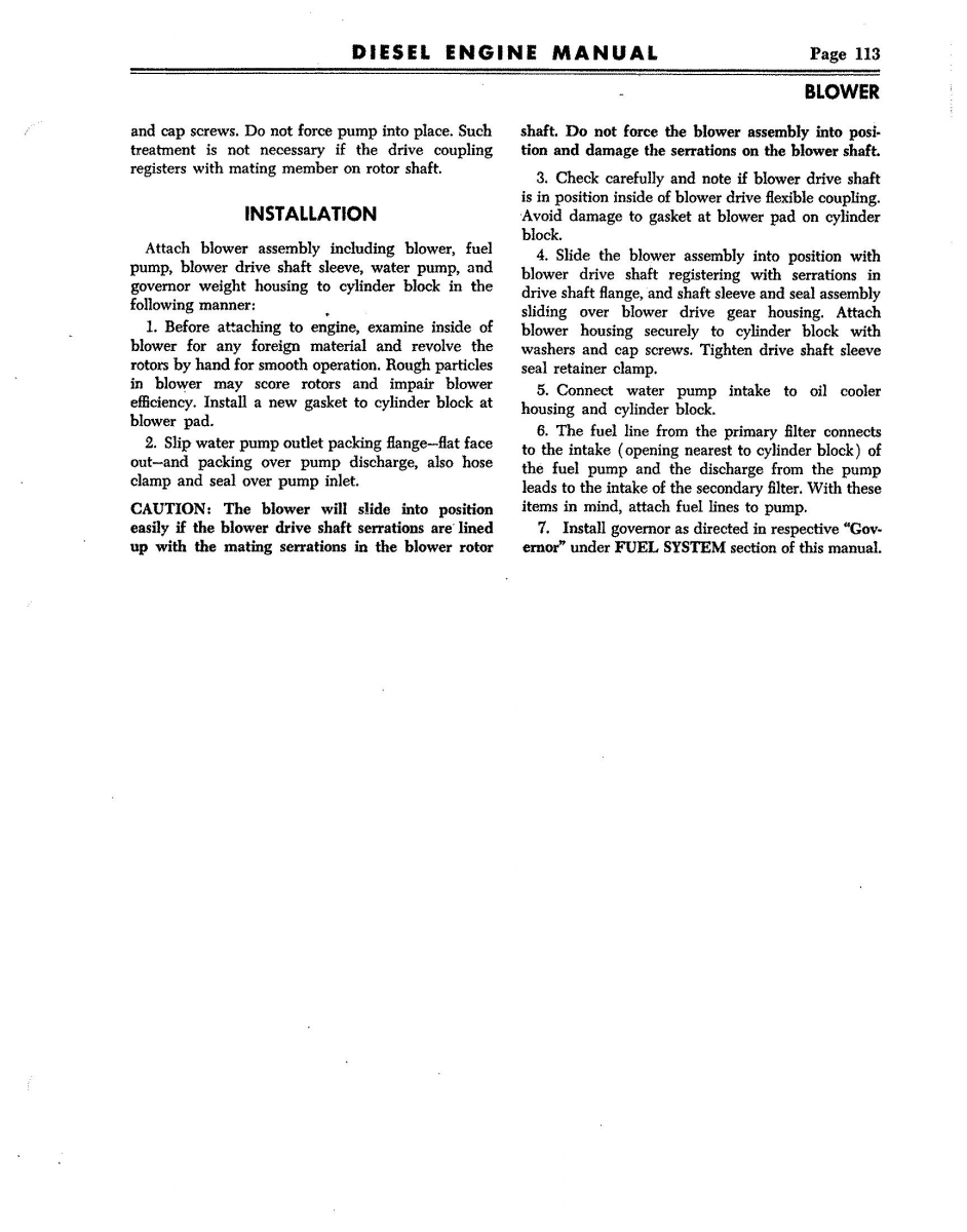

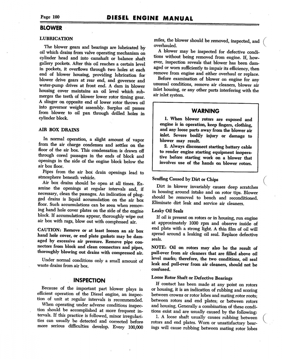

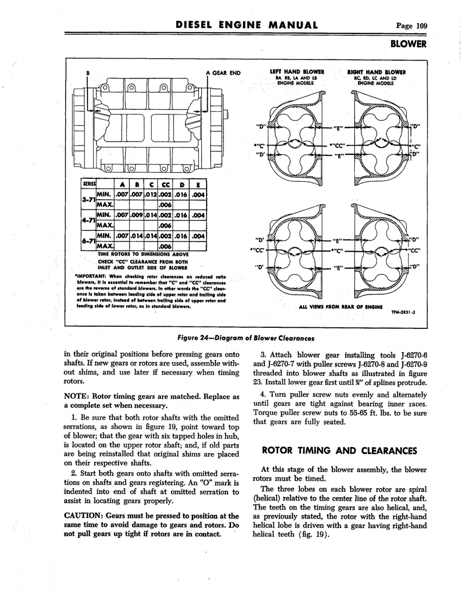

  1. upload_2015-11-25_10-23-45.png upload_2015-11-25_10-24-25.png upload_2015-11-25_10-25-44.png upload_2015-11-25_10-26-52.png upload_2015-11-25_10-27-43.png upload_2015-11-25_10-28-14.png upload_2015-11-25_10-28-46.png upload_2015-11-25_10-29-46.png upload_2015-11-25_10-30-31.png upload_2015-11-25_10-31-14.png upload_2015-11-25_10-32-11.png upload_2015-11-25_10-32-47.png upload_2015-11-25_10-33-19.png upload_2015-11-25_10-33-50.png upload_2015-11-25_10-34-19.png upload_2015-11-25_10-34-54.png upload_2015-11-25_10-35-37.png
    Hope this helps someone building a 6-71. Can use for 2-71 3-71 4-71
