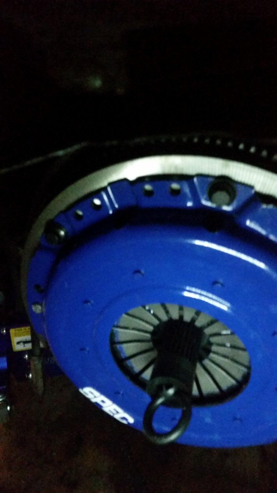

    Get a SPEC Stage 2 clutch for a Mercedes 190E. Use the pressure plate and throw-out bearing.
    My 200hp+ 200-6 has one, although I am also using the disc for the 190E. It happens to have the same splines as my T56.
  13. gimpyshotrods
    Joined: May 20, 2009
    Posts: 24,569
    gimpyshotrods
    The step height on the current flywheel is 1", it needs to be reduced to 0.870".
    There are "extra" holes in the flywheel, one on each side of the stock pressure plate bolt holes. Those need to be tapped to 5/16"-24, for high-quality fasteners. The holes are already the correct size to accept the tap.
    Here is what it looks like with a T5 setup.
    Pry the current throw-out bearing off of the slider. Pry the Mercedes throw-out bearing off of its slider.
    Place the Mercedes bearing on the Ford slider. The little "spring fingers" on the Mercedes bearing will latch under the lip on the Ford slider.
    Show ***embled here.
    You may want to talk to a SPEC tech. They have clutches for this setup in stage 1, 2, 2+, 3, 3+, 4, and 5.
    They may be able to get you set up with a disc that matches your input shaft, and this pressure plate design.
    My current setup.

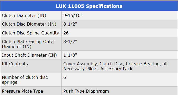

    The picture with the silver pressure plate was the setup that I ran with a 144 and a T5. Same everything, but that needed a Pontiac Sunbird or Diesel Jeep 4-culinder clutch disc to match the splines.
    If you remember what the splines are on your T10, I can look around and see what also has those.
    The Mercedes clutch is 215mm. That is 8.465", or 0.035" under. The bolt patter is an exact match. You might have to enlarge the pressure plate bolt holes a tiny bit, as they are Metric. Do this with a tapered reamer, alternating sides, and remove no more than is necessary
    No idea what the extra holes in the flywheel are for, or why they match the desired pattern.
    I have no ability to explain why all of this happens to be the case.
    Even less so, in my case, why the 190E input shaft, and the T56 input shaft have the same spines!
    None of this makes sense, but it works!

    One caveat:
    It seems that every manufacturer has their own idea as to how to make the sprung hub in the disc.
    In some cases, the springs stick out of the engine side a little. Check that. It might be necessary to machine a little out of the flywheel face to clear them as the disc wears out. It is a simple thing to take care of ahead of time.
    That is shown in my naked flywheel picture.

    Here is the LUK equivalent for a stock one:
    They even call it out as 8-1/2", not 215mm!
