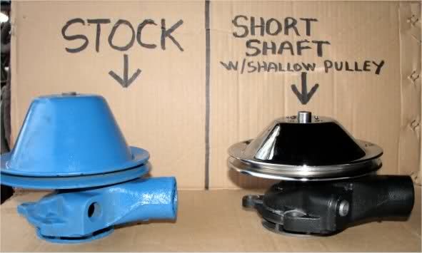

    typical 250 water pump, note that it looks like you might be able to press the hub down a ways on the shaft.

    You can do the same trick on a 250 pump, they just pressed the hub further onto the shaft.
  22. A 250 pump is shorter than a 292 pump incase anyone else needs to know.
