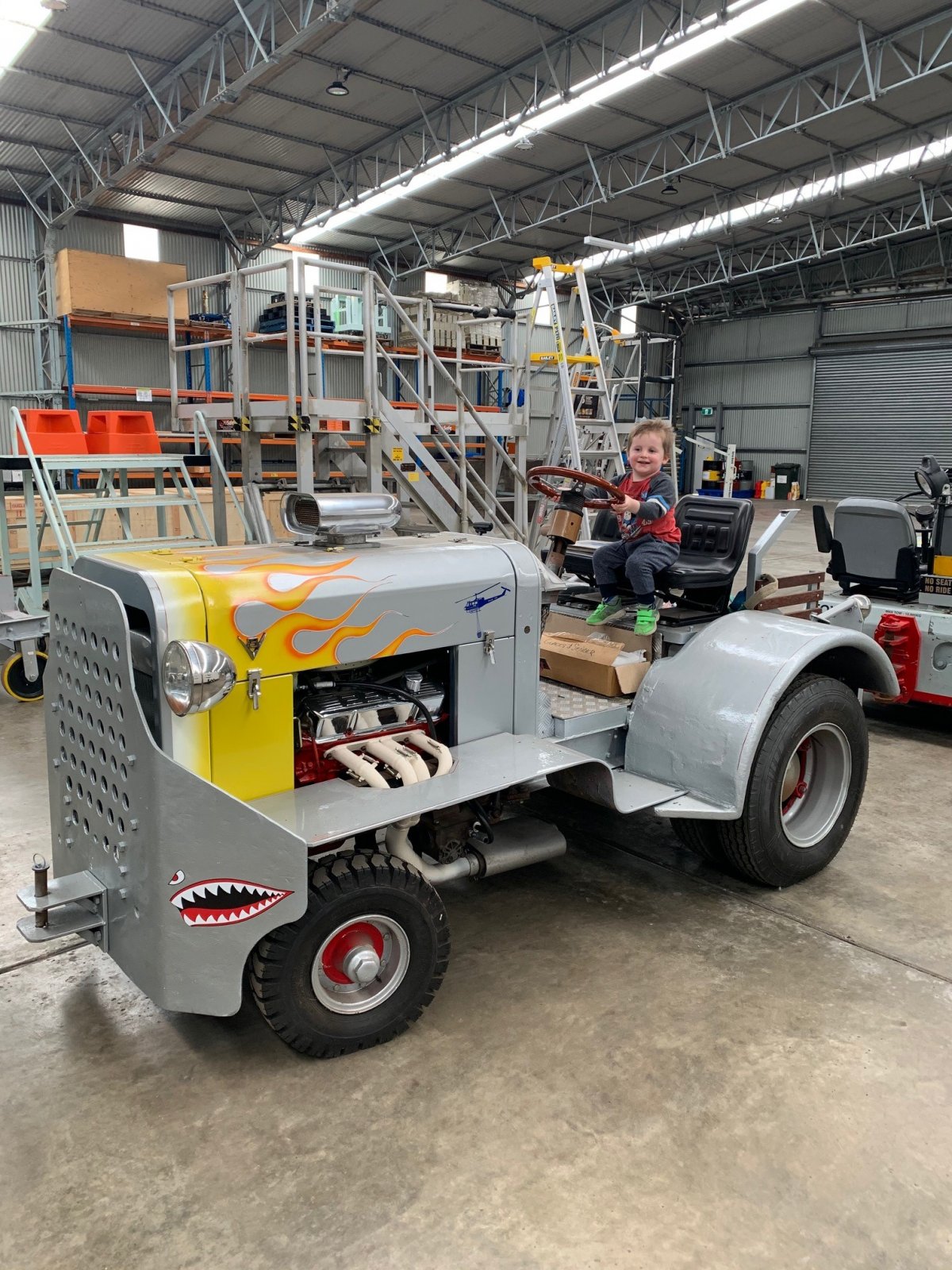

    i play with the old greys regularly and have been told that Chrysler industrial flat heads and Kew crankshafts have the same bearing spacing and the steel cranks from industrials were a regular replacement during the speed way days to keep up with offys,,, but cant confirm it , but i can confirm the multi carb manifolds from holden greys will fit a chrysler flathead industrial engine 6 from a 1941 clarktor 6 aircraft tug,,,, and yes i cut one up and put a v8 in it before i knew how much a rich ww2 airplane guy would pay for a clarktor to tow his mustang around.
    heres my latest grey with the only manifold ive never seen anywhere else ever and I collect grey speed equipment ,its got triple gravity fed Amal carbs and its bounced around a few hands for many years,only stuff ive found is pictures of the very same manifold on forums asking for info, the aussie greys are the most hot rodded engine in australias history,,,,, and my V8 Clarktor 6
