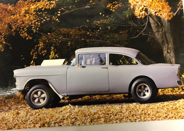

    Deuces likes this.
  7. Smoothy
    Joined: Jun 18, 2015
    Posts: 338
    Smoothy
    Awesome! I've always loved seeing your car on the other threads. Have any photos of the side so I could get an idea of the stance?
