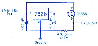

    You can use a 7808 in conjunction with an NPN output transistor to greatly increase the current capability of the regulator. Because there is a voltage drop of about .7 volts across the base/emitter junction of the output transistor, a 7808 (8 volt) regulator is used, which nets you 7.3 volt output. Use a large heat sink.
    G-son likes this.
  6. Or use a LM7806, it will give you just a shade under 6volts, but most loads won't care too much either way. The 2N5881 will work up to a 15Amp load (with a good heatsink)
    G-son likes this.

    7.3 volts is close to where a good 6 volt system would be when the charging system is in good shape.
