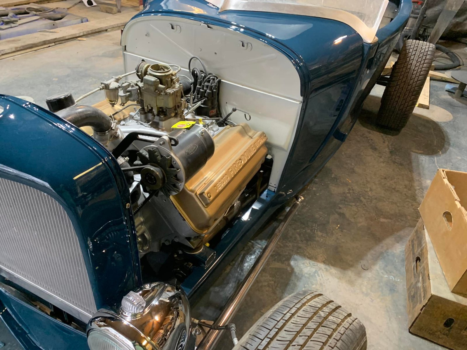

    Just get a Powergen 6V Pos. ground. It'll look stock, and work great. Just run a cable from it to your battery post or put a battery lug on the firewall somewhere. I have one on the 276 Hemi in my roadster, it's well worth the small investment. They are internally regulated, just ditch the stock regulator. I used my regulator as a connector lug to feed the rest of the car. Mine is 12V but you can get a 6V unit as well. (old photo) 05A1A6C4-A25B-47CB-B148-C3E3EAD9C34F.jpeg

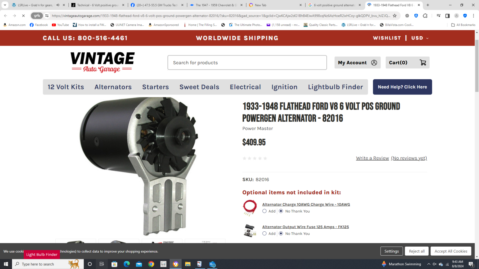

    I'll put it right out front, Not all of us are independently wealthy and have the extra money to spend 400 bucks on an alternator that pretends to be a generator just to please a few people. 20 bucks for a regulator or 65 for a kit to convert a 10 or 12 SI alternator that most likely you already have is in the most guys can afford it category. To me it is damned disrespectful to tell someone who asks a simple question that he has to go spend four hundred ******** dollars just to make you happy rather than do what the budget allows. If he was shooting for totally period correct he would be asking for that and if later he decides to go for a more period correct look and ratholes the coin to get the big buck item that is ok too. Screenshot (726).png
