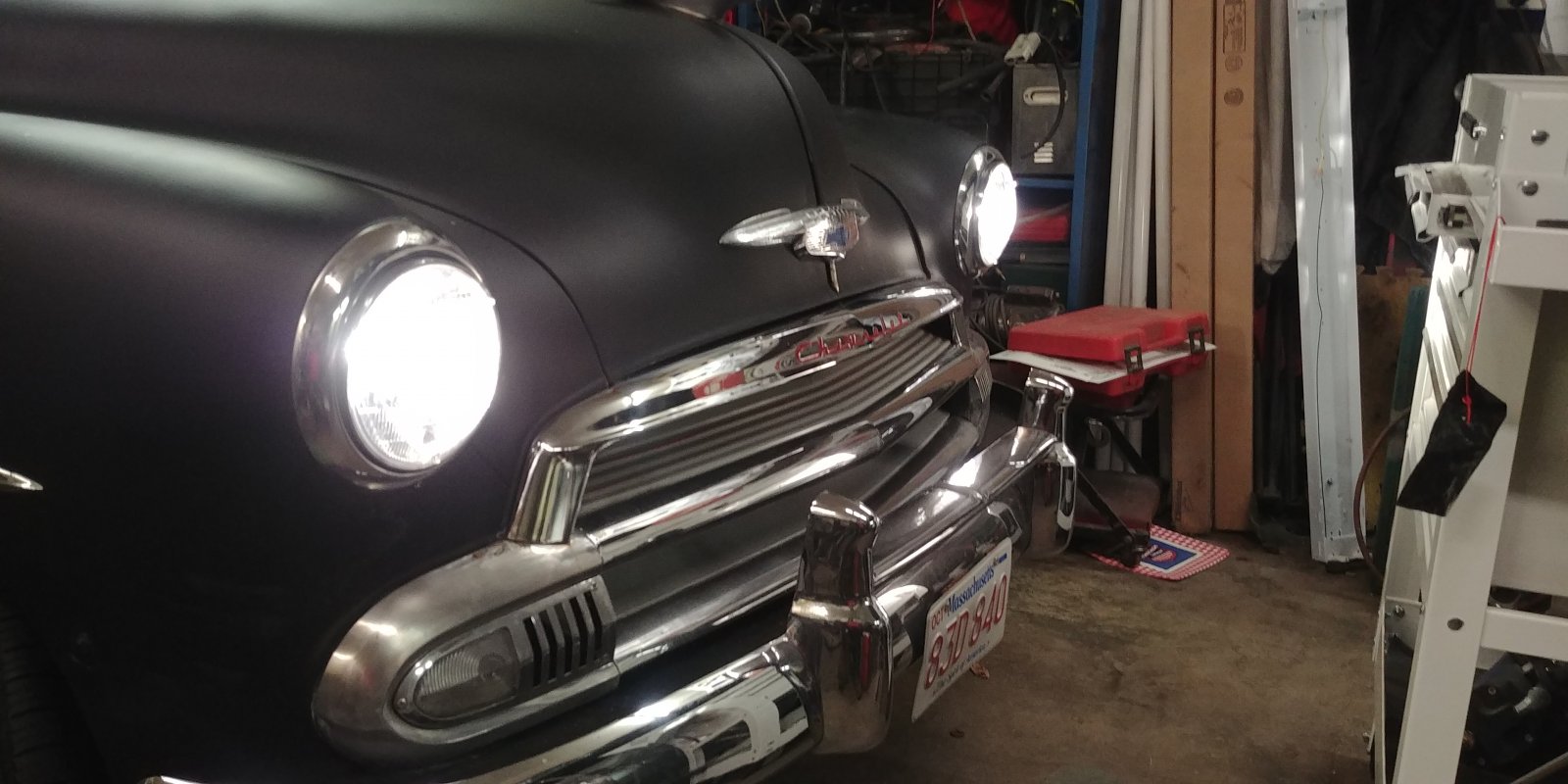

    A buddy of mine that traveled the country teaching Toyota electronics gave me this tip.
    Pick up an 8 volt tractor battery.
    No changing out of any parts or bulbs to your 6 volt car!!!

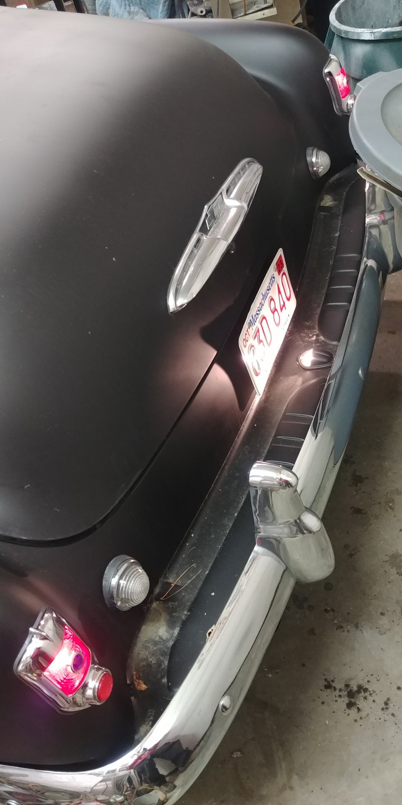

    Your 6 volt starter spins faster, electric windows work fabulous, all lights are brighter!
    The battery should never get back to 8 volts for the regulator keeps it at a high 6 volts.

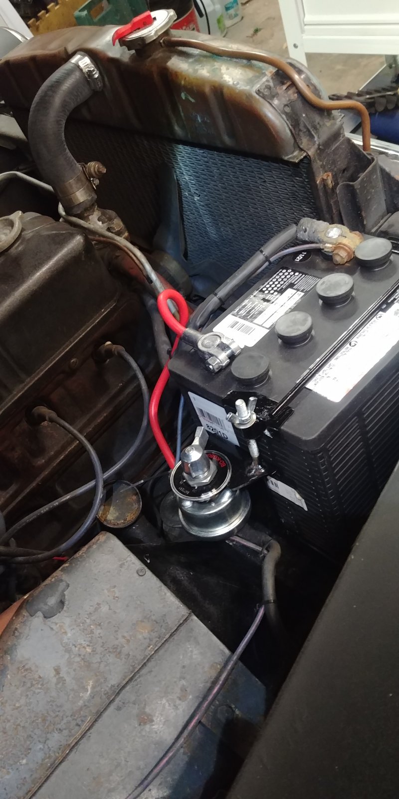

    I made a new battery tray for its a good inch longer then the original 6 volt battery tray. While at it I incorporated a a good battery disconnect mount in the fabrication.
