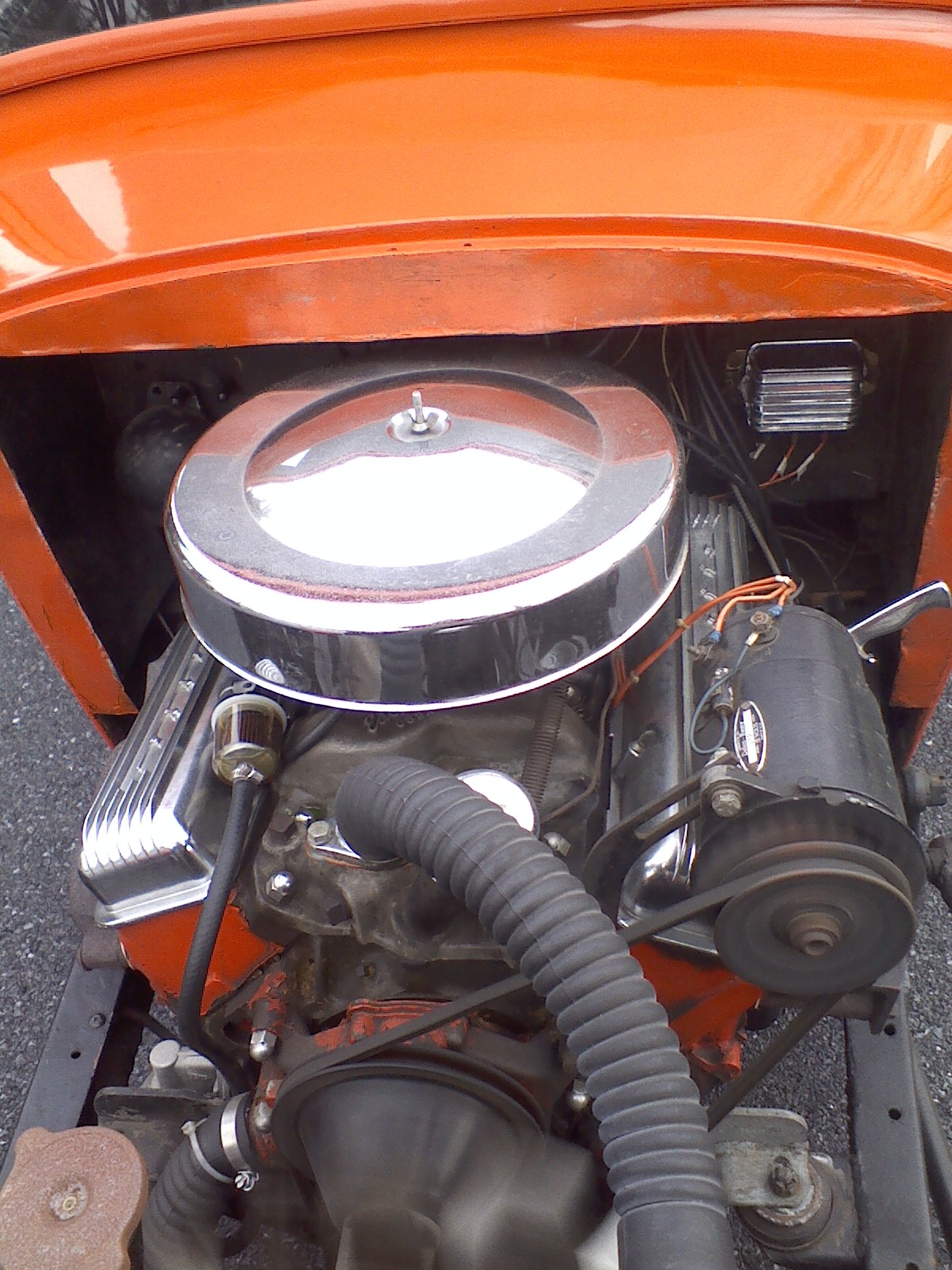

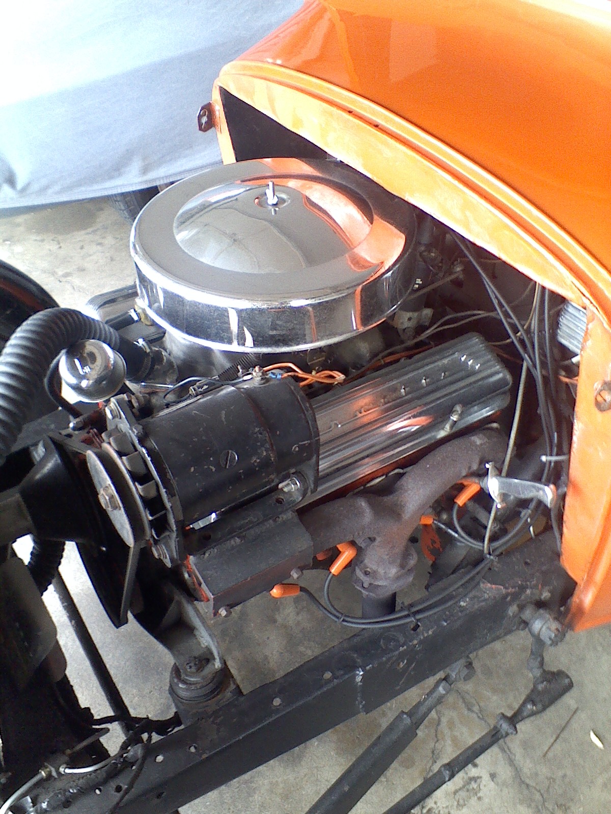

  4. What I did on my 350. Ignore the alternator lol. Short water pump, chrome pulleys, chrome road draft tube, finned aluminum valve covers, repop spellings and hellings air filter ***embly, and 55 Chevy exhaust manifolds. And if using a modern intake like I did paint it to match engine. Doesn't p*** close scrutiny but looks the part IMG_2023-08-11-17-13-16-120 (1).jpg

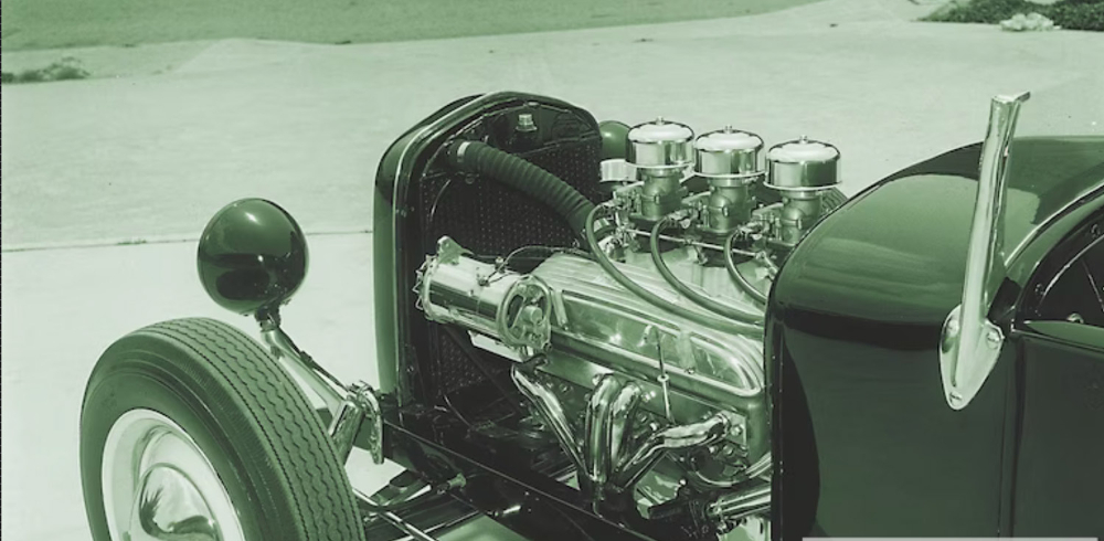

    Only a Hand Full of these ,
    Serious Racer & Hot Rod
    I think 1958 ,, but before 61,

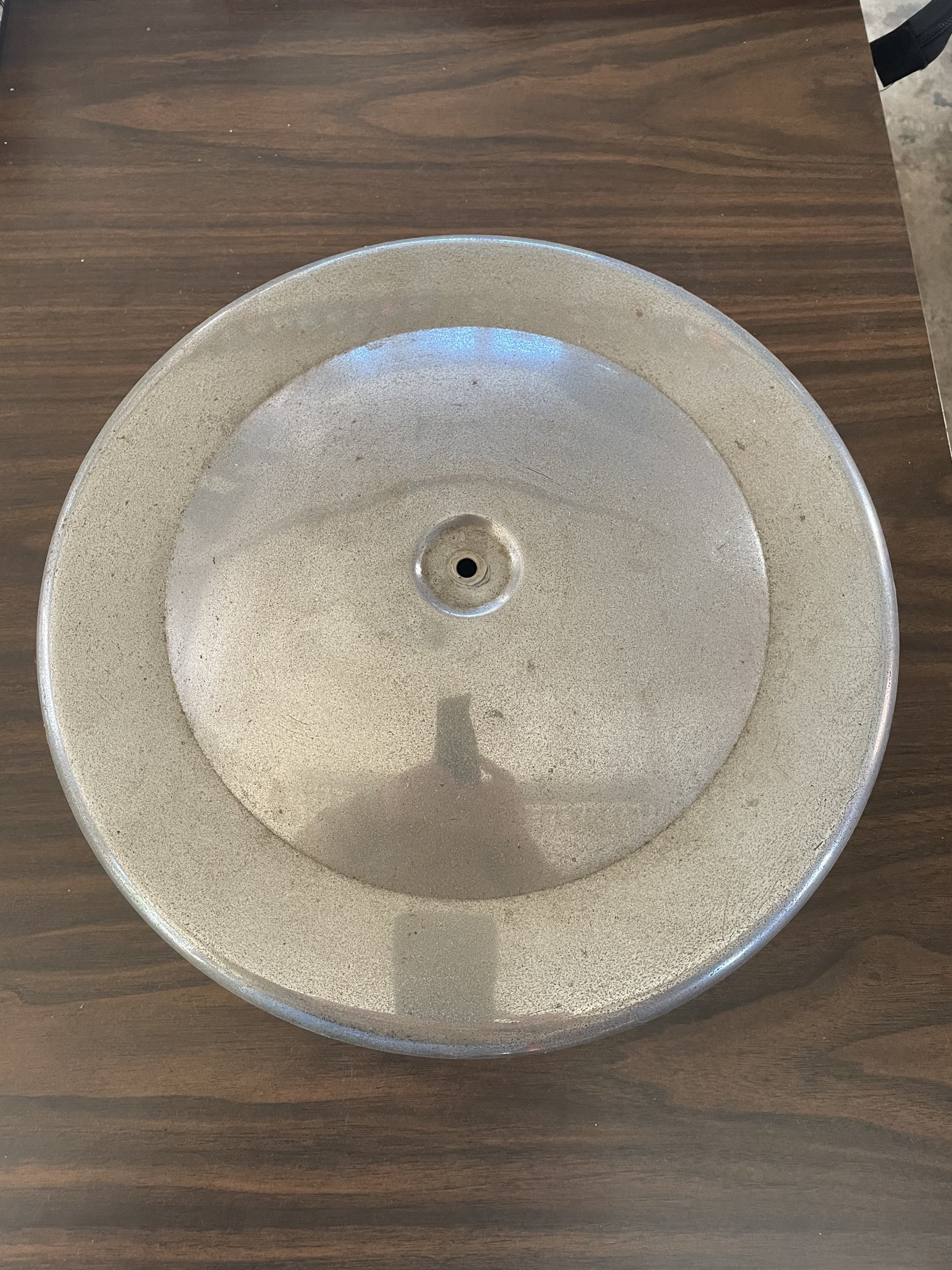

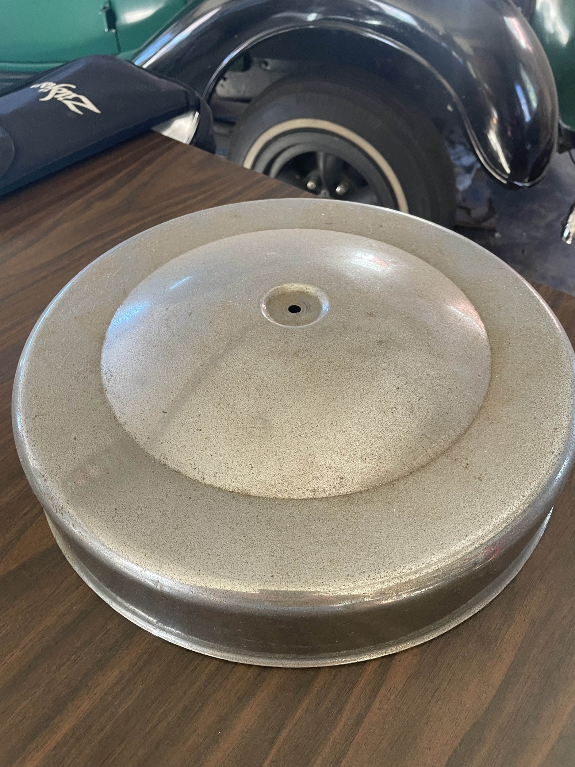

    Nice air cleaner…I’ll ask where did you find it and it’s brand?

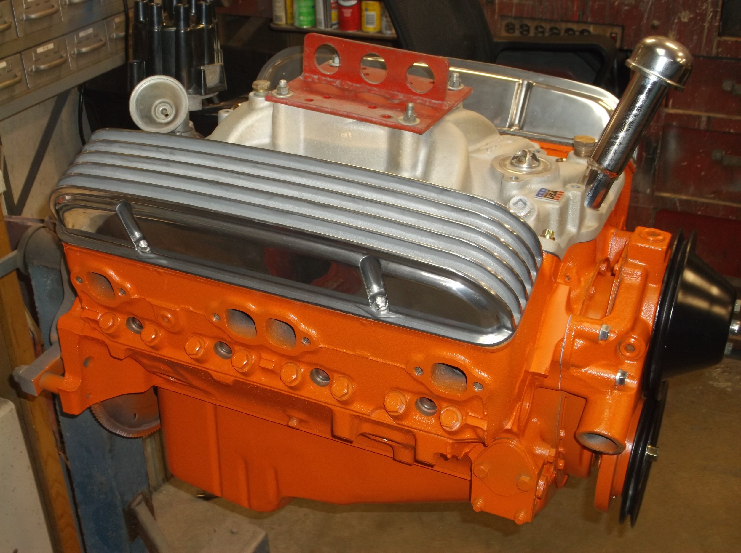

    My fresh 327 with staggered hole Cal Custom valve covers adapted to it.
    Gary

    B4A2F9D0-D4A1-4C58-8B15-F33C6AB37695.jpeg 7F0C28F0-FBC2-4F43-9A46-32C4DA34E227.jpeg Thanks, Found it at Hershey in about 1974. I’ve always thought it is a Stelling &Helling

  24. DDDenny
    Posts: 22,532
    1968 "291" heads.

  26. J. A. Miller
    Joined: Dec 30, 2010
    Posts: 2,349
    J. A. Miller
    from Central NY
    Keep the heads pre-1968 so they don't have the accessory holes on the ends of them.
    Speccie, 05snopro440 and Just Gary like this.
  27. DDDenny
    Posts: 22,532
    Pre-1969
    Deuces, VF-1, tractorguy and 2 others like this.
  28. blue 49
    Joined: Dec 24, 2006
    Posts: 2,138
    blue 49
    from Iowa
    My block is date coded Nov. '65 so from a '66 car or truck. I got a good deal on the 291 heads so that's what I'm using.
    Gary
