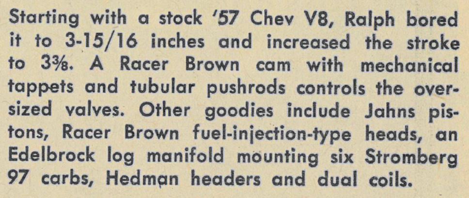

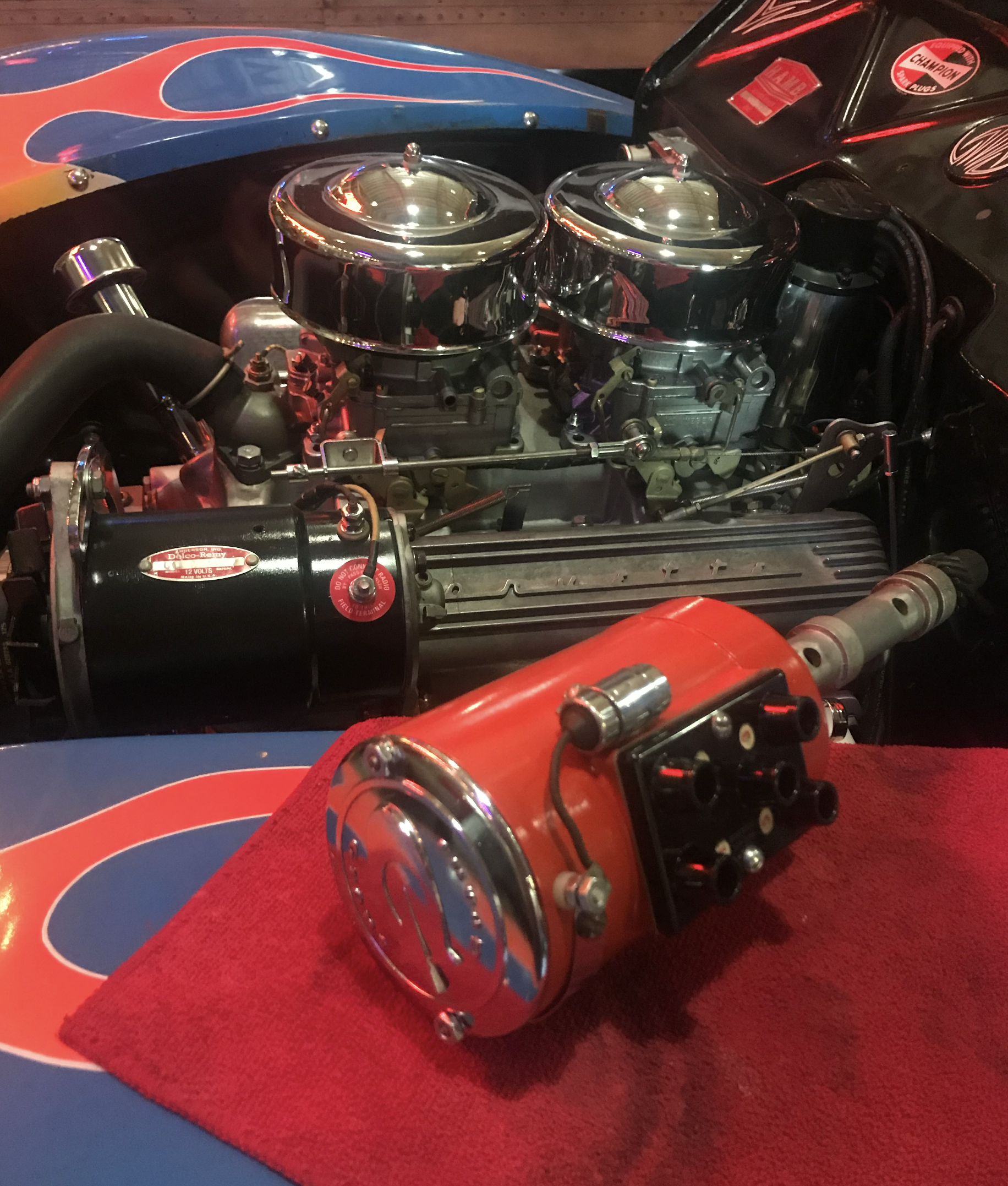

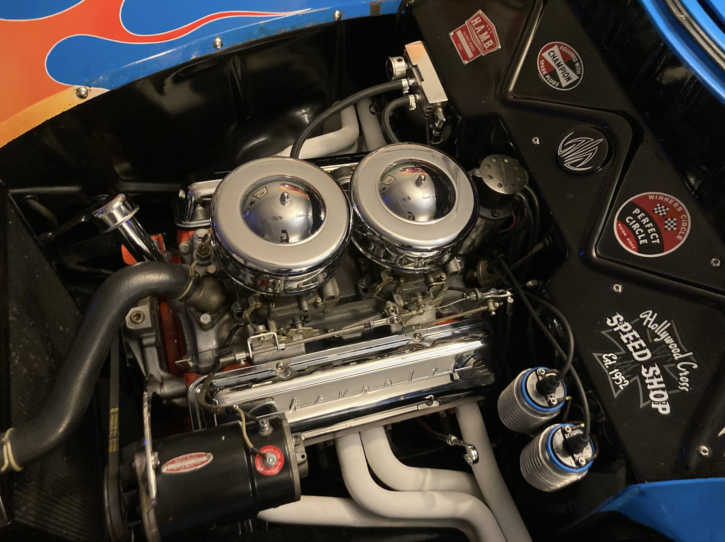

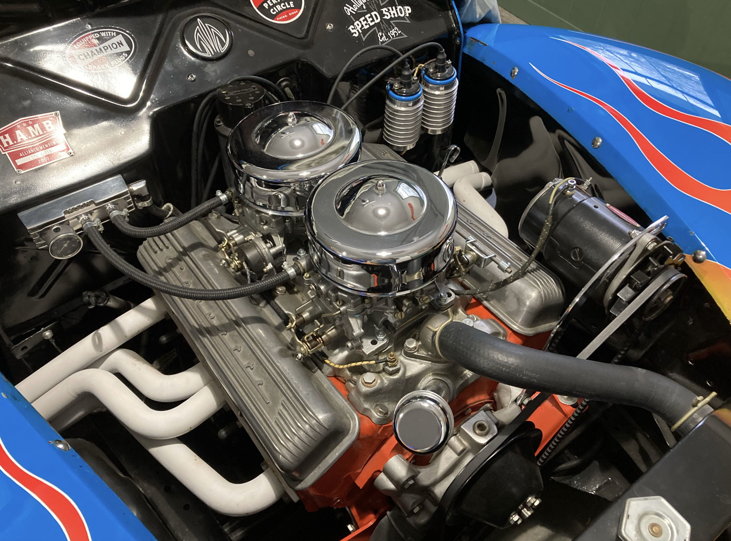

    I did similar as I wanted something right out of the old mags: '62 327 destroked and bore to a 311, real Dontov 30/30 cam, X fuelie heads, Ansen mounts, Spalding dual coil ignition, early matched AFB's on a rare Creitz intake. All the internal jazz backed up with an early Hydro-Motive drag 4 speed with stall fluid coupling.
    I still love the look and sound but keep in mind some early goodies do not make an easy driver... there is always something to tune and adjust. My coveted Spalding flamethrower had me restoring distributor machine to keep it in check (thats why its got a look-a like mag in this pic. The compression is killer on the early style starters and high revs on a restored generator was costly. The Creitz intake cool in theory but a big open plenum making it terrible under 3k, and that Hydro-Stick will beat your back on the 2-3 shift. But... I love it, to me it's a hot rod.
    Screenshot 2024-11-12 at 4.27.20 PM.png Screenshot 2024-11-12 at 4.27.53 PM.png Screenshot 2024-11-12 at 4.32.29 PM.png Screenshot 2024-11-12 at 4.33.07 PM.png

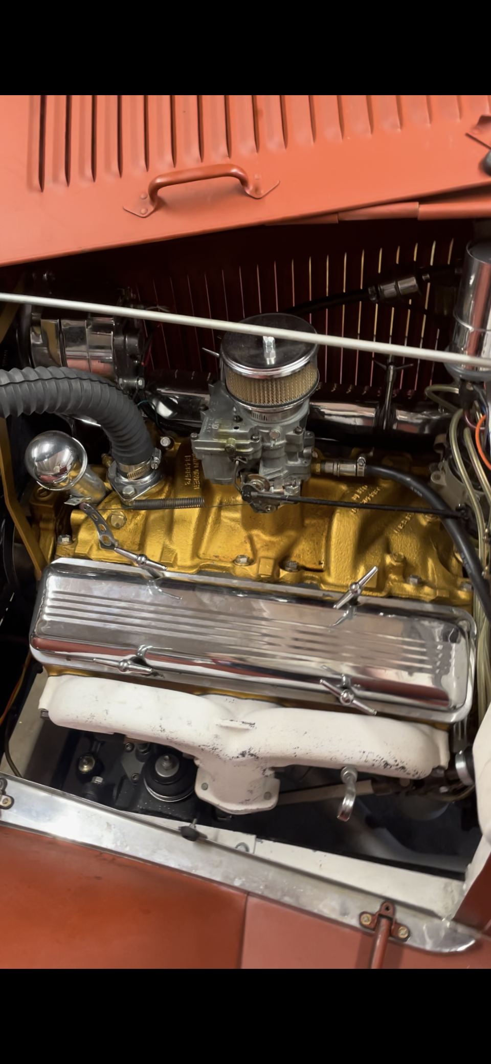

    IMG_8110.png Here’s mine. Minus the alternator and the U joints for my Vega box, I’d say it’s pretty 60s. Mallory brown cap dizzy, cal custom valve covers, corvette manifolds painted white,

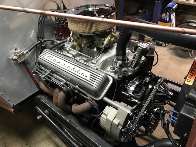

    IMG_20241112_185358.jpg Engine in my 29. 1964 327 , 1958 vette intake , Mallory dual point, air cleaner is a more recent edelbrock but it matches the valve covers pretty well.

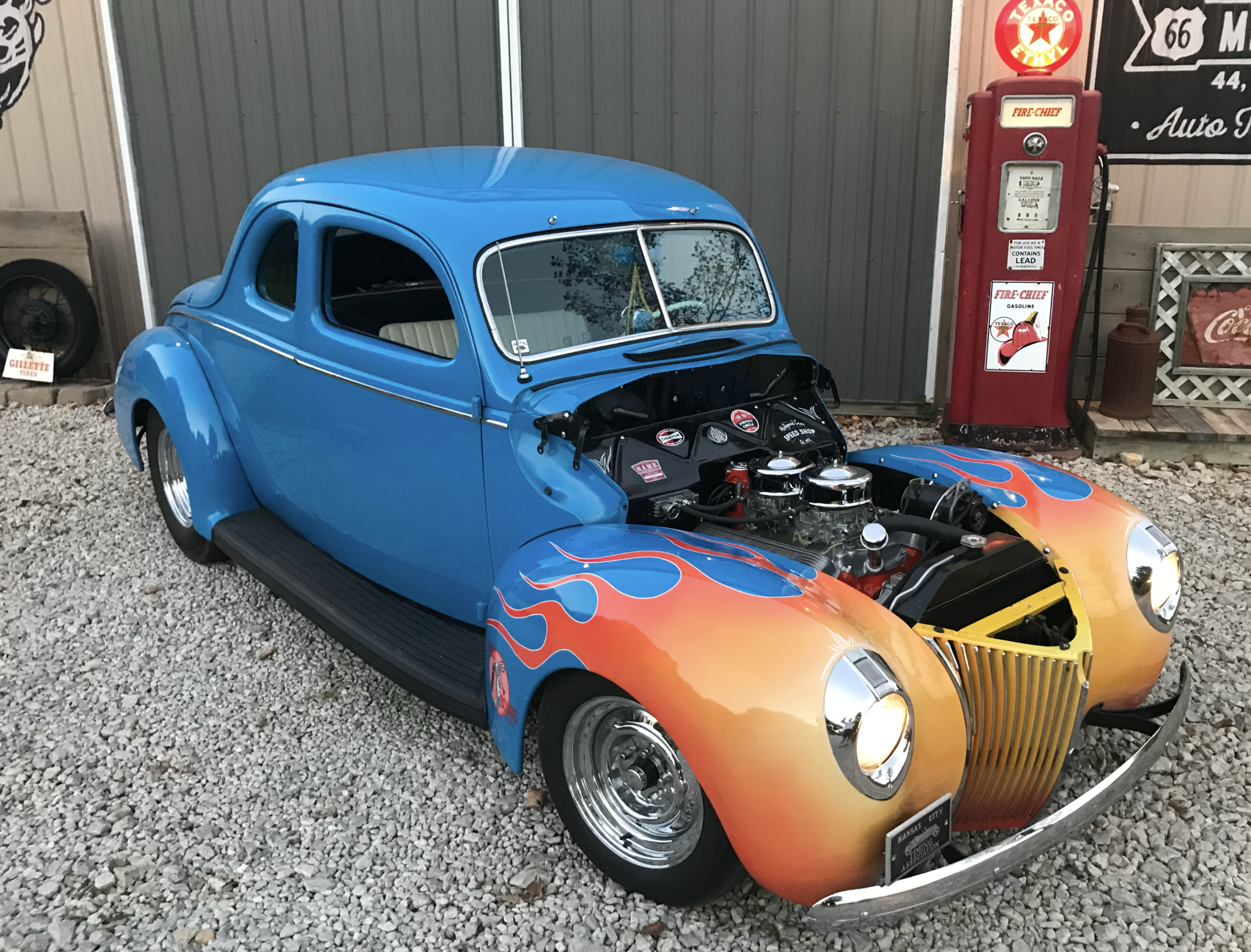

    I was going for mid to late 60's

    @G_Don not trying to pick on you. I honestly don't know for sure so I'll ask here.
    Are those winged valve cover bolts period correct? I know they boomed later but not sure when they started.

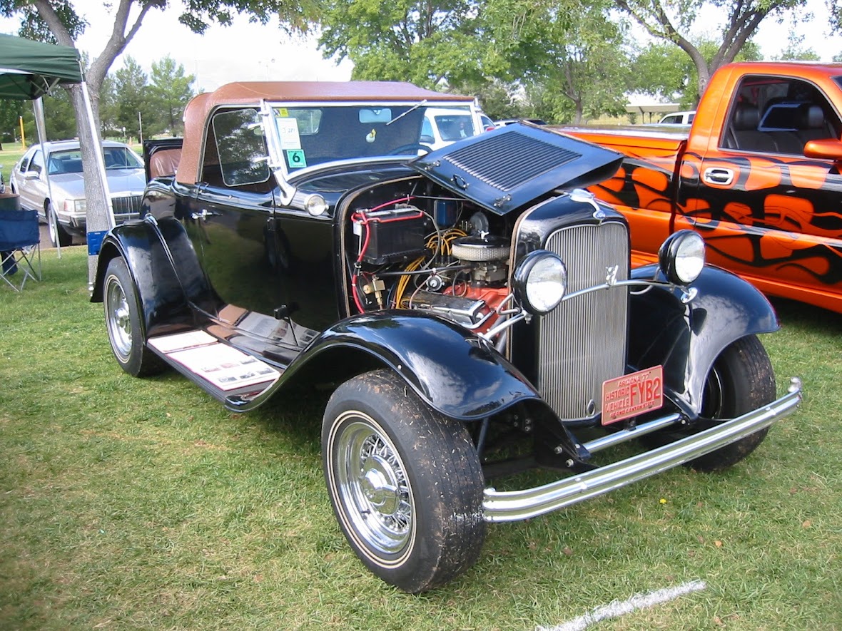

    This one was built in the early 60s, picture was taken in 2005...yeah, there's more than one hot rod with a 2bbl on a small block.

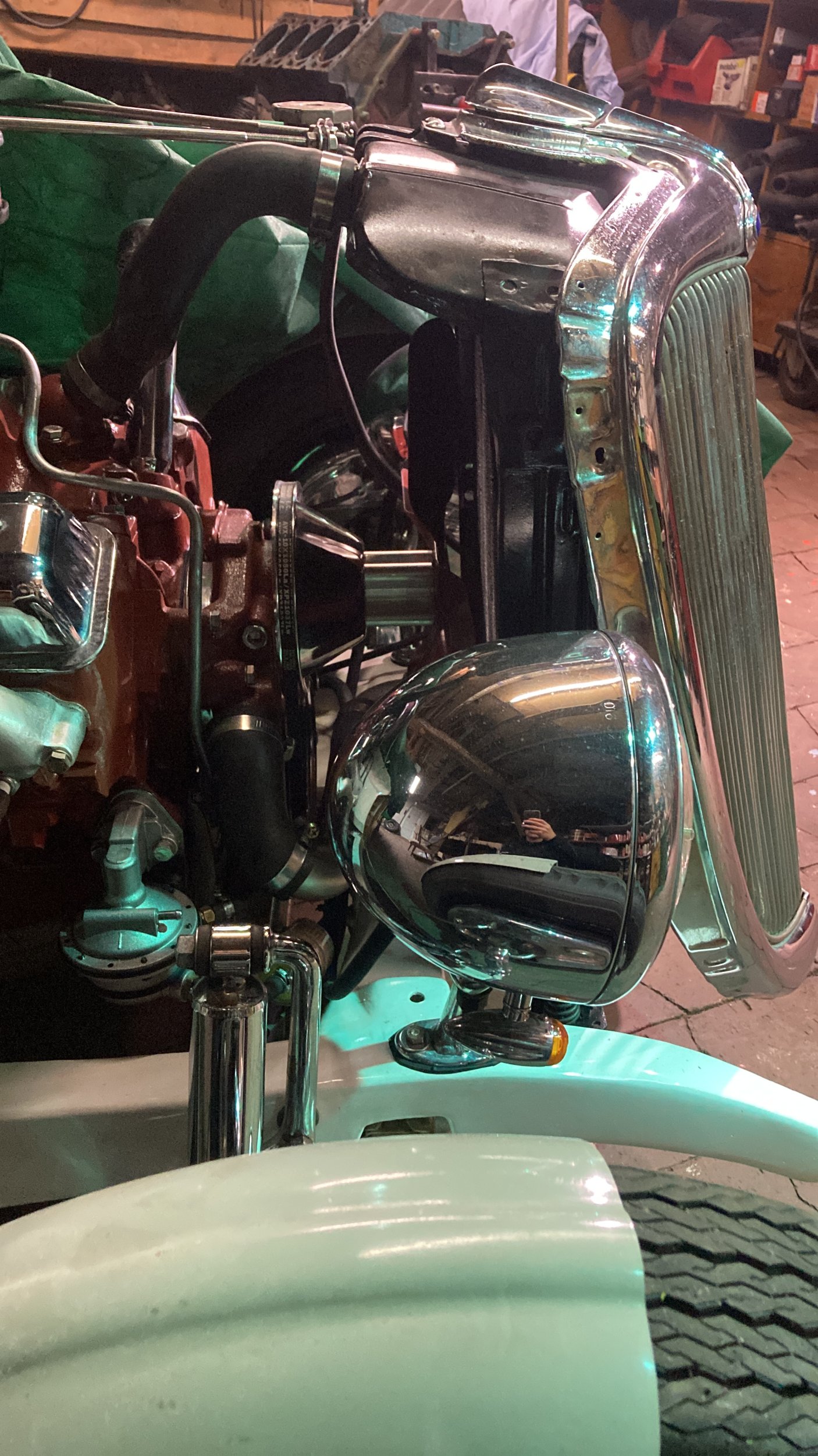

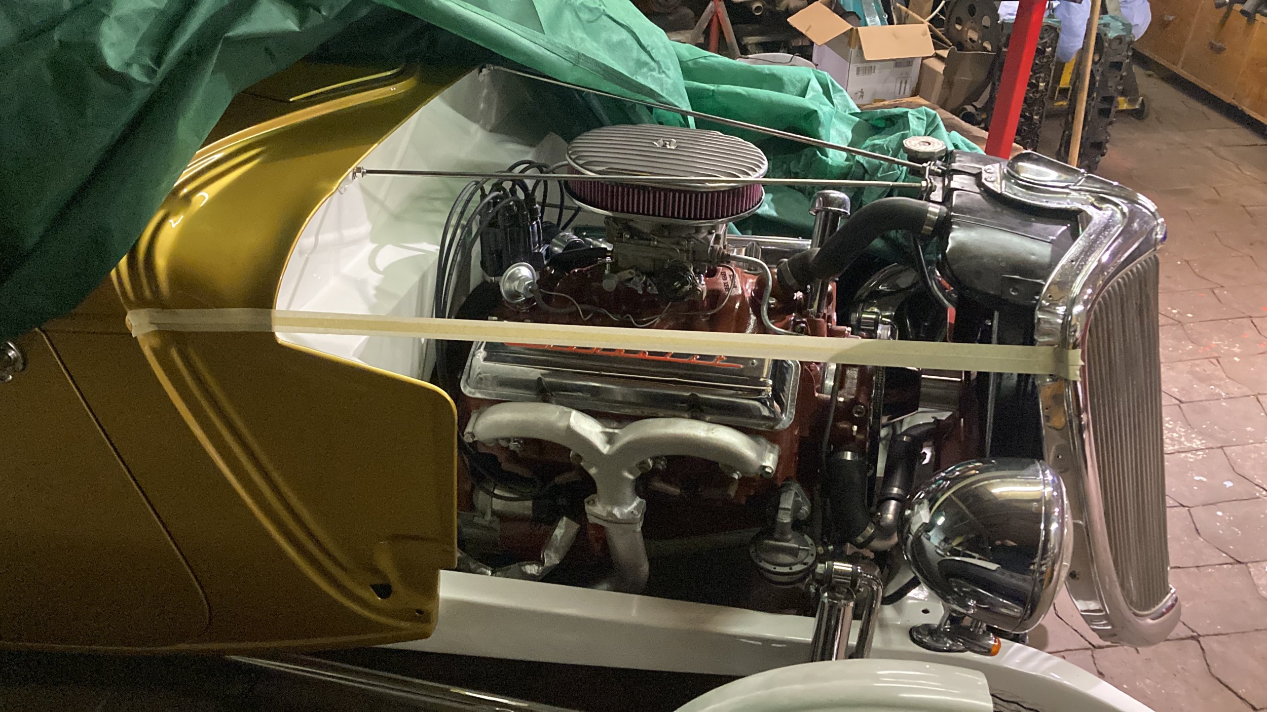

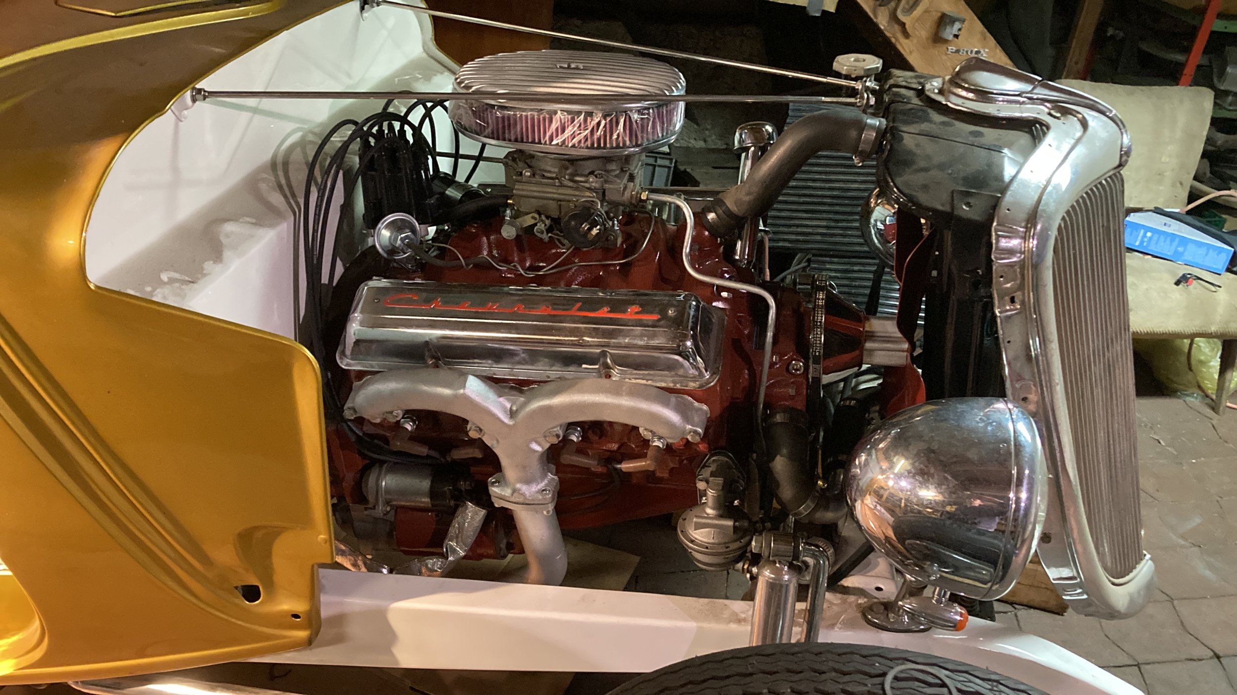

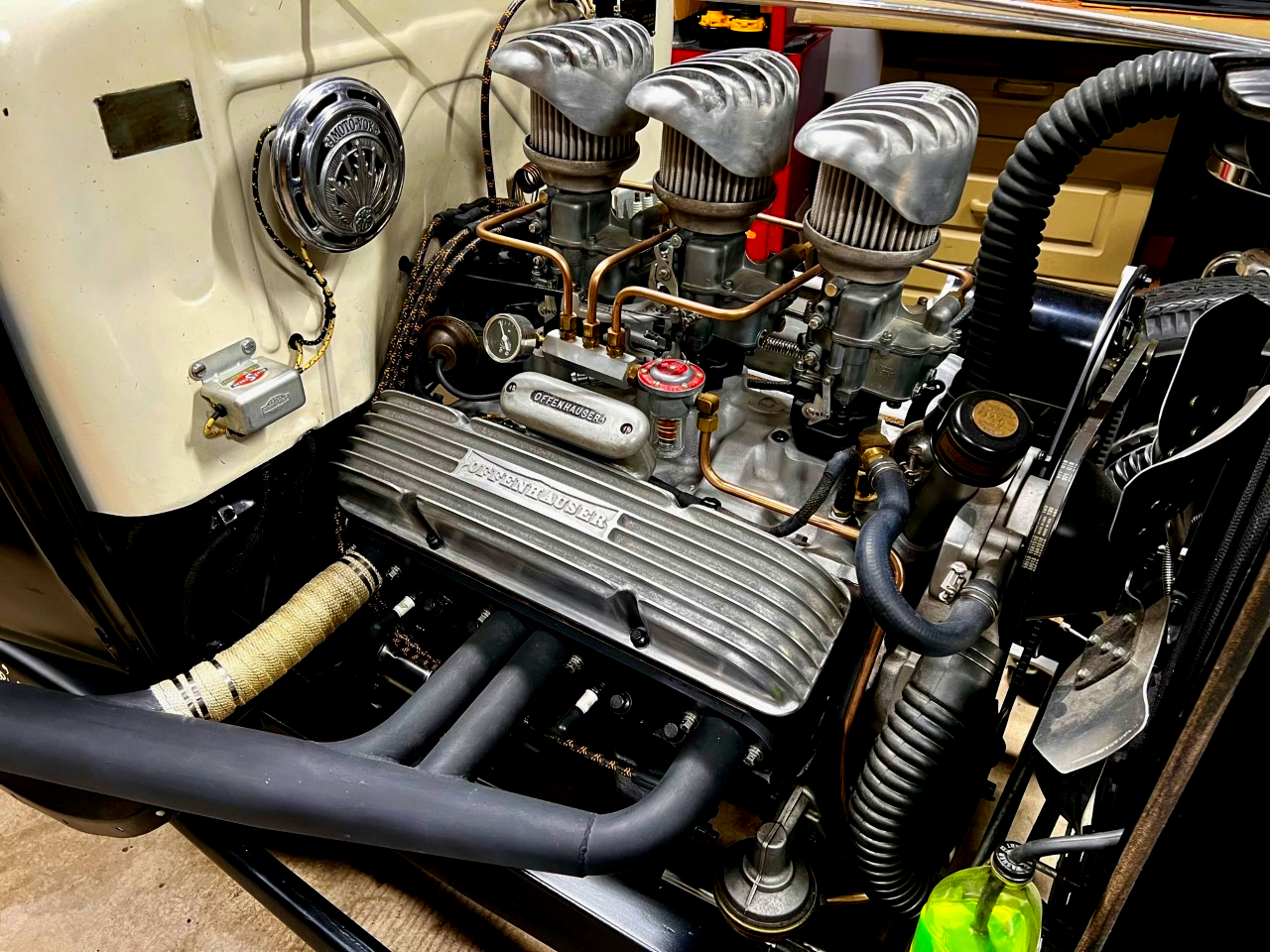

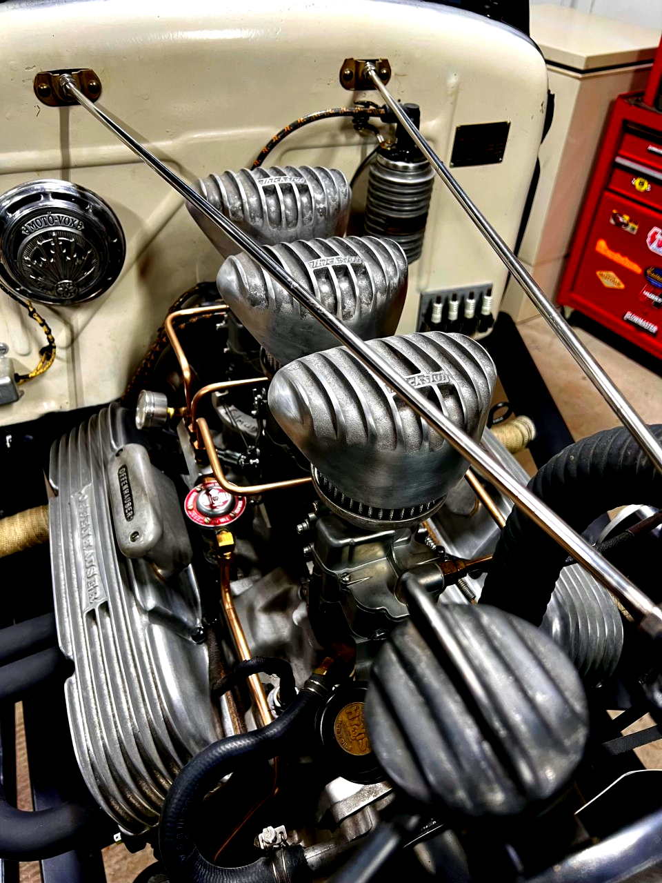

    That's what I tried to do.....with a couple of exceptions. As the period pieces were tarnished with age, I just left everything that way....no polishing. It does have a Zips and the Thickstun carb. cleaners are new ( I dulled the finish on them).....the headers are driveshaft.

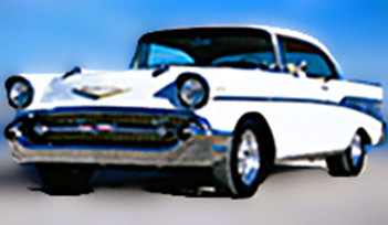

    upload_2024-11-14_2-52-41.png A simple looking 57 Bel Air Sedan with chrome wheels and visible set of Traction Masters underneath. But, a change from a single 4 barrel to dual quads was the best improvement. The next thing was having the local expert, Jocko’s Porting Service do a full port and polish on the 283 heads. Those two things made the Chevy Bel Air instantly faster than anything around.(except for my 348/280 HP Impala)
    The final thing that made this 283 motor powerful was the Duntov Cam from the factory parts department. If the same motor were to be built today, those would still be the exact parts for a 283 SBC motor. Powerful, but not over the top. All parts were tried and trued 1960-61 building techniques.
    My teenage friend had a great job after school. He earned enough money to do the most to his cool 57 Chevy Bel Air Hardtop Sedan. The first things was a set of finned aluminum valve covers. Not the Corvette version, but just the normal finned version and we added a set of Moon Breathers to the finned covers. Some of the others we saw did not grind down the middle fins and installed the Moon Breathers on the sides. The drag racers at Lion’s Dragstrip used them on most of the valve covers, aluminum or not.

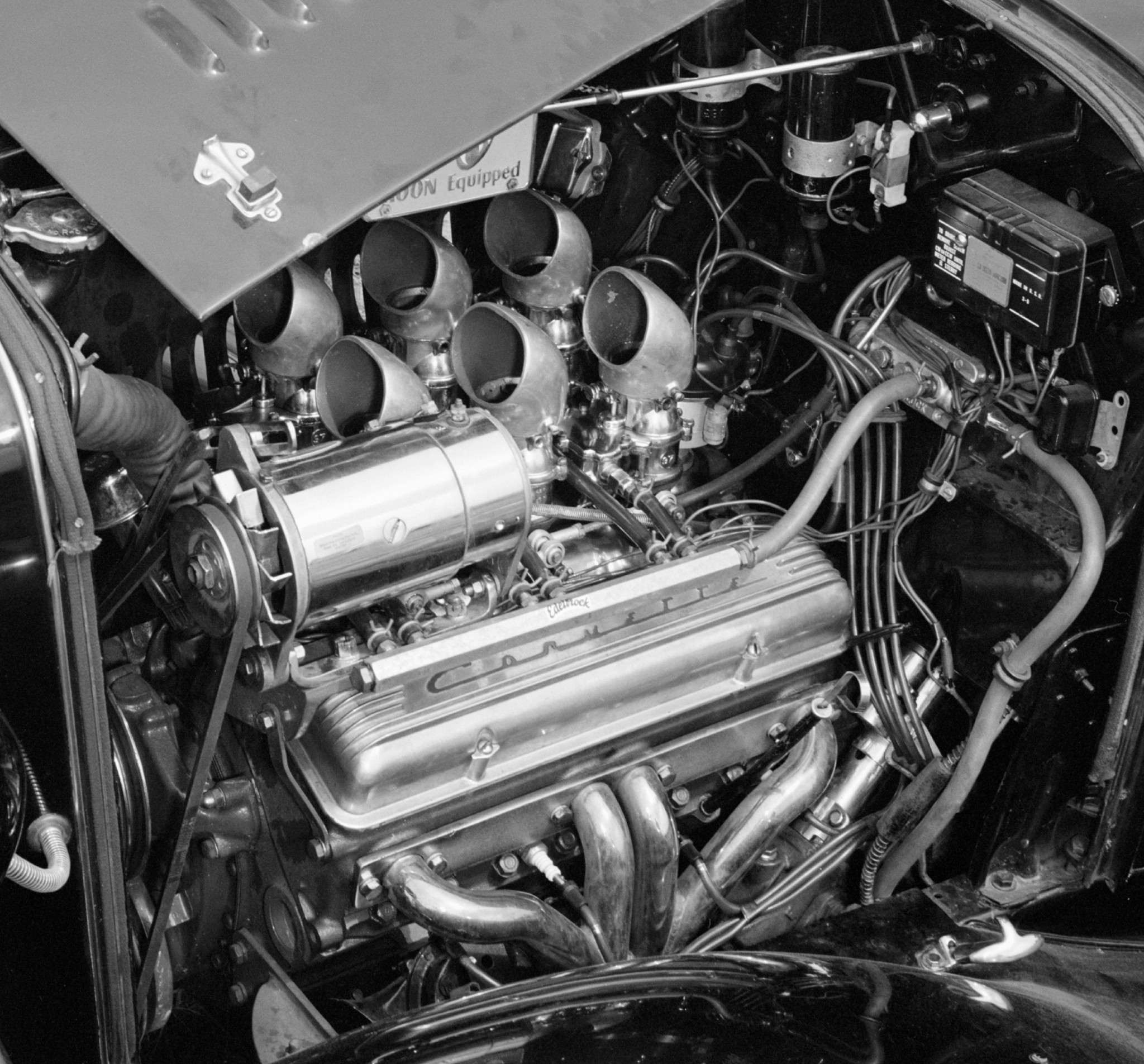

    Now, my brother had saved up enough to get started on a supercharged motor. We did not want a used 671 supercharger, so we were able to get a new, display model as the Diesel Motor Shop owner was going for an all polished look for the large diesel truck motors. He gave us a deal as it technically was used, but never ran on a motor of any kind.
    Then we were able to get one of the first Isky-Gilmer Belt Drive Kits for an SBC motor. And everything started on the new build. Reath Auto bored the 283 to 292 and said it was a safe increase using all blower spec parts + the new 671.
    Our 2nd version of a 671 supercharged 292 c.i. SBC motor in our 40 Willys Coupe. Prior version of the Willys /SBC start up was the 6 Strombergs only, on a 283 motor with a 3 speed LaSalle transmission. There was a definite difference in power and acceleration with the new build.

    Ya know, Im not too sure. They came with some Aluminum Cal Custom valve covers I bought at hershey, and theyre too tall for the chrome ones, but I like them better than using an allen key or a wrench. As shown how tall they are in the pic below.
    I love those offy valve covers. Finding ones without the breather for a straight bolt pattern has proved difficult. Wish they reproduced the straight hole with no breather. The only set I saw were pricey and couldnt afford them.

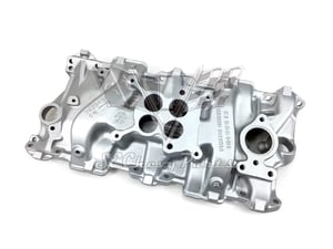

    Correct from a performance 4bbl. But actually there was a 55 Alum wcfb 4bbl. It's odd, has bolt holes for adding oil filter.

    No, that's an intake manifold from a Chevy powered swamp buggy used by the armed forces. The two bolt boss was for part of the underwater equipment to bolt to. I've seen lots of guys try to p*** them off as a Corvette intake.

    What year? Had small ports, heads would date to pre 1959. Still GM.
    I used to think Marine application, light weight.
