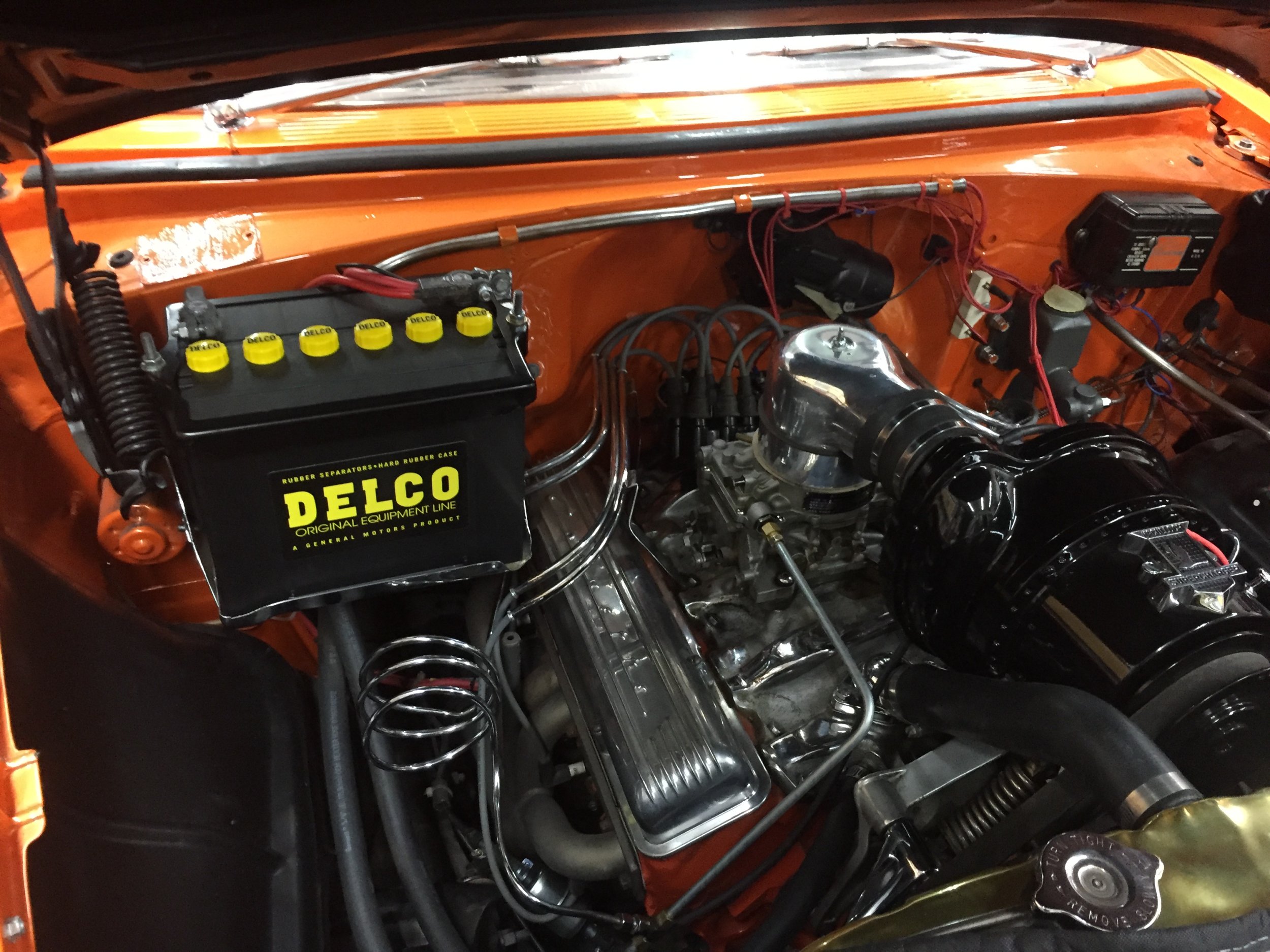

    My attempt to make Vortec heads look 64 correct, drilled the Vortec intake for the oil fill breather tube, also have valve cover adapters under the 327 covers :D

    Not the same style accessory holes as the 1969+ heads. Two different things.

    what is the story on those accy holes. I had never seen early heads with them before. Maybe big truck accy holes for the air pump for air brakes or something??

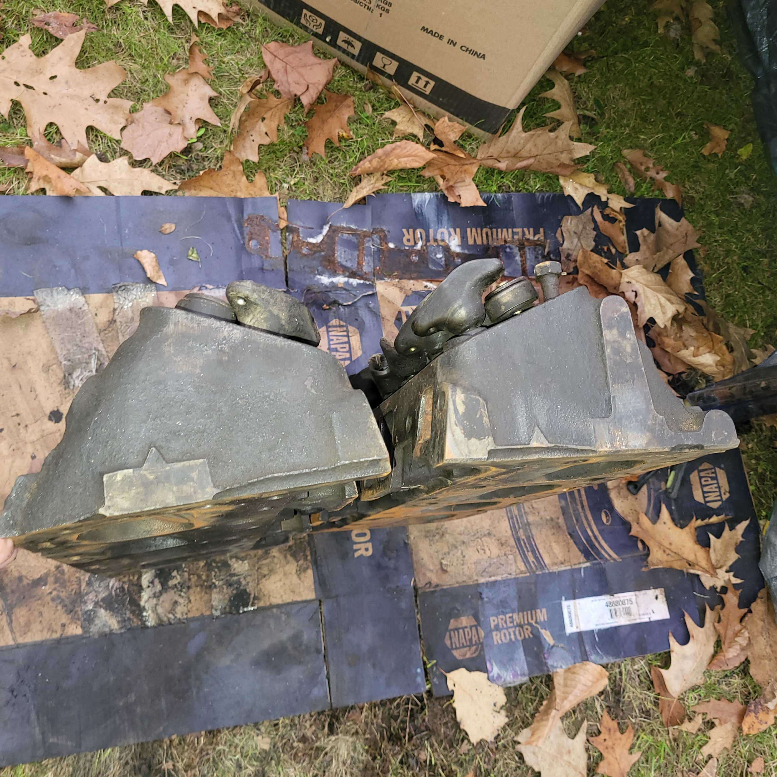

    1958 and 1959 first design cylinder heads had an accessory boss on one end of the head; when installed on the engine, only the driver side head had the boss facing forward. This is where the compressor for the optional air suspension mounted. The air ride was discontinued in mid 1959, at which point a new head casting was made with no boss and the first straight across valve cover bolt holes.

    A pair of early 19 20241119_065557.jpg 59 power pack heads.
