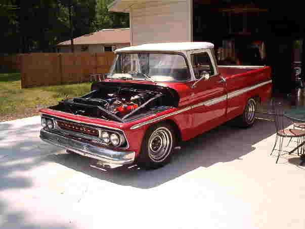

  17. Retread
    Joined: May 7, 2006
    Posts: 6
    Retread
    Here are my rides: '65 C-10 and a '641/2 Mustang[​IMG]
