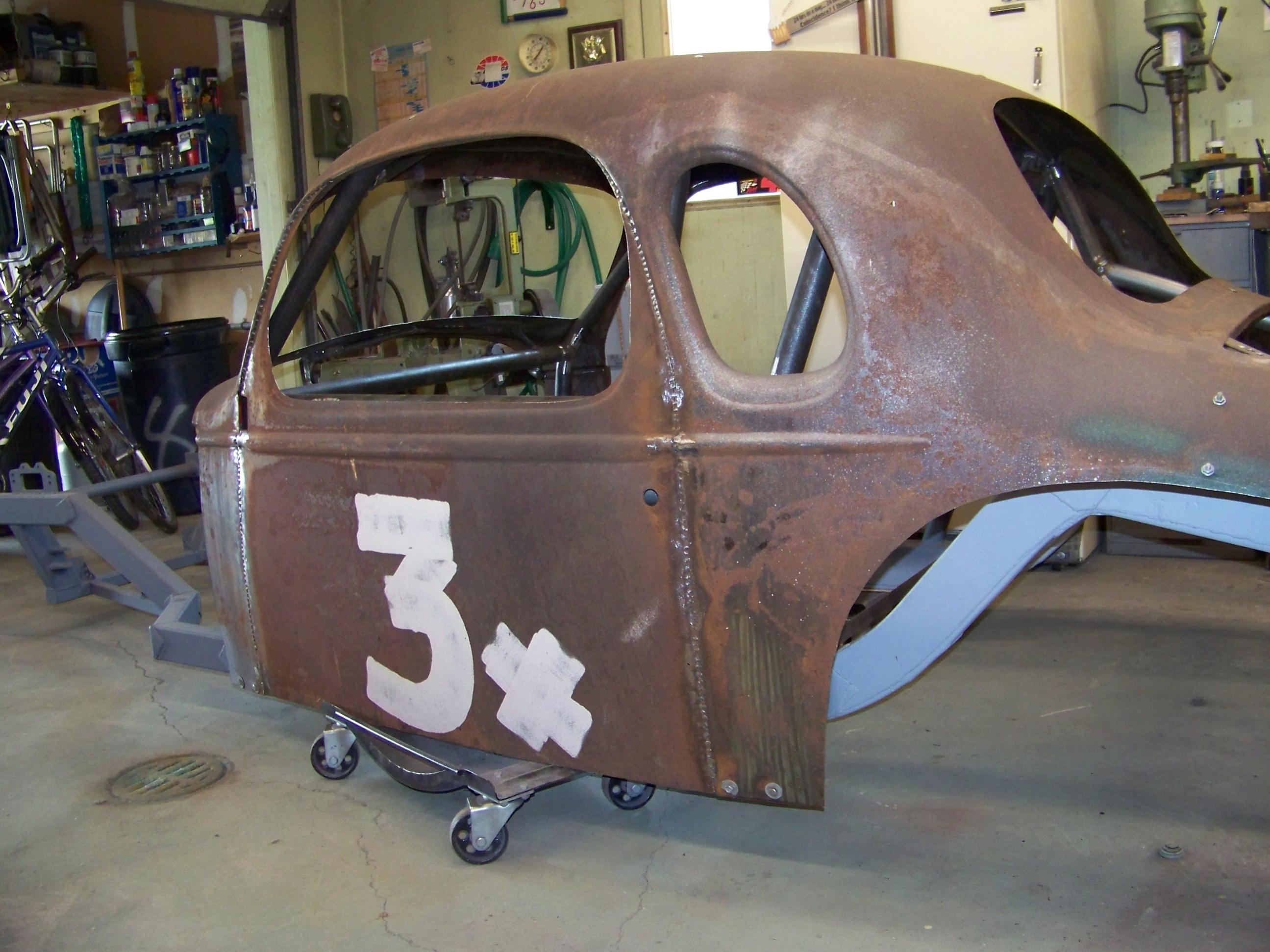

    If anyone can explain to me how to post photos, I could take some pics of models I made back in the 60s & 70s....#55 Mike Miller coupe, #12 Merv Treichler coupe, #18 Dutch Hoag coupe, #33 Bobby Merz coupe, #7 Dutch Hoag coupe, #88 Mike Loescher coach & # 6 Troyer Pinto.
    Leadfoot4....Do I know you? I'm in Spencerport (not far from Webster), if you ever want to stop over for a look. I'm also building a vintage Modified (36 Chevy coupe) that you might find of interest.
    Bill

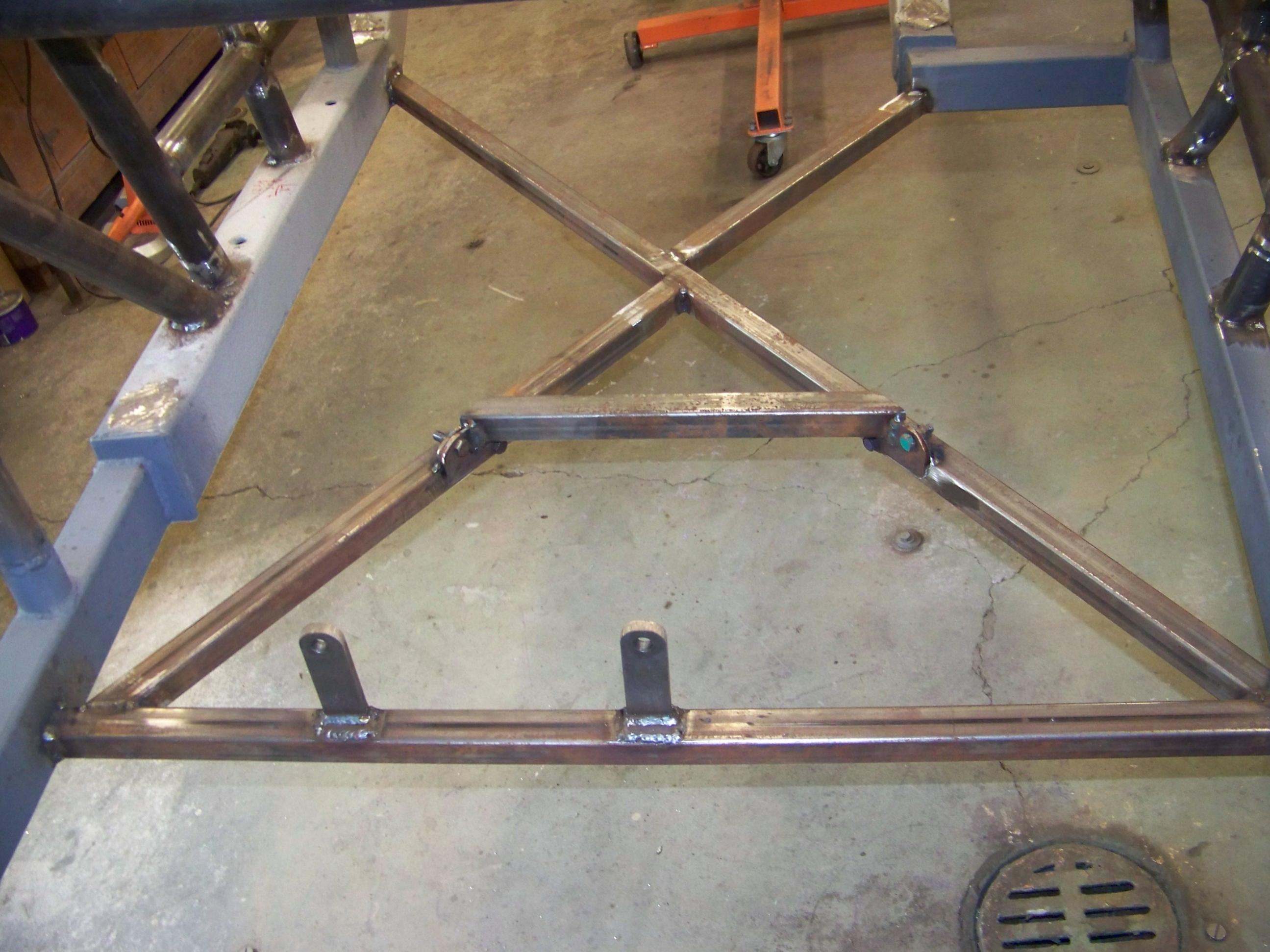

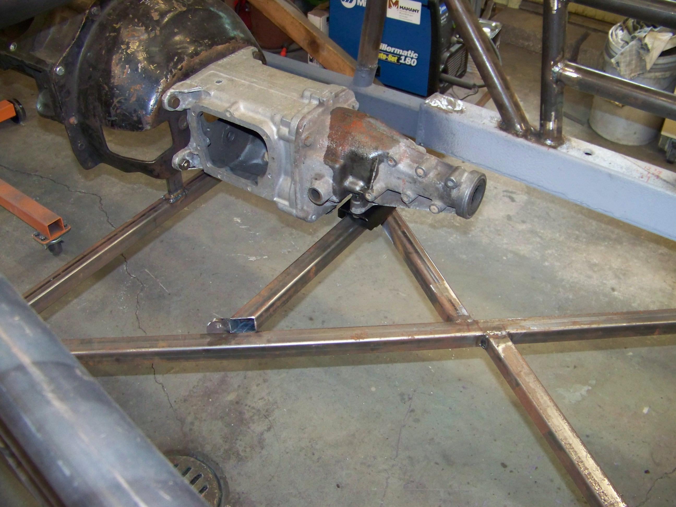

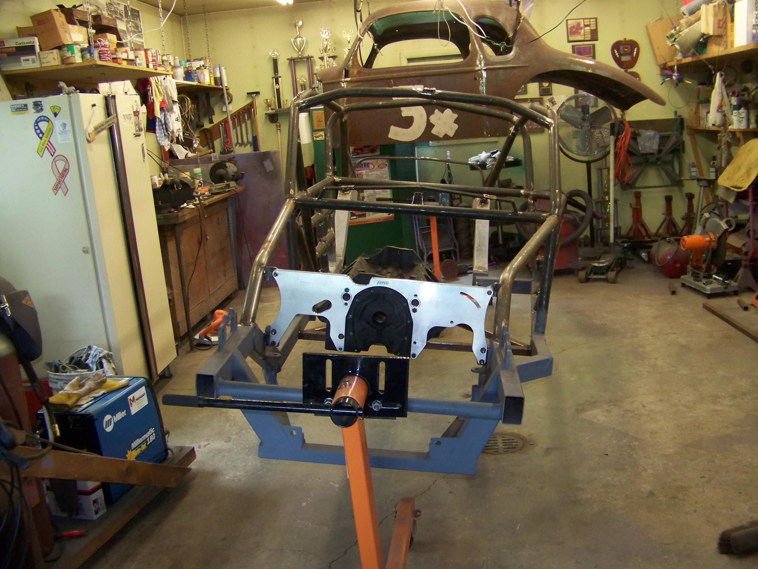

    OK....that worked (Thanks, Isettajohn!). These are roughly in chronoligical order...

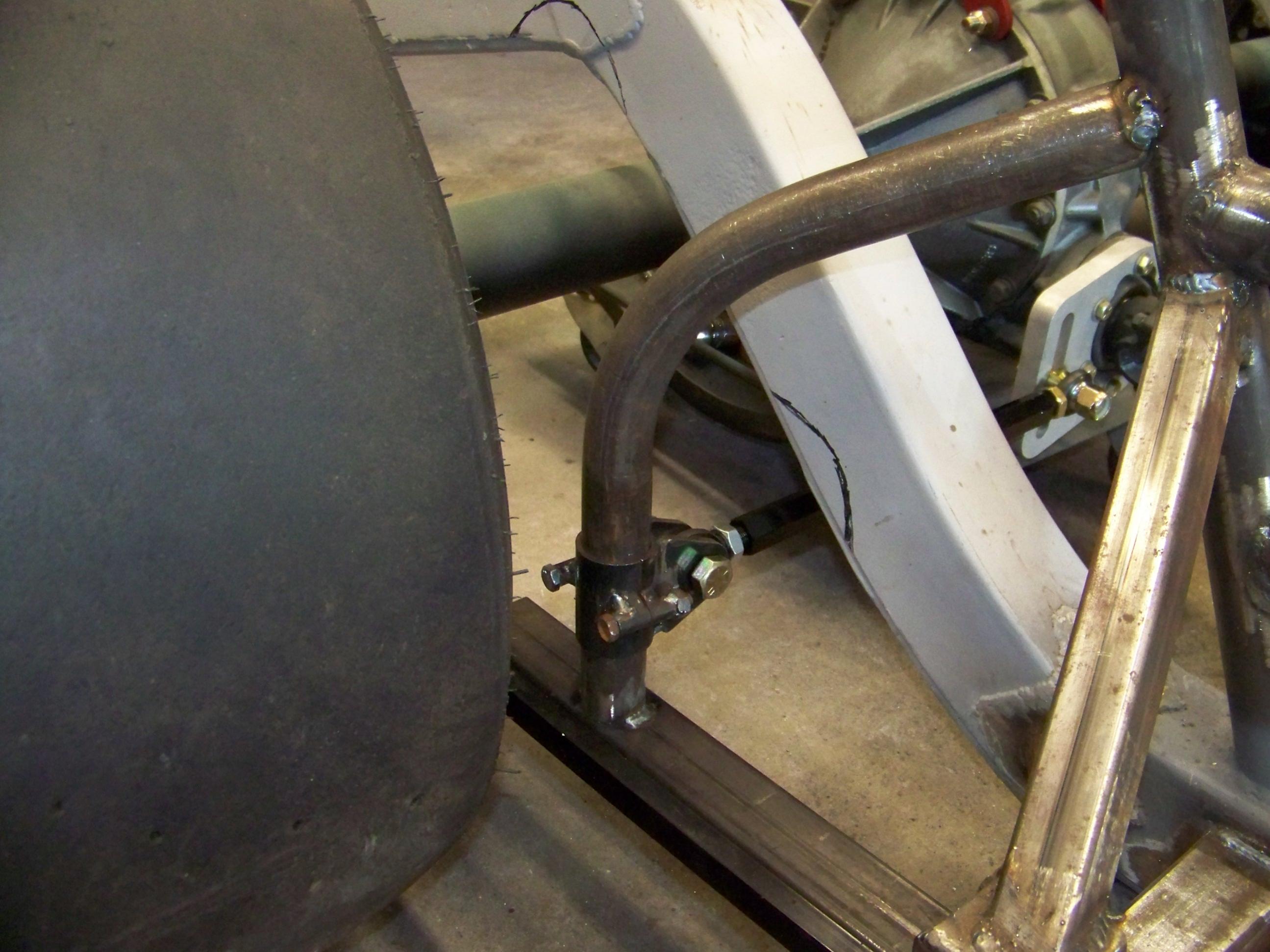

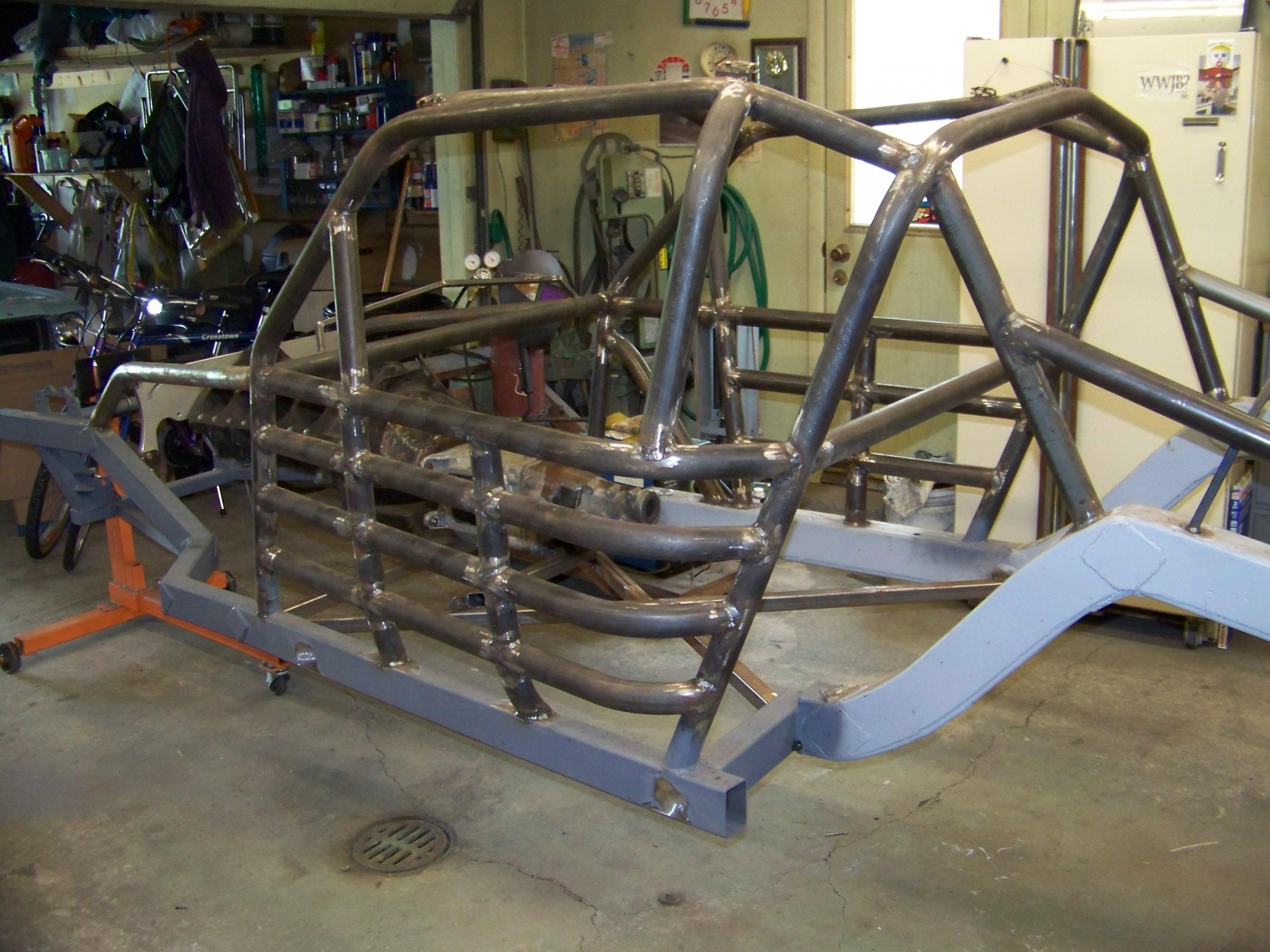

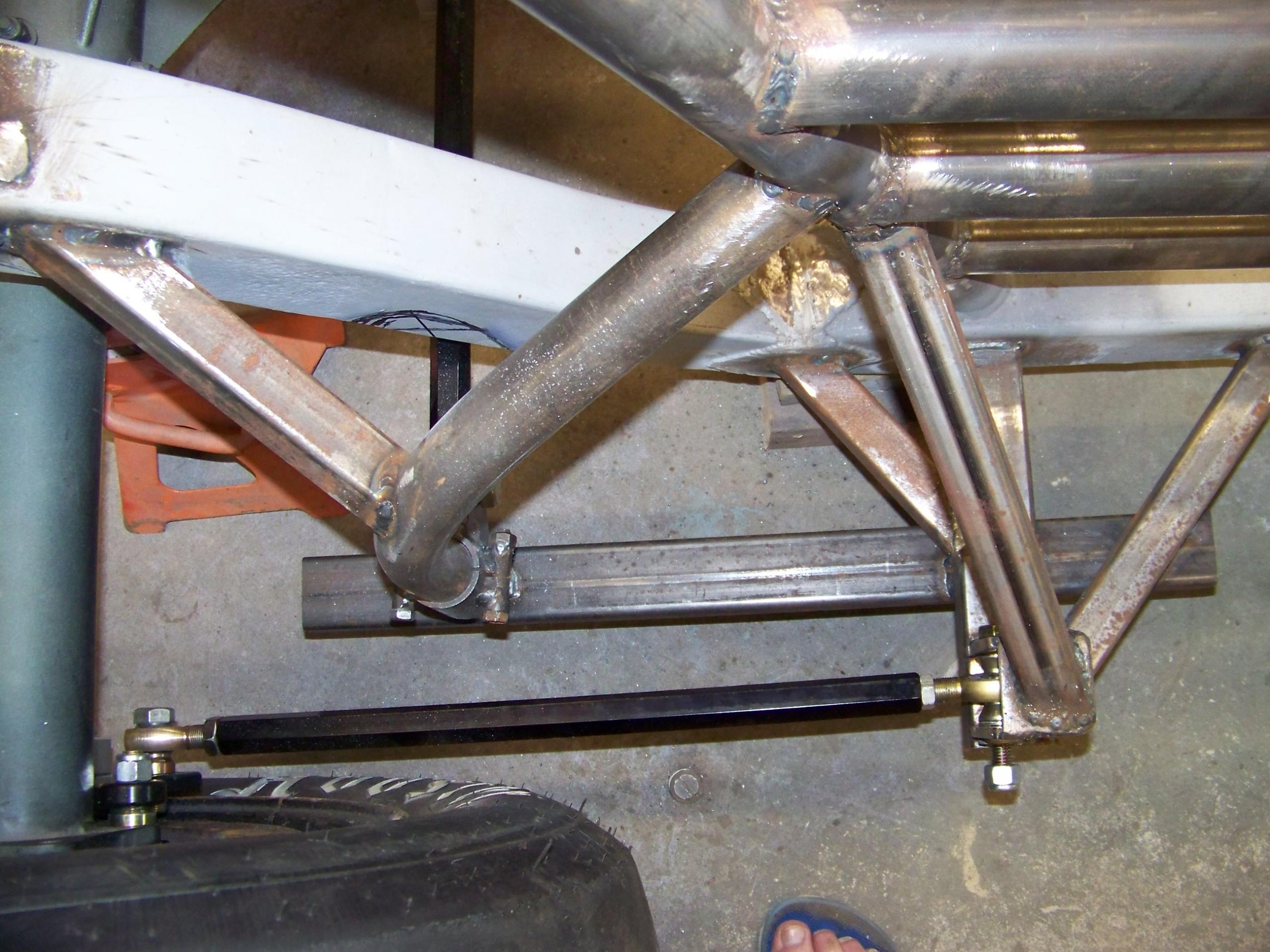

    ....and a few more

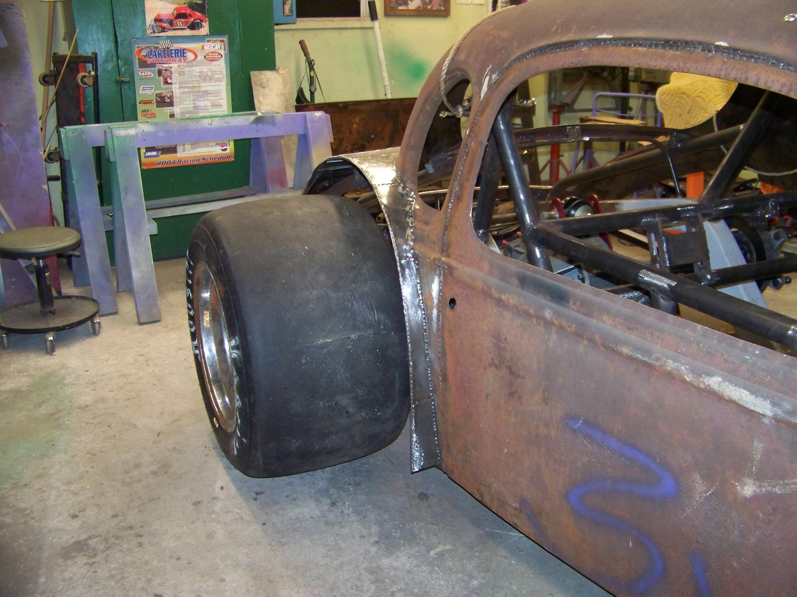

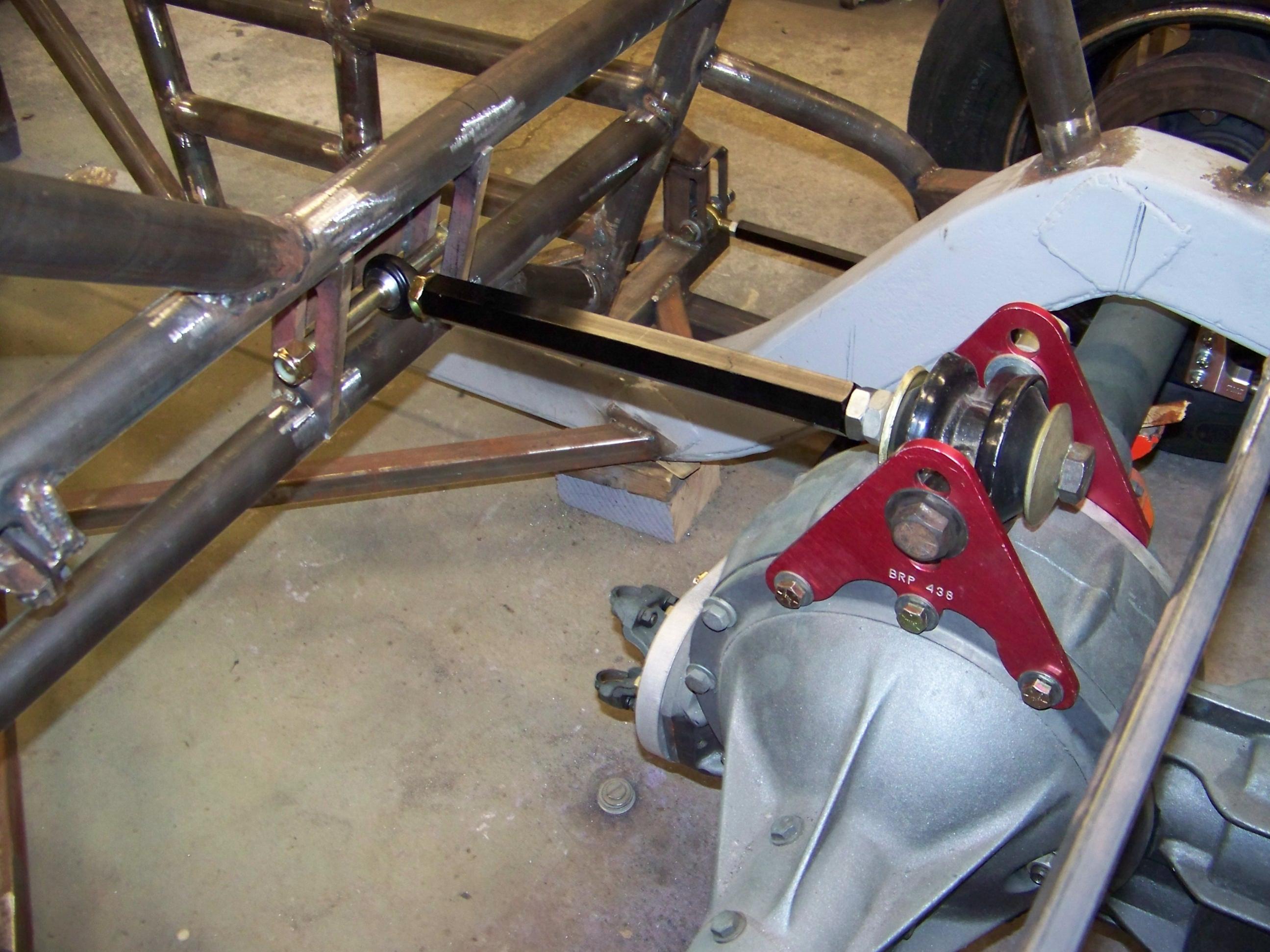

    Finally, getting the rear end mounted. This weekend will be spent modifying the body so the rear tires have enough clearance & to try and make it look "nice", It's gonna be a challenge cuz it's wicked low!

  8. What did you use for the primer colored main rails for the rear kick-up?
    Almost looks like recontoured Scout frame rails.
    Looks great. Nice build.

    Good catch...the rear clip is a (modified) Scout frame. I cut the kickup to give me more clearance. The latest pics show how I spent my weekend.

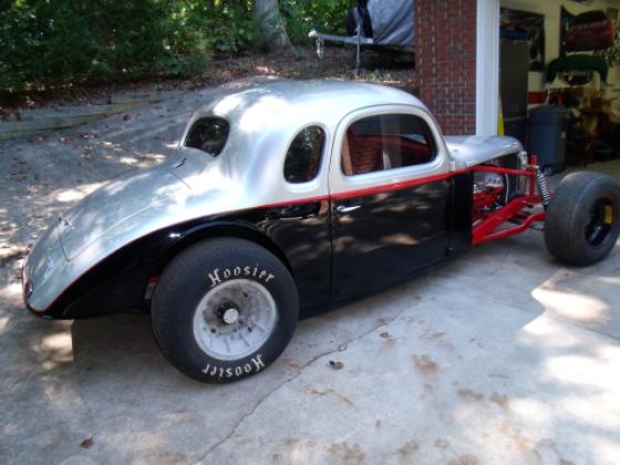

  21. Here's a couple of pics of the '36 my buddy is doing down here. I did the complete rolling chassis/cage, engine and Q/C rear.
    We're gonna' fire the engine later this week for the second time. First time the distributor was wrong and we didn't get oil to the rockers. The $125 oil priming tool and 348 truck distributor with a Petronix were both wrong. Lesson learned on W-engines (aka boat anchors).
    Rims/tires, headers and bumpers are next. Plan is to take it to Daytona.
    Back to your car:
    I cut a Scout frame up like that for a local vintage racer (not the one in below pics). We used a straight front axle.
    This car will be lower than low with the tire that far up the quarter. Is that part of a rear fender you used to fill the rear portion of the well well opening?

    Yup...it's gonna be down loooowwwww, alright! Ride height will be @ 4". And yes....I used the back part of one of the original fenders. That 36 you posted is a real beauty. Street legal too?
