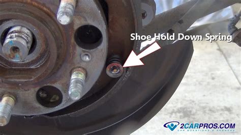

    What if you clipped the "nails" holding the shoes to the backing plates, might get things moving around.

    yup, another vote for cutting the heads off the hold down pins. If you use a puller on the drums there is a very good chance you will ruin them and there probably isn't much aftermarket support....

  4. Another vote for cutting the heads off the nails.

    I'm not familiar with this brake setup. When you say cut the nails, what are you referring to?

    you should be able to locate these pins on the backside of the drums. Use a die grinder to cut the head, that should loosen the shoes some, hopefully enough to hold the drums off.

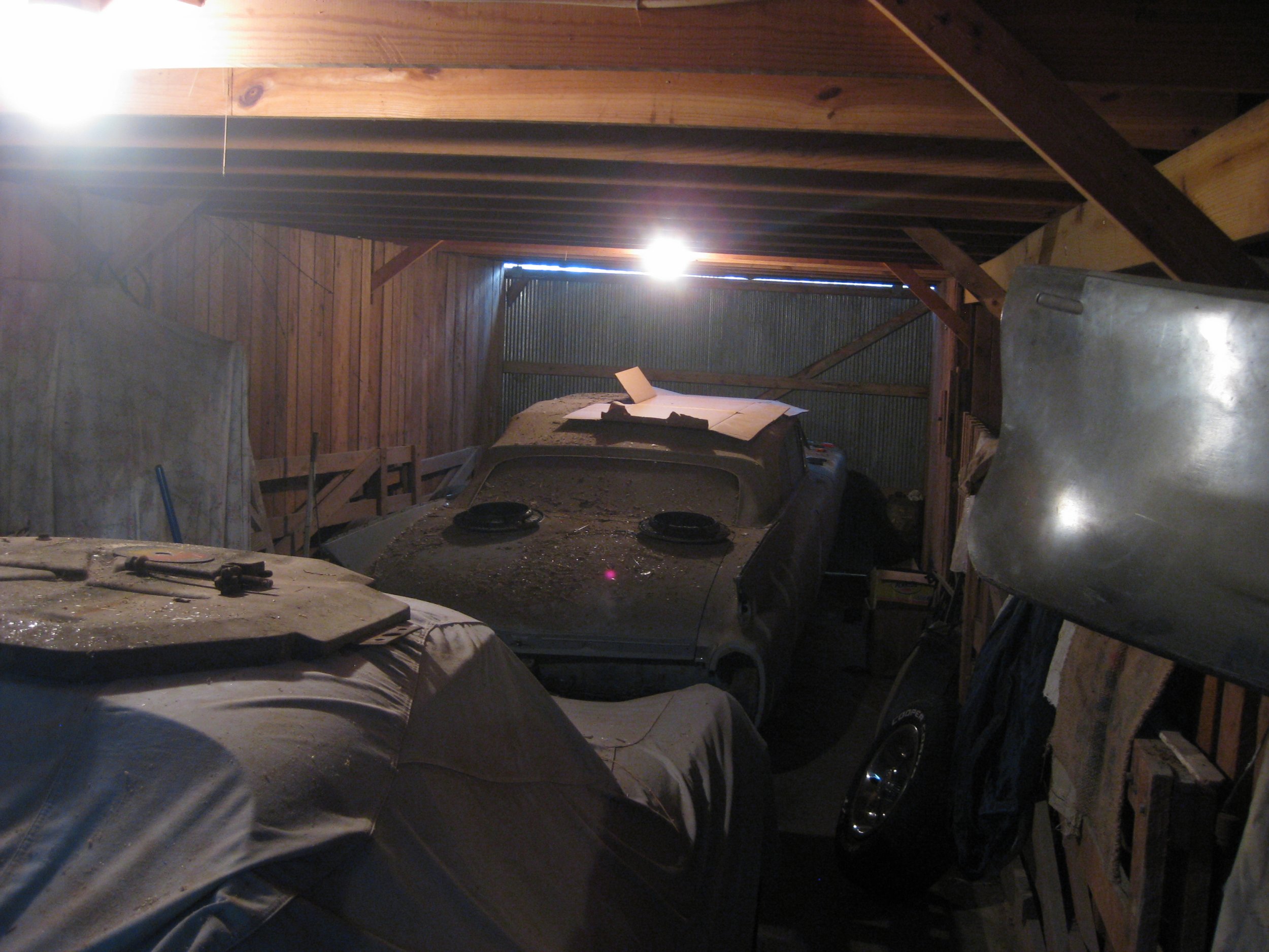

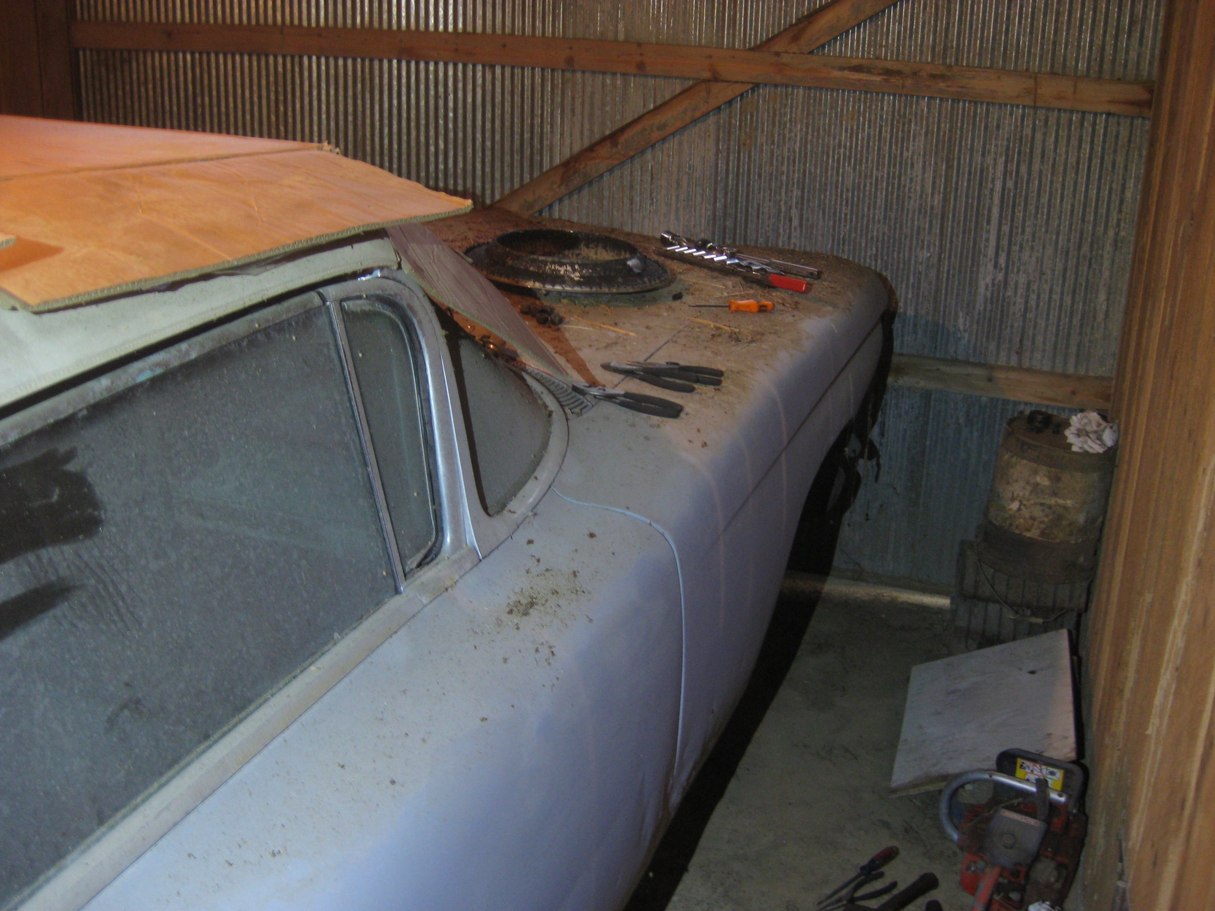

    Now Vetteman61, It didn't happen unless you show us the photos and give us a story.

    Thanks a ton everyone. I cut the head of the pins off and took the bolt out of the back of the wheel cylinder and was eventually able to remove the drum. Unfortunately, even though I didn't hit it hard at all a couple pieces of the lip of the drum did break off. Unfortunately, a lot of trash got onto the spindle and bearings so I had to clean, regrease and repack everything. One down, three more to go. As requested, here are some pictures. Also, I began thinking and realized this car has been in this barn for 14 years now. Time flies.
