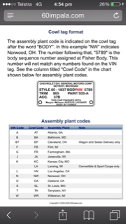

    Have a Factory rag with a
    Vin is N for Norwood OH
    Cowl: LA for Lamsing
    I understand one is ***embly and one manufacture but it's very confusing being each side of the country
    Any Rag experts out there ImageUploadedByH.A.M.B.1460682164.010763.jpg ImageUploadedByH.A.M.B.1460682186.243703.jpg
    Vin **867N1433zz
    Cowl zz67BODYLA162zz

    I'm not an expert....but have never seen a vin and body tag showing different build plants on the same car. One of those tags don't belong on that car I'm afraid...

    If LA is for Lansing, Michigan, then Ohio & Michigan are near each other. There were body plants (where the cowl tag was affixed) and ***embly plants where I think the VIN tag found it's way onto the car. I'm to understand that some of the bodies were rail car delivered to ***embly plants, if I'm remembering my past reading well.

    The ***embly plant issued the vin. In other words the car got a vin when it was coming down the line to be mated with the body shell that would already have the cowl tag affixed to it. Lansing and Norwood were both ***embly plants...don't see a reason why half the car was built one place and the other half another. Simpler answer is one of those tags isnt original to that car..

    I can't find a vin letter listing for ***embly in LA ( Lansing )
  6. Aussie Chev
    Joined: Dec 21, 2011
    Posts: 26
    Aussie Chev
    One is Michigan one is Ohio

    Does your car have airconditioning. If so, somebody swapped cowls. It`s the easiest way to do it to a car that didn`t have air.

    WOW! You learn something every day. Amazing! Never heard of this situation...but it seems to have happened before. Seems like Lansing and Cleveland were just building bodies and not whole cars ?! My first reaction especially in a convertible like the OP's is to ***ume shenanigans....could/might/probably be legit
