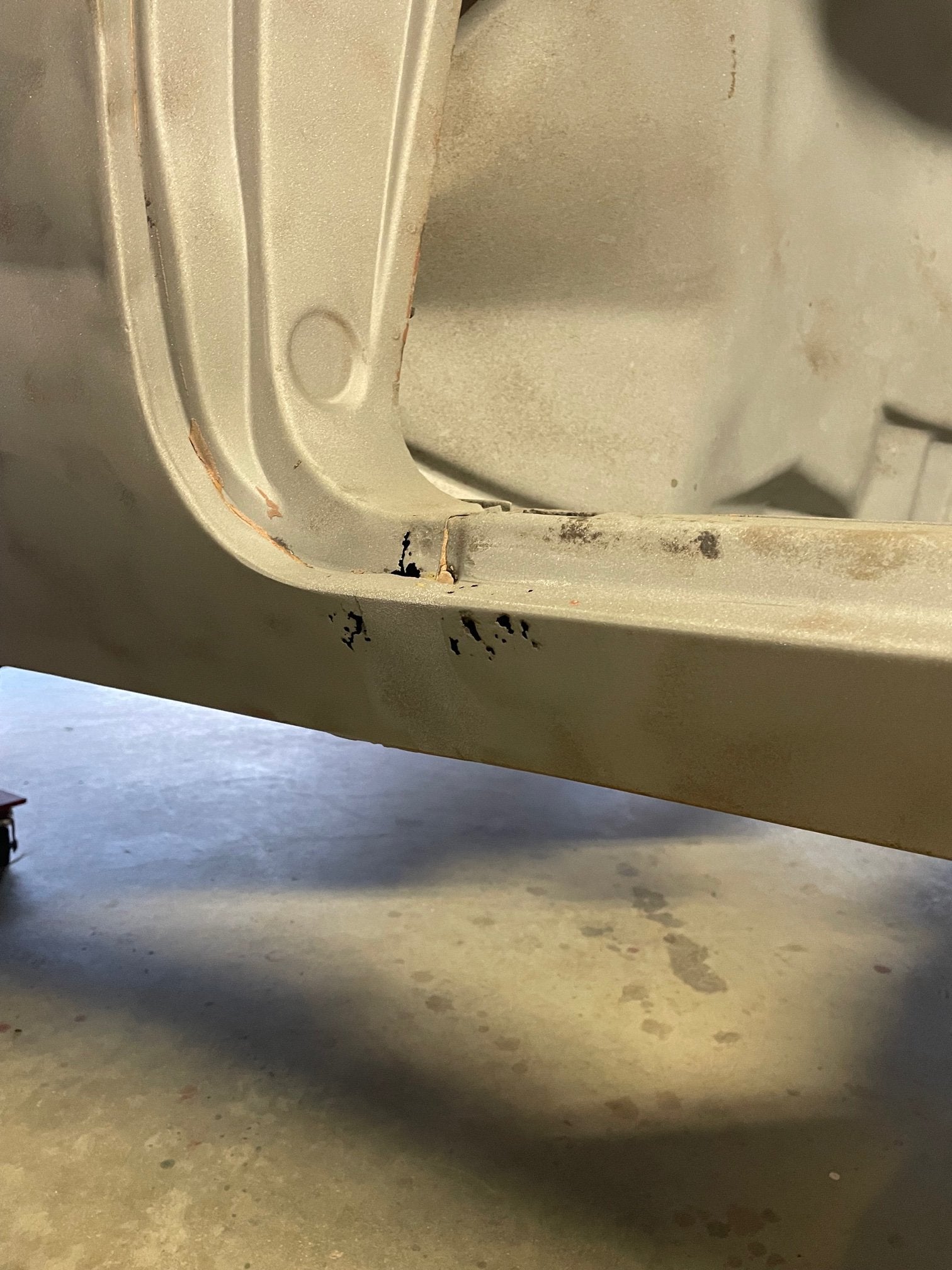

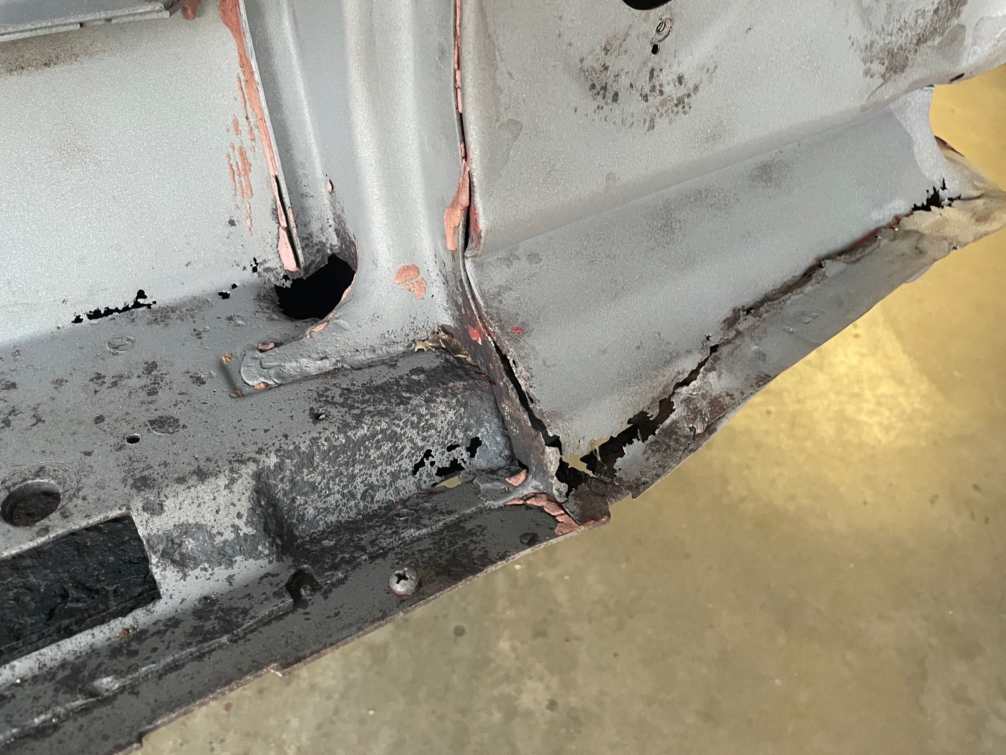

    Got the car back on Thursday. Came out pretty clean. He had some trouble cleaning up underneath so the frame isn't as clean as I'd hoped and the differential still chunked with old grease. From the differential back, he said whatever is on there, would not come off with the media he was using (green diamond is what it's called). I'd like to pull the body off the frame and ideally put it on a rotisserie so I'm not too upset about all that. There are however, lots of small rust holes that appeared. Some no larger than a pin hole. Not sure if I need to cut out and repair those, or if I can pick up some leading supplies and fill them that way. Others may do well just to receive some seam sealer. All in all, I'm happy with the result. I have a much better idea of the condition of the car and can start moving forward.
    P***engers side rocker.
    P***enger door jamb
    P***enger roof
    Drivers roof
    Drivers quarter at door jamb
    Drivers quarter in front of rear wheel
    D/S rear tailgate jamb
    P/S rear tailgate jamb
    P/S quarter
