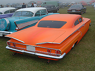

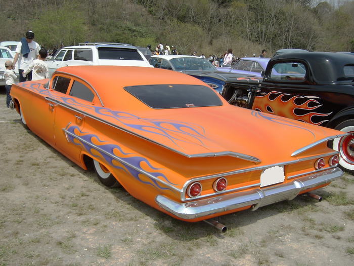

    I'm not building an elcamino. I've had a 4dr sedan impala I've been driving for the past 12-13 years and its due for a redo. Ive had an Idea for a build first thing is I've got turn the car into a two door sedan but I wanted to give it slanted B pillars like the elcaminos have and I want to chop the car similar to the two door hardtop 59 or 60 buick that david guymon chopped several years ago.
    The only thing I want to change that some other folks might not like is I'd like to change the back glass when I chop it. I want to take out some of the green house effect. So I've been trying to come up with smaller back glass Ideas that I can come up with.
    I've considered using a 49-52 chevy fleetline fast back rear glass but I've got a few other ideas. I like the look of the 63-4ish galaxy 2dr hardtop rear glasses. I'm just tired of burning up from all the glass in the summer.
    I'm also planning a 3" chop using a 2dr hardtop windshield which is about 2" shorter in height give or take a little. Then I planned on possibly sinking the windshield another 1"
    At one time I had measured the windshield height on and elcamino, 4dr sedan, 2dr sedan, 2dr hardtop, station wagon, 4dr hardtop, sedan delivery. What I found if I remember correctly was the 2dr hardtop windshield and the 4dr hardtop flat roof cars had the same size windshields which were around 2" shorter than the sedans and elcaminos.
    I've figured up most of all my cuts already to get the roof down where it would look nice and hopefully not look squished. I have a complete parts car and alot of extra parts to use in order to do the build its just alot of metal work but I'm not afraid of some metal work. Every project I've had needed extensive metal work it seems like lately.
    I want it to be a nice clean custom car. My car already has alot of mild custom touches like pontiac bonneville tail lights and a custom grill that may get changed if I can find a 60 merc grill and headlights for it that are reasonable.
