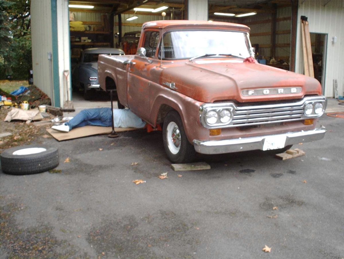

    She's the opposite of pigeon toed right now. The stock axle is 53 1/2" kingpin to kingpin. whereas the replacement axle is 53 3/4" kingpin to kingpin. Making the whole steering arm shorter than it has to be.
    I've got a new tie rod coming for the p***enger side because the boot was toast and honestly... it looks like it hasn't been changed since they were installed on the ***embly line ,62 years ago.
    So, once I get the tie rod (probably Monday) I'll be straightening the steering out.
    Before and after shot:
    That's it for today. I'll post up the progress on the rear as it happens.
