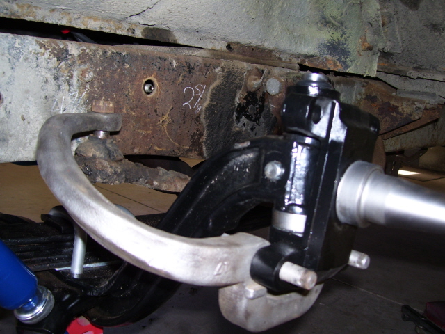

    Funny you should mention that...
    d'you remember me saying the bump steer was slight and "I can live with it"?
    Well... Monday morning I hit a chuckhole right on the edge of a bridge that has an angular approach on a slight curve, no less.
    Anyway, I hit that thing doing 45 and the wheel jerked out of my hand and the truck swerved into the next lane (thank god it was clear) and I almost over corrected trying to get her to calm the hell down. Yeah... "Slight, my ***!"
    'White knuckled this ***** back to the shop, parked it, sat behind the wheel for a minute, got out, then tried to smooth out the pucker in the naugahyde where my *** tried to bite a hole in the seat. :eek::eek::eek:
    Holy ****!!!
    So... this morning I popped the wheel off and set the truck down on a block that put it at ride height to have a look at things and take some measurements.
    Well there's your problem! :eek::eek::eek:. That steering arm is certainly a little more acute than it should be.
    And, check out all of the speed hole ****ery going on there on the frame around that steering box!
    I wonder what cobbled together mess was there before someone replaced the steering box with the right one? :confused:
    -OR-
    Perhaps this is Swiss Steel Ford experimented with, that turned out to be no gouda. **rimshot** :confused::D:D
    Okay, back on topic. :mad:
    From what I've read, solid axle steering geometry loves right angles and gets real twitchy when you throw any other angle at it.
    So, with the math and everything, it looks like I have to bend the J-arm down around an inch and a half.
    That'll put the drag link at 90 degrees in relation to the pitman arm and level with the road at ride height.
    BUT... I don't have a tourch... well... I "didn't" have a torch. Found a little homegrown gem locally and it was so cheap I couldn't p*** it up! AND, it works!!! I'll need to get the oxygen tank filled, the acetylene is damned near full.
    It's not a big set up, but, it'll do what I need it to do around here.
    I wiped down the tanks and cleaned the regulators, then I booger welded (and when I say "booger welded", I mean it.:D) a cross brace with my tired, gasless mig on the cart because those pipes were dangling free and welded to sheet metal. Then I gave the old cart a squirt of hammerite and repainted the wheels. The wheels had been orange at one time and they sprayed the rubber too. :confused:
    There is just something so very freakin' cool about homemade tools and carts that I absolutely love. The middle aged guy I got it from said it was his dads and that he must have made it sometime in the early 60's.
    It's well used and not perfect, just like everything in my shop, including me, and I couldn't be happier. :D
    Of course, I'm going to replace the hoses and I need to find a cutting torch for it.
    I didn't go crazy on it but the cool old torch that came with the set cleaned up pretty nice.
    So, Once I get everything together, I can bend this thing onsite.
    Stay tuned, I'm getting the tank filled tomorrow, then swinging by the welding supply shop for some hoses and to look at a cutting torches.
    That's it for now. ;)

    You probably know this but when you heat the J arm to bend it make sure you let it cool down on it's own. Don't use water to cool. I never had a problem with bump steer on my truck.

    I don't have a diagram of it, but your bump steer is caused by the drag link and the suspension leaf springs being on different arcs as the suspension moves up and down. Basically you need the steering drag link to move along the same arc as the leaf springs do. It sounds like lowering the drag link mount point at the spindle is what you need. Or raise the box relative to the frame where it is now. What's some more holes in the frame (just kidding.....I think)? It is not just a simple "make the drag link parallel to the ground", although in your case it seems that is the approximate correction you need.
    Graph out the locations of the leaf spring rear mount and axle mount, and then do the same for the drag link. Put them on graph paper at their locations, as viewed from the side, and draw arcs as they move up and down. If those arcs do not move and keep the same distance from each other, that is your bump steer, the difference in the arc locations. Putting on paper, you can adjust the drag link front and rear points to get the arc to line up with the leaf spring arc, which will help you know how much to bend and move. Hope that helps, the point is to keep them moving together in close as you can equal distant arcs and not diverging arcs.

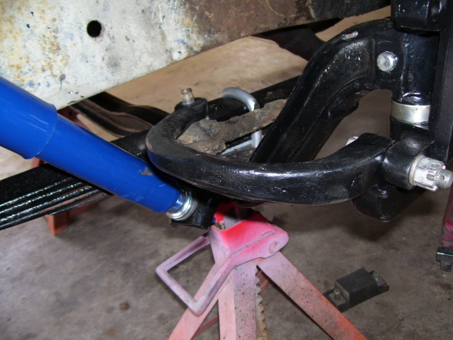

    Monday Morning Update:
    Okay... well this was actually pretty fun and fruitful.
    I listened to you guys, I got a new torch head and a rosebud tip. I made a jig to hold the arm still then went to work heating it.
    I used tension in the form of a tie strap and heated the arm while my lovely wife tightened the strap in intervals. Probably not the way you guys would do it but it afforded me a level of control in getting to the tolerance I needed, slowly and without too much stress on the part.
    Made sure the plane was square where the drag link connects. And it all just kinda fell in place.
    And here it is all cleaned up and a squirt of paint.
    Reinstalled it and found the drag link is now parallel with the spring and frame. I did my loose nut and cotter pin check and went for a drive.
    Bending the arm has completely solved the bump steer issue! Drove the wheels off of it and forced it through every scenario I could imagine, including hitting the original chuck hole at the same speed as I did when I got the **** scared out of me. Nothing. No swerving, no wondering, and no negative feedback at the steering wheel. And, at a standstill, there is no movement in the steering wheel when you bounce the truck up and down like before. BIG WIN!!!
    So, I'm sticking a pin in this and she's once again drivable.
    Thanks so much for your input and suggestions, it made this job so much easier. I am one happy camper... in this respect.

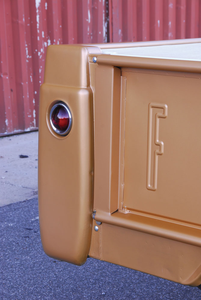

    I've had these old '52 Buick tail lights laying around the shop and I think it's time to use them. I've had this hair-brained scheme cooked up for a couple of years. o_Oo_Oo_O
    So... it's very crude template and poorly done photoshop time!!! :D
    Let's do something stupid! How about something french? :cool:
    Not too deep, maybe about an 1-1/4". Just enough for the bullets to peek up over the surface.
    We'll see what happens. This will also afford me the chance to clean up the metal work on those bed corners. The last thing I frenched was a license plate box into the tailgate of a buddy's S-10 way back in like 92ish. So... anything can happen, folks. :confused:
    Here's kinda what I'm thinkin' placement wise:
    I'm thinking of going with a smooth tailgate as well. I wanna clean things up back there a bit.
    Also, there is so much chrome up front but nothing in the back... looks a little nose heavy to me. Don't be surprised if I end up putting a rear bumper on this thing. It'll help hide the udders... I mean gas tank. :D
    Stay tuned, I guess.

    I think the taillights will look killer, but not sold on that smooth tailgate...I think the original with the giant FORD's quite distinctive and interesting. Maybe do the letters in a gold/white mix like the scallops?
    But I do agree a chrome bumper would help regardless.

    I've been playing around, building the buckets for the tail lights.
    They're a bit heavy, but I'm building these from what I have laying around the shop, so... at the very least, if these get chucked, my shop gets a bit cleaner in the process. :p
    Tune in tomorrow. Same Bat-time, same Bat-channel.
