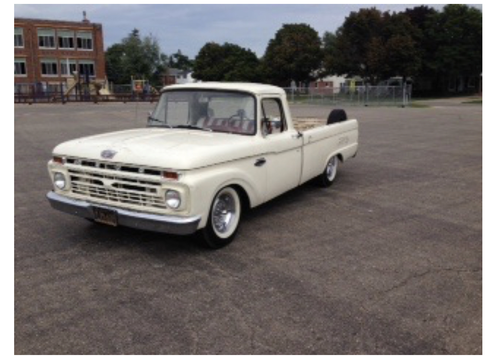

  18. Callmaker
    Joined: Feb 17, 2020
    Posts: 170
    Callmaker
    How about this?
    loudbang, brEad and ccain like this.

    ccain
    63-64 Galaxy? Nice.

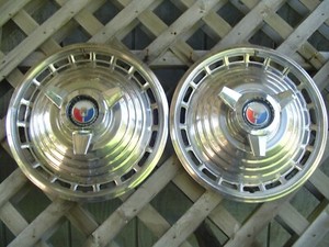

  27. loveoftiki
    Joined: Nov 11, 2006
    Posts: 9,178
    loveoftiki
    from Livonia,Mi
    Yes...and whitewalls...
