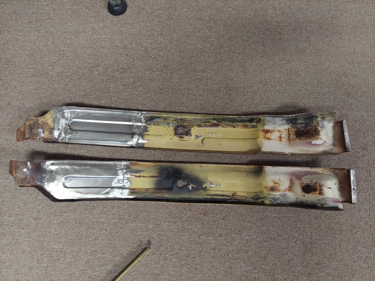

  3. I have the inner fender braces off both my fenders at the moment as I bought new lower fender replacement panels. The design traps debris between the fender and the brace and is guaranteed to rust eventually.
    My braces were rusted through, so I had to make some repair panels for them.

  6. Doc, these are my braces and it shows what was rusted and needed to be repaired.

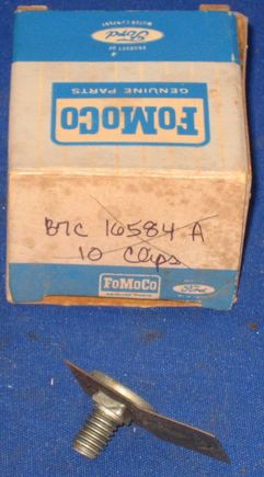

    There should be a stud at the bottom of each that holds the bottom of the fenders to the mounting point on the cab as well.

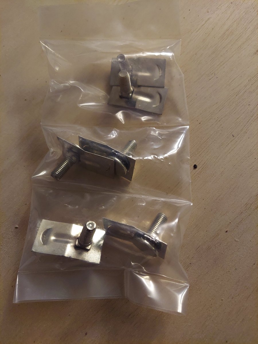

  8. There were remnants of the same fender clips as would be found in the other holes on the fender there are 3 per fender on the inside. See the attached pic edit: found correct pic.

    Well, you've just been a wealth of information for me in the past 24 hours! Not only a picture of the clips, but the Ford part number too! Thanks!!!
    (I've owned three of these trucks, one had bolts welded to the inside fender where the studs were, one has a bolt through the fender from the outside, one was just a welded goobered mess that was slathered in bondo.

  10. Those clips were a learning experience for me... Just sharing what I discovered. Of the six, I had part of one left.

  11. I got these off eBay. If you search for the Ford part number above you can find them. Obviously not original Ford. I'd actually forgotten that I had even ordered them. I blame early onset senility. :rolleyes:
